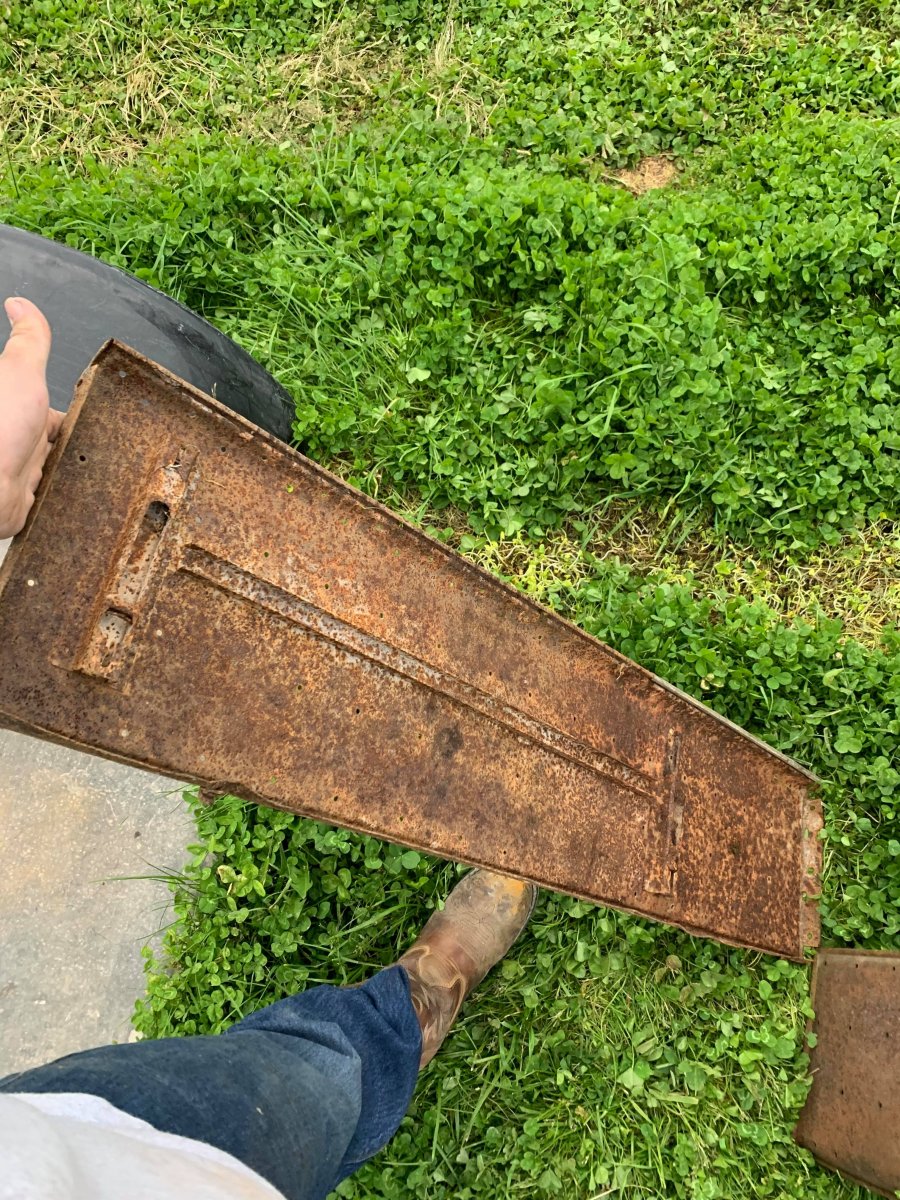

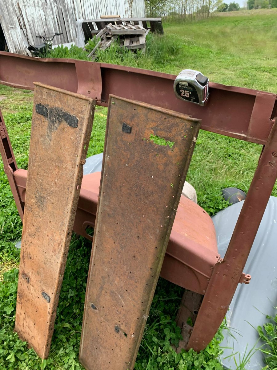

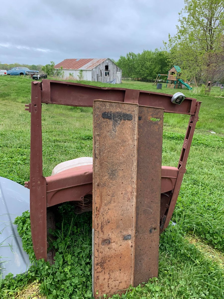

    Brother @Austin kays came threw with a set of what we think are the correct running boards!
    Im super stoked on them and can’t wait to see what we’ve got in person :)
    going back to work this weekend with a VERY heavy schedule so any progress will likely be stacking up parts in nature. But I do have a couple big acid soak projects I’d like to do so maybe I’ll post how that goes?
    thanks again Austin!
    ~also if any of you guys are looking for 35-39 ford gauges he’s unloading a good pile of them ;) ;) A5A9E302-CFFB-47D0-95C3-048FE1C010B3.jpeg 1DC81DFE-5DC3-4ABF-8633-4DAAADBA2873.jpeg 918F9B1F-ADC9-4355-9FBB-230767C72E9C.jpeg FF7FA7A2-2061-49C4-9464-A5A6F36746EC.jpeg

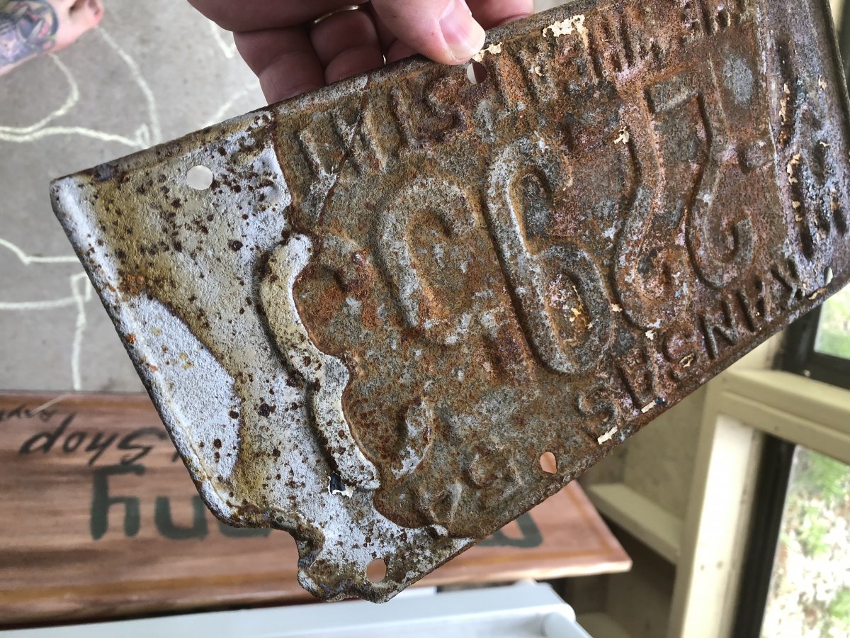

    @drdave well, @flatout51 got me hooked on soaking stuff in citric acid. Mix the flakes with water and let it soak! Doesn’t eat paint or platting. Works pretty quick, seems to neutralize easily with some dawn and water. Obviously dry it off good after that.
    doesn’t seem to make any difference if you cover it or not and I get bubbles to come off it even when it’s dang near olive colored “water” in the bucket. Good bang for your buck.
    did some experimenting with an old license plate last month and found that covering it didn’t really make any difference but it will eat threw a disposable broaster pan/ tin foil pan so maybe stick to a 5 gallon bucket.
    I see David soaking some leaf springs in what looks like a 2x4 square nailed together with a plastic tarp to set everything in. Trying to figure out how to soak those running boards with out waist of a lot of product.
    Could dump it all over the board and wrap it with plastic wrap but I doubt it would work like a good soak you can agitate

    This thing was CRUSTY before.
    after I soaked the whole thing I left this end in for a week and got that result! Been setting on my porch for about a month now after the fact with no coating and it’s obviously not flash rusted or anything CAC76990-9BFC-40CD-AE24-946E212CD4EE.jpeg

    That's pretty impressive! Less messy than sandblasting, that's for sure.....at least a lot less sand down my back and in my ears. LOL

    Now that I’m looking at the photos of the running boards they don’t seem to be model A. The bead around the perimeter and the Rounded over side don’t look familiar.
    any ideas what they might be?

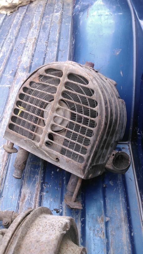

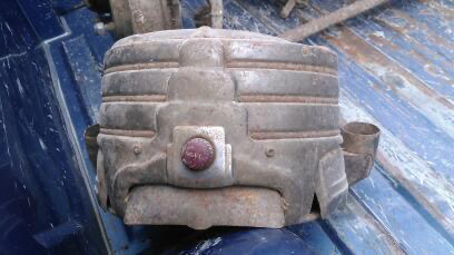

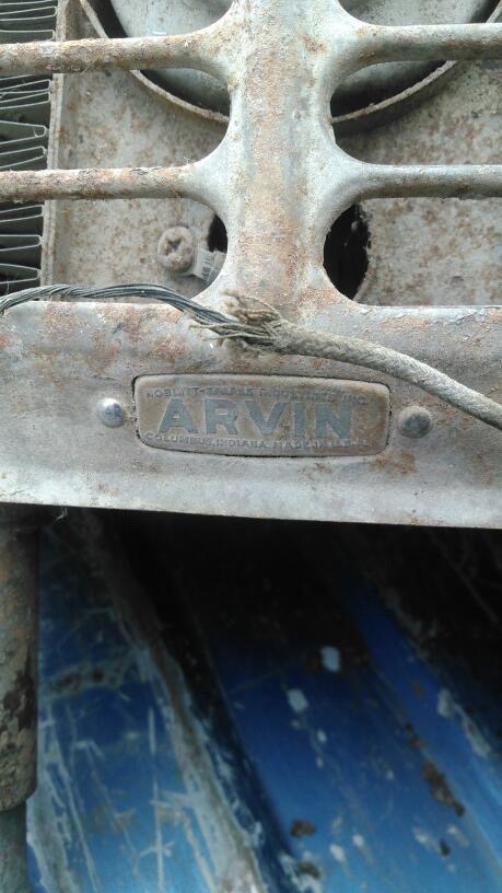

    Got this heater coming my way. Pretty excited about it! Seems to be 40’s after market and I’ve read reports of it thawing ice off windows at -20! Good to hear, should keep us warm on those cool nights with the windows down and maybe the top open! 9EC0044B-3A18-4B71-A815-9476AB35E14C.jpeg 488D36D2-219B-428E-A3E0-30C191EA9326.jpeg 63C9EC9A-9A00-434B-BB37-C897500EB96B.jpeg @RICH B on Austin’s post you showed how you framed in the roof opening on a sedan with square tubing. You mentioned a home made roller and that there are other methods to get the subtle bends as well.
    wondered if you could expand on that? Didn’t want to clutter his thread with my curiosity so thought I’d ask here :)

    Picture I snagged from an old hamb thread to show the size of the heater. That’s a 49 chevy it’s in if I’m remembering correctly 4B523BB9-7D90-4F62-9972-DFF59384771A.jpeg

  18. Runnin shine
    Joined: Apr 12, 2013
    Posts: 3,383
    Runnin shine
    Can we start a Arvin members only club, or would only two of us show up for meetings?

    does yours look like this one?
    loudbang, Thor1 and Stogy like this.

    :rolleyes:...I see a funny face in this Heater...must be Arvin...:D
    I guess the P***enger will have the warmest Tootsies...
    Having a 29 myself I know it'll be real easy for the Driver to get the Tootsies warm too as it's pretty tight in there...

    Looks like it’s got three directional vents on the bottom and a defrost port on each side. I’m hoping that the reostat switch lets me keep it just barely on so we don’t melt our toes haha

  22. Runnin shine
    Posts: 3,383
    Runnin shine
    Here’s mine, it’s all apart now for a fresh green hammertone paint treatment.

    Cool, that’s the one I see more often. Way more chrome though! Should be neat in your hot rod.
    I like that the single knob has a light inside it so you can see it down under the dash in the dark. no problem

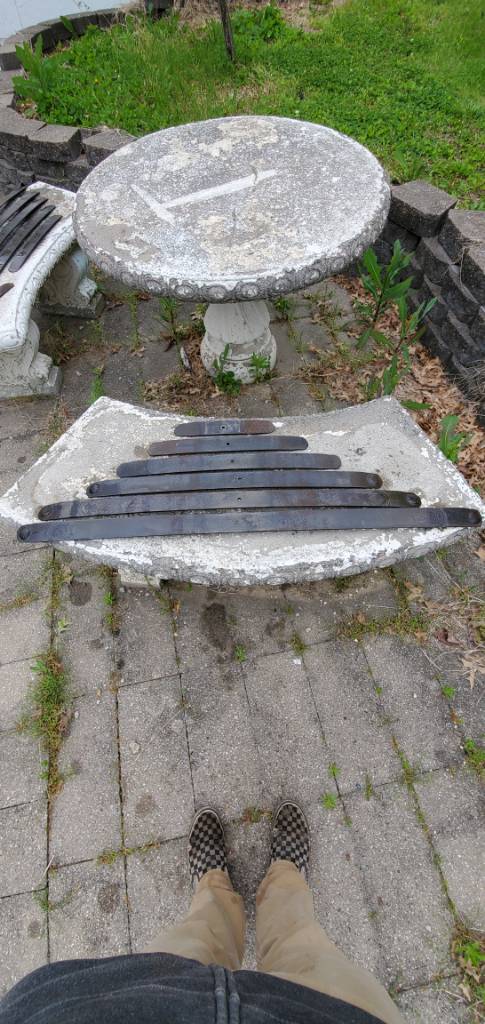

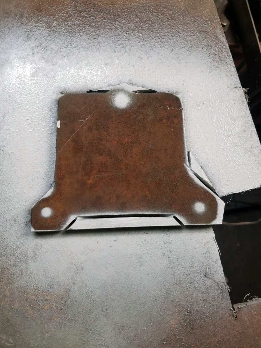

    Mail order hot rod parts A82676AB-8AEB-4C55-9230-9B1381B623A1.jpeg 954F8FD4-1408-4087-8637-CCE109C3770D.jpeg 111A813E-9AA2-4E1F-B353-76A6B28019D0.jpeg mailed my buddy a few templates and between his giant quarantine honey do list items he’s been knocking them out and sending them back to me. This is the block off plate for the hole left in the intake manifold for the heat riser. I’ll pop 3 holes in it and eventually make a gasket. Done deal!
    figure with hood sides less than 5 inches from the intake we should t have any trouble with it being to cold but if we do this is 1/4 plate and shouldn’t be any trouble to adapter a riser from the header
