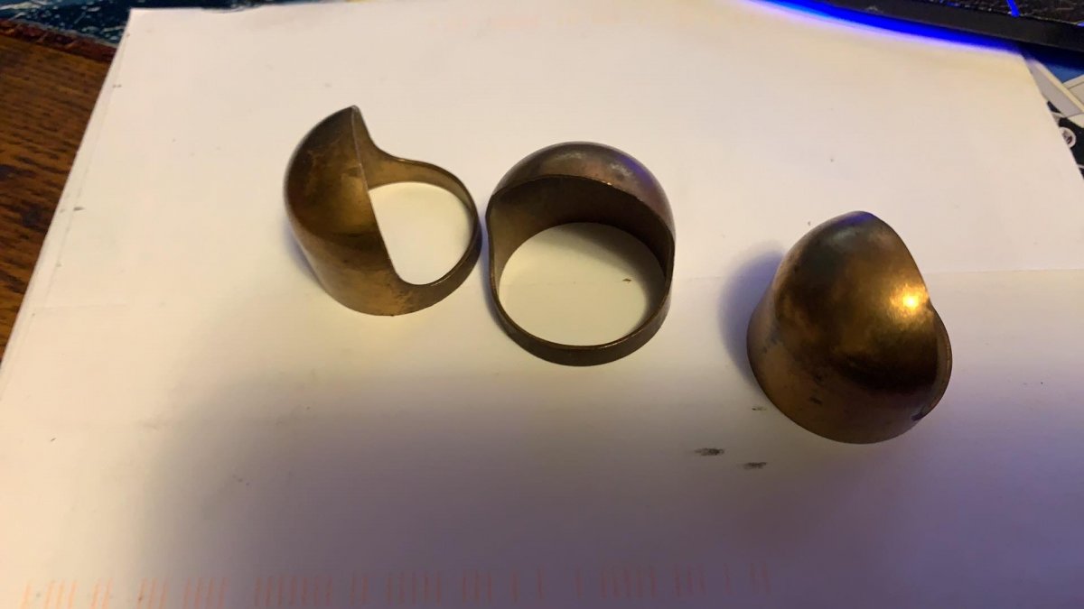

    969DE8C1-0092-4DE9-934C-1944E78D806D.jpeg Austin snagged me these little br*** knick knacks from a train he dismantled. I can’t wait to use them on the A! All sorts of ideas for these :)

  3. dumprat
    Joined: Dec 27, 2006
    Posts: 3,572
    dumprat
    from b.c.
    Cool! How big are they?
    loudbang and Thor1 like this.

    I’m not sure @dumprat in thinking they’d be cool to hide a light or switch under, or if they are a little bigger they could be a cool little wire bulkhead/hood where it p***es threw the firewall.
    I’m excited to see what I can come up with for them.

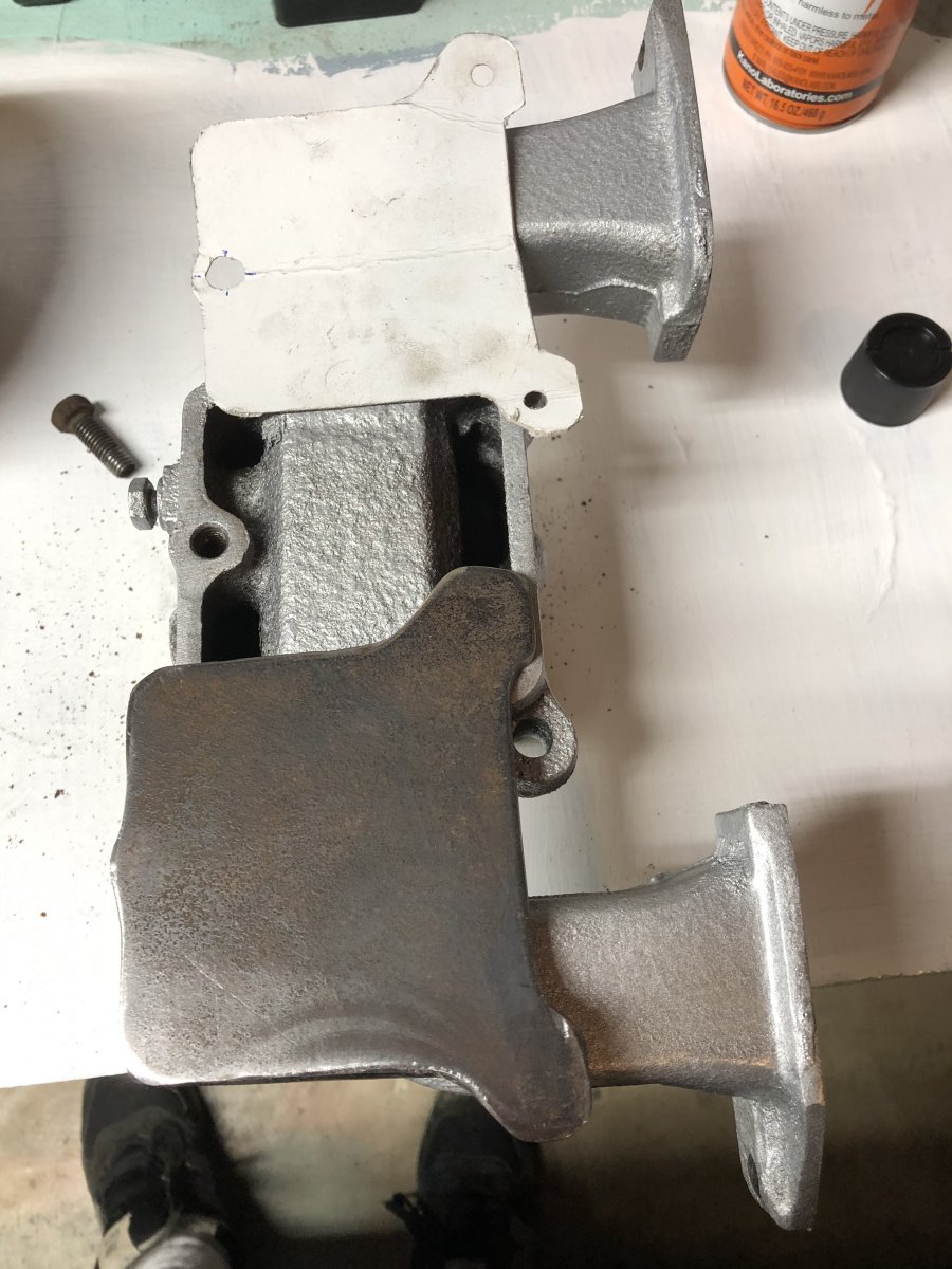

    Cardboard template.
    1/4 plate part 4B4F8F5A-2FFC-486D-A345-460406533332.jpeg drilled and painted with the silver hammer tone like the rest. Excited to have this one close to being checked off the list 46FA9862-42A7-4660-B947-D7FBE8F447EA.jpeg
    patmanta, loudbang, brEad and 2 others like this.

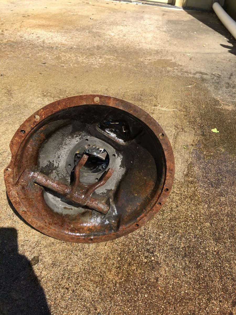

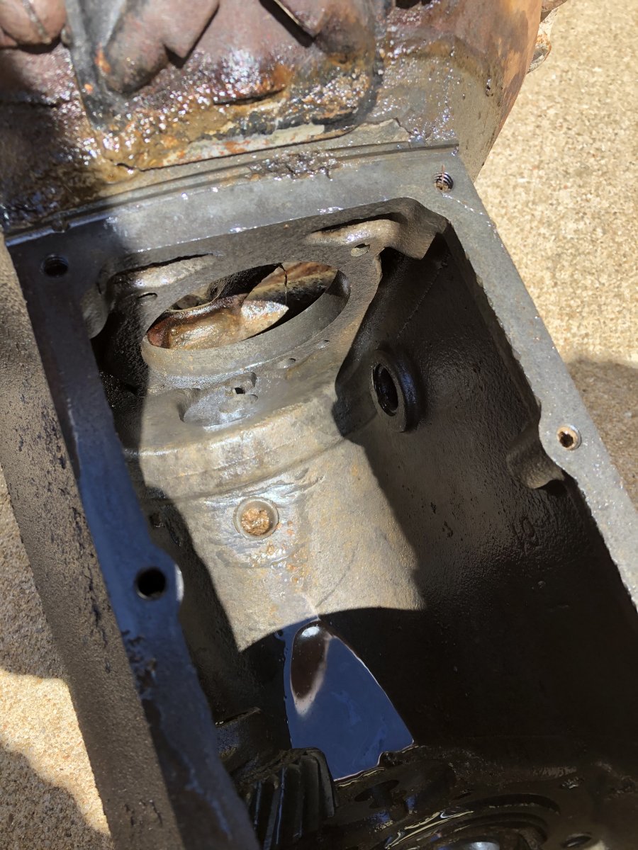

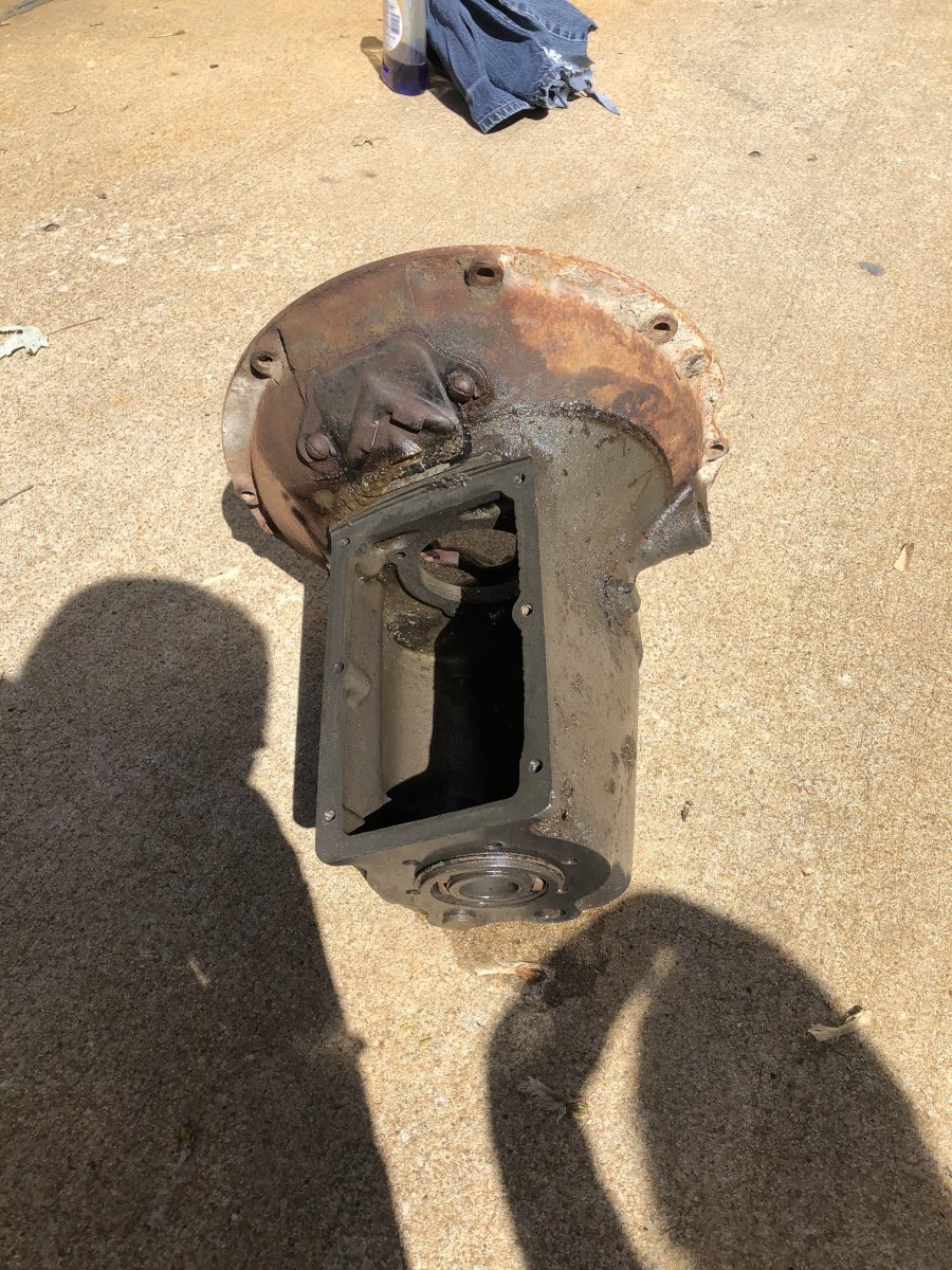

    Pulled it out of the bucket and took it to the drive way. Hopefully these load more or less in order 8374618F-67B2-41F9-BC5E-2CD234B5B41E.jpeg 1B30759D-A991-4D1B-89D5-681184F08B36.jpeg 9B9F4A4D-E00F-4838-BC64-B84C91B83E11.jpeg B1636893-3C07-4418-BD13-1450527E22CA.jpeg CA2EBEFC-6BFA-4DDD-9853-AFD30A9EEEEB.jpeg EE6542EB-FD30-428A-8039-4045E7FF4A9D.jpeg
    brEad, drdave, loudbang and 3 others like this.
  14. Tim
    Joined: Mar 2, 2001
    Posts: 20,796
    Tim
    from KCMO

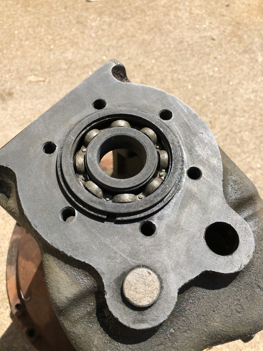

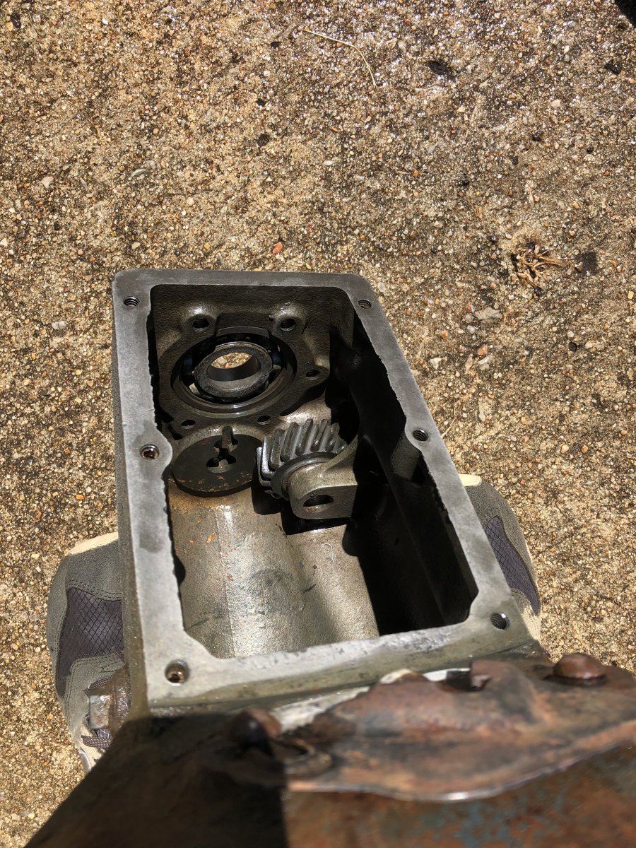

    Then because I had just cut my Jean into shorts haha I used the cut offs with some dawn dish soap to scrub it down. Then i put some soap in the case and just sprayed the **** out of it with a hose for a while.
    then I used various towels to try and soak up any water and left it in the driveway for 5 hours at 93 degrees.
    you can see that it gets a charcoal ish tint to the metal but If you want it gone it comes off fast with a wire brush or similar.
    after a few hours it has a tiny bit of a sand colored spots that I guess are flash rust but it doesn’t bother me at this point. Easy prep if I need it gone.
    i can read ALL the numbers on everything, the gear inside the case now rolls like it’s all brand new.
    Just brought it back in and sat it in a wider shallower tub with some other bits and pieces with the bell side down for round two.
    I just dumped the now yellow/ green liquid out of the blue bucket into it.
    most of the rust/ mud sludge stayed in the bucket I’ll post pics of that later :) 5D73D1D7-76CC-48A4-9087-307CA1426A91.jpeg 26AC9B83-19BA-4595-B997-F7A14F3564FB.jpeg A10E2FFD-EDF5-4862-96A5-56958E83DAA0.jpeg 56CA2955-BCF9-4A85-939E-A07F4B064B62.jpeg 4EDD0EF0-95F6-4F19-9F74-E8B47CE74A33.jpeg 62AA074F-7F2C-448C-A394-4305D6DEF2E4.jpeg A2F013C0-F373-499D-A265-C5E9F76CF45F.jpeg 5D59C1CE-36A9-406F-93F4-9A54E024C03C.jpeg
    brEad, flatout51, drdave and 7 others like this.
  15. Impressive results!
    loudbang, Thor1 and Tim like this.
  16. Inked Monkey
    Joined: Apr 19, 2011
    Posts: 1,850
    Inked Monkey
    That's nuts
  17. Tim
    Joined: Mar 2, 2001
    Posts: 20,796
    Tim
    from KCMO
    Even that gear spins with no slop or noise!

    Here are a few photos of it in the new tin with some random bits of other rusty stuff. You can re use the solution until it’s basically sludge. As long as you can see teeny bubbles it’s working. C06F5E04-FF80-4B0F-BC34-AEF9CDA4B22A.jpeg 1B2EF6D3-28F9-4F5D-AC61-0D40195D64DD.jpeg 505FBFC4-4F66-4B18-99F9-15FBF8413BF3.jpeg EA874194-9FD6-49E3-A5B7-F2C84CE24270.jpeg Was trying to get a good look at the green/yellow tint it has now. Also put the block off plate on the intake for a look. Needs the paint touched up a little as it felt over night but over all I’m happy with it. Need some hardware and eventually gasket material and it’s done 97285190-3B8F-45E7-BB79-51A2E36C638D.jpeg

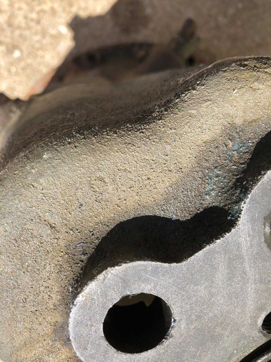

    Yeah I think they would @drdave between this and the steering boxes you can see the machines surfaces perfectly clear.
    Most smooth machined or non porous things come out shiny. Worse case you may have to clean the bores a teeny amount if they get the darker tint to them? But seems like dang near a bottle cleaning brush would do it.
    this if it’s quick thin flash rust this will take it off in less than 12 hours.
