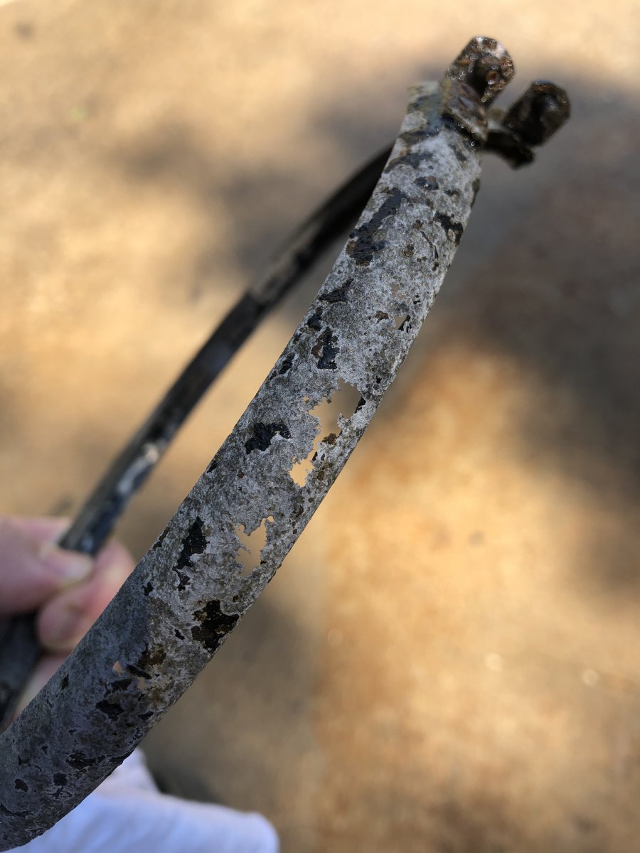

    So 24 hours in the soak and maybe 20 minutes wiping them down, hosing them off and drying them. I can actually see marks inside the buckets that show how they were made.
    you can also see a ton of places where these were plated at one time. The inside the bucket is where I see it the most. Don’t know if it was chrome but it was.. something. 9142CA4F-8CCF-4230-BCA2-47DB96682249.jpeg 5BA1DA85-CF07-4710-97AE-127A8D39E960.jpeg D2872BD9-D0FA-448F-B7F6-9CF334363E66.jpeg B925EE02-96BD-4110-B9A9-261C520020CF.jpeg 0486CF51-8937-40D1-A36D-8BB4BA6B180F.jpeg DD4E6A38-0B4E-4873-AA8D-084A889A4D62.jpeg 59C522AE-6855-4CF3-BDA3-57FC76DF2753.jpeg So the damage that needs repaired comes down to one bucket having a ding in the top and the bottom pushed up. I believe a shed fell on this car in last years big tornado. So it’s likely those both happened at the same time.
    the mount clearly has been broken and ****ed with before and handy enough it’s the one that needs a new stuff anyways so I don’t ave to feel bad cutting a good part up to get it swapped. Both trim/‘retaining rings have rust threw from water collecting at the bottom id guess. The metal still feels thick it’s just the high/low spots of the pit that are popping threw not the entire thing getting thin.
    I put it together and the part that has the holes doesn’t seem to touch anything so I might jist fill it with some all metal/ J.B. weld from the back side and sand it even. Call it a day.
    anyhow they are clean and ready to be messed with
