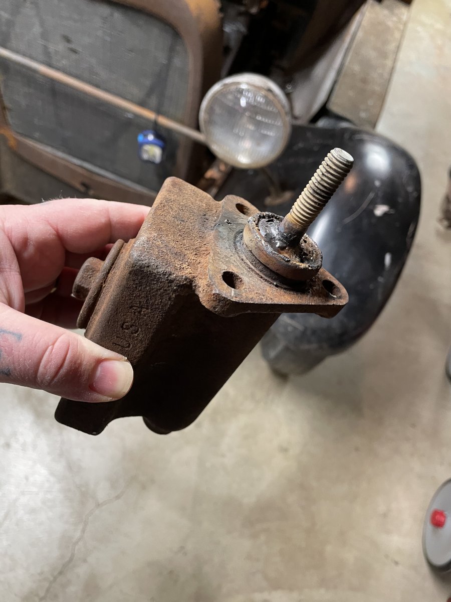

    @Six Ball buddy has a 394/ lesale in his 27 t and I noticed one day that it looked to have a column shift and a floor shift.
    when I asked he said after a while the pedal position hurts his leg so he made a column mounted hand throttle for cruising the highway

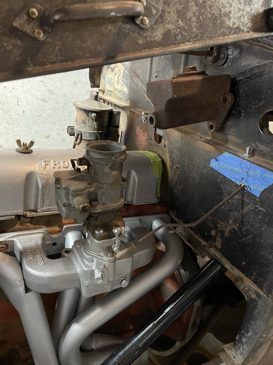

    If I can use the stock steering column and box on my roadster I'd like to try to use the levers for the spark and throttle for a throttle and choke.

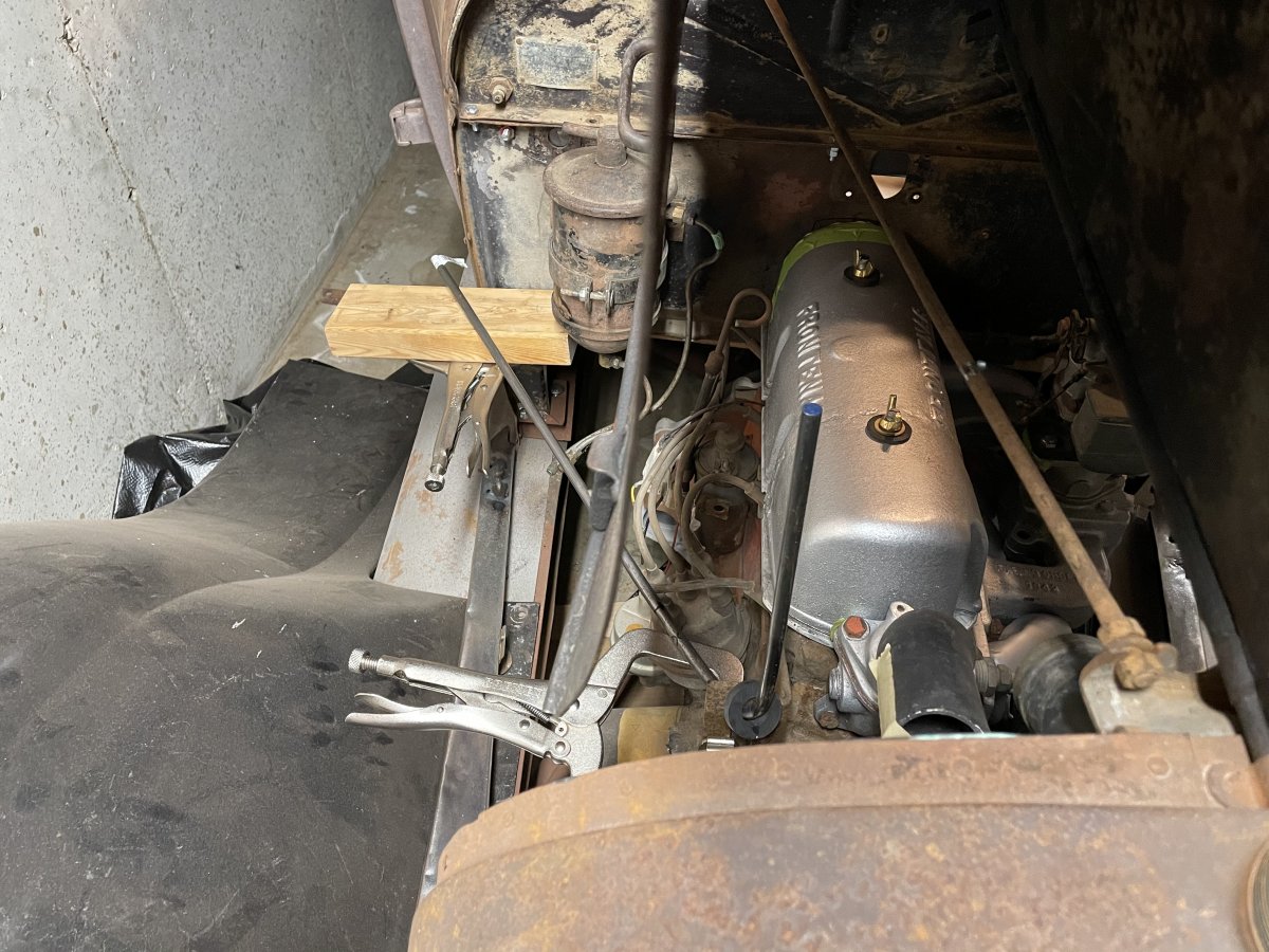

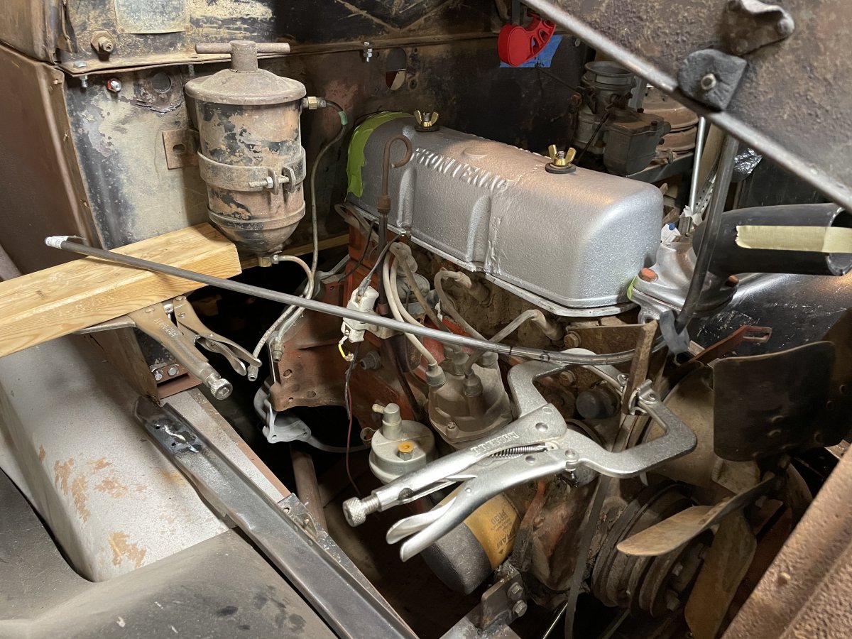

    The masters mocked in place I moved to fabricating a mount for the filter side of the air cleaner so I can build the cross over DF9E6A01-573F-46DA-9382-E7E32085BE53.jpeg used 3/8 steel round stock and a torch after making a rough template of out of a metal coat hanger D75F8A80-F50D-4B51-B8C5-E225834705A1.jpeg B0220962-A1FB-4578-862D-385BE44F4487.jpeg 5E331E13-8FC2-4483-A512-8B02D8B028C0.jpeg a little mocking up and I’m getting a feel for where it wants to go. It may land a little further back or I may run a slightly shorter air cleaner element and mount the base higher. I’m just barely touching the plug wire for the forward most cylinder and I don’t want to worry about it arching or making it hard to check a boot with out removing something to get in there.
    more sit and look, move it around and try again then anything. Can up with a pretty simple way to make everything I think.

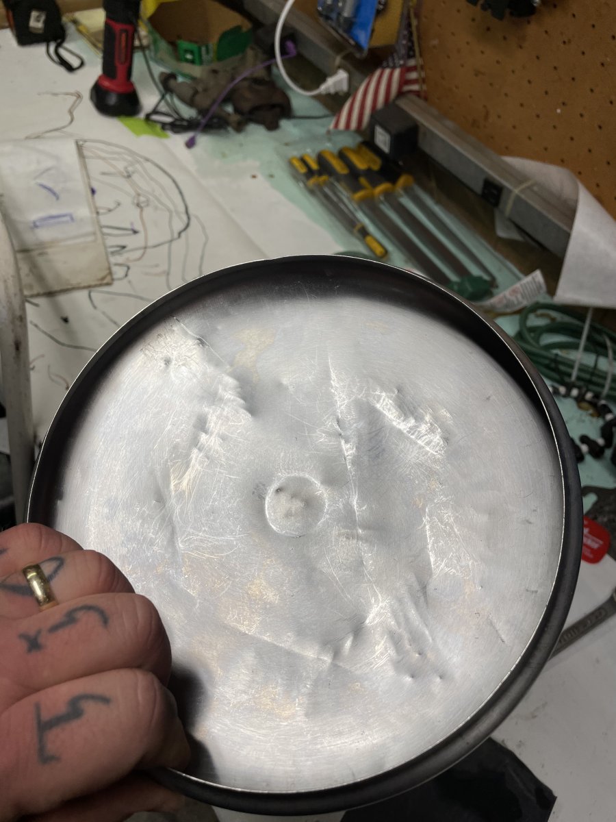

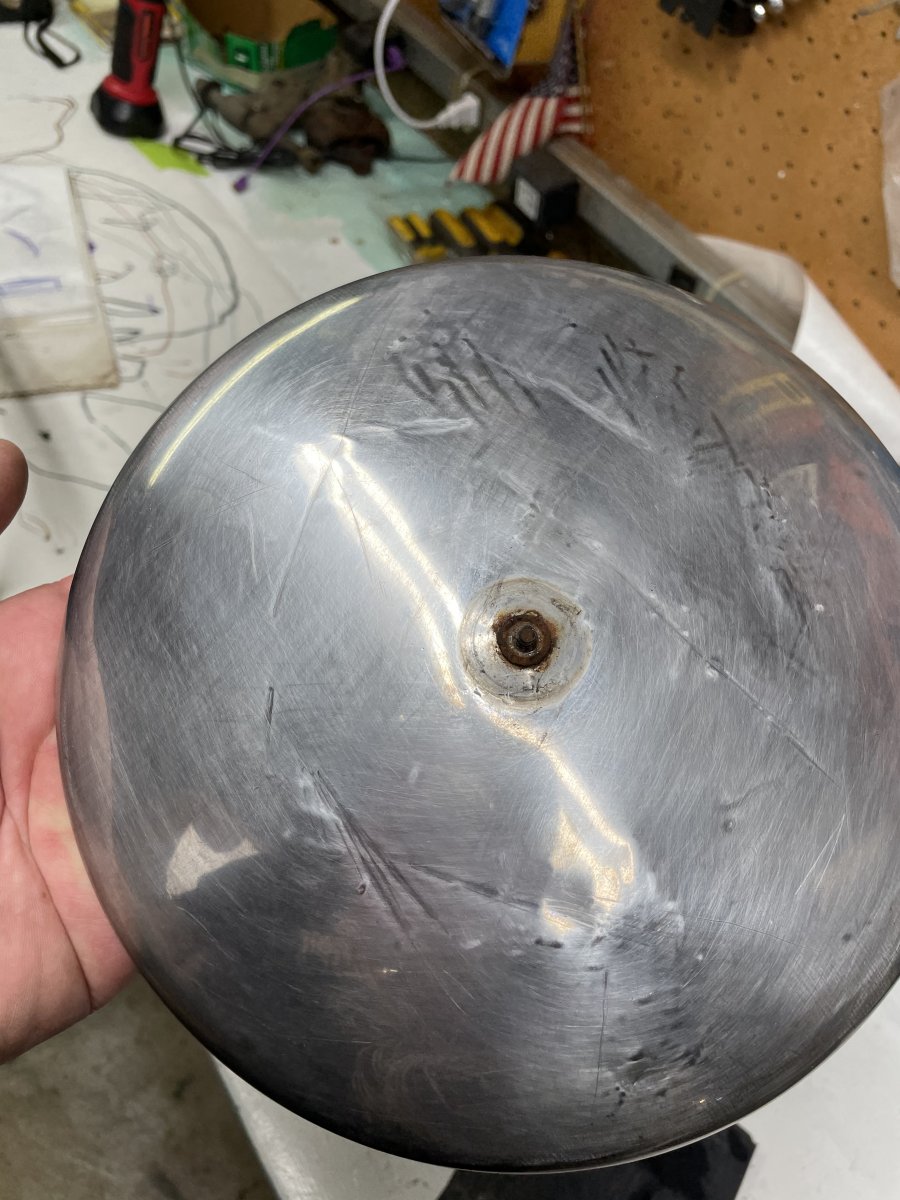

    While I contemplated clearance and how I want to route plug wires I put the lid on my thigh and started tapping the creases out and quite as I could manage. 019968F7-BAC3-4A88-B1D7-2B96FC6C2120.jpeg best I can gather they are all from other kids being piled up on it at some point CF08A617-31F5-473D-910D-DB06D0E90BC2.jpeg wet sanded it a little. It moves almost a little to easy but my high spots are very very short and I think when I can make a little noise that the correct dolly and a hammer from the top side should get me close enough in short order 0F2222B0-5FDA-4F71-B7C9-80E1C0E40907.jpeg the creases moved easy enough but I didn’t have a round hammer head handy so the majority of my high spots are from the hammer heads corners.
    waaaaay easier to hit the top and work them back down than trying to work this from the bottom any further so I’m fine with it. Thinking I’ll polish it up and paint the top that I’m making from a 53 Ford housing black. Because why not

    A 4lb sledge with a polished face makes a great dolly for stuff like that. You can clamp it in a vise and use your flat hammer on the top.

    Hadn’t thought of sticking it in a vice that’s clever! I’ve been meaning to go hammer shopping any how...

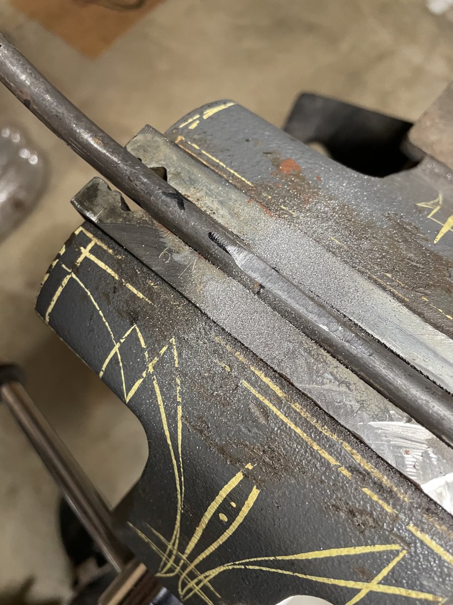

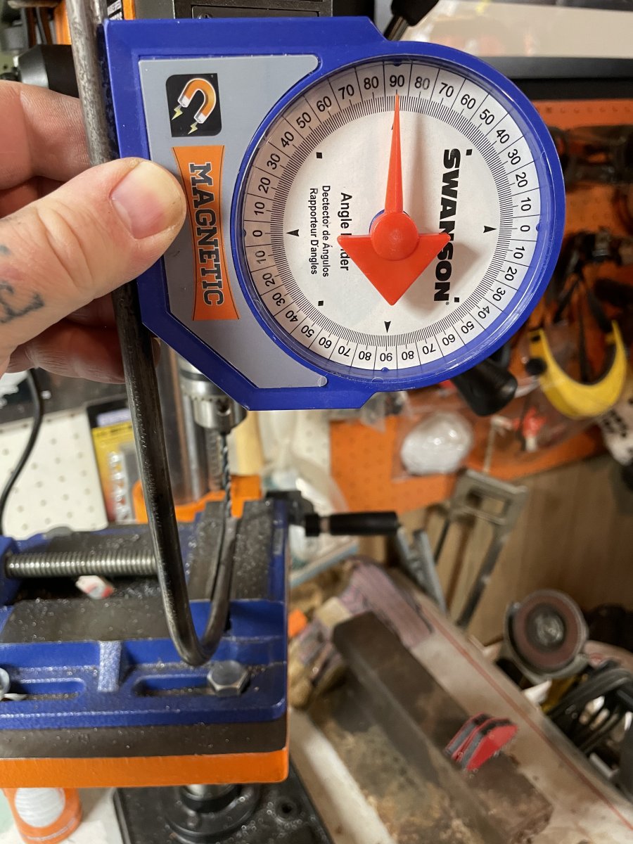

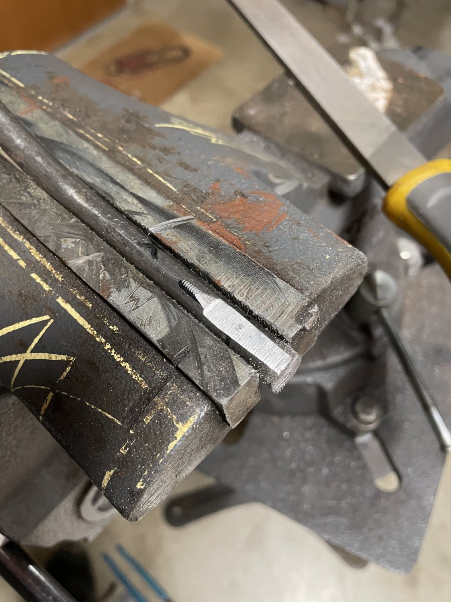

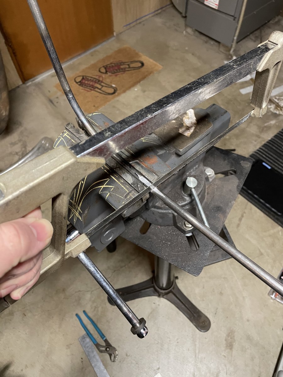

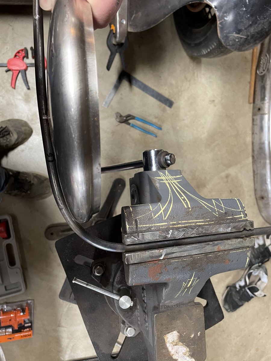

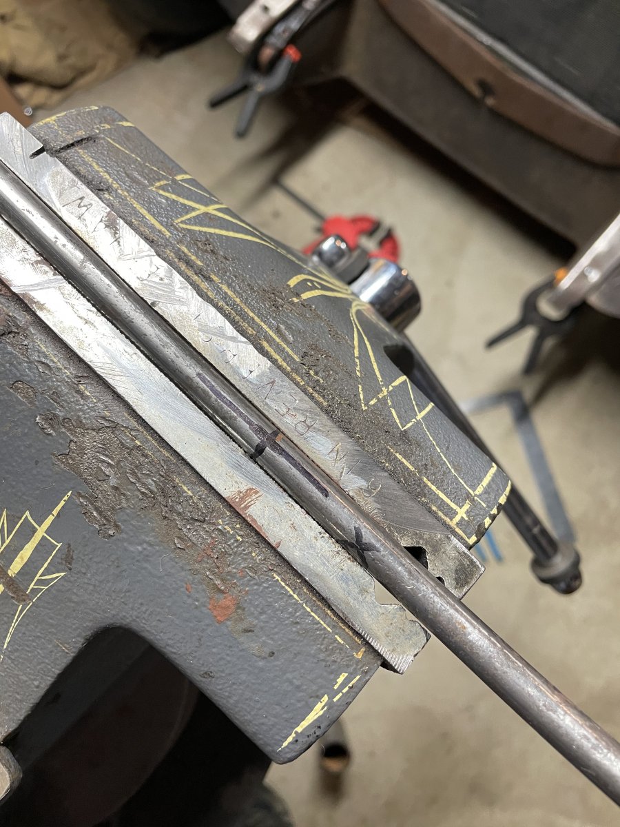

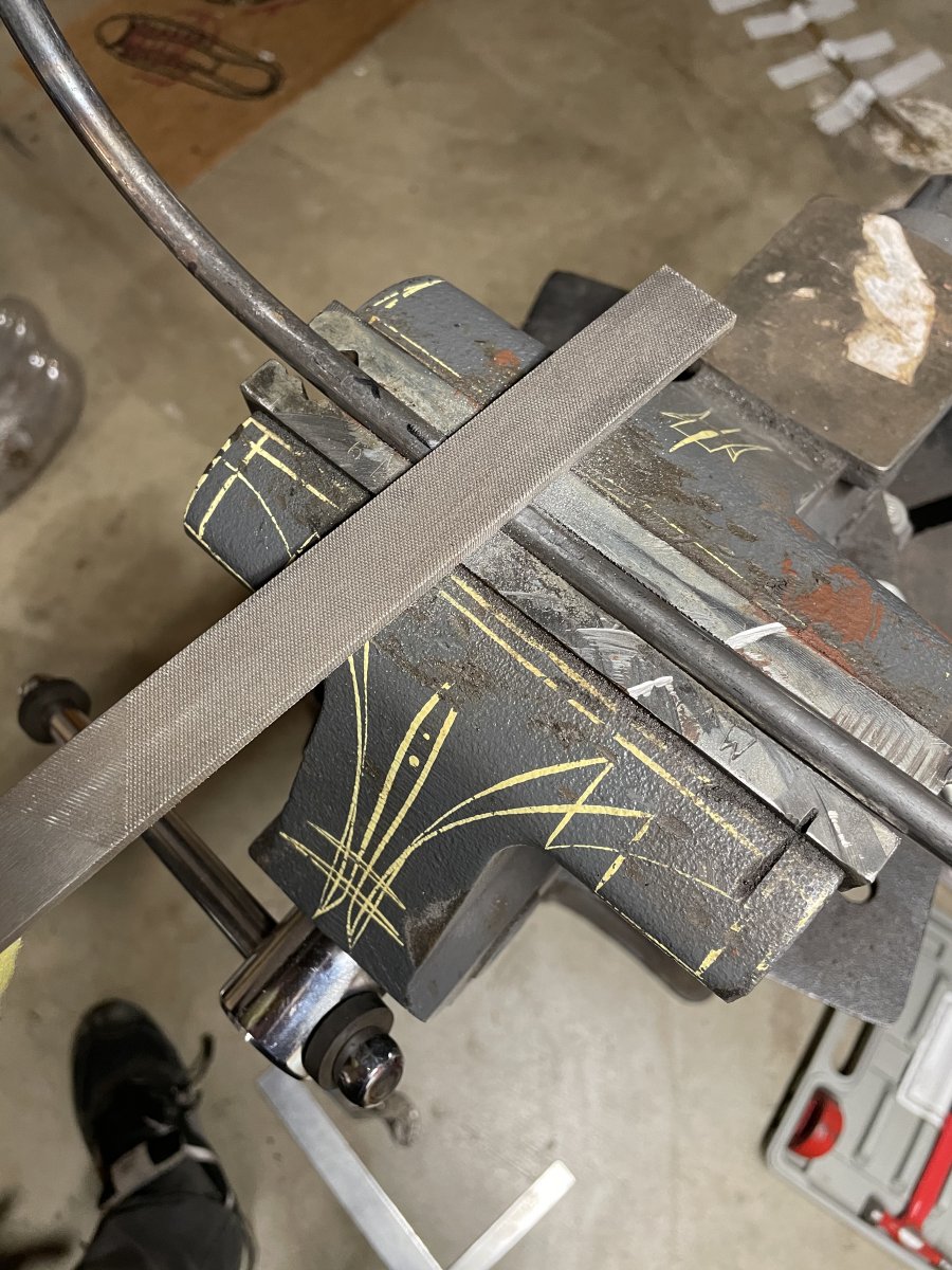

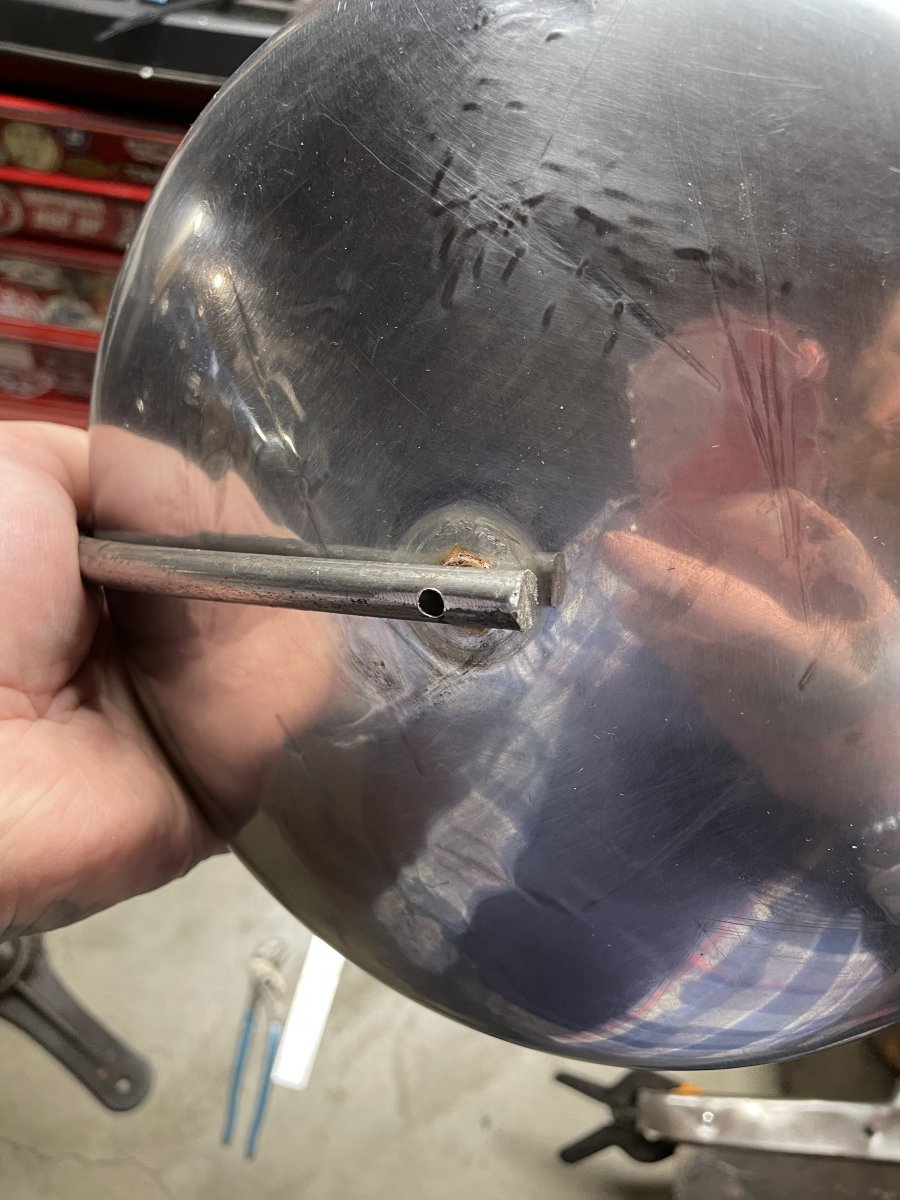

    Well, filed the round stock flat, center punched and drilled the hole for the bottom half to attach. Went surprisingly well

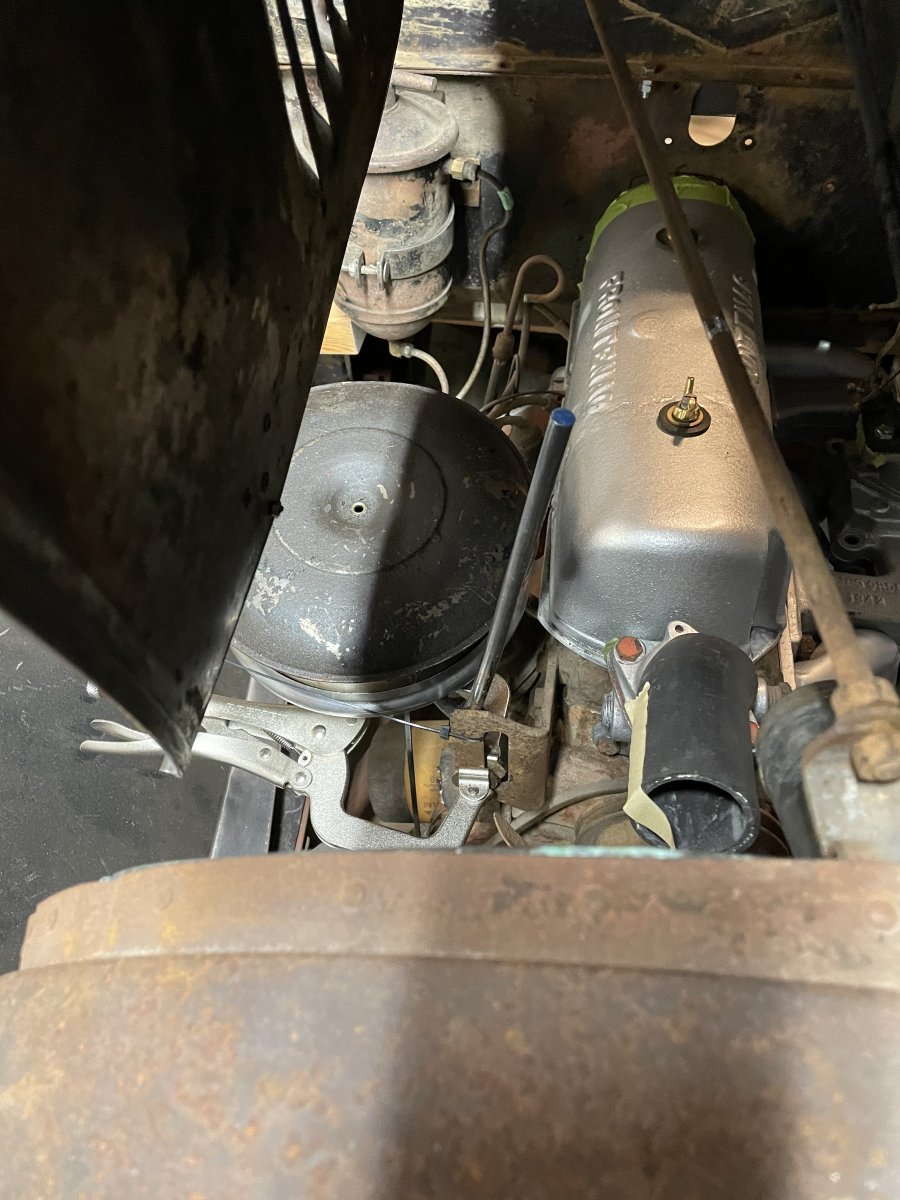

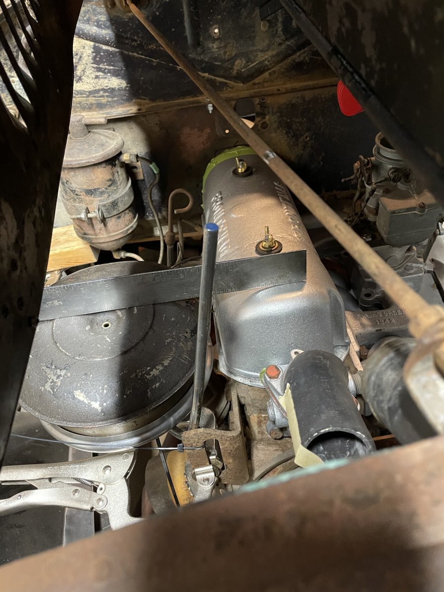

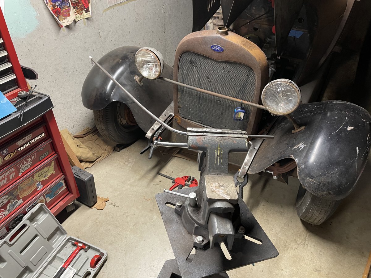

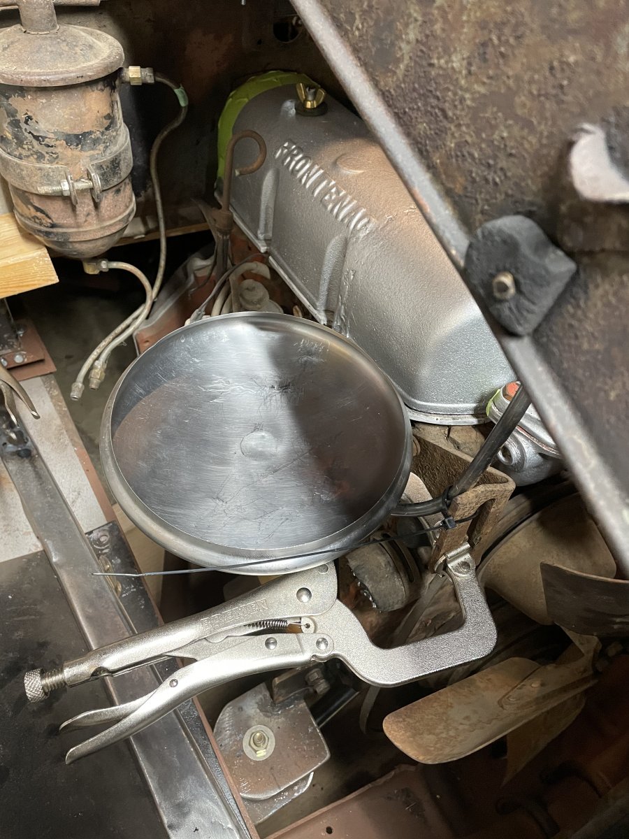

    Mocked it up quick. With it as it sits the top of the filter housing is level with the top of the valve cover and looks like enough clearance for spark plug wires. Once I get this cemented I can build the cross over. 6403D667-CBAC-4DFE-BF3D-5375A453EB57.jpeg 12B90E40-B8B1-44BF-9CA7-1EEA4952FA18.jpeg 192CFECD-715C-4E63-9383-CEEC547A3F49.jpeg 999E7DAC-7089-4110-B450-F4503E3E6EDE.jpeg D6E88795-DB20-405B-AE06-38F6526464FB.jpeg

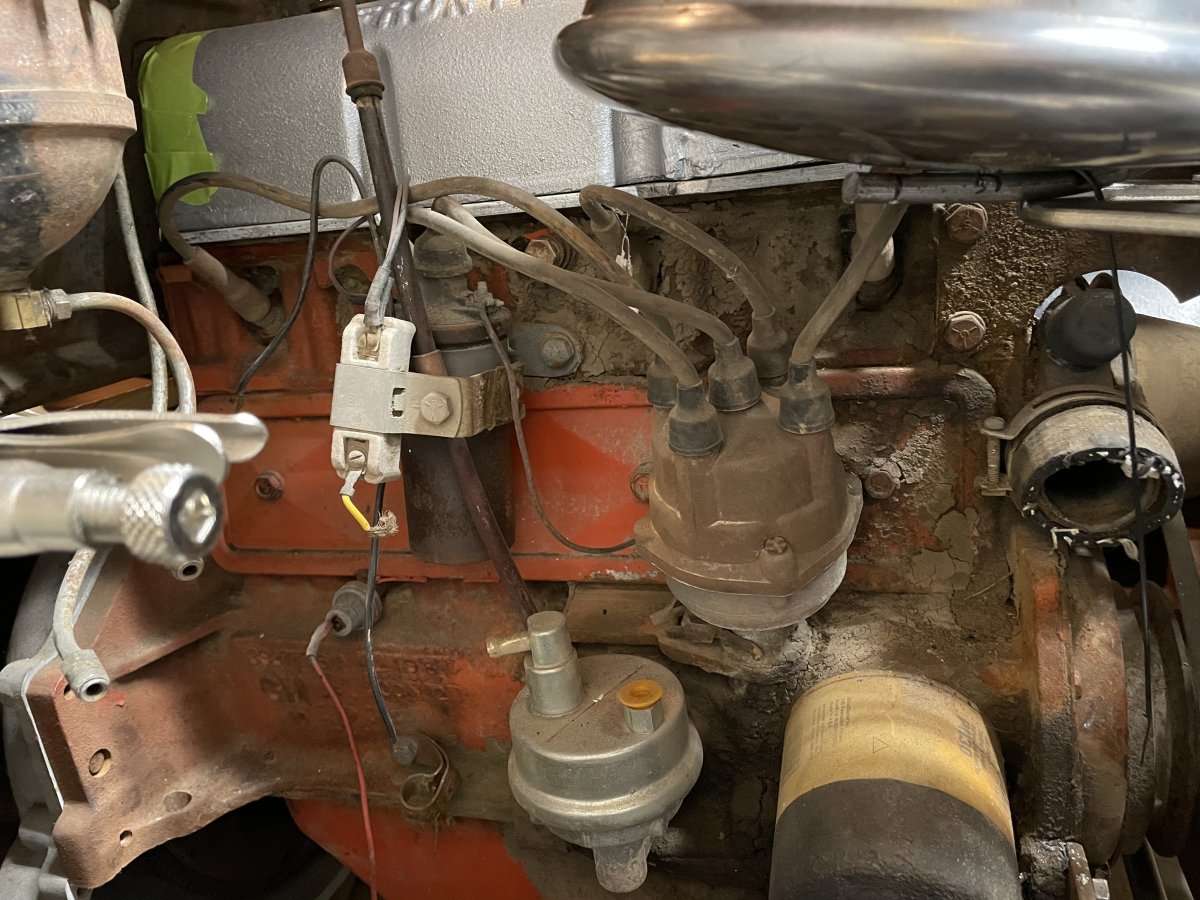

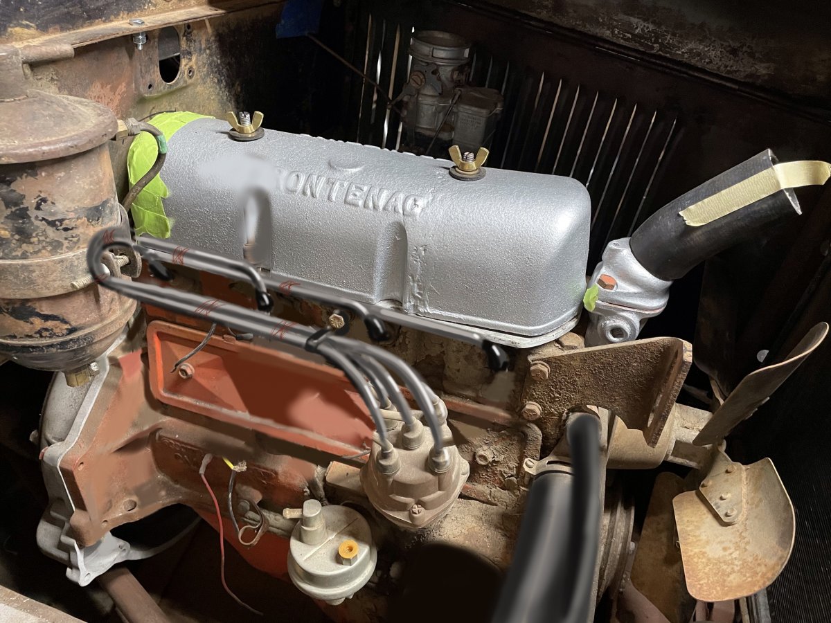

    Playing with spark plug routing. The p***enger side of the engine really needs cleaned up.
    91BF6794-DEC1-43E4-AD0F-FD9FCF57841D.jpeg The air cleaner will cover that bracket, the radiator and the heater hoses pretty good. I’ll also tuck and hide the oil filter lines.
    Moved the coil to under the dash and I’ll cut the dip stick down to damn near a stub since it’s easily accessible I do have a finned aluminum side plate for the motor as well.

    Wonder why go back towards the firewall and then back forwards rather than just one run back and drop each wire off on the way? Asking for a friend...lol

    I need to play with different wire ends. Straight vs 90 deg etc.
    the furthest forward plug is so close to the distributor that a straight boot in the plug like it is now the wire reaches up high and arches back down to the distributor and if I can get that wire down I’ve got more room for the air cleaner that’s gonna kinda float right there.
    does that make since? Though your right if I can get the front plug wire to have a lower profile it is cleaner all coming from the front.
    kind of a mix of function, lack of visual clutter , and it just looking “right” which some times voids those first two haha
