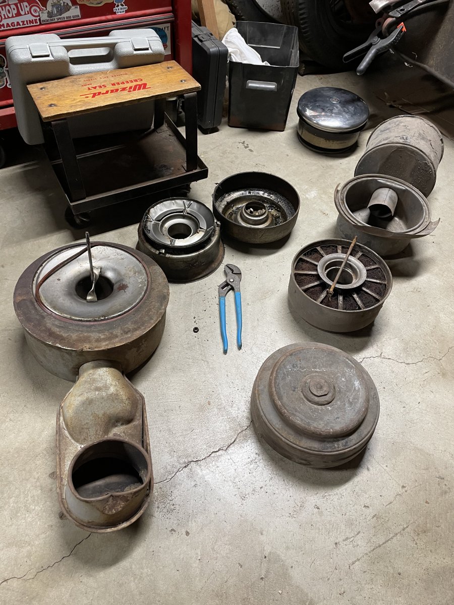

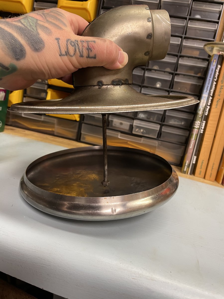

    7CBAF8C4-E90E-4A8B-8A02-FB61A006995A.jpeg Well I tore into it today. The big clunky looking on is the three parts to the left and above the channel locks. The smaller black one is more linear and to the right.
    I noticed the clunker basically had an elbow threw the big space. Didn’t make a lot of since to me but I had an idea and a grinder...

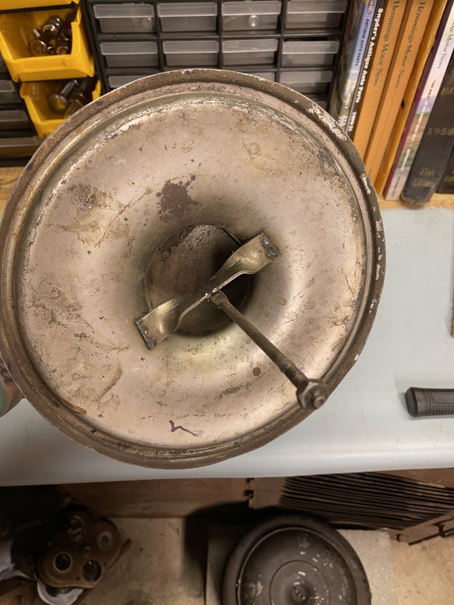

  10. Tim
    Joined: Mar 2, 2001
    Posts: 20,796
    Tim
    from KCMO
    Inside that big pot looking but I found this! 07B3AB5F-001F-44F9-905A-3778C54CC498.jpeg 1E2FEA25-B549-4A39-9886-542D95704C5E.jpeg perfect!
    Ive yet to measure but I’m thinking cut it down to the bead of that inner circle and I’ve got my filter top!
    the little stubs poked out inside the cavity.
    I noticed some gummy oil stuff in there so maybe there’s some Perforation and the tubes were for... **** who knows LOL. Everything g else is in the trash. Normally I’d hang onto every s**** and piece but I’ve got enough random s****s to move around.
    brEad, drdave, loudbang and 1 other person like this.

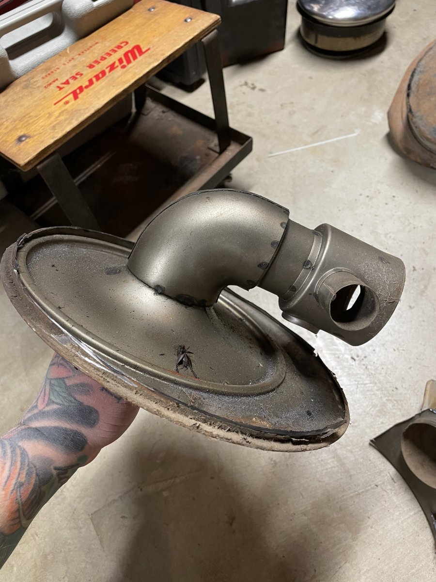

  11. Tim
    Joined: Mar 2, 2001
    Posts: 20,796
    Tim
    from KCMO
    So the second half is taking this cut off from the big clunker (tm) C3488C2C-293D-40D3-A60D-17BA8C3314AE.jpeg and using it to transition this carb hat to round tube. EB3E0CD8-521A-457C-9845-00E9AF9E76F7.jpeg the rubber is pretty shot. Thinking about replacing it with leather or? Any ideas?
    either way this should speed up fabrication and it’s more old parts being used. These actually
    Came off the s**** pile lol

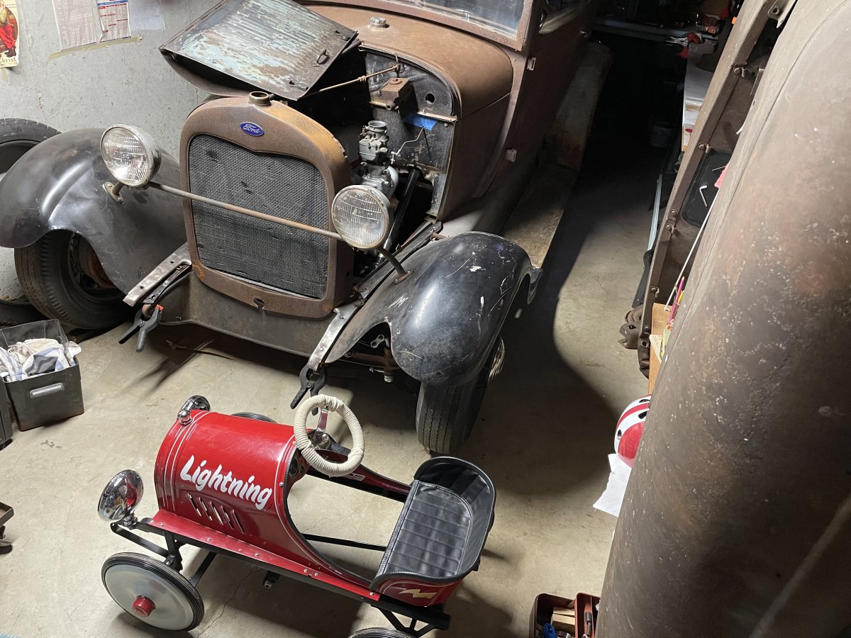

    from KCMO
    Haha, I’m far from the only gear head under this roof :)

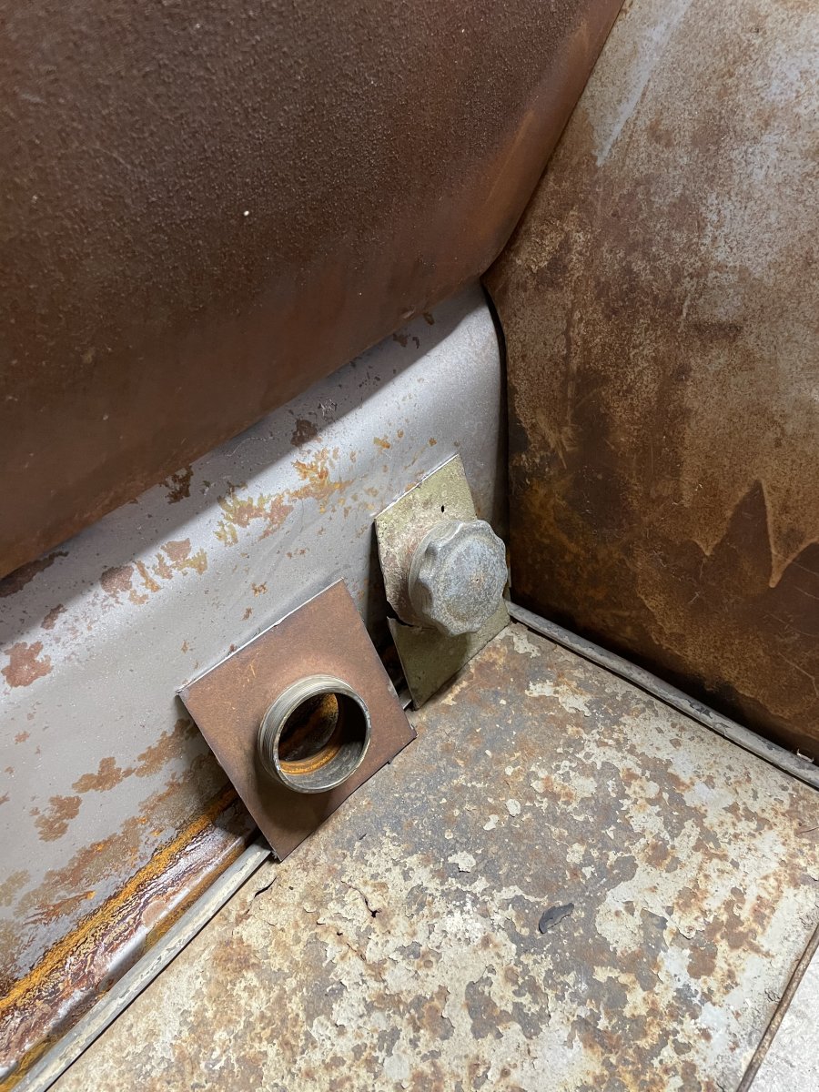

  23. Tim
    Joined: Mar 2, 2001
    Posts: 20,796
    Tim
    from KCMO

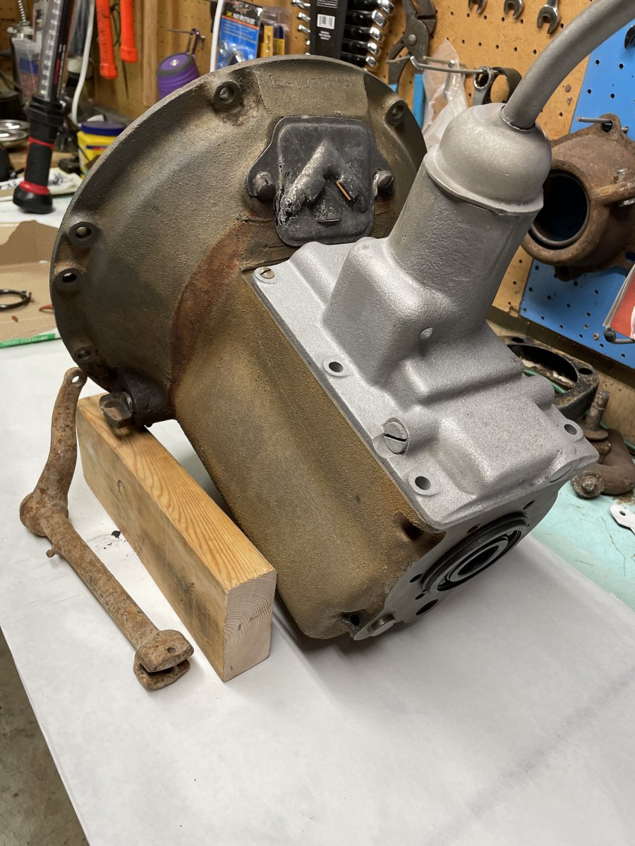

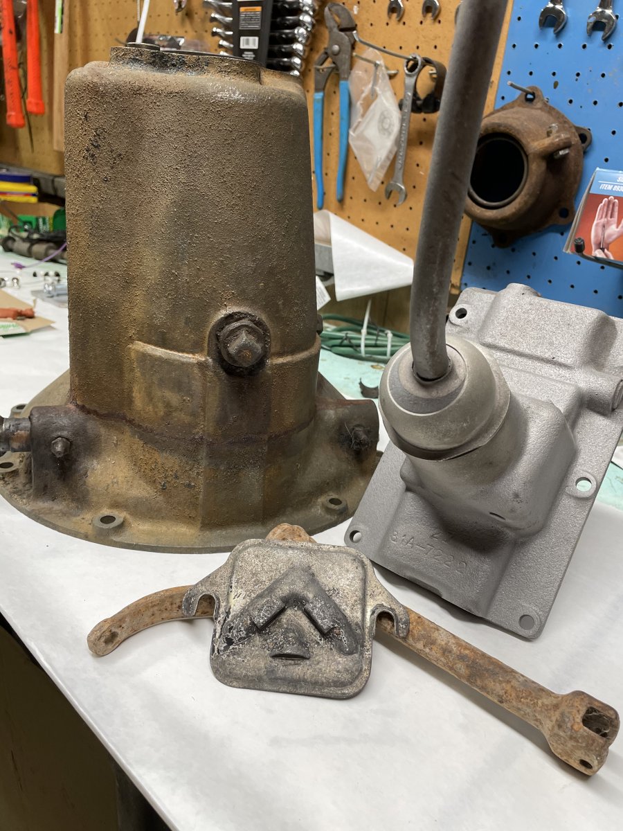

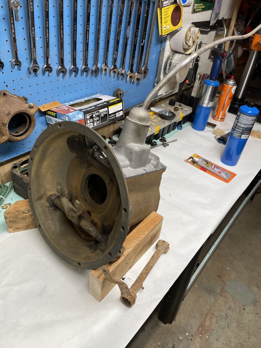

    Alright got a few more parts and mocked up the empty case to stand back and smile at it 34254024-FBF6-4C70-BABA-85CD2C60B97B.jpeg E79C1FA7-23DC-4EF6-9850-BE7F69D90906.jpeg 048C34D6-36FF-4EBB-9A7B-2D734FFEB361.jpeg 39 case and double detent top, 32-4 clutch arm
    For the added length for leverage . Should make the slave cylinder we work easier is the thought.
    5B7EB1B5-05D4-487F-B73B-B7D05B67EA20.jpeg need to fix this little bit up but over all everything is in excellent shape. Need to block
    Up the rear of the engine and pull the 46
    Trans out of the car and start tearing it apart for its guts E5518670-829B-4444-A5C4-0A9A50900EC5.jpeg 76F74358-29B9-42C4-815D-B8883C6D4AF2.jpeg also got a pair of 28/9 fuel necks to add to the aprons to fill the saddle tanks. Never noticed but the slight slant will be perfect for dunking the pump into it.

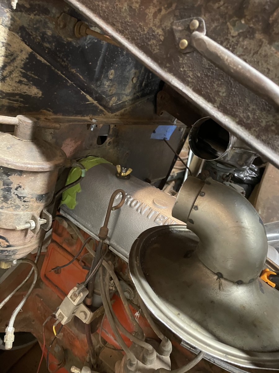

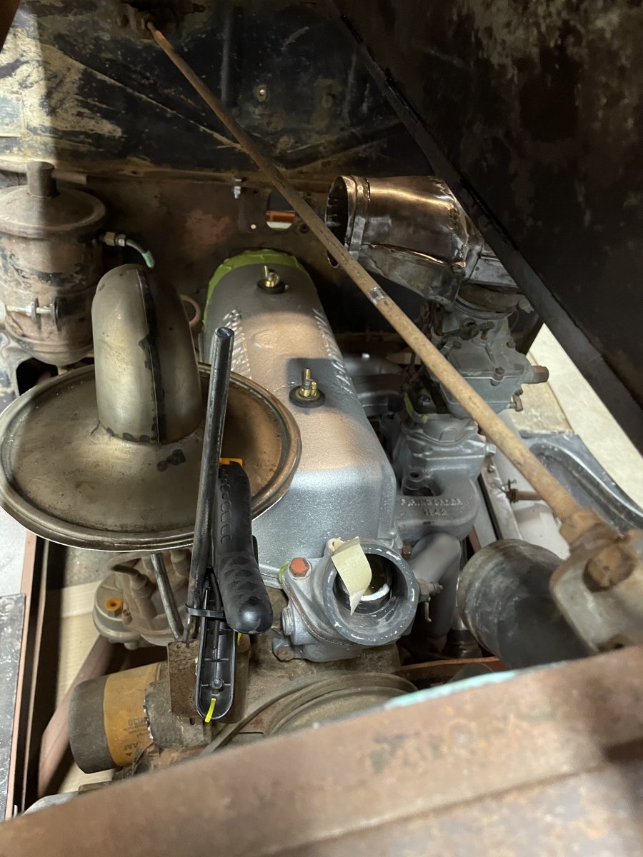

  24. Tim
    Joined: Mar 2, 2001
    Posts: 20,796
    Tim
    from KCMO

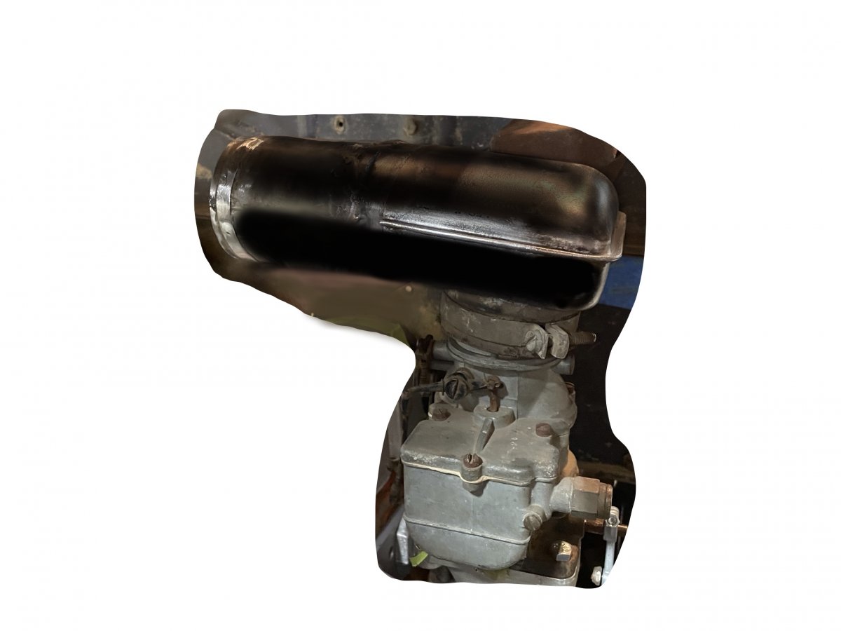

    Well got some parts back to mock up and tweak some more with the air cleaner set up.
    FC9B7DAA-9D5C-4CD2-BD1C-11C2F80A4B05.jpeg Initially it was going to go forward then over. And while it clears the brakes better than this sideways position it looks like a dang space cannon with that 2 3/4 pipe pointing at you. I completely hate it. So I tried it sideways. 813D38DD-42E8-4CA6-952F-95B0E6049395.jpeg CD3B094E-A578-4C76-9734-14B043B5FC7E.jpeg This is just a lose mock up. It will come down further on the carb side and there is room for me to modify it and make it lower yet again.
    1C52CF7E-7907-401B-BEB6-01D7D0258DAA.jpeg The filter side needs trimmed further back and the bracket heated and twisted a little more as well.
    I was hoping to keep that bead and maybe run a filter with a bigger diameter to suit but it’s much bigger than the bottom I wanted to use and I’m not sure it will clear.
    might shop around and see what filters are available in the diameter/ height and make a hammer form for a new bottom half of it will clear the hood side. 3960AE33-EAFC-4A82-9FFD-7BAA4A6E85FD.jpeg 4FA0FF9D-E08C-4F96-9748-8E54F7CDE8B6.jpeg F0B39C47-D3AC-47AE-81D3-6A097721ABB0.jpeg you can see here the size difference
    anyhow I think I’m on the right track. The carb side has got a lot of ugly that needs taken care of but this is a step in the right direction. I’ll dig
    Into this more in coming weeks
    kidcampbell71, brEad, Stogy and 6 others like this.

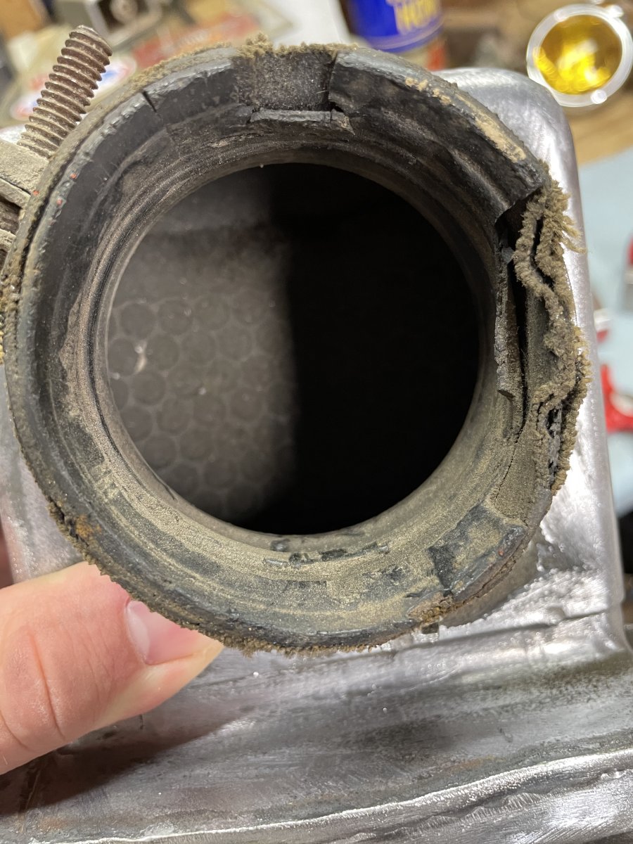

  25. Tim
    Joined: Mar 2, 2001
    Posts: 20,796
    Tim
    from KCMO
    Need to get this out of the carb hat side also, seems like steel wool with copper expanded over it? 8599BD7C-2886-4382-B618-39B4FCFCA4B0.jpeg
    Stogy, Six Ball, loudbang and 2 others like this.

    Yeah I read about these motors being under carbed stock and every “normal” air cleaner choking out a stromberg so knowing the roads this will see. Some of them probably gravel. I knew it had to have a real filter.
    not a lot of room because of the master placement so I had to get creative. With just the hood top on you can’t even see it on the drivers side. But I still wanted it to be something that just felt like it was supposed to be there and possibly something that just kinda fades into the background.
    a lot of mocking stuff up and walking past it 30 times
