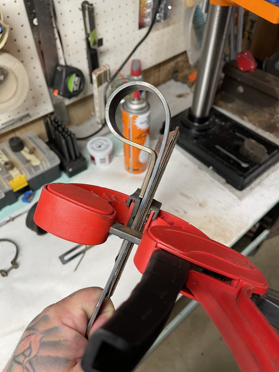

  2. Tim
    Joined: Mar 2, 2001
    Posts: 20,778
    Tim
    from KCMO
    Marked more or less the same spot on both sides for a clamping hole. Because the bends are slightly different the head of the drill couldn’t clear exactly the same spot but it’s close. And it’s just going to be pulling it together so it doesn’t matter if it’s slightly different.
    plan is to buy small carriage bolts and then drill up to size and file the square into the strap. If that seems like to much h***le once I get in there plan B is a low profile ****on head Allen bolt. The head will land behind the plate so I want it to be as low as I can get away with. C02248BF-7CA9-4286-BC06-D9C6437267D8.jpeg shops tight so I had to space it in the vice with a wood block so I could... 5F0AC026-4069-4D55-8C84-ACA2CDA52D5F.jpeg stick the other end threw the window haha

  4. Six Ball
    Joined: Oct 8, 2007
    Posts: 7,054
    Six Ball
    from Nevada
    You can make the hole square by heating the bar and driving something square into the hole. The tapered square shaft of a center punch works well. If it goes part way or even all the way through it it really doesn't matter. You may need someone to hold the other end while you hammer into a slot between the vise jaws.

  5. Tim
    Joined: Mar 2, 2001
    Posts: 20,778
    Tim
    from KCMO
    That’s a good trick!

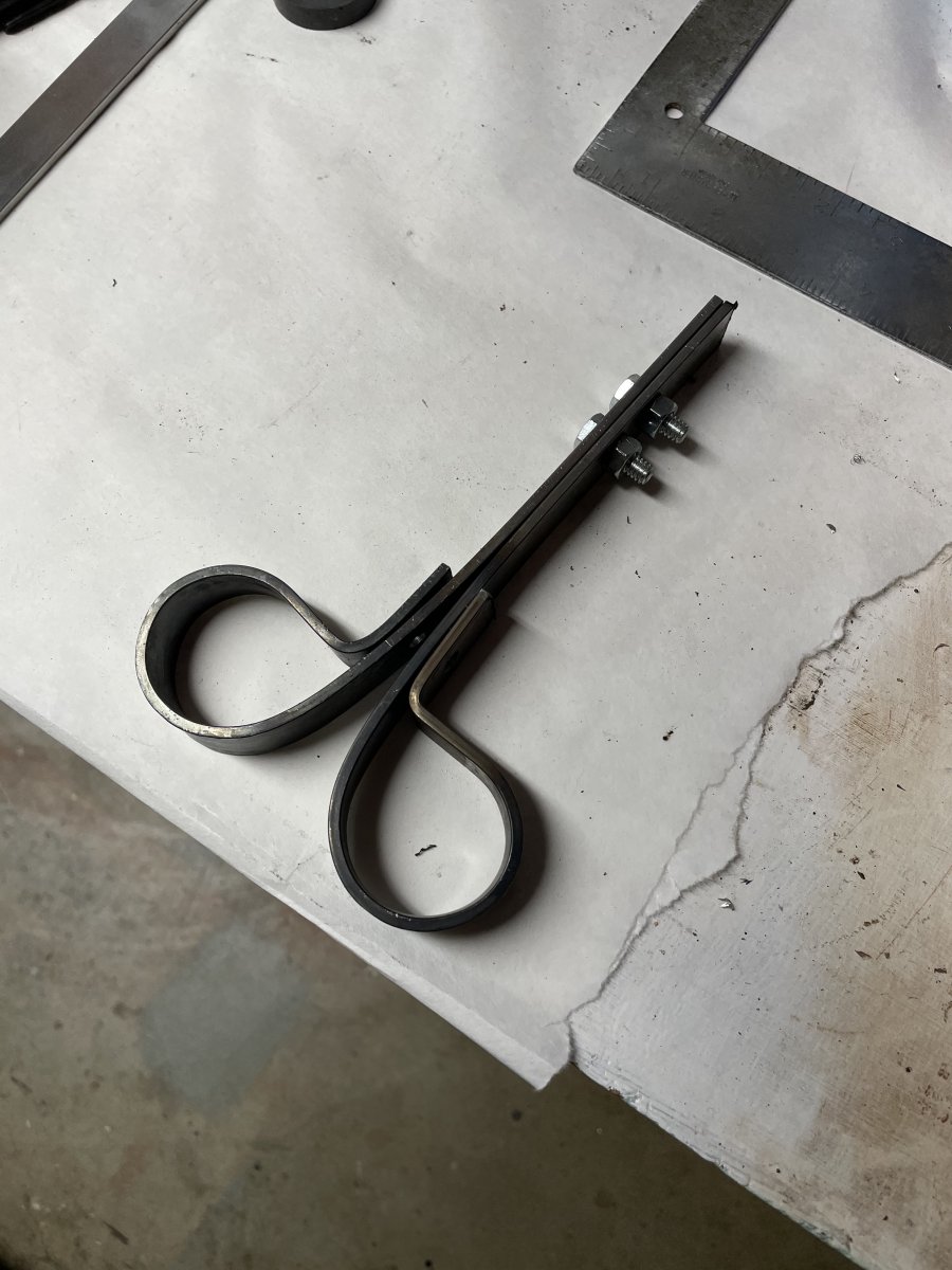

  26. redzula
    Joined: Jul 6, 2011
    Posts: 1,338
    redzula
    Having spent a couple hrs in your chair overthinking with ya. I think I'm the same or similar, but I always just called it thinking outloud.
    Also pic 2 posts above.... I think you might need to sharpen your scissors if you want them to work right.

  27. Tim
    Joined: Mar 2, 2001
    Posts: 20,778
    Tim
    from KCMO
    Haha as soon as I took the photo I thought they looked like scissors

  28. Tim
    Joined: Mar 2, 2001
    Posts: 20,778
    Tim
    from KCMO
    Filled the edges flat and even then rounded the corners. Need to buy the right hardware and paint them and it’s done. 2442E6F6-0B1E-4E1A-A035-5C233F07A0A9.jpeg A6D587F1-0A4E-45A1-9B80-D8B1CFFC2C87.jpeg
