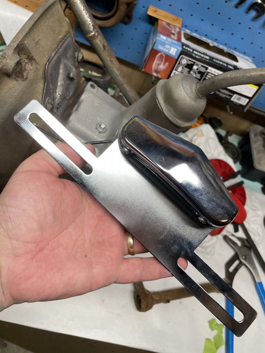

    He tweaks on a license plate light and I spent about 7 minutes on mine...just drilled a hole in the license plate and shoved a dash light in it, swiveled it around to point upward toward the plate....done! Next project... 34atnightingarage.jpg

    Old light vs new light.
    6D2F1C17-01B4-4419-932D-2E3F2B6E147A.jpeg 6C8FF7DA-C27B-46F5-9F8C-6FE3868556E5.jpeg that’s why I went threw the bother to drop it, they are always way closer to the plate in the old photos

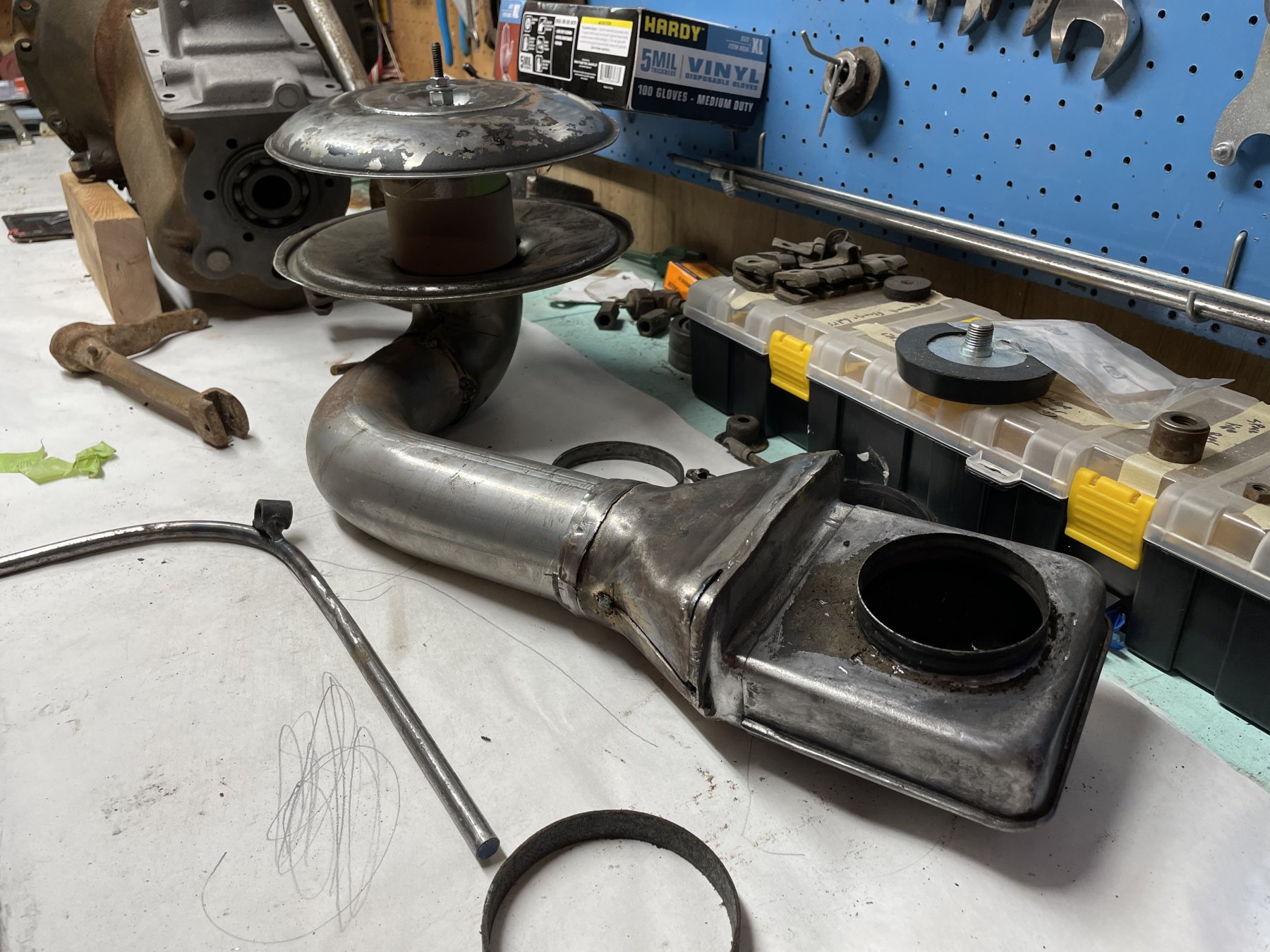

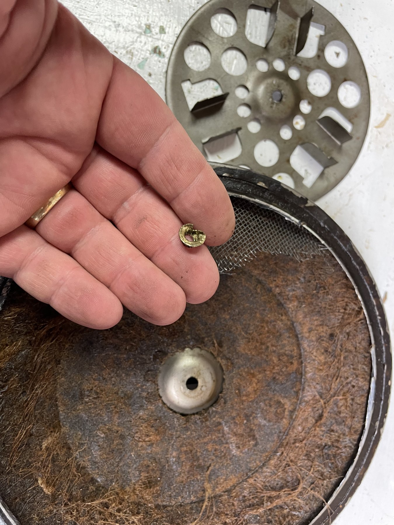

    Snippets of progress E68C049E-9AFC-4C9F-96E0-1612375F6E45.jpeg needed to make the hole in the lid big enough for the stud to p*** threw. Noticed a br*** grommet before I tried to drill it and when I peeled it out it was not only the perfect size but this baffle dropped off. One less layer to rip out! EBB12346-F3B2-45E4-A265-597F178DE1BD.jpeg I also got half of the air cleaner tacked together and the other half marked to weld. Mocking up air cleaner height here with some tape rolls. Buying the actual filter this week before anything gets cemented 072BBEEC-AC28-401B-8C3C-F539C0B26CB1.jpeg in a related note anyone have any idea what this hole is for? @Inked Monkey has the same hole on his chevy 250 in-line 6 but it’s not tapped? Seeing as mine has hardware it must have held something when I got it? Guess I’ll scroll back a million pages and see if I have a photo 14B74E49-E93C-4A90-8882-FCA41075480B.jpeg here’s a shot of it a little clearer. The two lower holes of the triangle mount the coil.
    think I may bolt the air cleaner support to one of those three and ditch the pre existing beefy bracket up front that I had previously bolted a support to E5FD8C43-79B6-4661-A586-531783E9D898.jpeg also I made this super fancy painting jig and painted the license plate brackets.

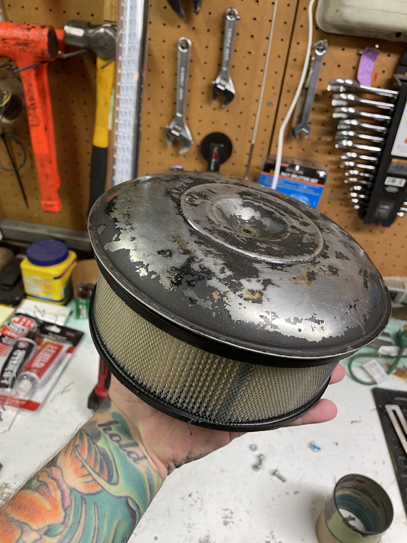

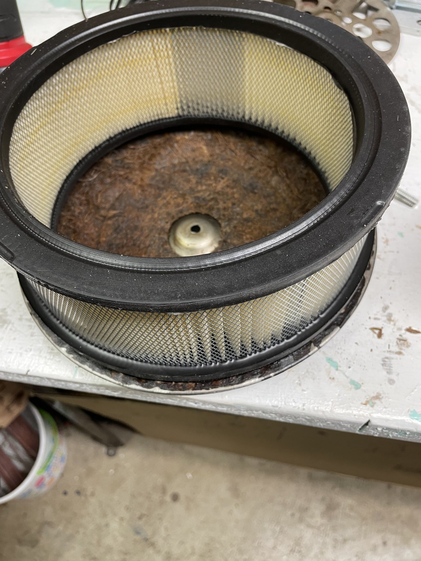

    Filter ***embly should be tacked for final check before final weld in a few days. Grabbed the slant 6 air filter from Napa as well. Going to put the filter in place when I mock up the mounting brackets so it’s as complete as feasible.
    89E43068-5609-457A-9C62-51C082F298E3.jpeg Looks like it should fit perfect 721B782B-B2C8-4852-9F4E-D19F255D2770.jpeg I don’t mind the look of the element either so I don’t think I’ll do any mesh or anything around it for now. C658DB4F-EC10-4680-AF31-00BBAA39C05C.jpeg was wondering about the size listed with a top OD bigger than the bottom. This photo hopefully shows that the filter isnt cone shaped but has two different width rubber flanges/lips top and bottom

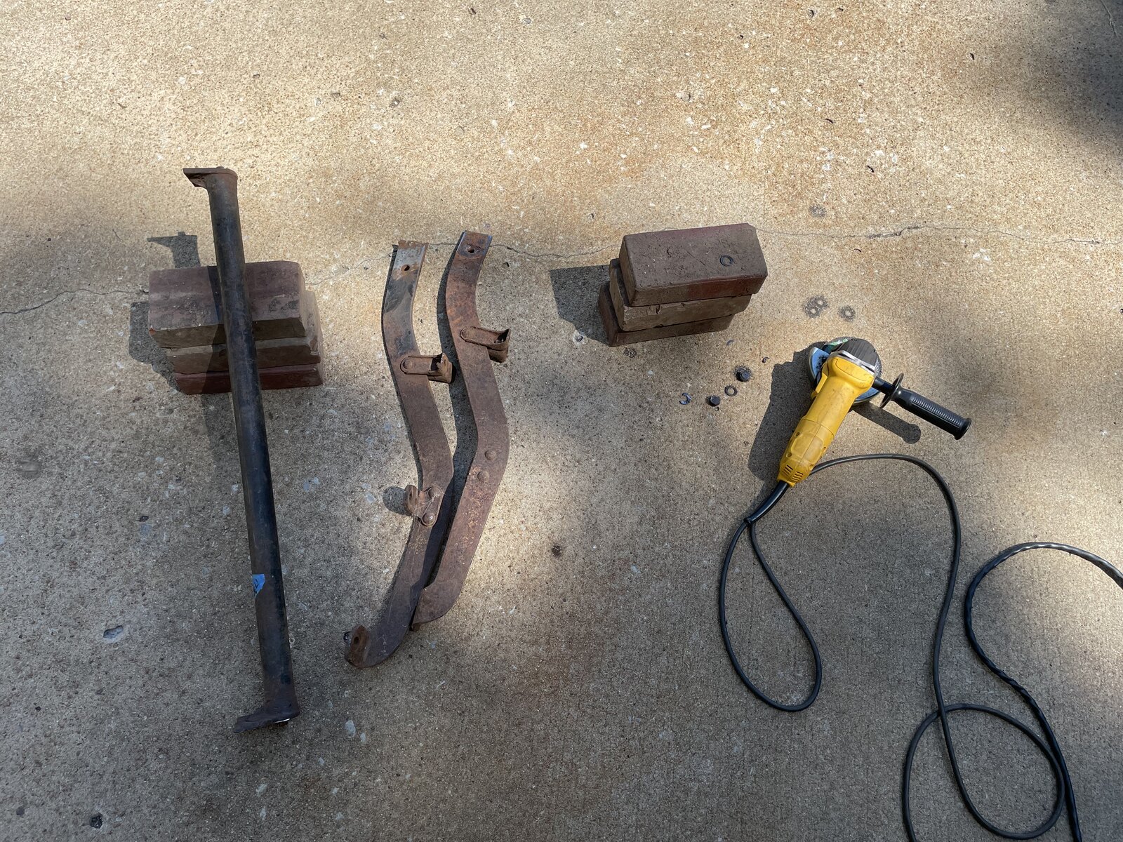

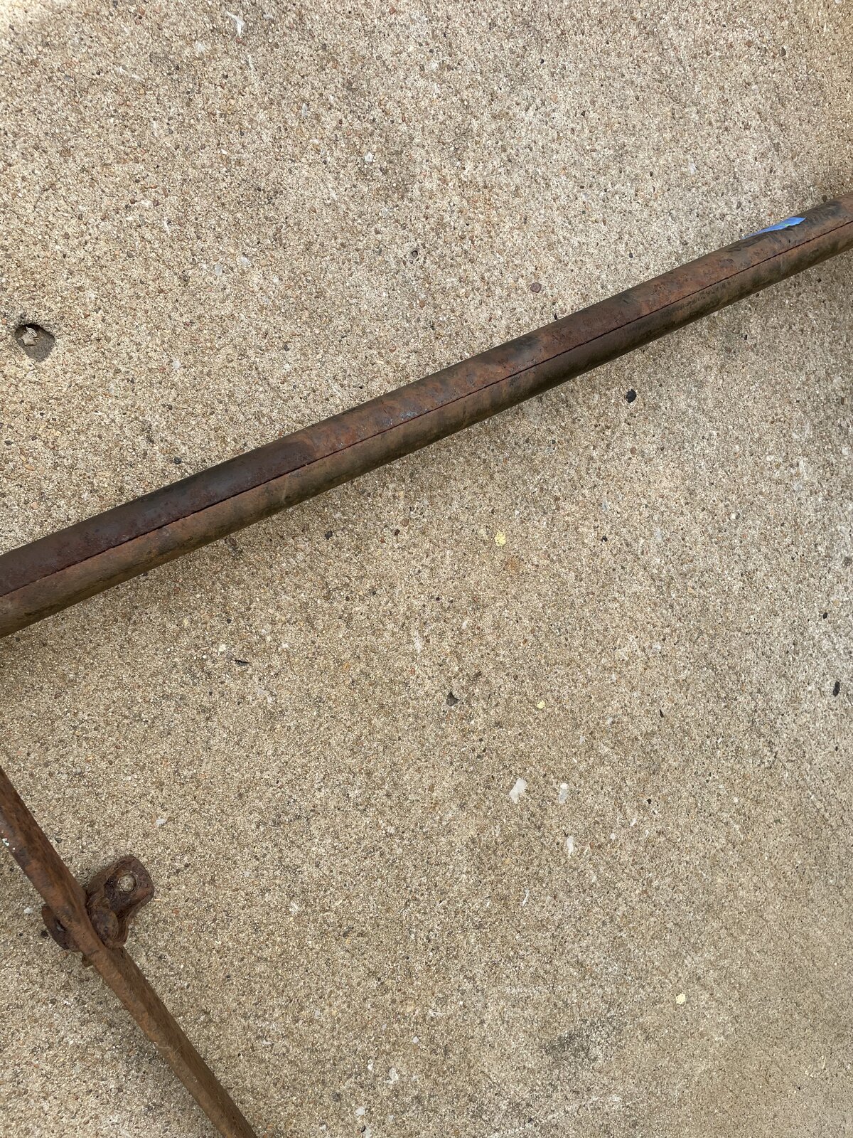

    Cut the end of the bolts off of the spreader bar and cut the weld on the one half. A8D98A54-B49D-4C2A-AAE8-28841EACE95C.jpeg Actually ended up cutting right down the center of the washer on both sides! The metal under the weld seemed fine so I think it’s likely that the ends that loop out and cover the back fenders were cracked off and welded back on and some point and that weld was a reminet of that
    10272588-4E1E-494D-BE1C-AEA414A041DA.jpeg Here you can see the open seem side to side I mentioned previously 5B92516B-9D90-4C20-92E1-BFF54FC32165.jpeg over all everything else looks good. Nothing a flap disc can’t take care of in short order
