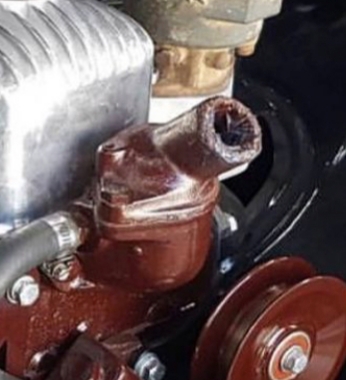

    @nunattax @Stogy i think it’s tape that got painted over.
    Might have a super tight hose or pipe that fits and did t want thick paint making it harder. Just hadn’t pulled it off yet.
    that’s what it seems like to me looking at the shape of the gunk on the inside it looks how I would imagine clear packaging tape would fold?
    maybe they used packaging tape to cover the inlet for time being and someone poked it all in?

    Looking closer you can see an edge around the neck where it stops. I think it was shown in this condition. they may have put some cling wrap over it to keep people from being **** heads and putting something in there

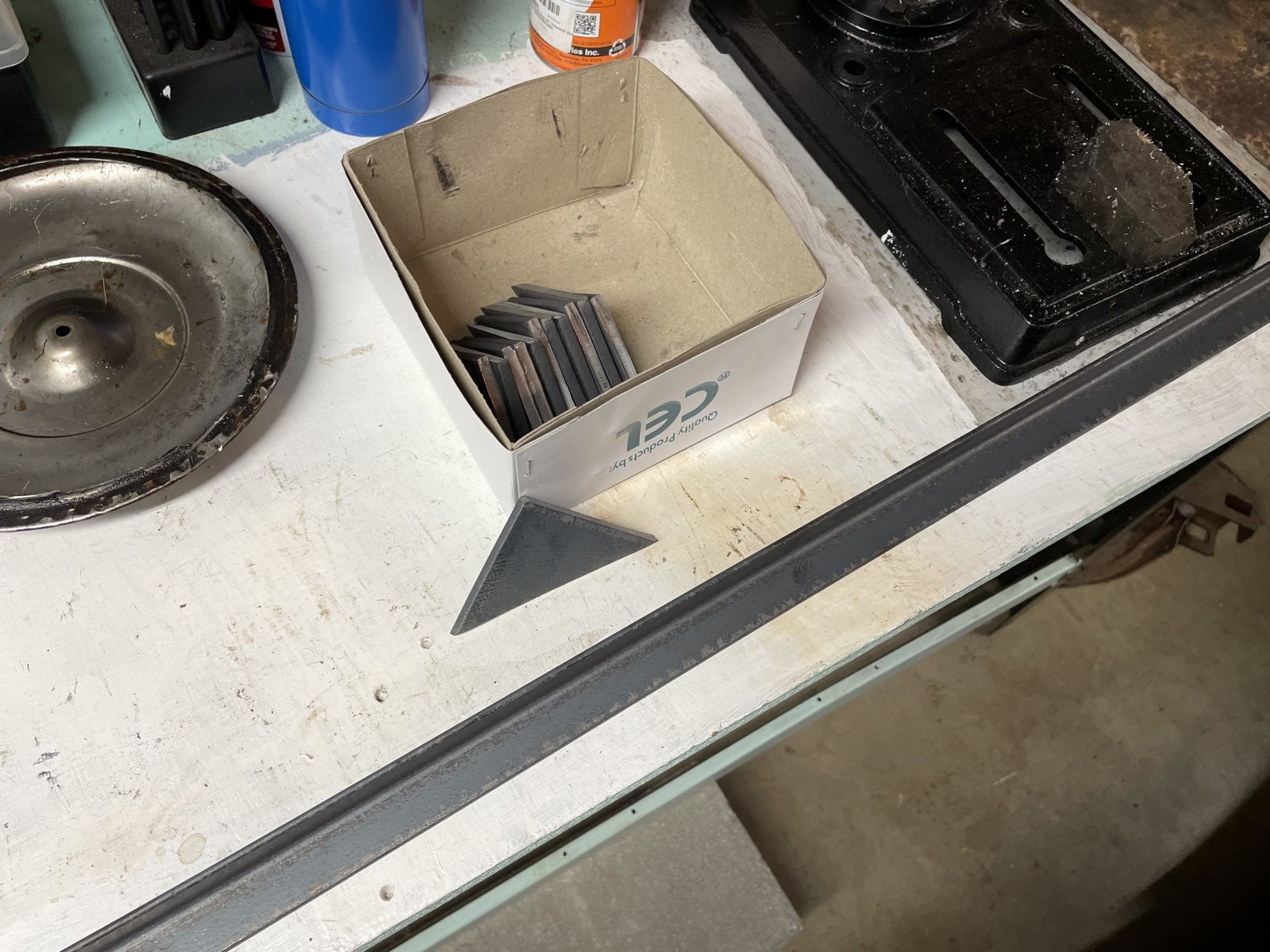

    Had a window in my month to run to the metal supply and grabbed some bits and pieces.
    making progress on getting the 46 back on the road. Taking a huge chunk of September off to work on the A and some other projects so I’m trying to have a game plan and supplies ready to go.
    trying to have the subframe, floor supports, and other body bracing done and welded, and the ch***is done and welded before snow.
    hopefully get everything cleaned and painted so I can re***emble the painted ch***is as I rebuild the last few mechanical things left. Most of this build has been tearing rusty **** apart, scheming and fabricating. As soon as everything is final welded and cleaned its pretty damn close to being a car.

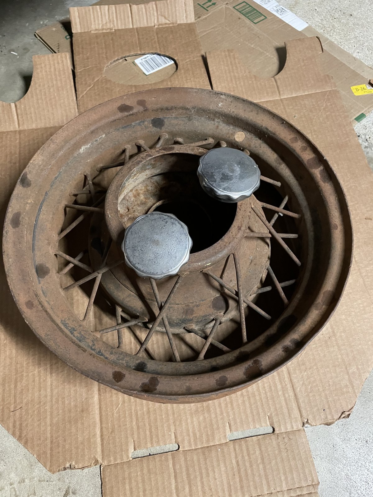

    Oh, bright home some more stuff too. D61D3296-B6B0-4B37-A612-1EEA9B7F1910.jpeg a better 35 wire to clean up and some caps 35A28618-5D1F-4CCC-9131-7CAF50B913B5.jpeg no idea what they are. The center is a stock A cap so you can see they are noticeably bigger and as far as I can tell not vented. 211C75BD-394B-4B15-8838-7C25A72DC934.jpeg roughly 3.25 across from tip of the bump to tip of the opposite bump.
    Any ideas?
    thinking I may use these and utilize the fatter fill hose/tube. With the saddle tanks so close to the cap seems a bigger fill then would back up slower? I’m used to filling the 46 kinds slow so it doesn’t puke everywhere but it would be cool if I didn’t have to with this one.
    contemplating mounting options and angles.
    slightly slanted up like the A sheet metal does. Cars pretty low that might make an easier fill that the cap being pretty vertical? Might not be enough to make a difference
    mount a threaded metal tube in the splash apron for the cap to screw onto and stick the rubber hose to the tank onto the back
    Put a hole in the splash apron with a rubber grommet and let the filler tube with cap p*** threw. I can see this maybe allowing for an easier panel alignment? And could run with out the aprons with out messing with the filler
    @flatout51 suggested mount the cap on the apron but use it only for a p*** threw to one of those gas caps you just shove the filler into/ threw.
    be a minute but there they sit the mystery caps and my brains wandering thinking about them

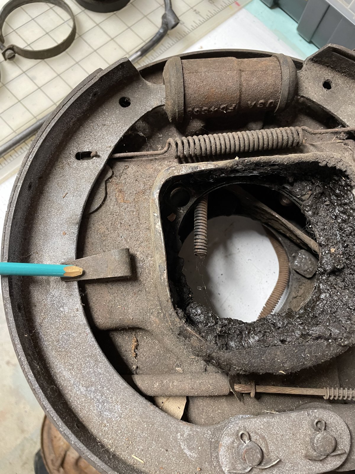

    62653405-D949-4C1D-AF06-1EAF02598114.jpeg 3795E81A-02ED-4E82-B505-5B09DD0B480D.jpeg So far I’ve gone threw the backs and it looks like I’m just missing this clip, which a friend has, and the rest of the posts that the ebrake hangs on
    I’m trying to see if I can buy them by themselves or if they would come in new shoes etc.
    im currently price shopping to see who has what and at what price points. New vs rebuild kits. Etc that sort of stuff.
    I’ll put the front on some jack stands and pull the tires to see what the fronts look like later since they are in the car currently. 8A36AC14-2458-4DAB-9197-DFE41D91D6DE.jpeg just a quick photo I stole from the internet for reference of what’s supposed to be there.

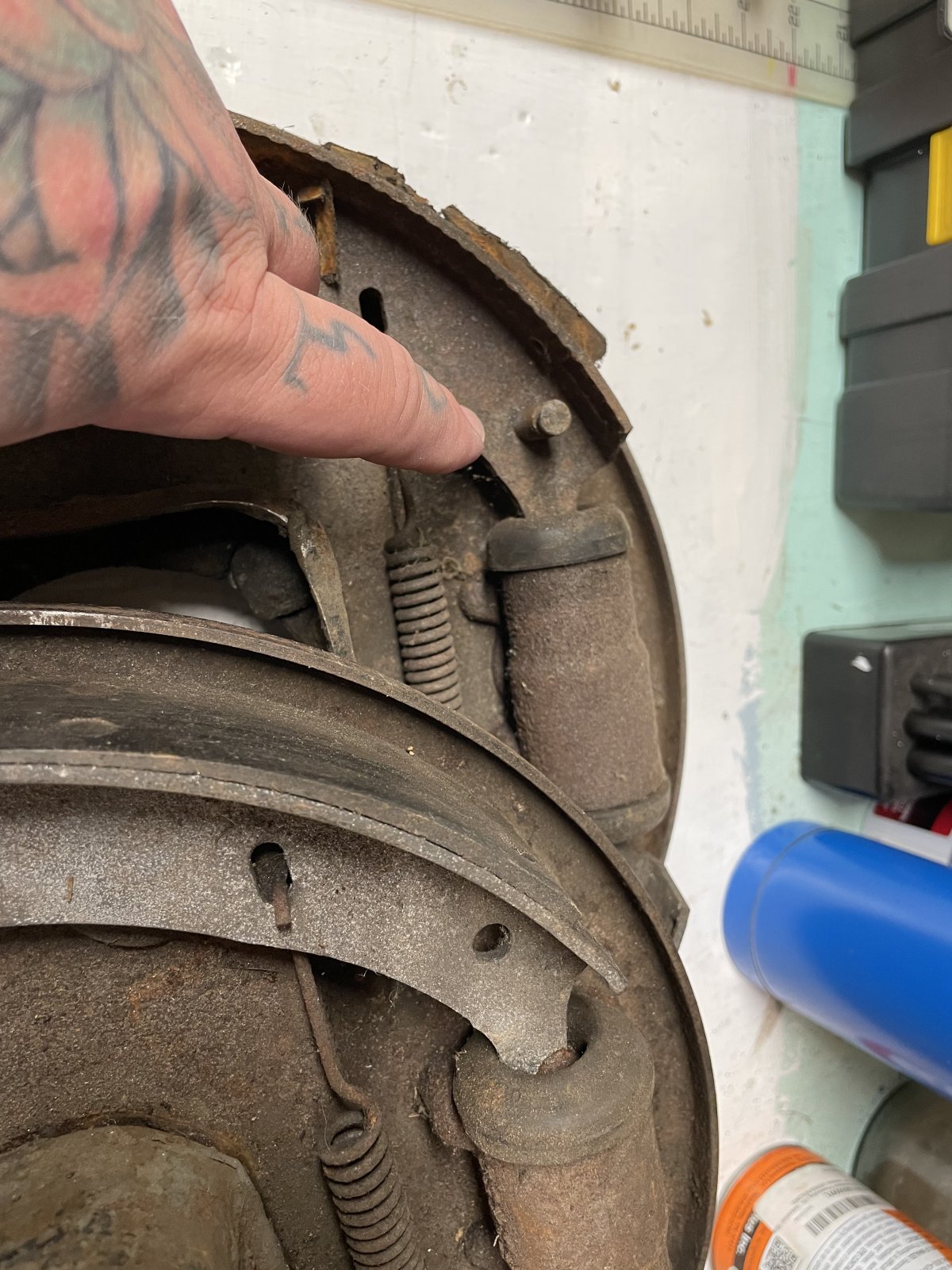

    Edit: but now I can see the top spring isn’t attached correctly and I’m pretty
    Sure that the shorter ebrake lever is supposed to go behind the longer one so I bet this person has the drivers side e brake lever on the p***enger side accidentally
    can anyone confirm? 656EA63F-AFF3-429B-8FB8-59E76A136D67.jpeg and my latest stinky book full of info. Edition 14 1935-51 worth the $2.50 I paid for it for sure. But dang it’s a stinky one, boarderline need a respirator paging threw it lol

    That internet pic of brakes needs the spring to go to the leading shoe (left) and there is another horseshoe clip that secures the E brake crossbar to the pin in the vertical e-brake lever. I think they have it right in that the crossbar goes on top. I seem to remember it only can go one way. Try the other and if it binds you'll know.
    If I remember correctly I robbed some E Brake components off of those backing plates for my 40. Sorry! ;)
    Thor1, loudbang and Tim like this.

    Now that I look at some google images, maybe they do go on the back of the lever. I remember mines were on the front, so I put it back that way and it worked fine, so maybe it is a left on the right and vice versa situation. That was years ago and my memory is getting worse!

    @Dan Hay haha yup it’s missing one clip and 3 of the studs that the e brake arms hang on. If you took them can you confirm
    That they just press into the shoe?
    Buddy has some clips and we’ll dig threw his stash to find some studs I think.
    from a @Dennis Lacy Instagram post I see that I have the 39-42 e brake levers- the ball socket for the e brake cable end is centered where 46-8 is offset an 1/8. The studs they hang off the shoes with are also an 1/8 longer which puts the cable in the exact same spot 39-48. No idea why they wanted the extra 1/8” in between for the second half of the run of production?
    either way I think if I can find 4 short studs the earlier e brake arms should work just fine on the later brake.
    really it would probably work fine with the later studs I can’t imagine 1/8” is going to make a huge difference pulling a cable

    My studs for the e brake weren't pressed in, they just fell out on dis***embly. Are they supposed to be pressed it? Possibly, but the clips hold them in and they were functional.

    @Dan Hay I guess I didn’t mean pressed with a press. I guess push in would have been a better wording.
    since I only have one stud it’s hard to figure out where things were. I see in the later studs there’s supposed to be a sprung washer but that’s about it. Is the clip your talking about on top of the ebrake arm? I’ll have to crack some old books tonight and see if I can find better diagrams
    Than I’ve found so far

    It was on top on mine, but maybe mine were on the wrong sides. Either way, front or back there should be a retaining clip.
