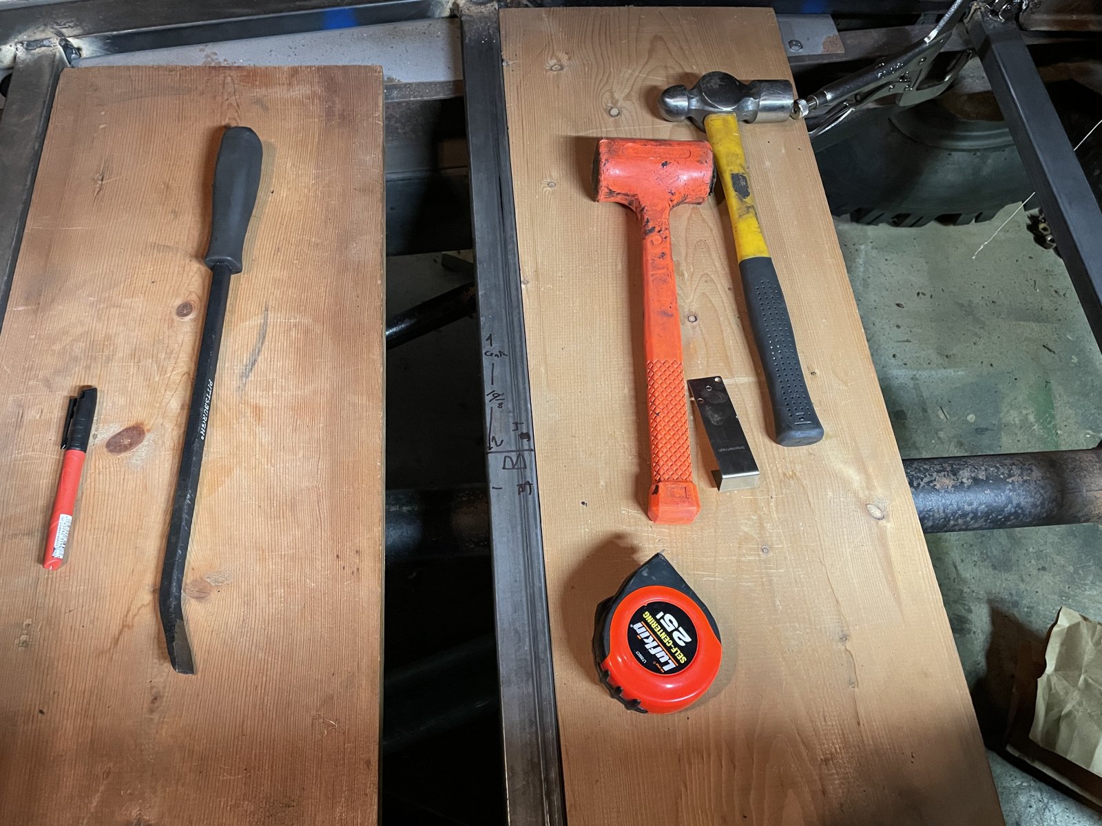

    brEad, Stogy, Thor1 and 3 others like this.
  4. Six Ball
    Joined: Oct 8, 2007
    Posts: 7,054
    Six Ball
    from Nevada
    That looks like a stock Ford ignition tool set. :rolleyes:
    brEad, Stogy, loudbang and 3 others like this.

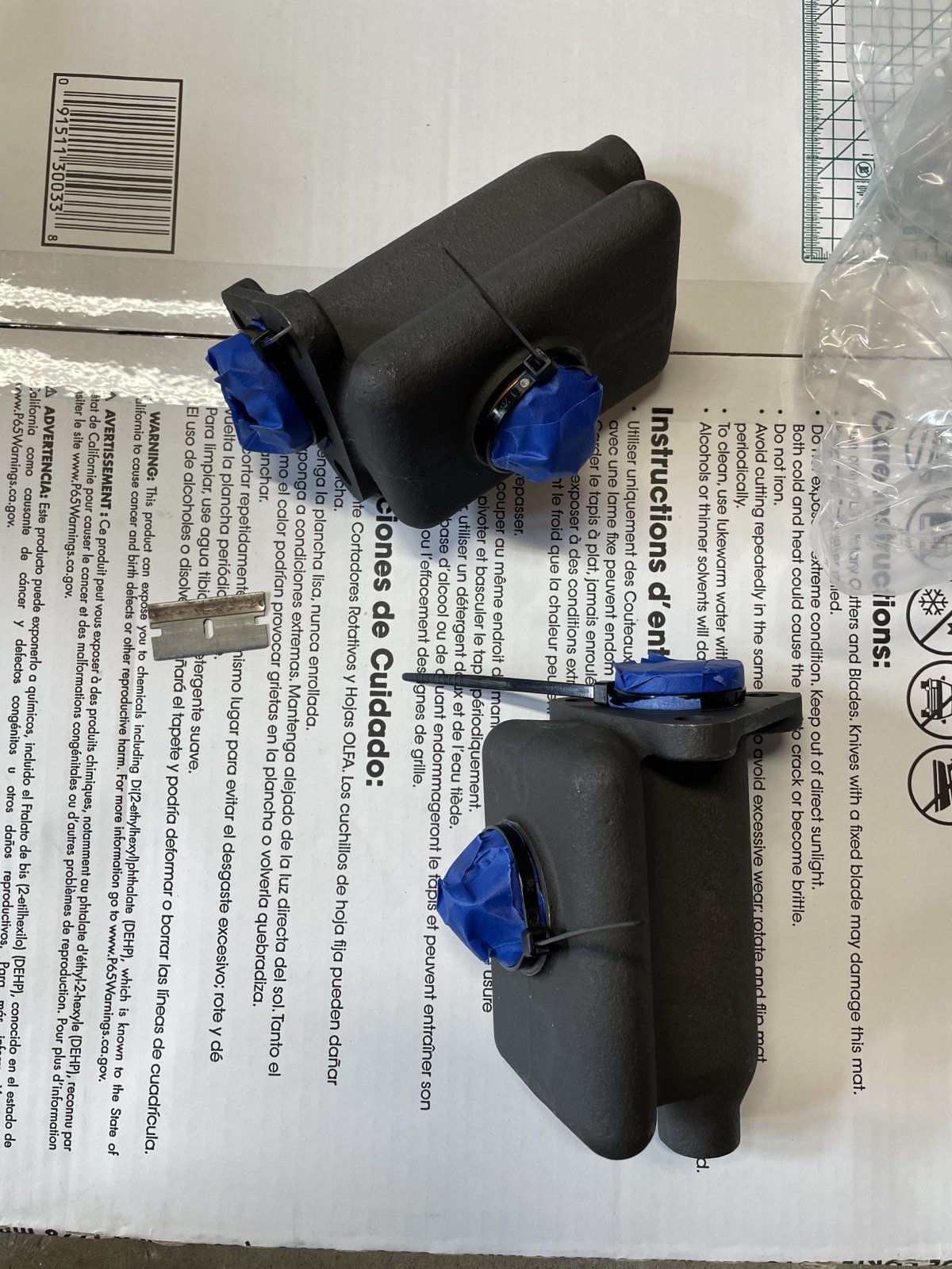

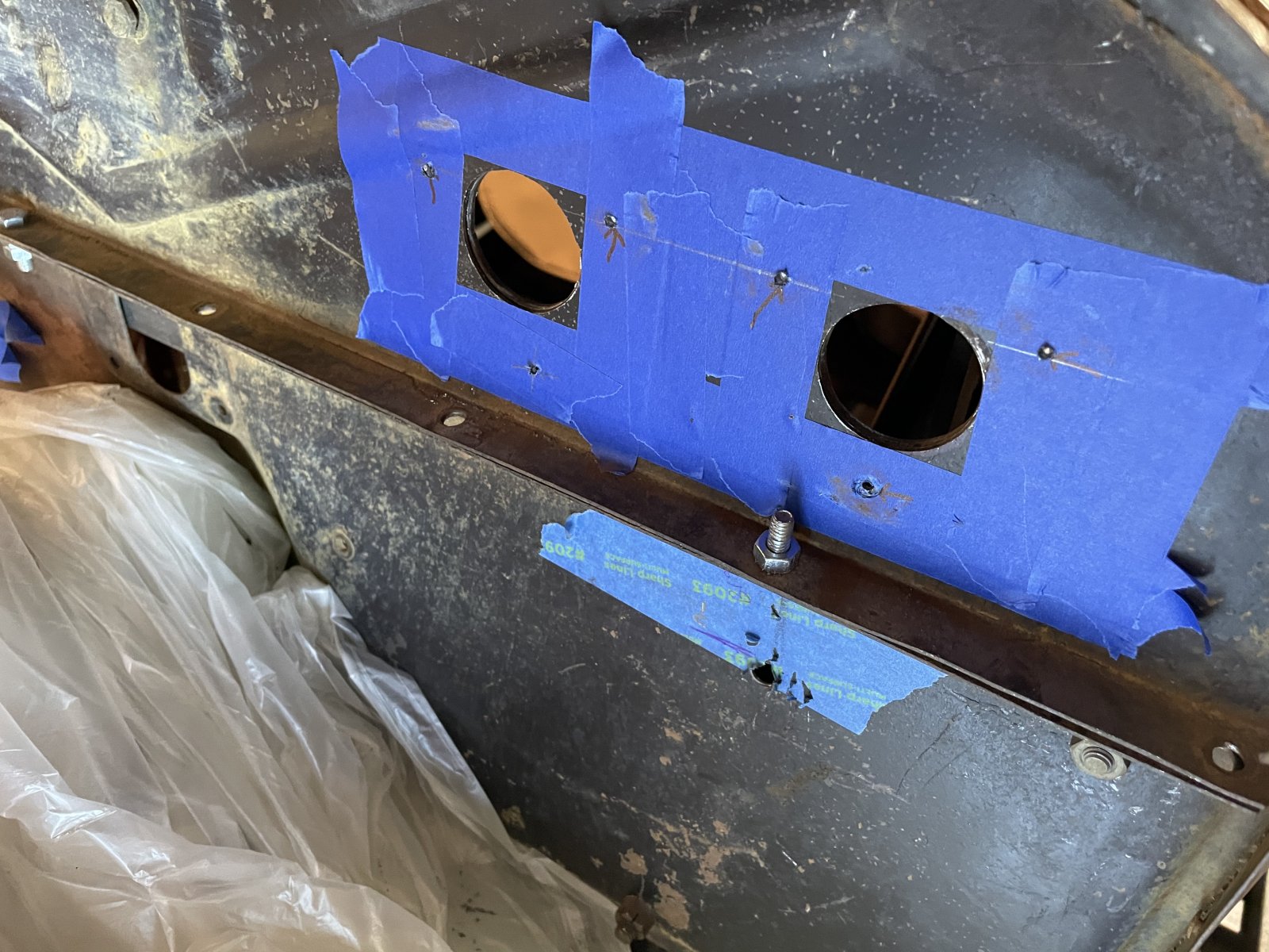

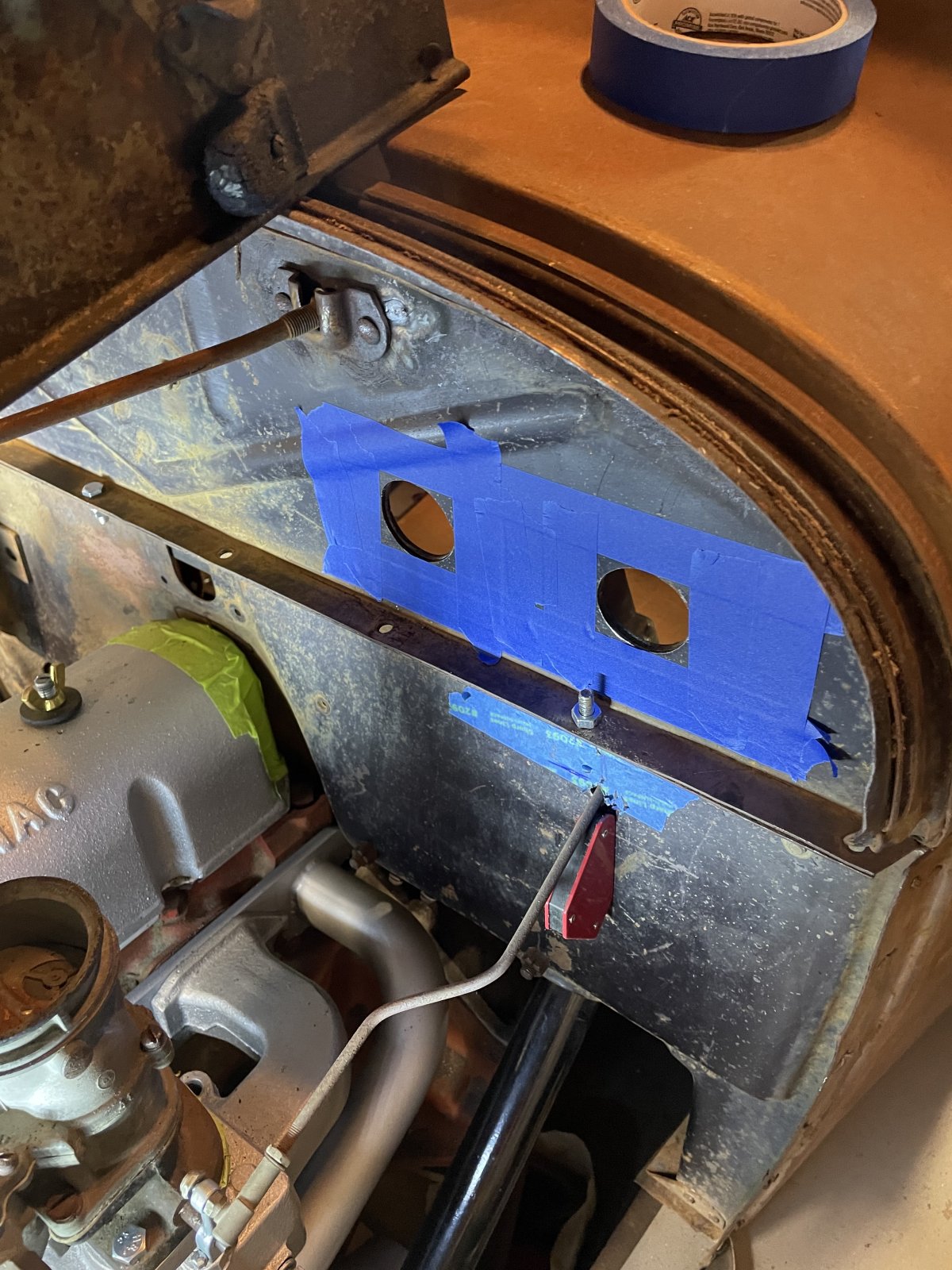

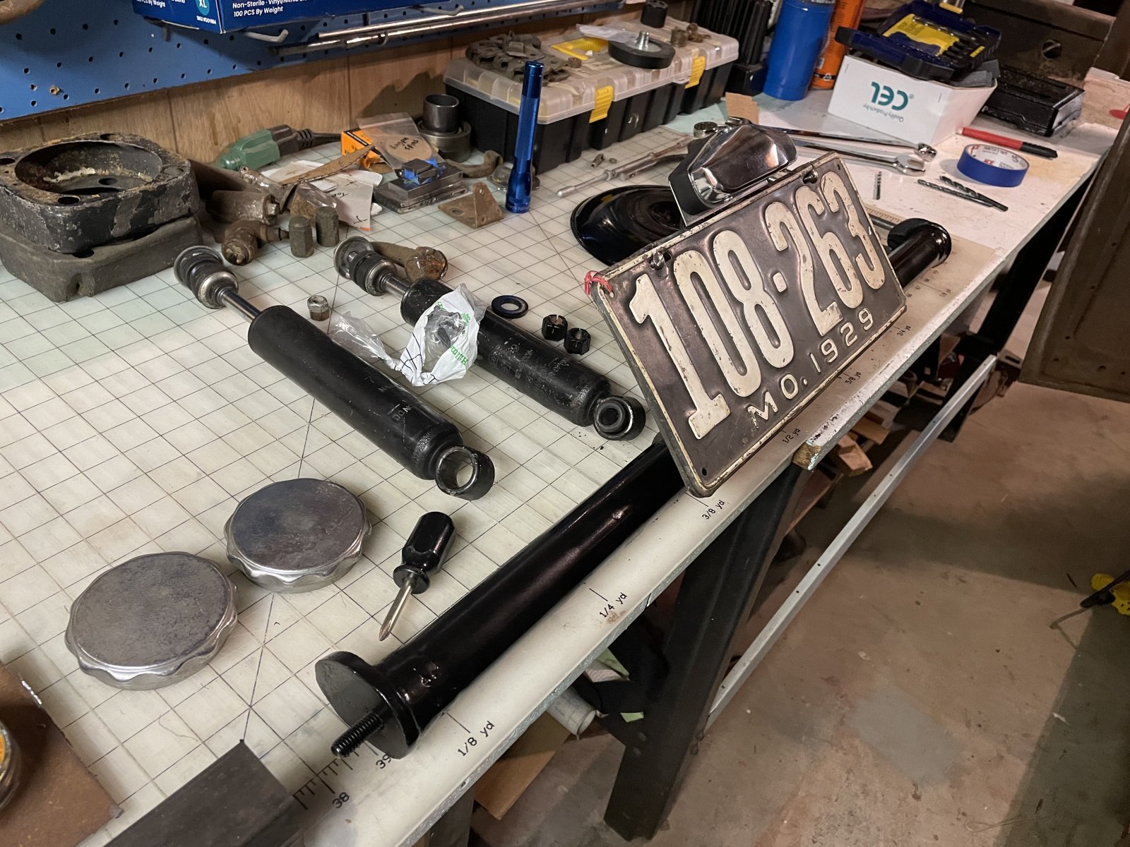

    Well I was going to wait for my two weeks to be over to post an over view of what got done but life kinda ramped up. So for the moment I figured I’d do a photo dump and get some of the stuff up to speed.

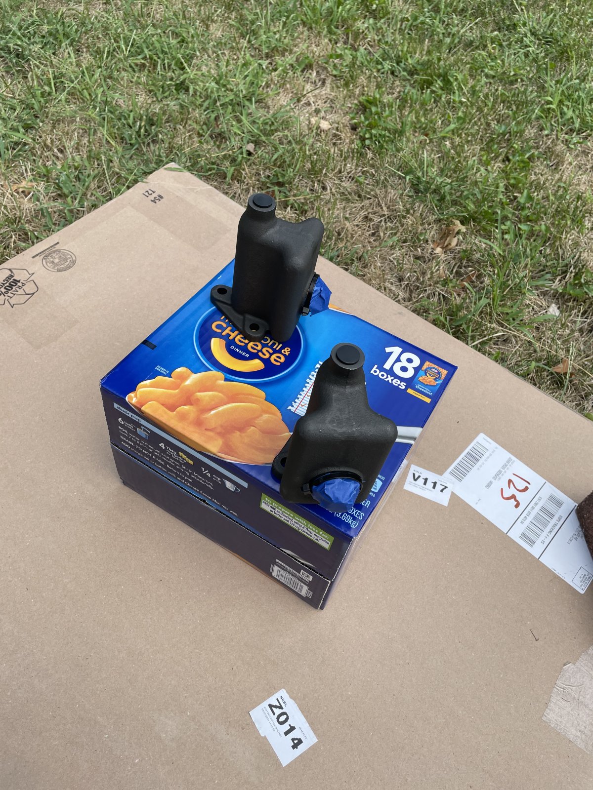

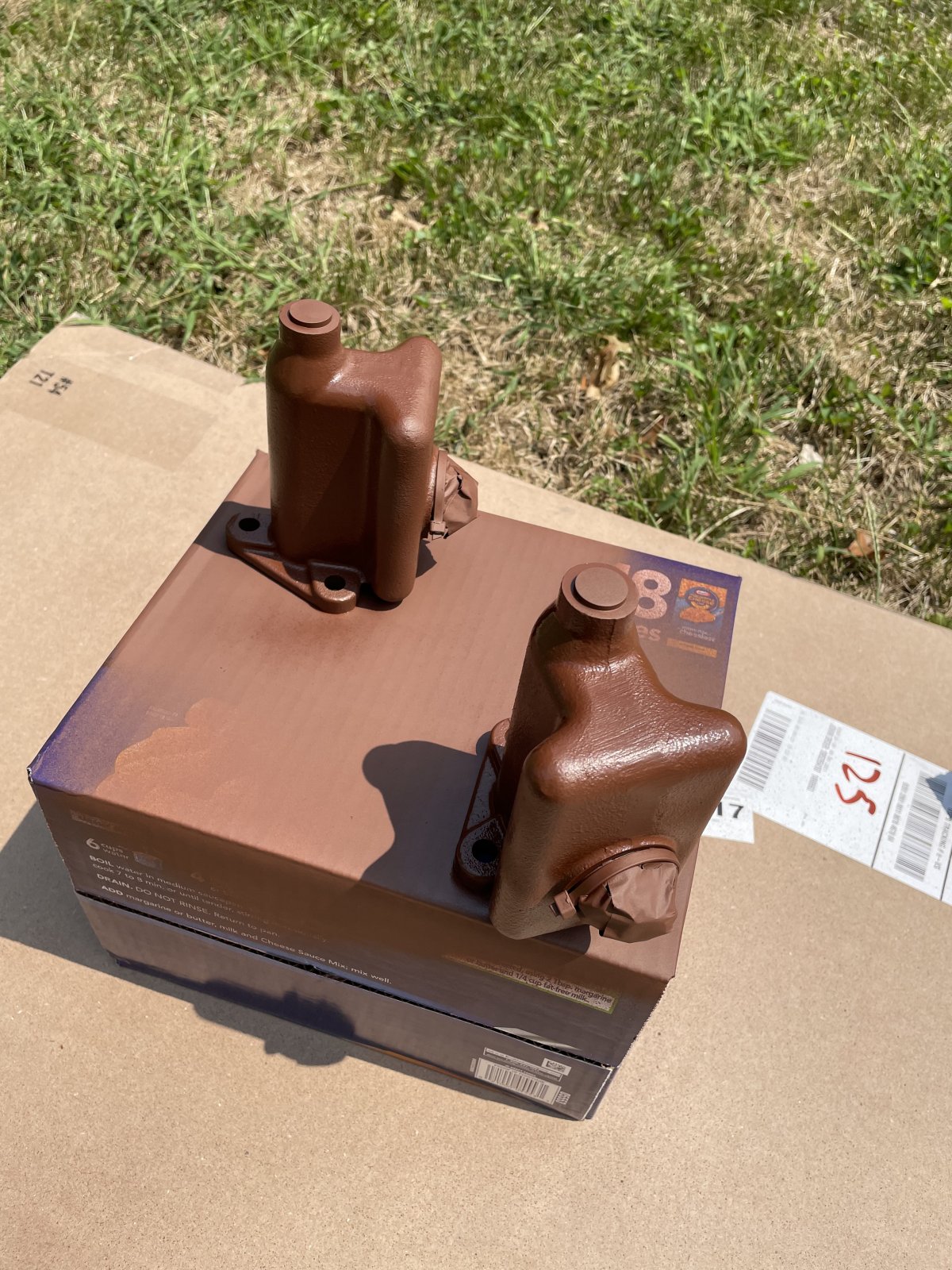

    One of the first things done I get my new master cylinders taped and painted and the holes to mount them drilled.

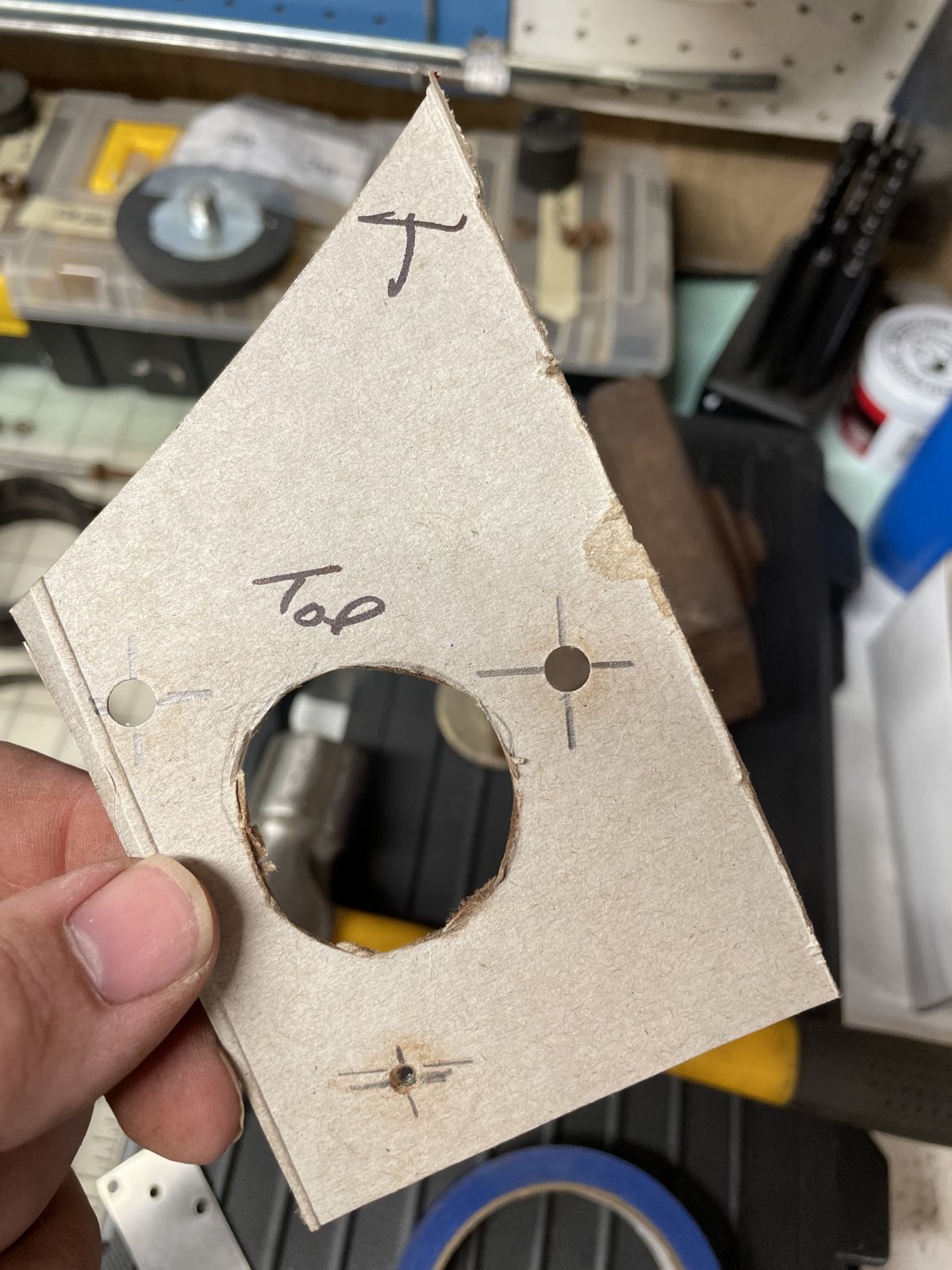

    well as much as I could, a few holes go into the plate behind the firewall where an existing hole doesn’t exist so I drilled threw the firewall and into the plate enough to be an easy spot to find when it lands in the drill press
    minuses centering lunches but where it wasn’t going to work with only two hands I made a cereal box template and used that B4CCF40E-5606-4D23-A2DC-AFD322B438C7.jpeg F3442768-861D-48E5-801B-D592B74612AC.jpeg B2E92E5E-6DFE-4DD8-B9E2-B1967AB5B5B3.jpeg 3E5E4D5D-4C2D-436E-847A-5EF3759272F5.jpeg E6A9D283-F025-474E-97C8-C2A740E0F7B7.jpeg DEBB8CE3-3F0A-4547-814D-DD8FFEEAF73F.jpeg F6D7F6DB-09A1-433B-BC61-B22573BA607A.jpeg 8E0B4400-BCAC-4BB4-8D9B-D6BBC1D58E30.jpeg

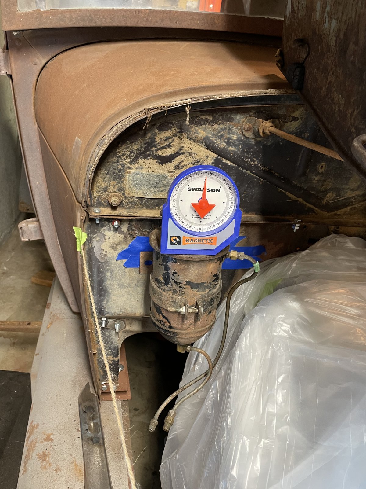

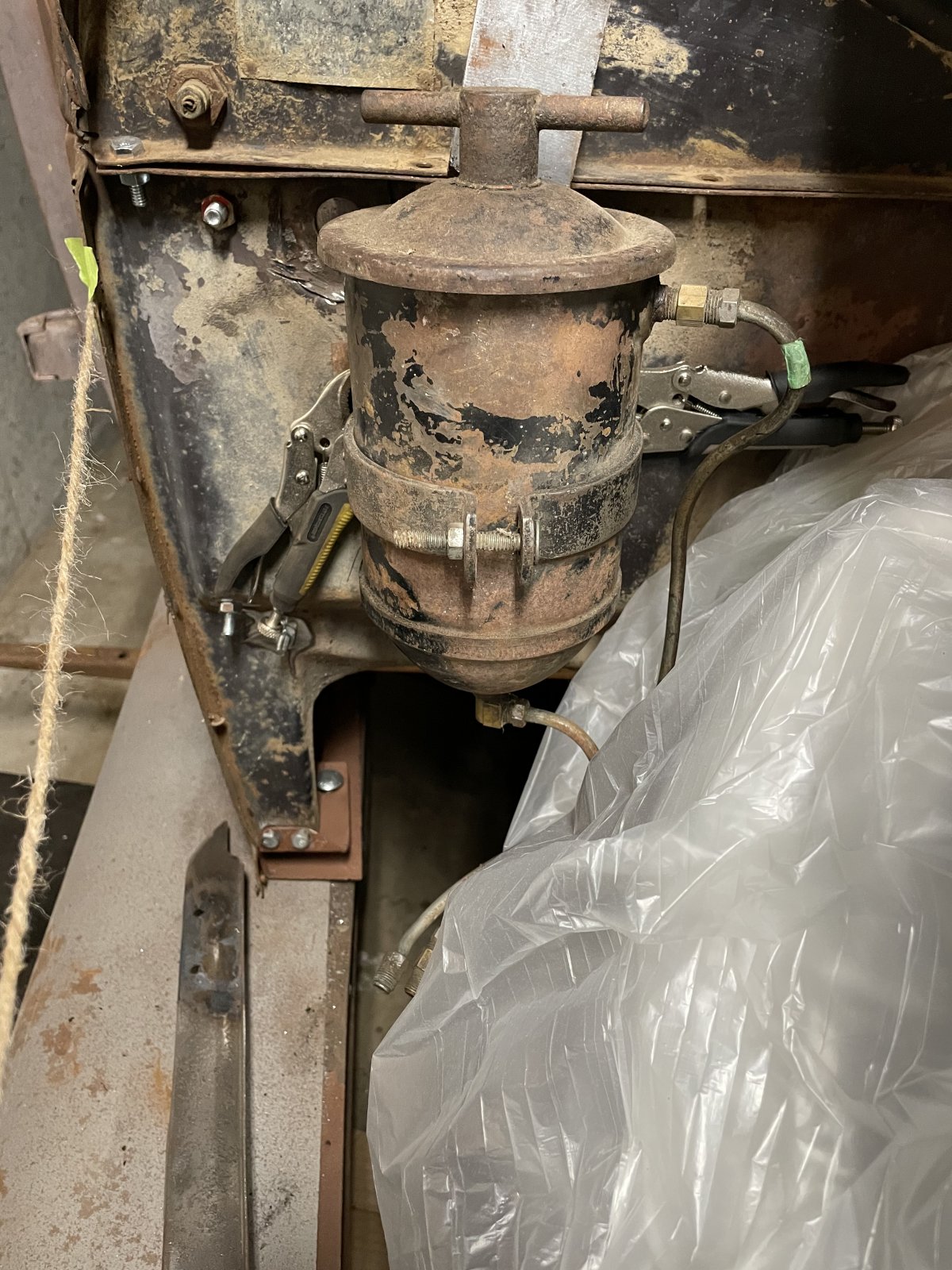

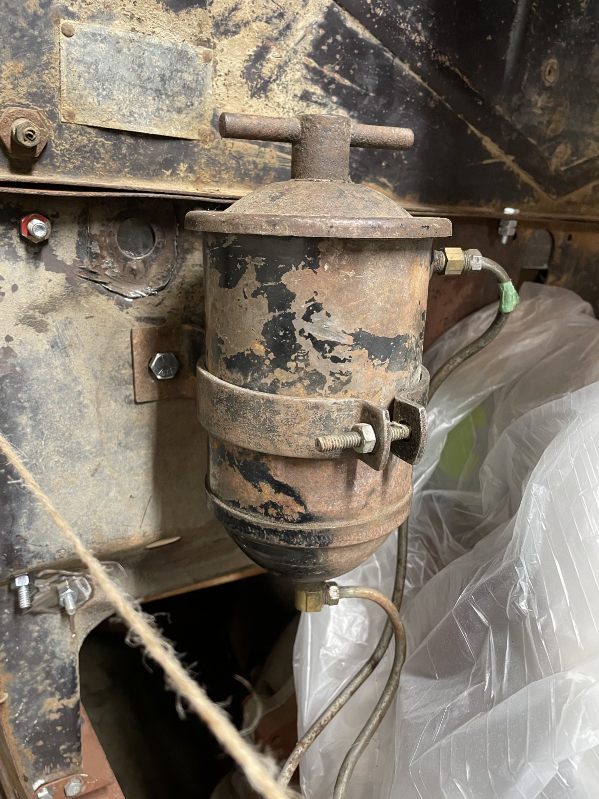

    At the same time I drilled the holes and mounted the oil filter. The photo with the vice grips is there to show exactly why I’m welding nuts to the back side of the firewall. I hate having to figure out how to be in two places at once for bolts like that 1D7FFF34-EBDA-4D12-BA0F-1BEB16EB6ACF.jpeg 8D4000AB-1A83-49C5-9BB4-19FDFE7FB8C1.jpeg DF7267E6-9DBD-4EB3-BA68-A28F8F133AE3.jpeg 57283555-638F-4239-A245-DAE8F949057F.jpeg E9F1CA27-C1AE-47A8-8E59-1E127C0CC678.jpeg
    Joe Blow, drdave, loudbang and 4 others like this.

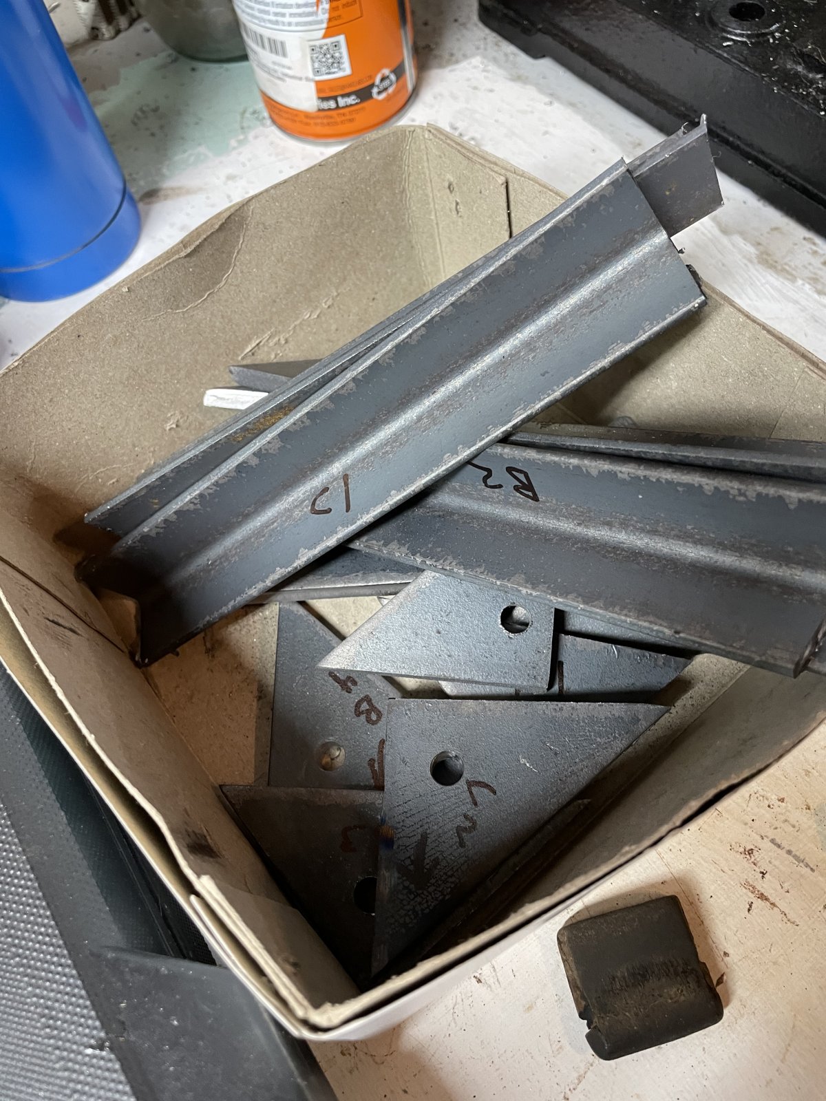

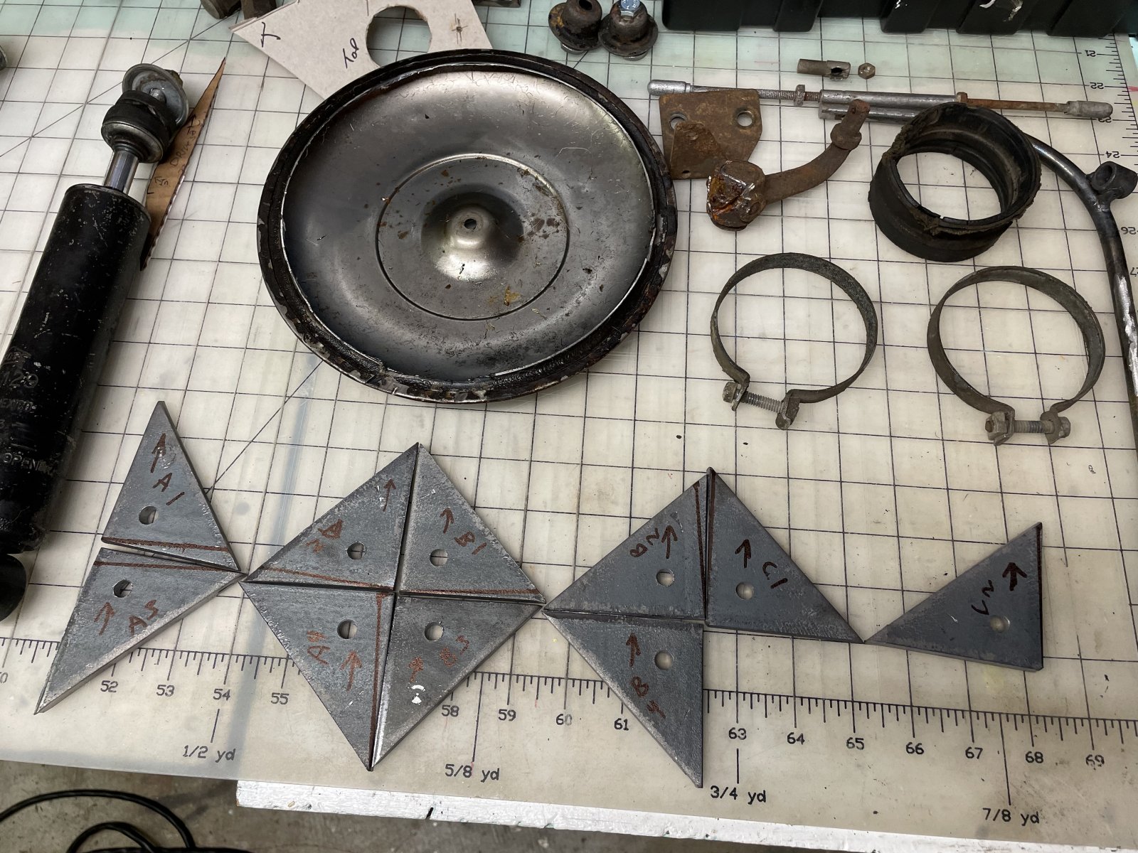

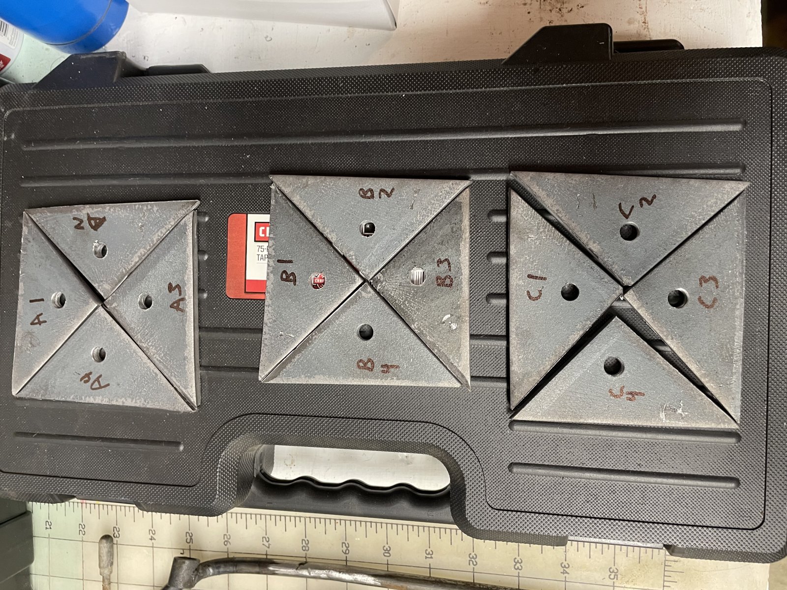

    Drilled, indexed and trimmed all the floor gussets 75324289-9376-453E-9459-BF9D09A7F3A0.jpeg 93088251-FFD7-47C9-AD3C-4BCF6FD1E280.jpeg 6753A4AB-F708-4E9E-A66A-A352A5652DEE.jpeg

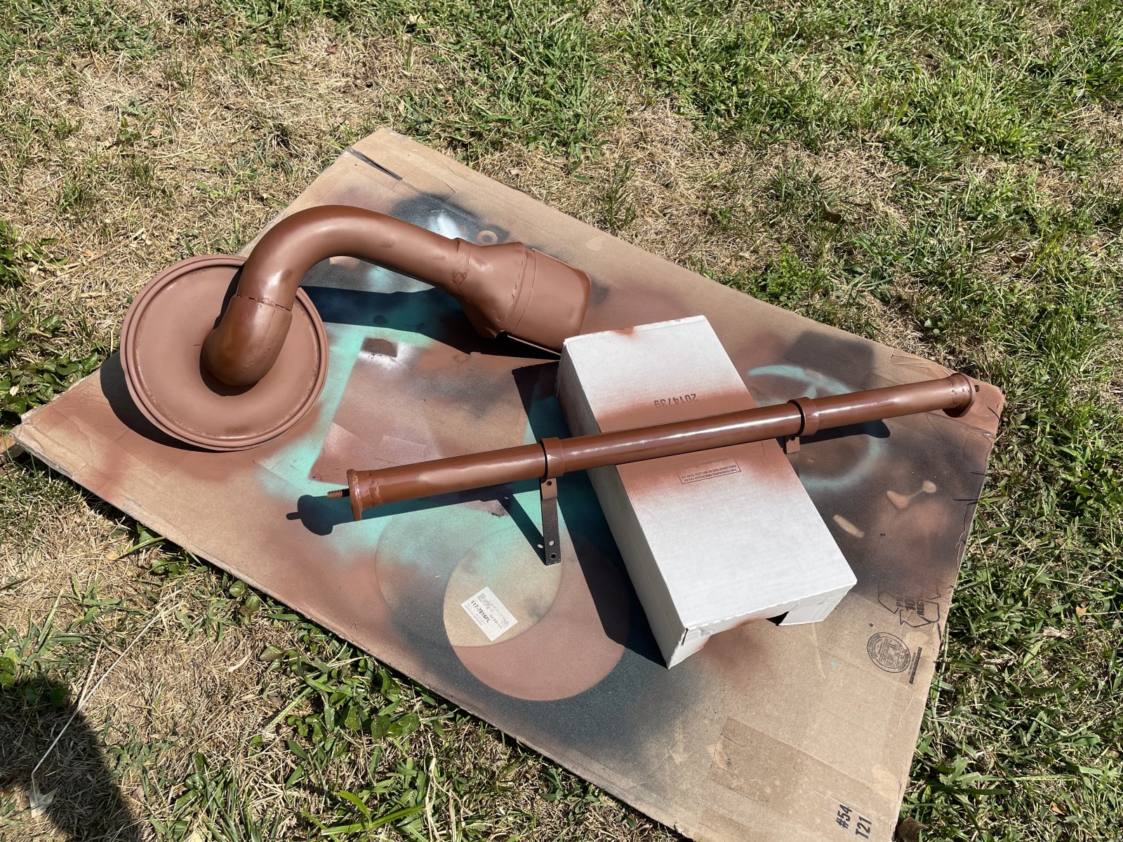

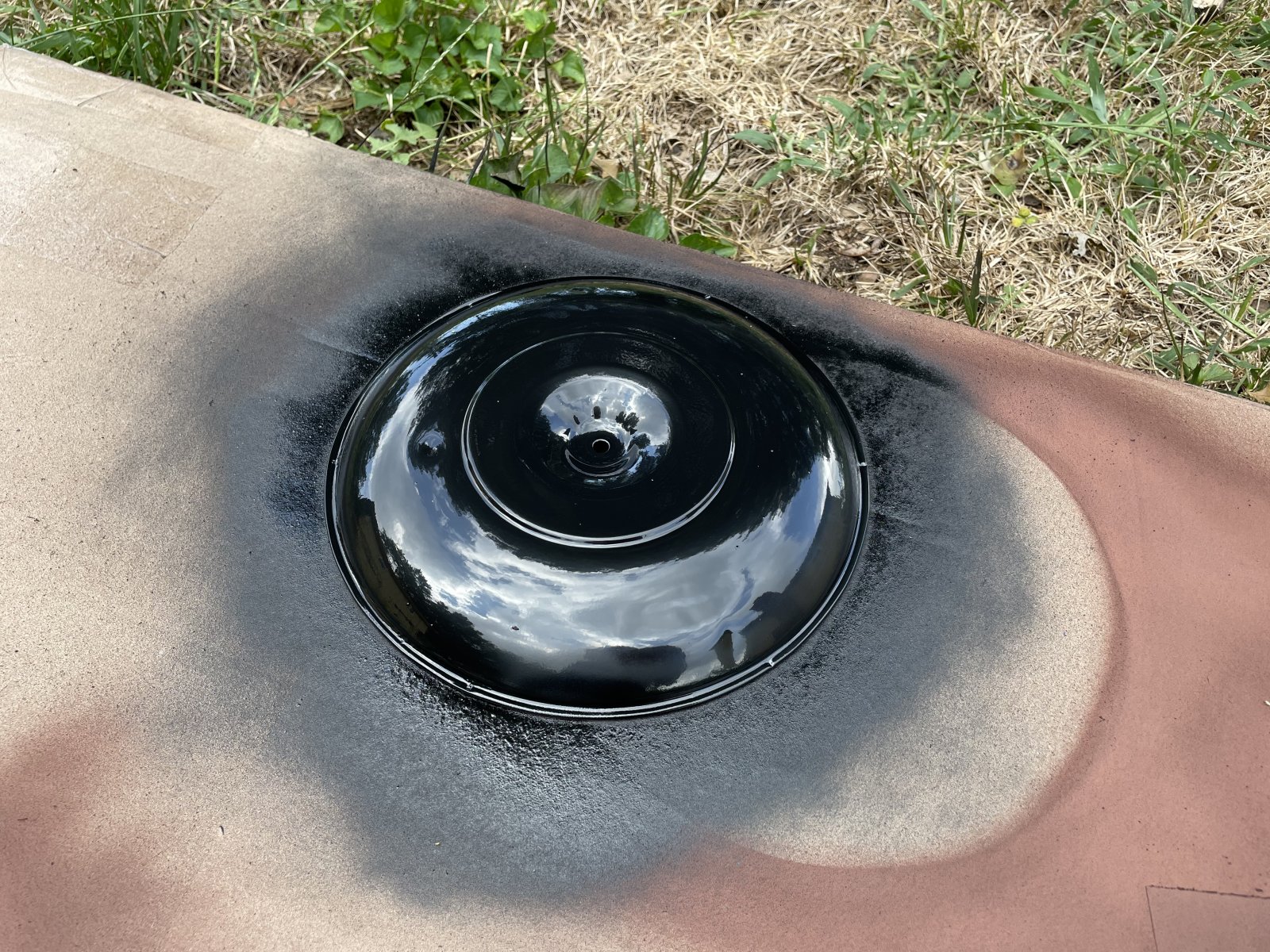

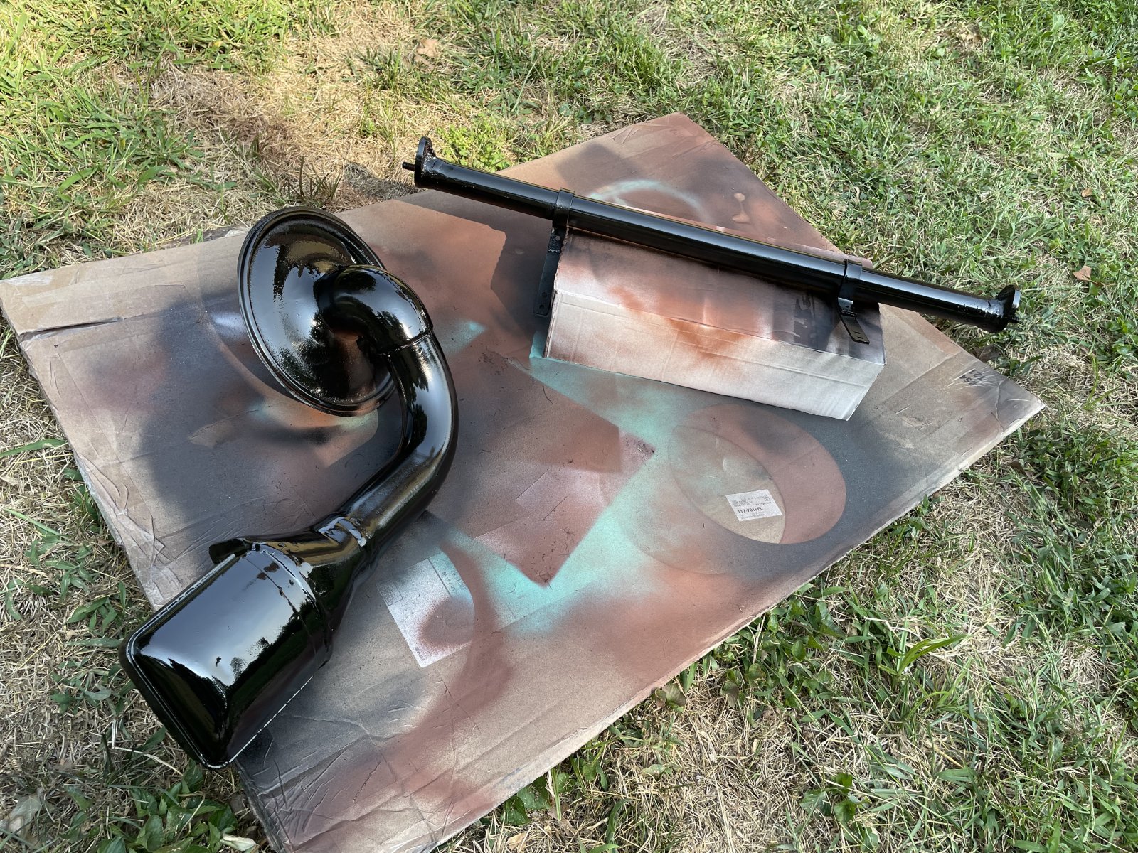

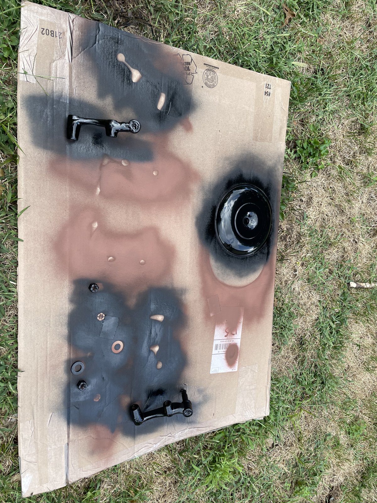

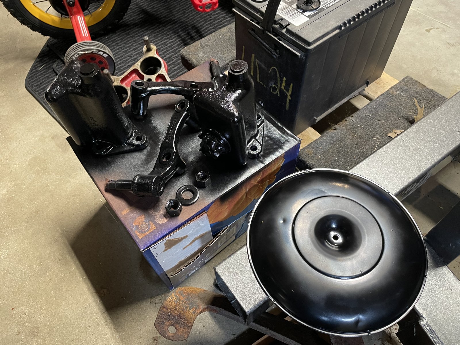

    Trimmed the air cleaner bottom and painted it. Also painted the rear lower shock mounts - cut and welded/ evened out 46 Ford pieces E9FD0A2C-7CEA-4D43-8447-6AF4DEA32377.jpeg F01ABCAC-1061-4426-8DE8-6D839B9FB894.jpeg 8E357506-AD65-40F5-8BBE-41CC208BDC7A.jpeg F7953ED7-7B9F-412C-B2FD-89E83447C6CC.jpeg BEDF0FB5-CB67-4D03-8E37-0C0ABDE51C7D.jpeg DBD86D7A-3212-43AA-800D-3643C10ADC18.jpeg D6A3021B-B6AE-48EB-89C2-1CA3987A44F5.jpeg
    brEad, Joe Blow, drdave and 4 others like this.
  10. Tim
    Joined: Mar 2, 2001
    Posts: 20,778
    Tim
    from KCMO

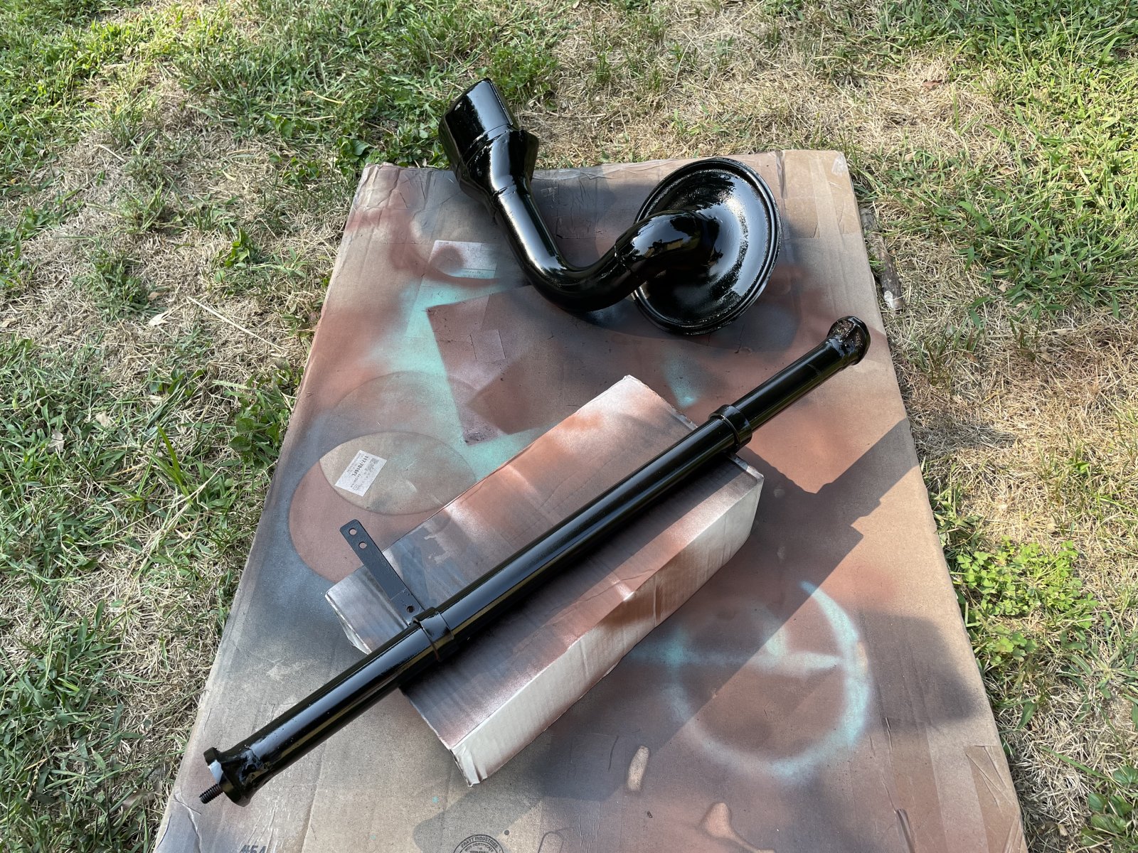

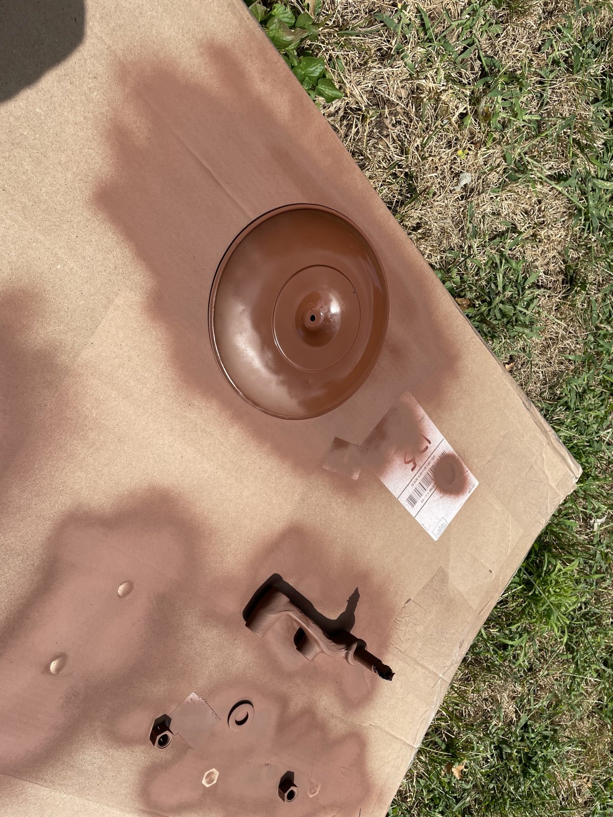

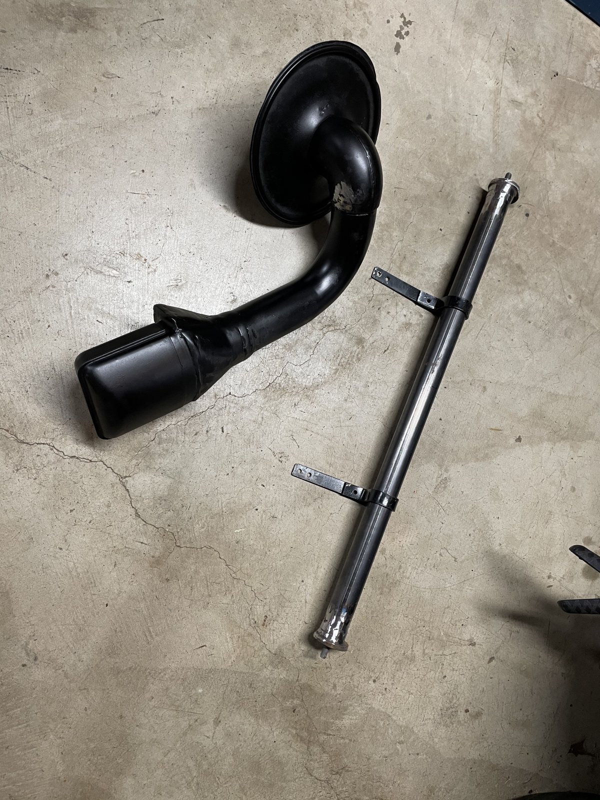

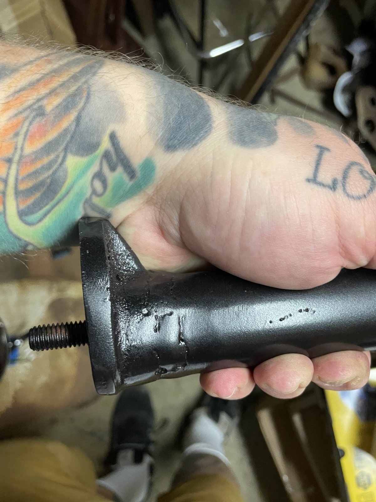

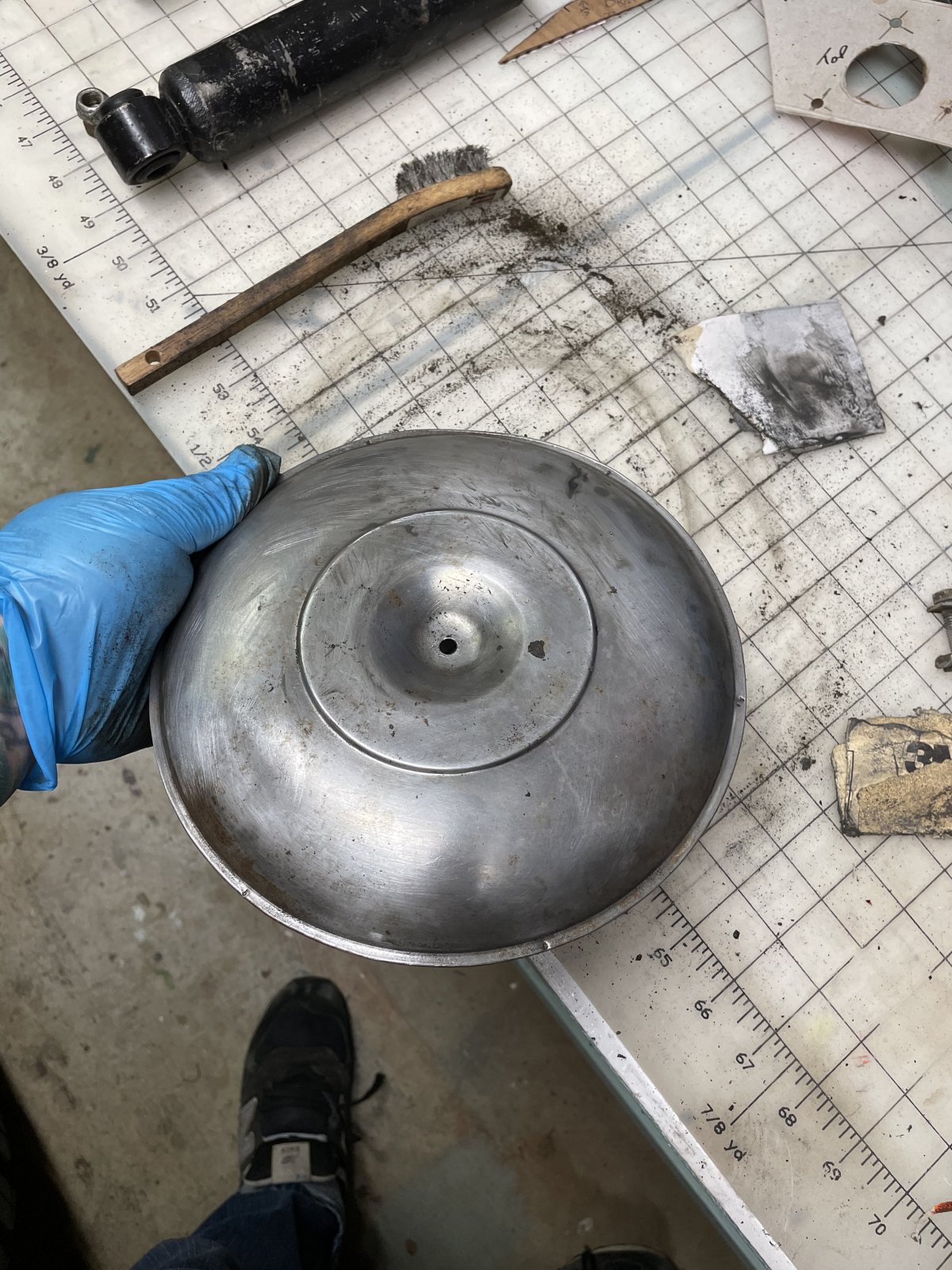

    Got my air cleaner top back from being brazed together and the spreader bar back welded.
    ended up using the stock ends of the spreader bar with new pipe in between. In retro spect a heavy wall pipe may have been better as it was difficult to weld the thunder tube to the very thick Ford ends
    painted them both C39F0705-ED2B-43D7-9399-3C1AA689A00F.jpeg 17C289F3-50AE-4711-9550-5355FFC32318.jpeg 10099ECA-327F-4539-9E32-34EA0C4BE8EE.jpeg 133F944F-B2B4-4436-B17A-73296AA72C94.jpeg 61345DE7-0384-4CC4-A669-195F03D2112F.jpeg
    random photo of knick knacks that belong to the project seems to got included. Oh well lol

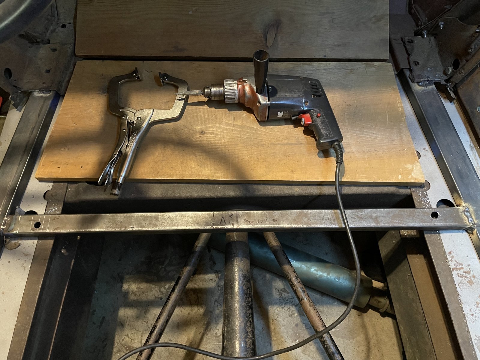

    No real photos after that point FBCAD8F6-61F9-4DAA-8525-150766703C7A.jpeg car has a killer rake in person. I’ve been cutting/ adjusting my tacked in sub frame getting it dialed in to have the rest of it final welded soon and working on drilling body mount holes.
    I spent for ****ing ever marking them out and 5/6 top holes are dead on but the bottom holes- I’m drilling threw box tubing with a hand drill- drifted on a lot of them.
    I drilled the holes under sized for partially this reason. Current plan is to oval the holes to get everything lined up and then when we weld in crush tubes fill what ever gaps may exist
    going to try to get to oval-ing them this afternoon and then I think the spreader bar to frame irons will get cleaned up one way or another and the column drop mounting holes drilled.
    then I think I’ll pull the tank off and correct the misalignment in the firewall/cowl bracing and drill the master cylinder/ pedal box while it’s apart

    Man that is a lot of component prep. I'm trying to do some of that too. Remind me why you went with a remote oil filter. I'm doing that too and in some ways it seems silly when the screw on is right there and is easy. Mine may interfere with the front mounts but I could change that. Mostly I'm doing it for looks.

    Yup. I was contemplating doing it then I found this 40’s dodge unit for like $2 or something and when I bolted it on the ****ty paint even matched! Figured it was a sign

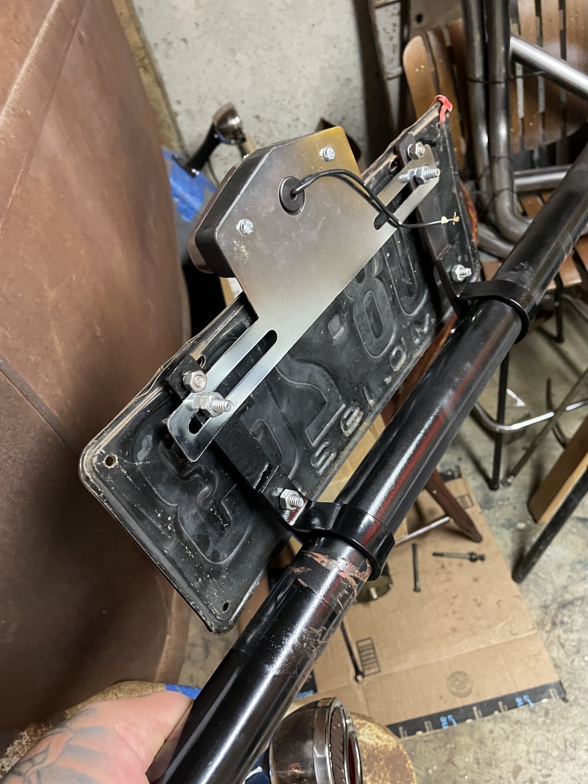

    Got the body mount holes 99% drilled tonight. Need a tiny bit more tweaking and they’ll be there. D1048D6A-30CF-481C-BF85-6E41C6640E3E.jpeg also mocked up my spreader bar with the plate mount EE5188FA-8B9C-4F22-B03D-D519F73CA45F.jpeg dropping the light was worth it 97C22F15-D383-4AED-A3BE-D16A082790C3.jpeg 382665DC-FEBA-4275-ACDC-499FC9CF9F48.jpeg Doesn’t lay flat like I want it to get but it’s nothing a little fine tuning won’t take care of 8DCF34EE-E2F9-4177-8855-2F1051C0A090.jpeg a lot of effort just to have that little webbed gusset lol C9E9A3E3-C696-4D18-B703-99F165882863.jpeg oh well. Progress.
    gonna try to buy some bolts Wednesday. Thinking a trip to a tractor supply for some low grade bolts by the pound are in order. Not sure what size and length I’m really going to use so no since being bent over at ace for them.

    @Six Ball just like the way the clamps look and they offer a lot of fine tuning should I want it to sit differently.
    But mostly I like the way they look

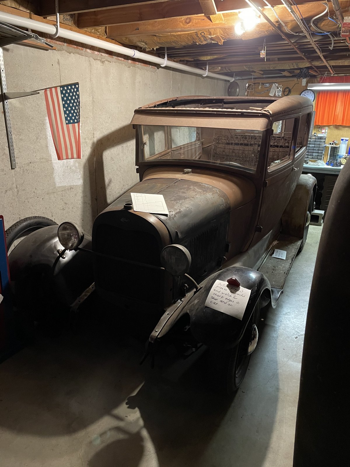

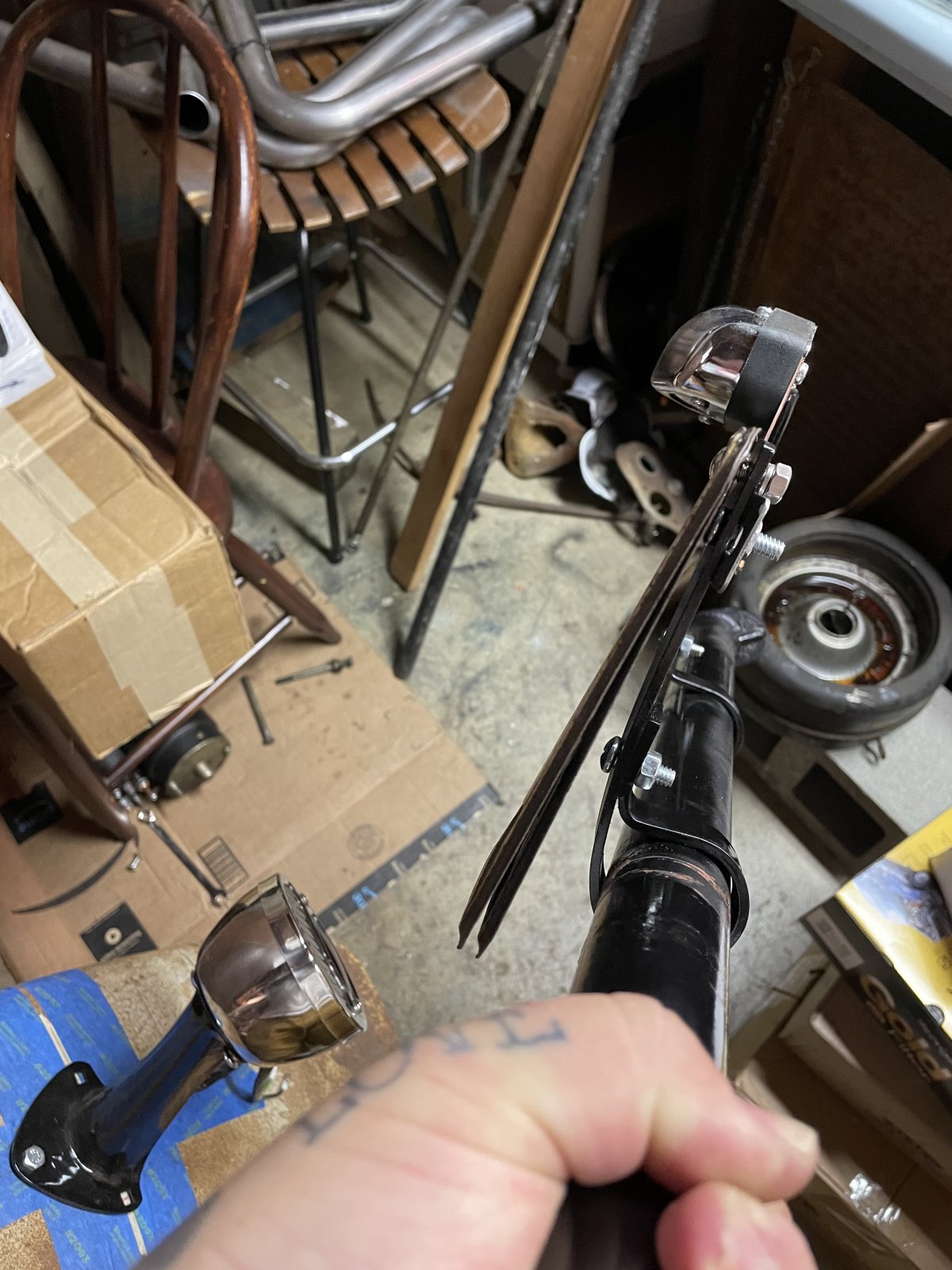

    Together apart together apart….. B753ECBF-4DF0-439E-9BF8-43BFD734FB09.jpeg car is bolted to the frame. Updates in the next couple weeks should see it outside :)
    drdave, patmanta, Six Ball and 5 others like this.

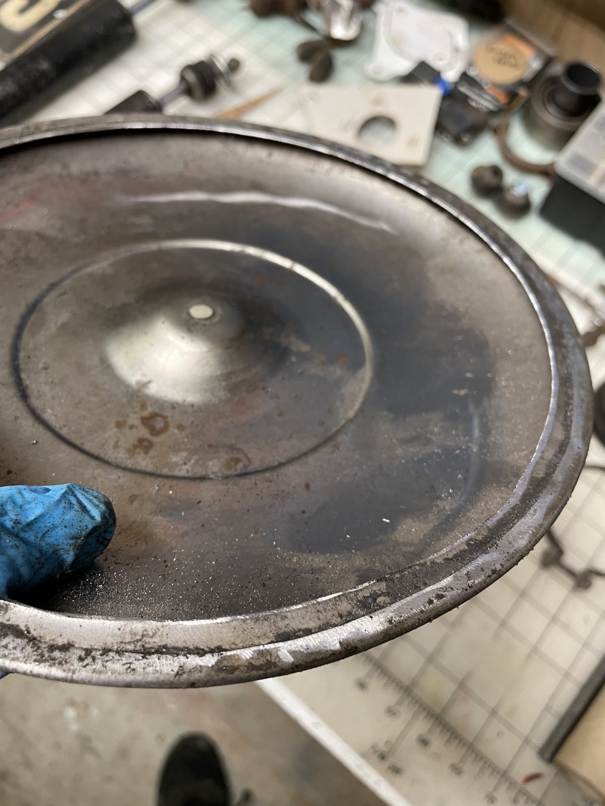

    Thought:
    my air cleaner has the “lid” on the bottom side so the wing it faces the ground.
    thinking I need a way to keep it on with out making it a pain in the *** to take off.
    thinking drill the stud for a cotter pin. It won’t let the wing nut loosen enough to do more than rattle and very easy to pull and replace with no tools to replace the filter.
    thoughts? 6582CB64-0E63-498C-AEA9-EE12891BE32A.jpeg sneak peek at progress. It’s got latches!

  27. Cotter key is a simple fix, do it
    Stogy, loudbang, drdave and 2 others like this.
  28. Thor1
    Joined: Jun 6, 2005
    Posts: 1,699
    Thor1
    You might want to use a small hair pin. It would be easier to put on and off...
    Stogy, loudbang, drdave and 3 others like this.

    Hair pin! There it is.
