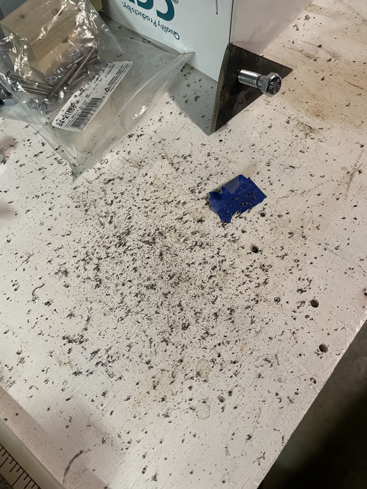

    Phew that made more chips than expected! EF6B2E4F-D621-48AF-8E38-C19462A870FF.jpeg drilled and tapped all the floor corner gussets for 3/8-16. They are 1/4 steel so when they get welded flush with the bottom of the 1”tall tubing in the subframe I can bolt a 3/4” marine plywood floor board down from the top and not need to figure out how to hold a nut on the opposite side.
    should get welded in a week from tomorrow if all goes well

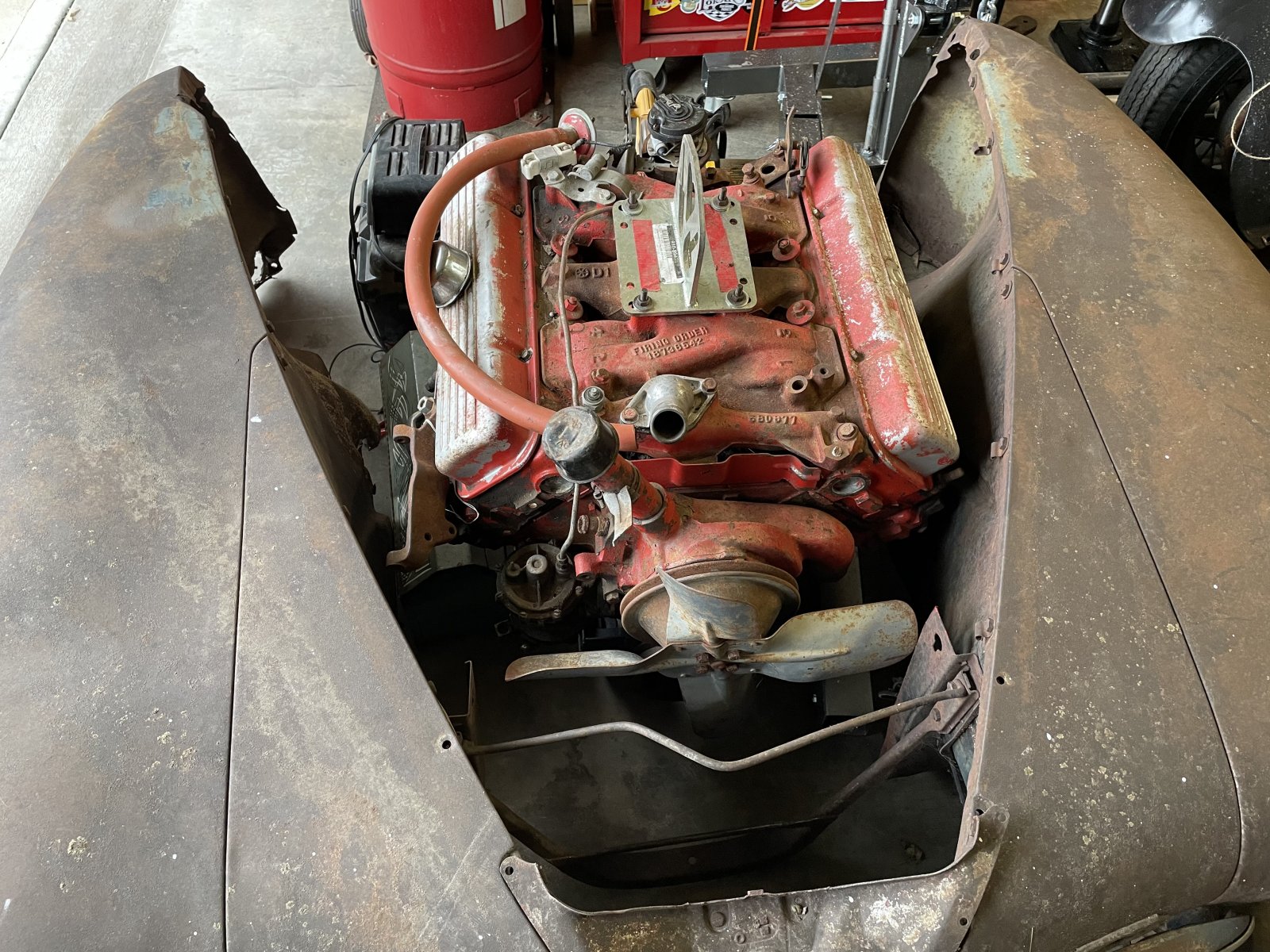

    What’s this…. 300C139D-D960-4DED-B4D0-978E60ED2568.jpeg 86C22E03-CAD9-4CC2-826B-04EC0778411F.jpeg

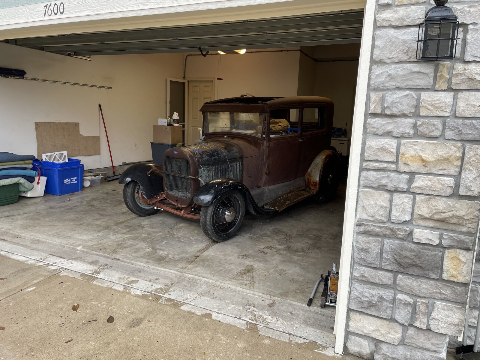

    And down the road we go! 37267C7F-8B8A-4F9C-9BE1-E09F40CE0499.jpeg AFCF1D0E-DCAB-450A-AE0D-C089F4BD2D81.jpeg 893F52B3-979E-4A54-9925-48D2E745F858.jpeg 375B0C81-817A-4A8F-A442-7CCFC2544DC1.jpeg

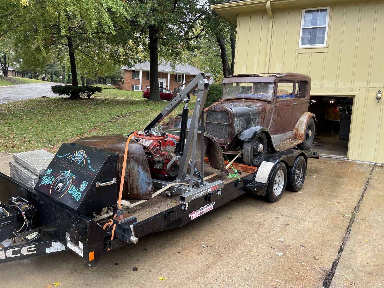

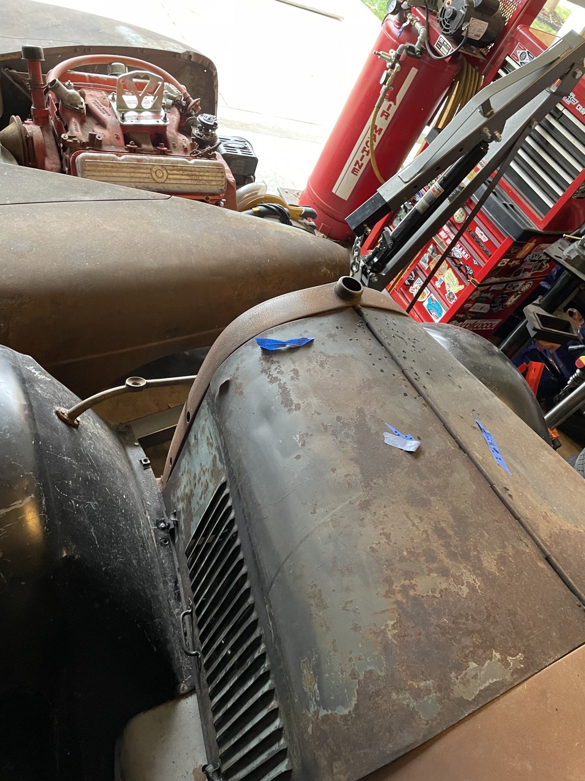

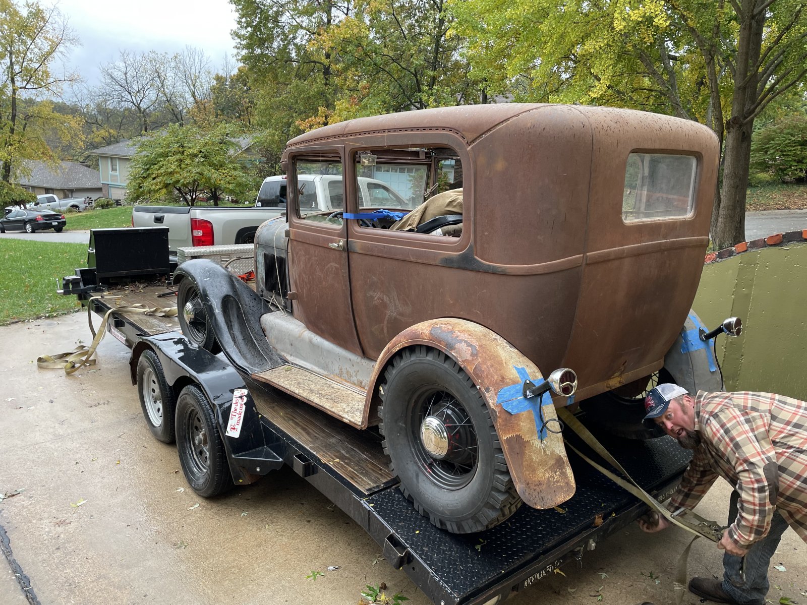

    Ahh that’s better! 9744FC15-21CC-4008-8AE5-2352D6AFB706.jpeg then it wasn’t long 4F42BDD5-337C-48B1-8C59-F063702C96B8.jpeg and it started feeling like an episode of pickers F9C6AFC4-B8C7-45F4-A8A1-B8CB9C668C61.jpeg 9120E5CF-D22C-4F6A-BF85-70F19AACE61E.jpeg AC8A5742-D17C-4879-BC90-8F1A7EE383A7.jpeg C6319B08-A124-4324-AD08-1186E9E9A335.jpeg 83690436-D13A-4355-9BC3-6C96D6458CEF.jpeg 2AF083AA-B870-4D61-8DF2-1A966B5BBC74.jpeg
    You find out just how low things are when you pull them up onto a trailer! Some crafty moves and we had it sorted. Thank God for friends who know what they’re doing lol 6B2B85C9-2016-414F-9516-EEF9579F2D59.jpeg

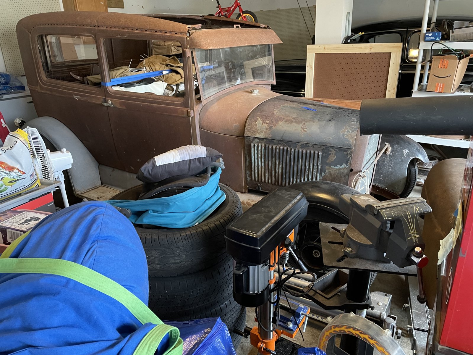

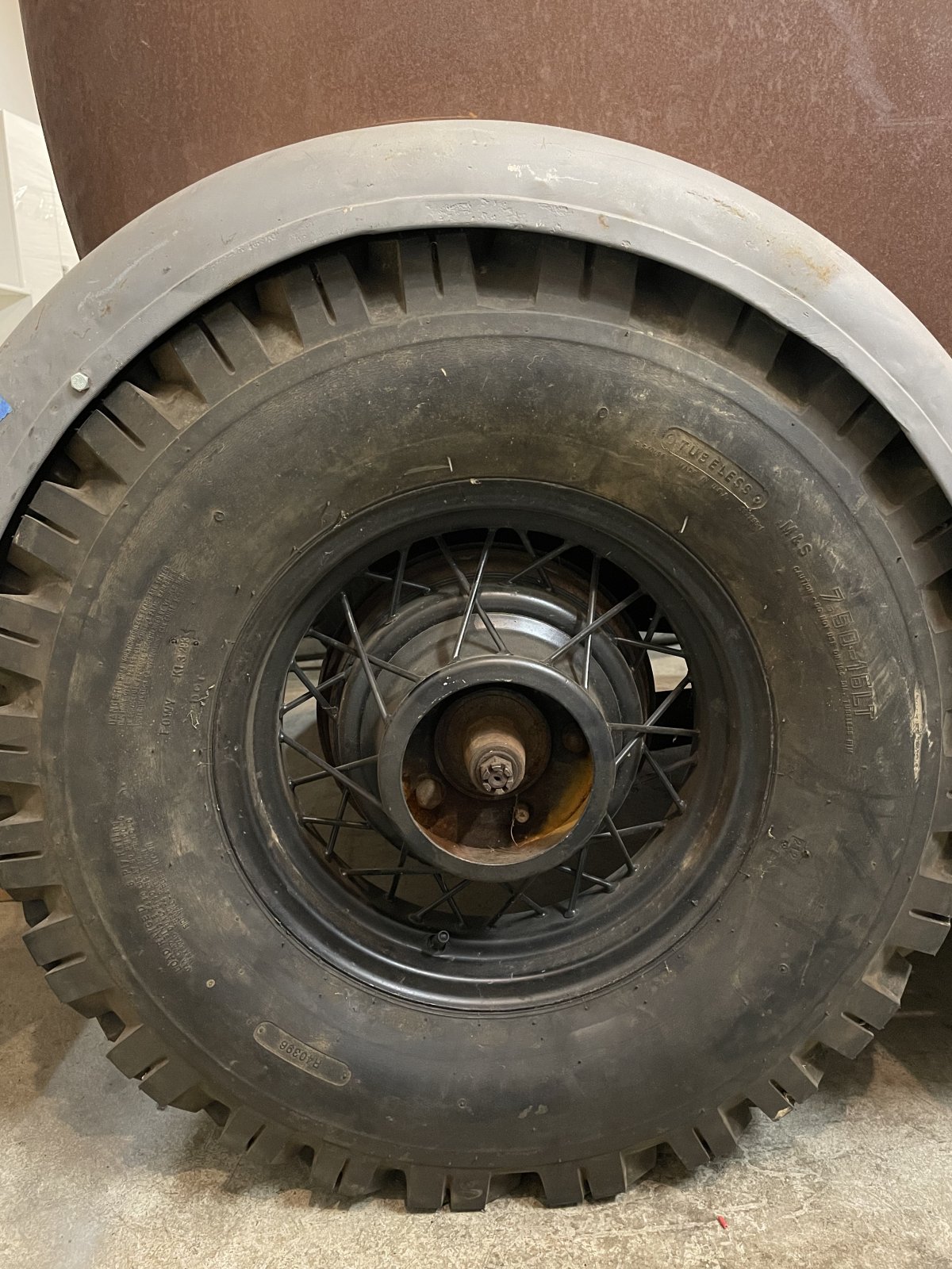

    Thinking these tubs need out of the A. That’s lookin a little low 3F566FDB-ED2E-44CA-B4BF-7E3C46C90346.jpeg

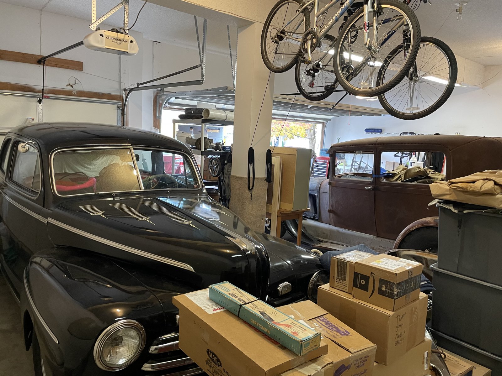

    Repeat. 5075F0F5-703C-4D7F-86E1-7301EDBFA773.jpeg this is gonna take a minute

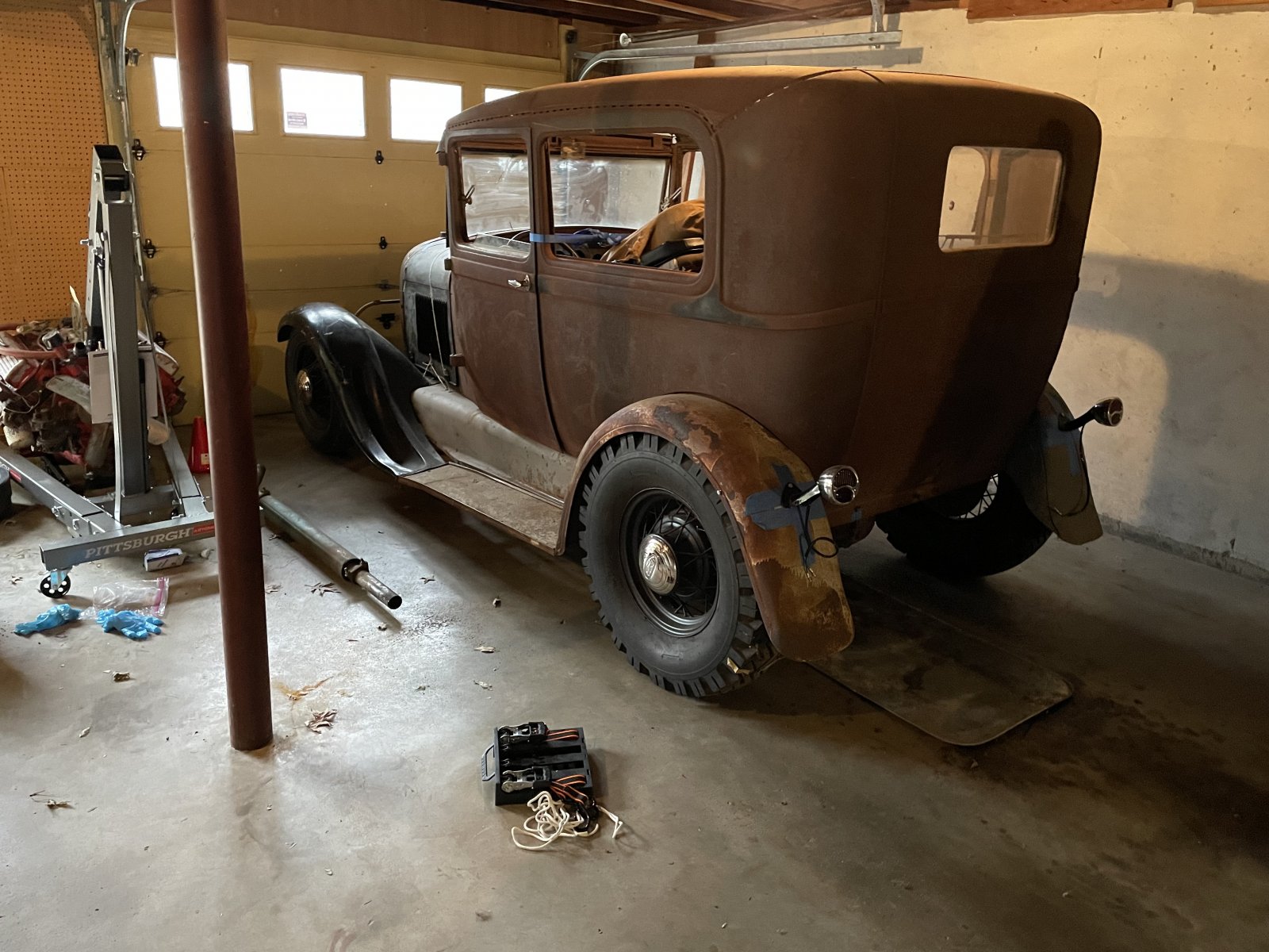

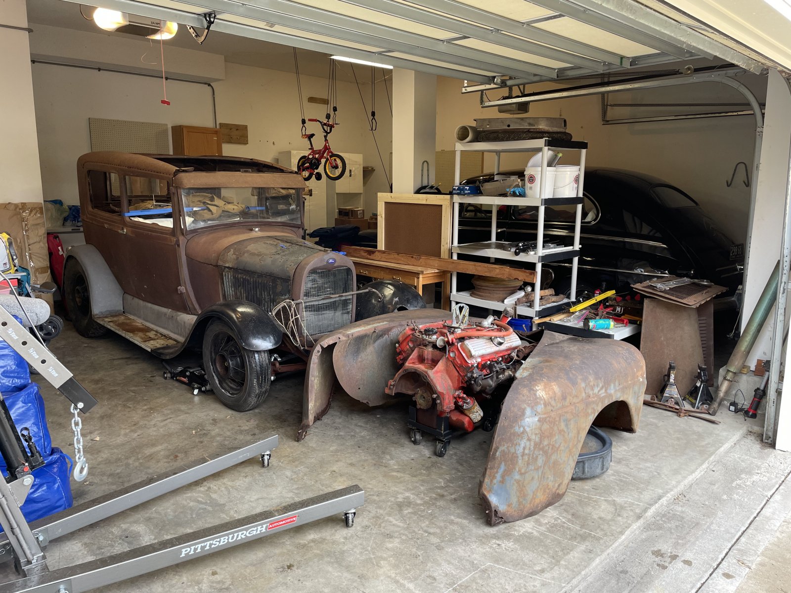

    87364604-33A6-42FB-8BAF-5E27137AC27E.jpeg Like a rusty game of Tetris, looks like the white stuff is on the other side of town gotta make room for mamas daily quicker than expected 7693E0C9-7D98-4C47-A2F3-8E4CE30A1C56.jpeg

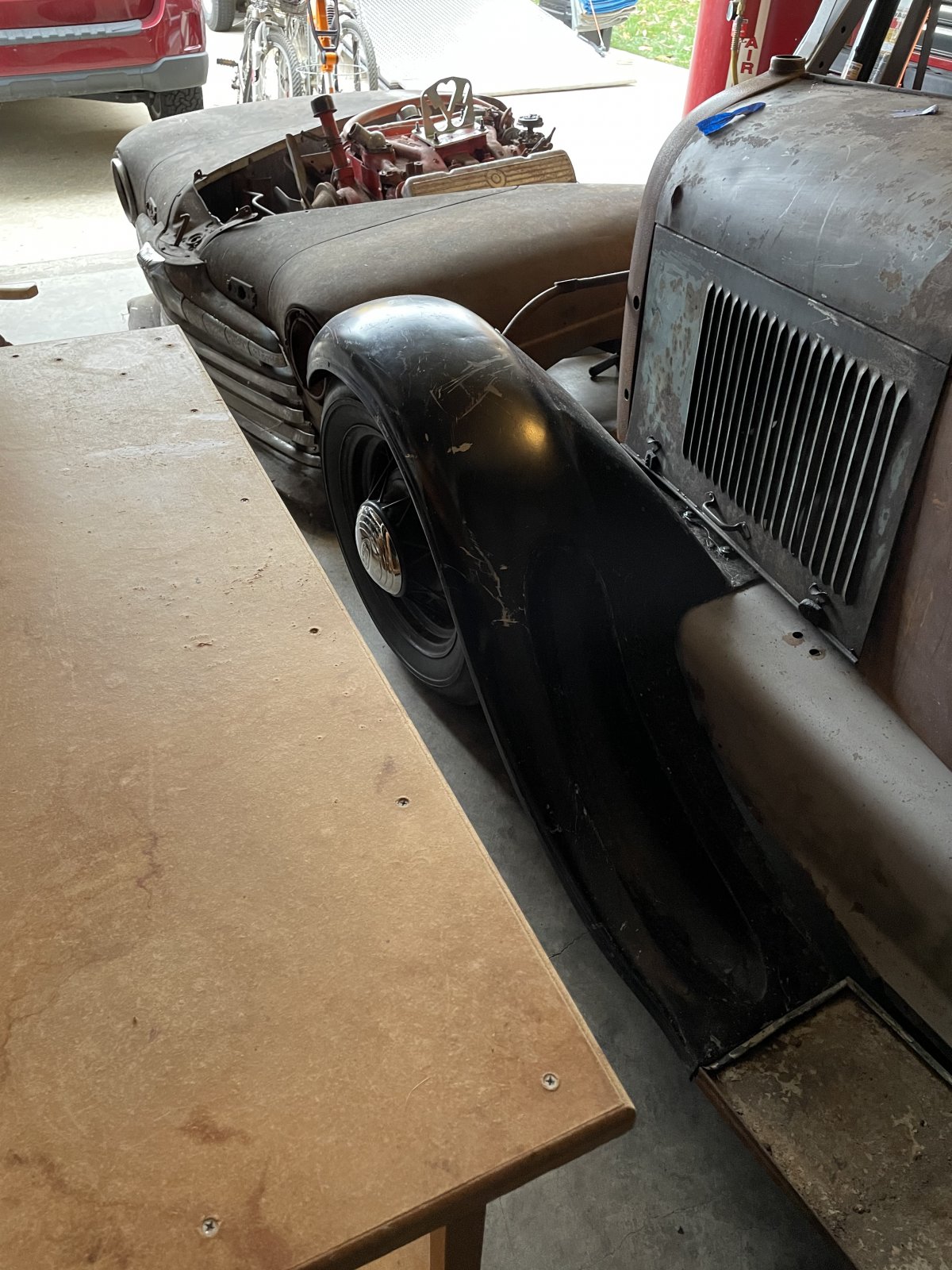

    Getting closer. Priced lumber for the work bench yesterday and this morning moved one of the last non garage pieces of furniture out. I can see the floor!
    3246B625-5527-4EAD-A739-5A463DA63E48.jpeg Got another big… let’s call it a book shelf on steroids.. that might not stay but for now it’s loaded with boxes so I keep shuffling it around
