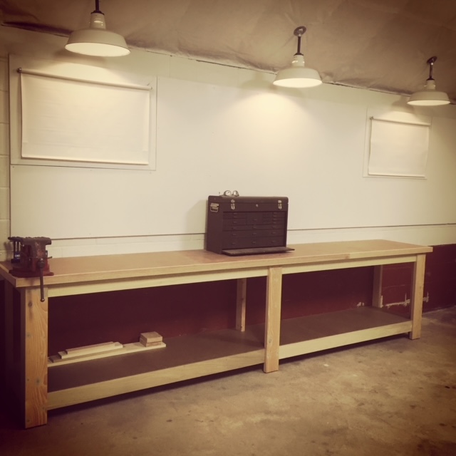

  14. The blank canvas...
    And the progression. It’s much fuller now top and bottom (as you know @Tim)
    And I also put a layer of Masonite on top so that it could be replaced if damaged. Also because it just reminds me of the benches I have seen in the past in old garages.
    brEad, 2Blue2, Tman and 8 others like this.
  15. Six Ball
    Joined: Oct 8, 2007
    Posts: 7,056
    Six Ball
    from Nevada
    Nice! I put too many windows in my shop. The light is nice but they used a lot of wall space.

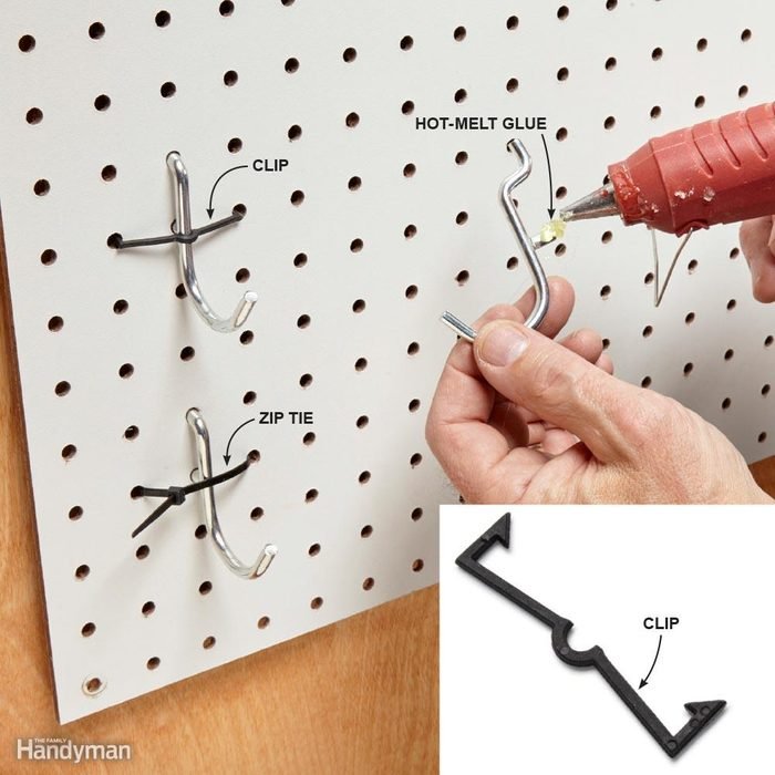

    Regarding pegs pulling out of the pegboard there are snap in plastic locks to prevent them pulling out and another easy fix is zip tie them...another thing you can do to pegboard once all is positioned is you can draw an outline around each tool and it provides a visual aid to locate the place it came from...leaves some memory to think of other things on the go...

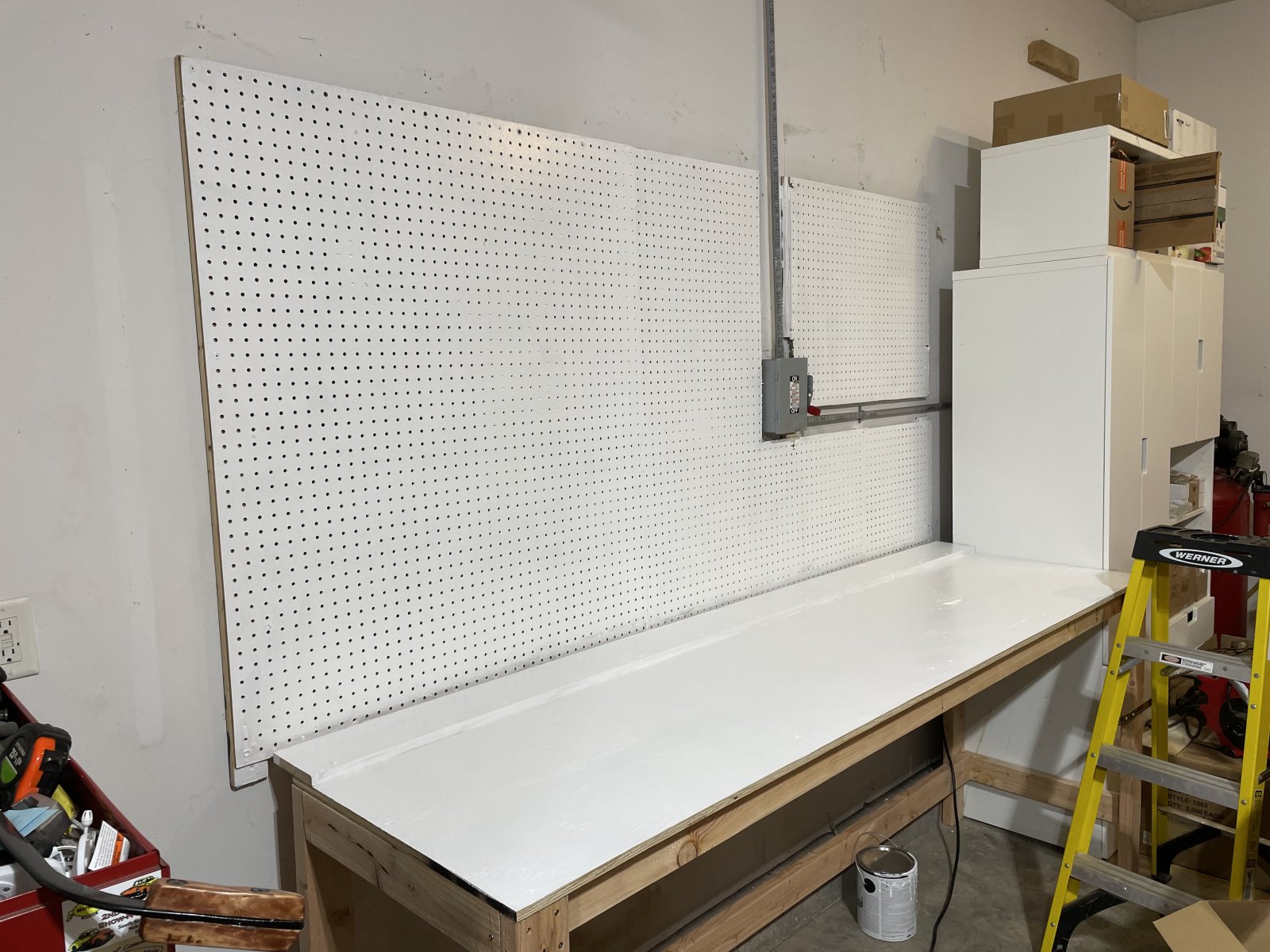

    kilz was a bust, that ****s rotten lol. Found a random gallon of white though! One p*** done and I’m waiting for it to dry to do another but after I figured out how to paint peg board it went pretty easy
    loudbang, Six Ball, drdave and 3 others like this.
  27. Tim
    Joined: Mar 2, 2001
    Posts: 20,778
    Tim
    from KCMO
    Need to poke a few holes back open but two coats and it’s ready to go. Good cold day to try out the space heater and help it dry. Tempted to start loading it up tonight but I think I ate to much for that lol D151264D-08A6-42B1-BF3B-F5F8F33A4B29.jpeg
    patmanta, cactus1, loudbang and 4 others like this.

    Live with it a while before you make tool outlines on your pretty white paint. That white will make your shop so much brighter.
