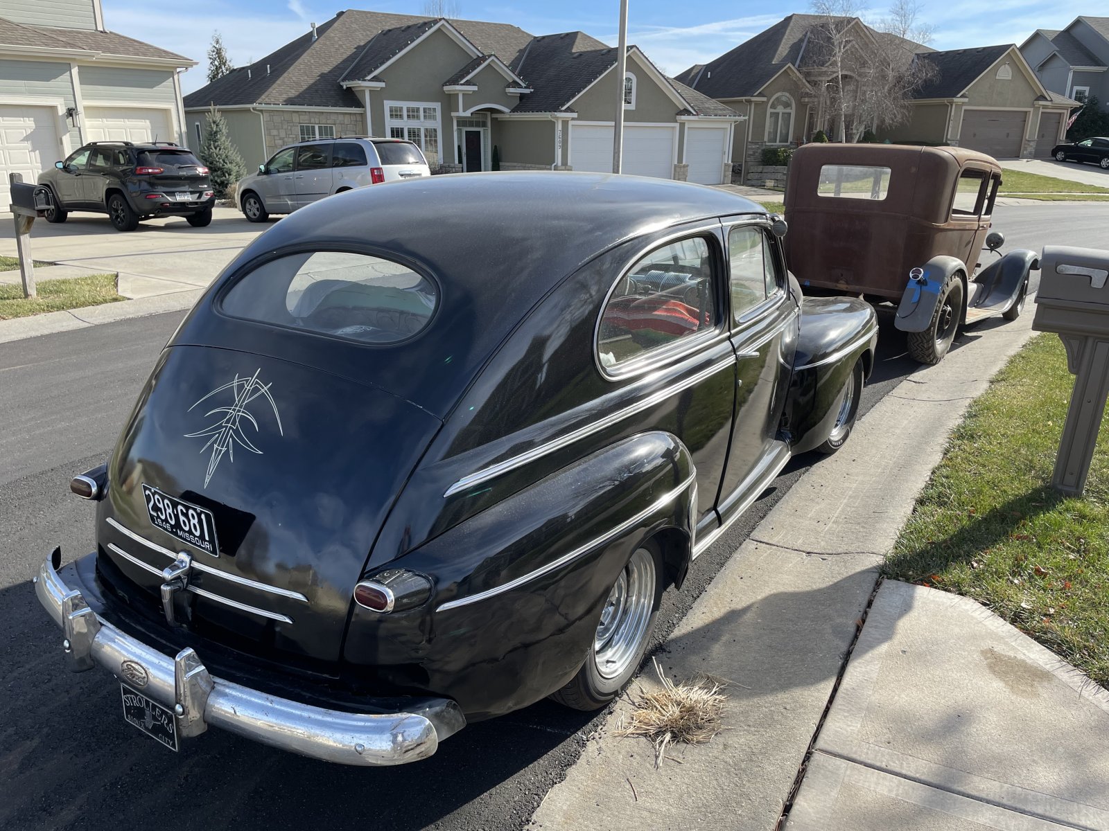

    Drawing a blank on who painted this, but I basically borrowed the lick that runs from the roof down to the trunk 1700839B-7BED-4F10-8337-377D1FC2321D.jpeg

    That looks very Von Dutch to me.

    Yeah it isn’t though. It’s right on the tip of my tongue but it’s evading me at the moment.

    Dean Jeffries?

    There we go that sounds right! I kept wanting to say Watson but I knew that wasn’t it

    Even Von Dutch didn't bother doing both sides exactly the same. Sometimes only a hint of similarity. You can only see one side at a time unless you are too picky and start looking for imperfection. That if different from looking for perfection. I amazed myself with how close the flames came out on my '53. I started with thin masking tape on one side and when I liked it I did a rubbing on butcher paper and transferred it it to the other side.

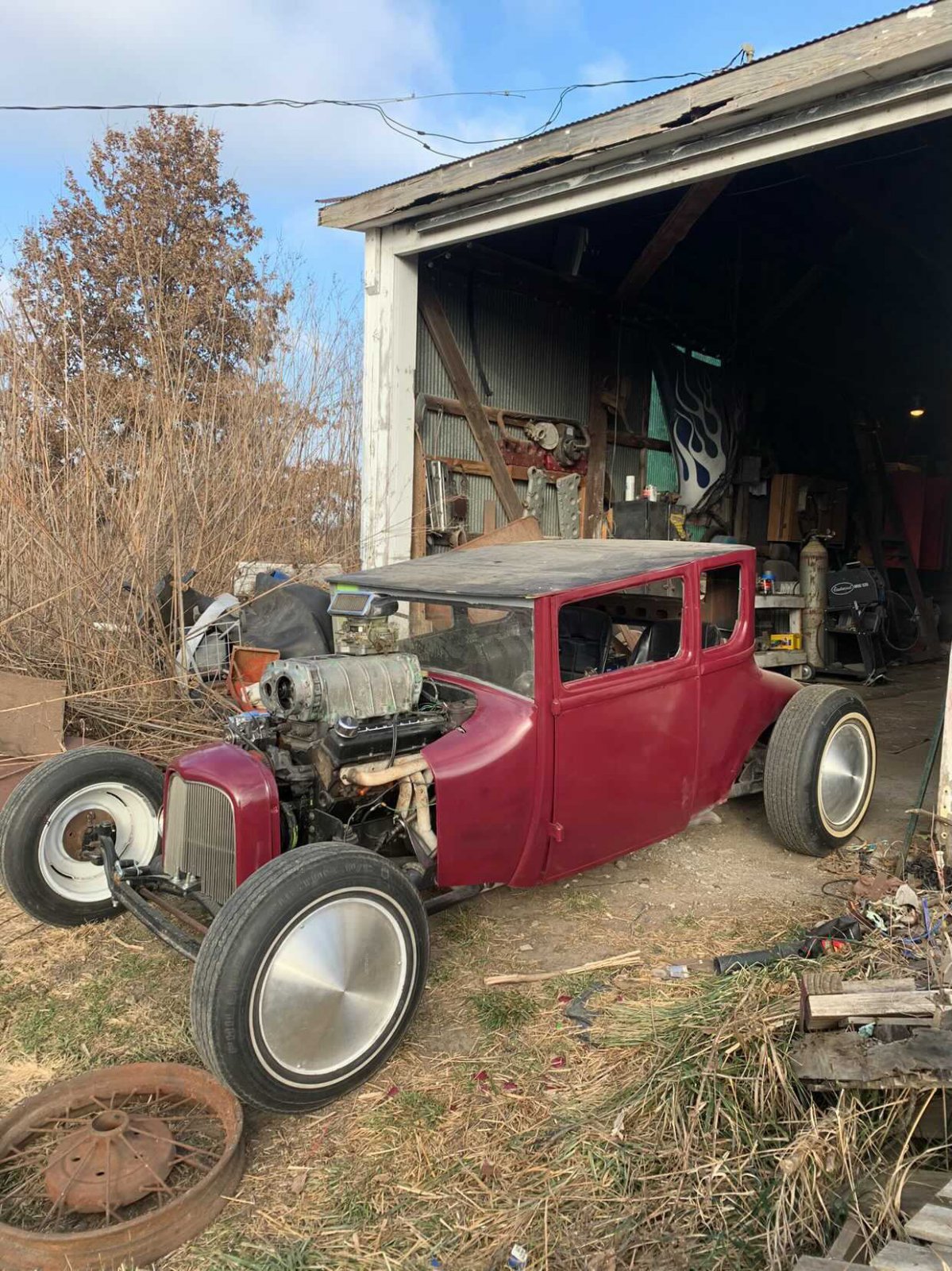

    Next up Frank - forget his user name- sent by Jimmy’s to get something and fell in love with this! It’s a 31 slant window 4 door model A with coupe quarters and a heck of a chop!
    Jimmy saw the vision and just had to do it and Frank just had to have it! Getting mocked and and built now :) it’s chopped pretty good with a little extra lean added to the pillars. The pushed forward 4 door roof has a different shape than a normal model A. Over all the back feels a lot more 32 and the quarter windows a little mopar. 100% *****en though. AEEF9411-7903-4AFF-ACA2-61B79B90A76C.jpeg 4A9DB37F-BC4B-486E-936B-DE0C2546CA59.jpeg

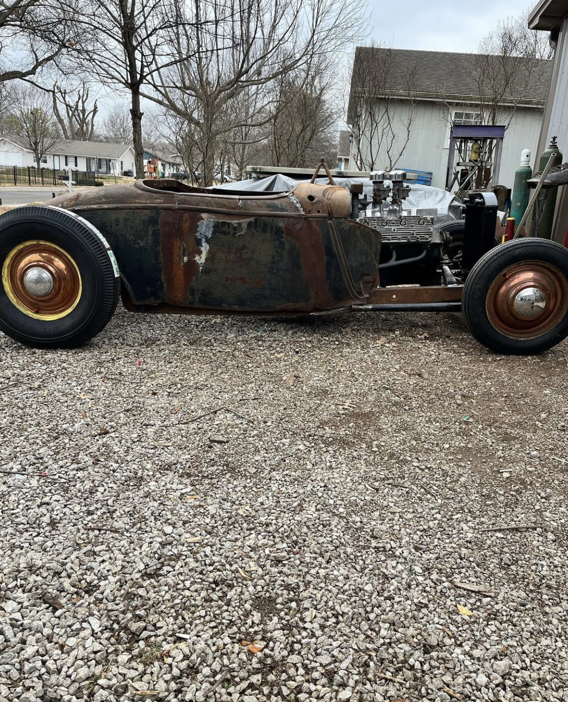

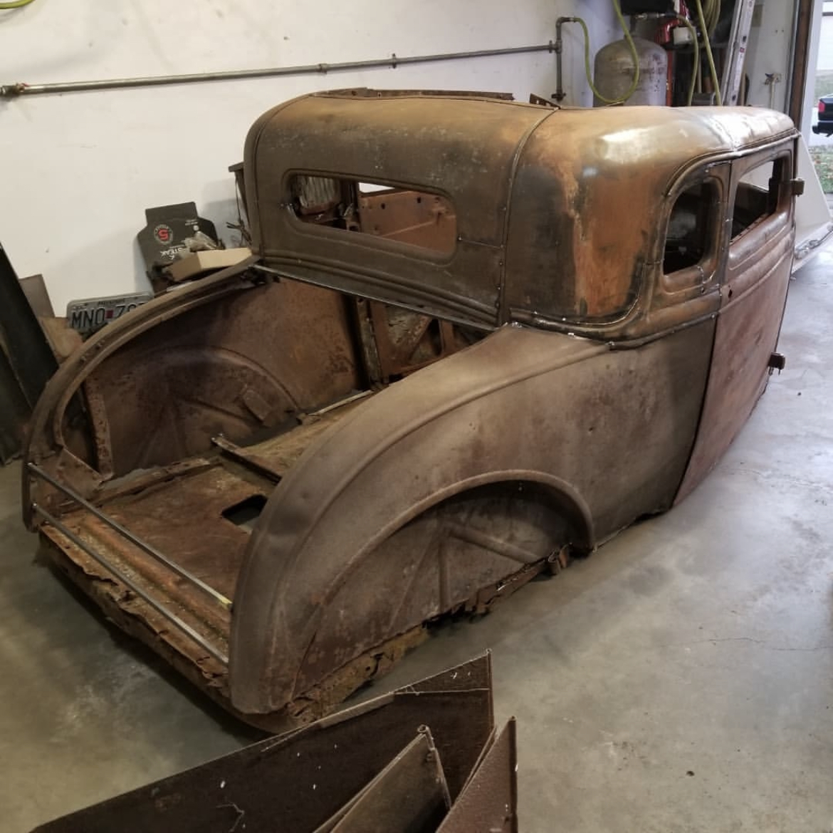

    And Jimmy? Well with the coupe gone this shows up! DBC6D29D-AAAC-491A-8AC0-B2AEFDC53EF7.jpeg whats left of an old hot rod! Shortened around 6 inches total, bobbed and every thing leaded shut it wasn’t long before… 69C7FA83-5BB3-424D-A3D7-225282E4BCCE.jpeg 00DB4B91-16EE-456B-8D94-680A2D32DE57.jpeg 2CD956A8-F0E5-46EE-9140-65648E774F17.jpeg he’s keeping it all pre… 50? I think. Every time I see updates it’s like a how to straight from the little books. This things got the vibe for sure.

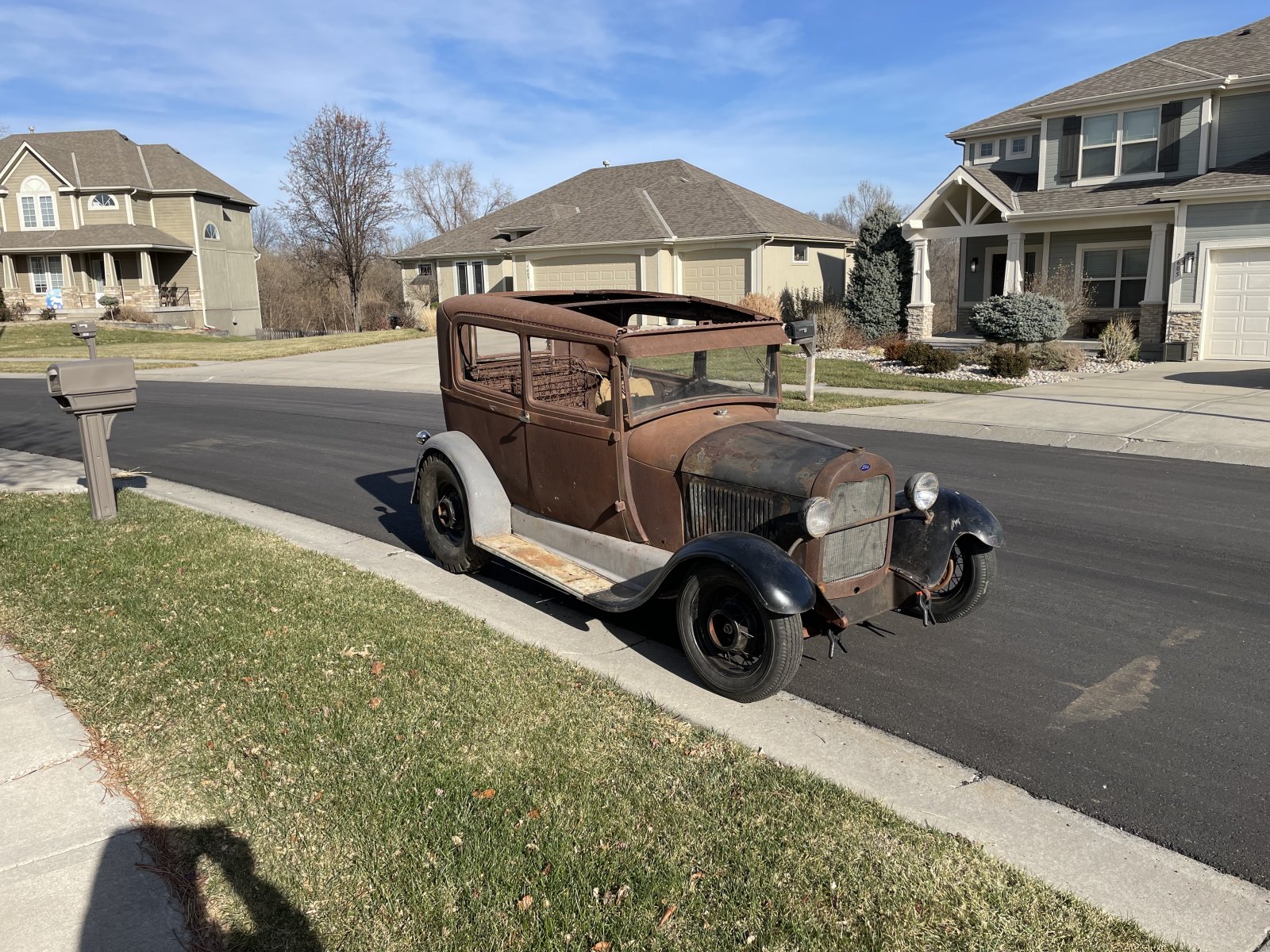

    Well, normally for my birthday I get the 46 out in the snowy driveway to warm up and take a photo…. But it’s 71 degrees and climbing…. So no snow lol.
    So I pushed the A out to the street and followed up with the 46. First time the A has ever been on a street and the first time the 46 and A have been outside at the same time! 53A4AFEB-5F6C-4C90-A70C-4F4C91FAEC49.jpeg 44C0E016-866C-4597-A821-077FFC18D947.jpeg 7280A10D-CBDF-4673-879D-91E2768509F3.jpeg had my wife hop in to steer as I pushed it back into the garage and as soon as I pushed I lose both headlight bulbs, both managing to hit me in the way down lol. No Damage to me or the bulbs thankfully haha. 4F785975-A5B1-4B19-9675-731BC58F73BC.jpeg does looks sad though. I’ll have to sneak out there and stick the bulbs back in

    It looks like it is looking for something on the floor in front of it. Put the bulbs down there and take another picture. Or maybe it saw a mouse.
    Happy birthday!

    Popped them back in before I had a chance but I’m sure I’ll have opportunities again. They aren’t bolted in at all

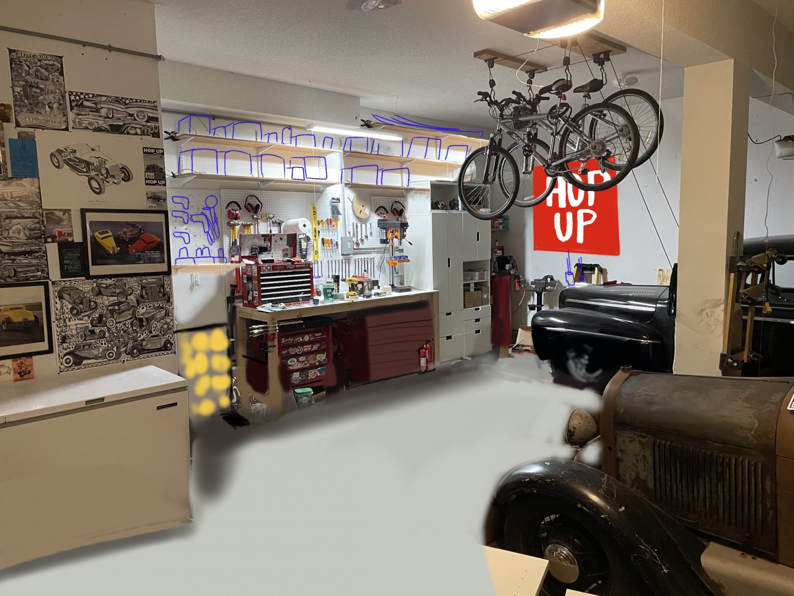

    Nobody likes an update with out photos right? 685DE0A3-1DD5-4841-9064-79BF69D0F5DB.jpeg not the car but at least it’s close to it lol
    got more peg board and shelves up, the parts bin up and started to fill it. 6 tubs of garage moving laid all over the floor. I’m trying to have the garage more or less operational by March 1st
    it’s been so long since I’ve messed with the car I’m starting to forget where I’m even at on it. Thinking maybe I’ll we read my own thread to refresh myself lol
    @J.Ukrop teased us with some new photos on his thread so that’s got me feeling a little more into messing with the car again.
    spring can’t come soon enough. Got some neat stuff in store :)

    Progress in the shop is progress on the car! I have most of a day free tomorrow I going to do something. You inspired me!

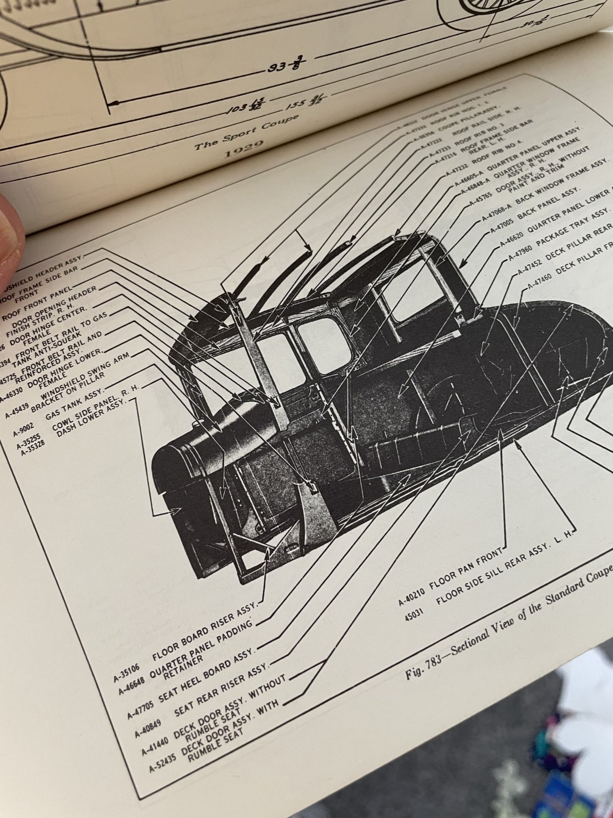

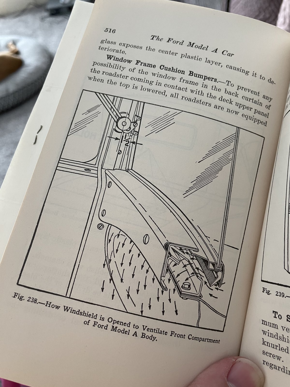

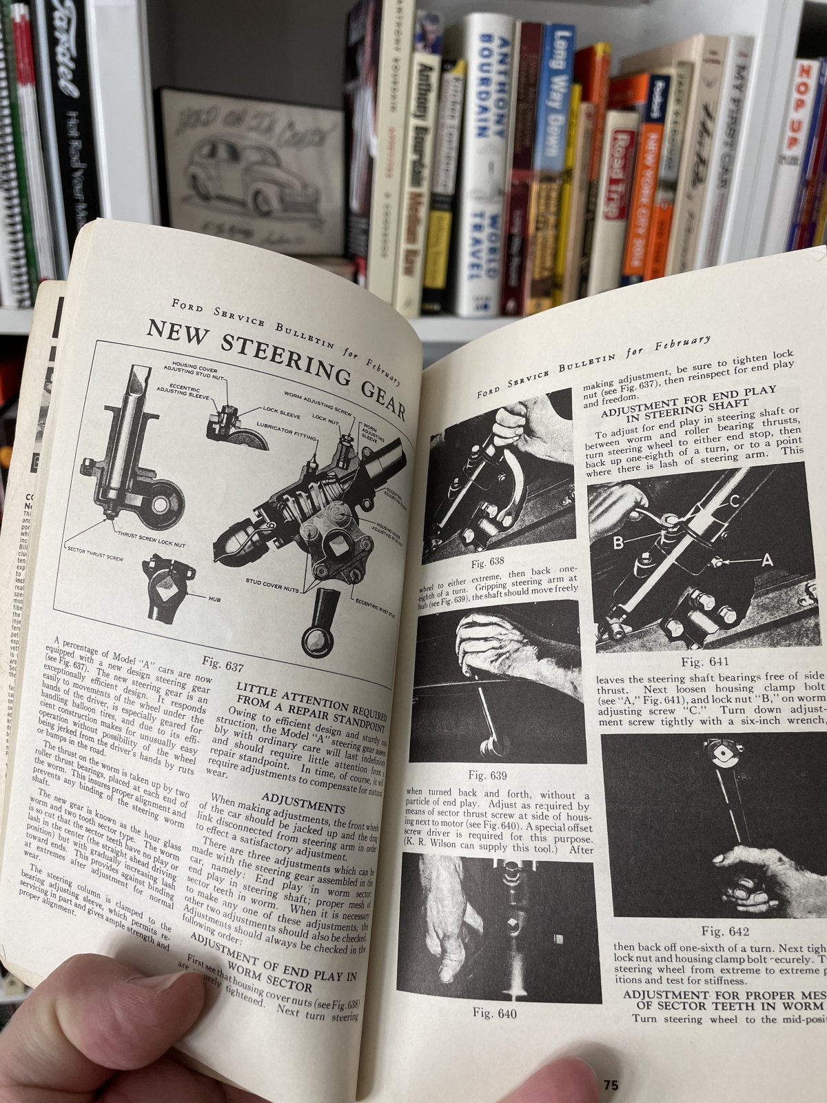

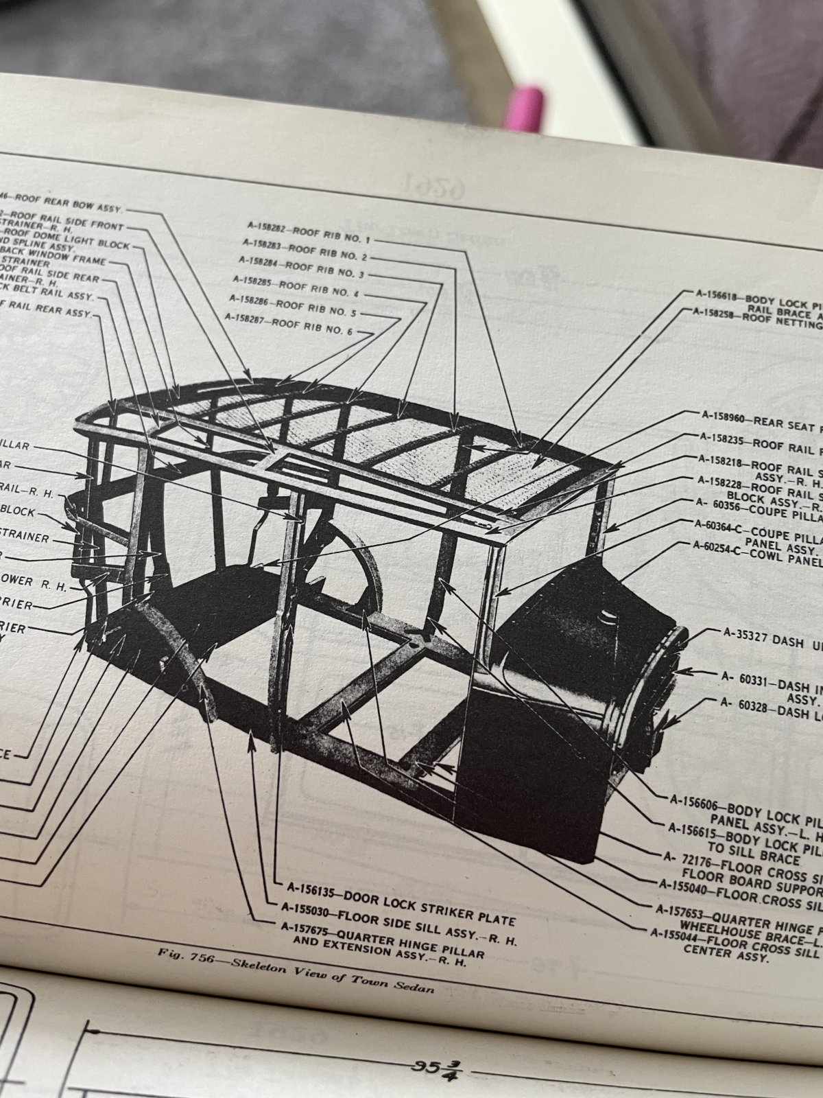

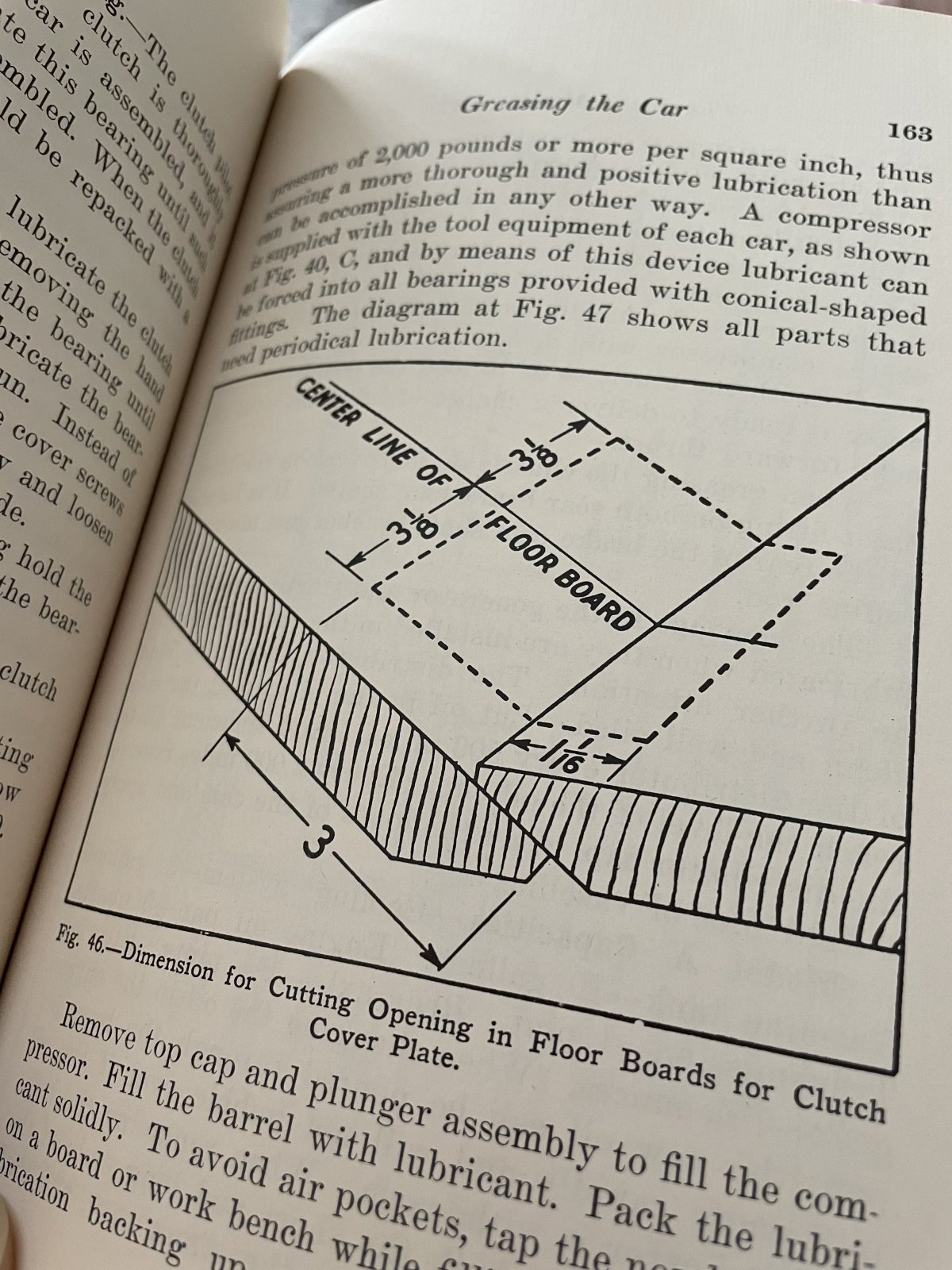

    No romantic prose of finding gold in a dusty junk store ba*****t like @J.Ukrop but that’s exactly what I did.
    3B2F1F86-4FF0-4C99-83A5-231EDF7B8B4F.jpeg 2787C9C2-E3FE-41B3-B707-F64D654AB189.jpeg I mean for $2.50 and $3.50 how could I not buy them? Ch***is book is way better than expected and just chock full of good info. The others I haven’t even opened but figure the rest of my
    Model A restoration materials generally have a diagram, a photo, or instructions that come in handy when trying to make a pile of parts a car.
    and with my new home so close to work I could feasible daily a totally stock model A. So, ya know just in case I should probably buy the book. Not at all because I love hoarding books or anything….

    These books are always chock full of good,
    Sometimes humorous, stuff. But what I really love is finding the paper trail of who owned them before me.
    most of the time they are well used books. Something they held onto, with a name and number maybe even an address in the front cover.
    or like these littered with notes and a book marks. I can tell the same person owned all three, and the s****s inside them date from the early 70’s to around 2013. Think they got their use out of it for sure! 7D1E20C5-70CF-4D7C-9A9F-390A95BA2E75.jpeg 6CA14E52-714E-41C4-94F0-1F39EECDD8F2.jpeg ACCAE983-69D1-40EE-8D9A-2C89678599F2.jpeg DA3F3CBC-6397-4A36-B4A7-852A588D54E2.jpeg DE328C47-BF20-43F3-A65F-CB86B24FADA5.jpeg 3FBF94CD-CFA0-45D4-8055-A3245F56DA27.jpeg C3FF9649-3981-4676-B130-B06E1428632D.jpeg CB19531D-31F6-4F02-840D-94A0230B682E.jpeg 46971D4F-93F2-4370-ADC0-F5883F82604E.jpeg 9AD97089-D166-4ECF-91C0-74B201E39866.jpeg

    Well dadgum, I don’t even own the books and already learned something valuable from them…like how the air ventilates through the dash garnish. I really like those body diagrams too!

    @drdave good stuff. Even diagrams of where the wires are routed in each model
