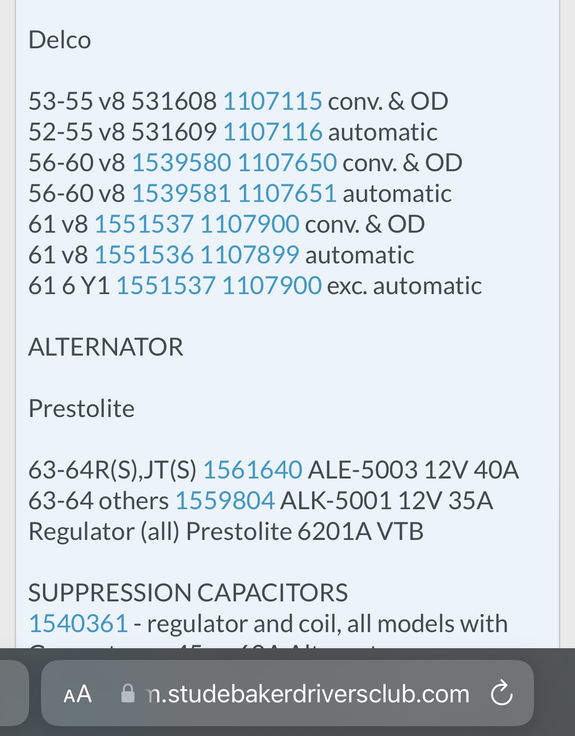

    Been nosing around seeing what’s out there for starters. I found one questionable source for a mini gear reduction starter and found a seemingly legitimate part number for the specific starter I need. IMG_0384.jpeg
    Delco 531608 and 1107115 are the two stock options for this combo. I’m ***uming conv means conventional aka manual. So the 531608 is possibly the 4 speed starter such with an 1/8 inch shim works for the 3 speed with over drive setup.
    the biggest thing I’ve had to reiterate when looking for this stuff is that the 6 volt and 12 volt starters are completely different outside of the tooth count on the drive gear and the bolt on flange.
    the 6 volt not only has a different style cover but the guts are a slightly different style and has a much larger shaft. The drive gear is physically bigger the drive gear has a roughly a .15 bigger diameter. No parts exchange between the 6 and 12 volt starters.
    The work around if you want to use a 12 volt starter - with the correct length nose cone as 3 speed, 4 speed speed and auto are all different lengths- is changing the flywheel for one off a 12 volt motor.
    56 and newer 12 volt starter = 56 and newer flywheel.
    was surprised to find they made so many different variations given the engine remained basically the same for the entire run.
    It’s as if Studebaker saw Fords endless interchangeability and standard tapers and bolt sizes and said let’s do the opposite of that. Lol
    oh well it’s a fun rabbit hole to have dove down. Gonna try to start cleaning my motor and trans up today. Fingers crossed

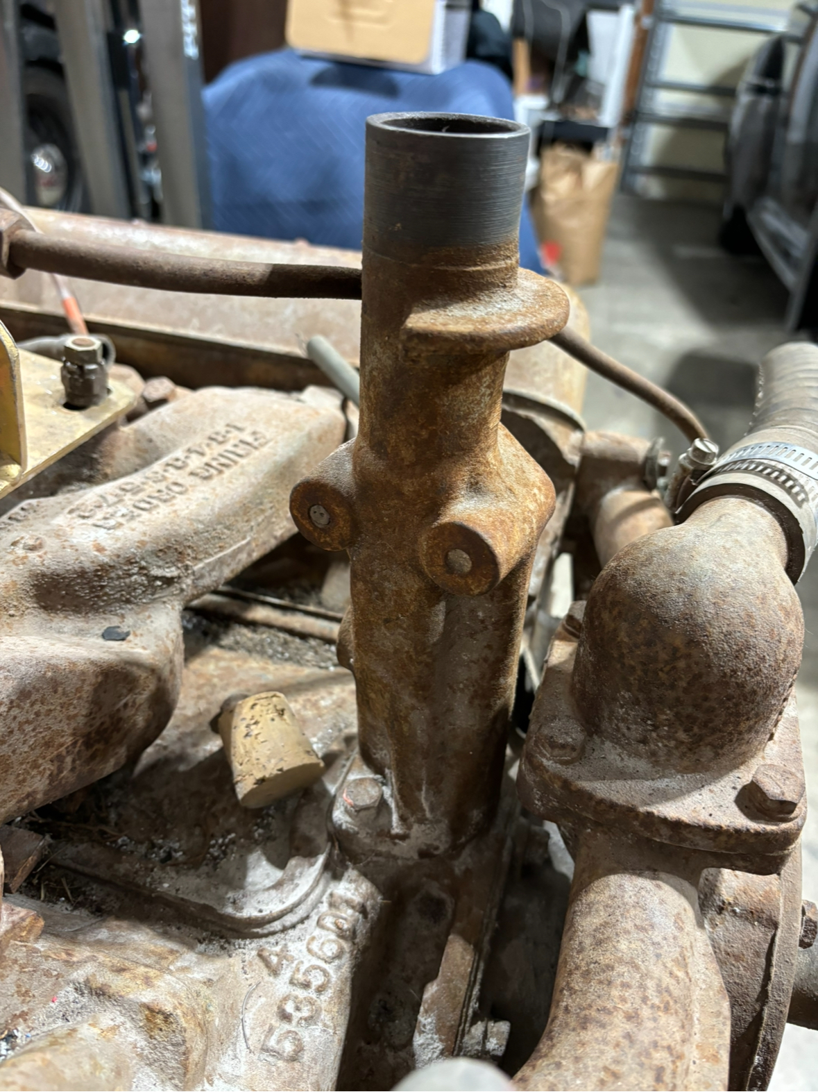

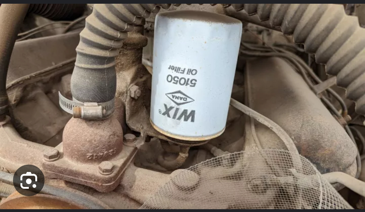

    on a stude note I’m looking at this giant oil breather stand and trying to see what all the flats and holes are for IMG_0392.jpeg IMG_0393.jpeg I’ve seen the oil filter bracket bolted to the p***enger side but I’m not sure where the hoses connect to.
    the flat spot on the drivers side the only thing I’ve seen there is a gl*** bowl fuel filter but most the time it’s empty or holding a carb return spring.
    I do see a hole routed to the hole near the bottom drivers side, mines blocked with the plug with a slotted head. I would ***ume it was a vacuum source?
    many reason I can’t make a shorter breather neck out of pipe if all I’m using it for is a breather and oil fill?

    Is that right over the fuel pump lobe on the cam? That flat looks like an uncut fuel pump mount to me. Could be driven with a rod like a flathead. Maybe for some AG or industrial application. We had one with a sheet metal timing cover. The only one I've ever seen. The engine was blue. I'll have to look and see if any of mine have that kind of breather stand.

    It’s like that on every picture that comes up when I Google studebaker 259. Got a line on a local stude club gonna see if I can find some local guys to trade info with.
    Stogy likes this.
  20. Tim
    Joined: Mar 2, 2001
    Posts: 20,831
    Tim
    from KCMO

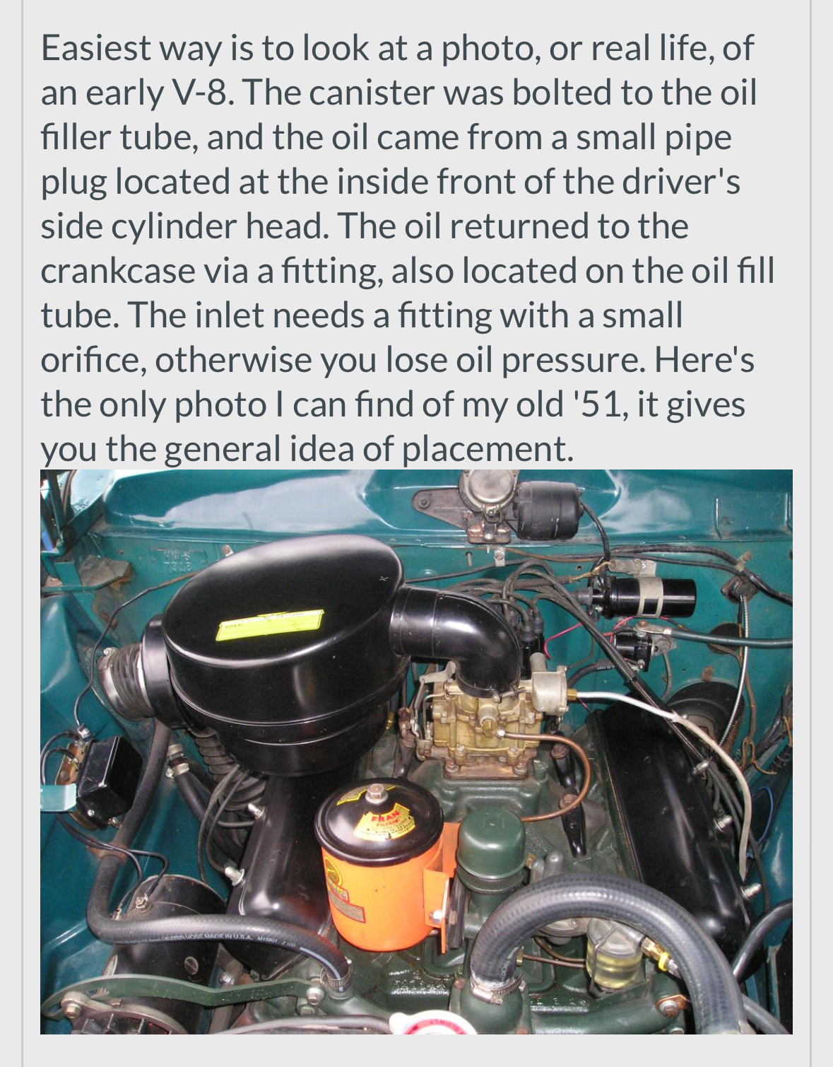

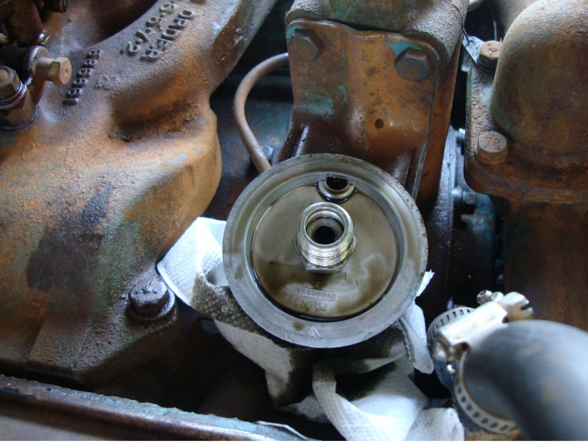

    Ok went snooping and found. One with a fuel pump where you mentioned and where I thought I was seeing only a filter! Could be a slick trick if you were out of room for the lower mounted pump.
    also a few photos of the filter bracket bolted to it.
    seems the oil for the filter comes out of a small port in the front of the drivers side head and in threw the top hose of the filter then out the lower.
    seems to be some debate of where it goes from there but the two routes I’m seeing are into the fuel pump boss which would line the push rod and the other is a boss in the pump stand/ breather tube which I believe to be the hole I see blocked with a slotted plug. The oil going down this tube would apparently drain down over the timing gears- no chain on these- and back into the pan. IMG_0405.jpeg IMG_0406.jpeg IMG_0407.jpeg IMG_0409.jpeg i did see one other style breather tube that was similar height but no where near as beefy looking. I’ll see if I can back track and find it
    Thor1, Stogy and Six Ball like this.

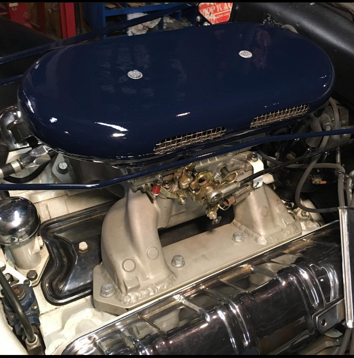

    Found it. Looking at the valve covers it’s possible a later stude not sure that makes any difference
    Thor1 and Six Ball like this.
  22. Tim
    Joined: Mar 2, 2001
    Posts: 20,831
    Tim
    from KCMO

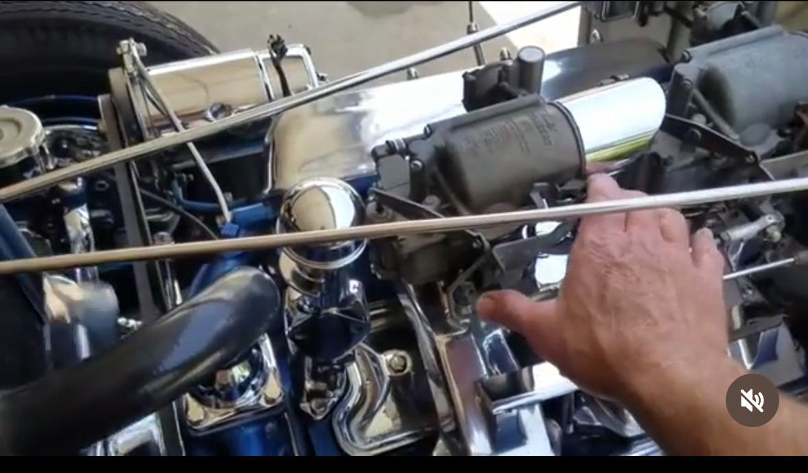

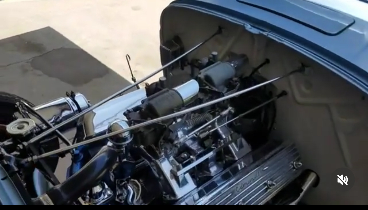

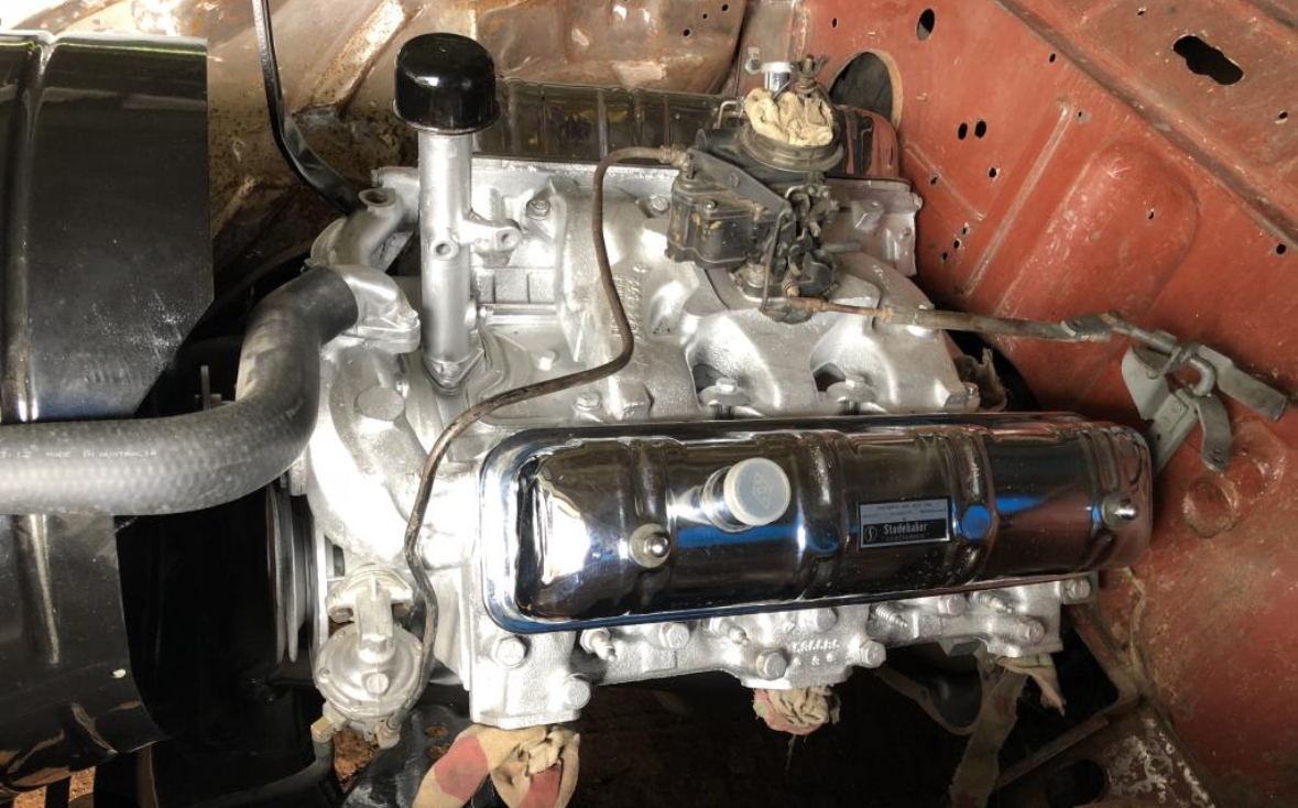

    Looks like Tom and Diana Branch both run a full length stock breather but chromed and Tyler runs a shortened or fabricated one IMG_0416.jpeg IMG_0415.jpeg IMG_0414.jpeg IMG_0413.jpeg IMG_0411.jpeg
    also that’s a mopar 318 air gap intake cut and welded to some flanges on Tyler’s set up with the single 4 barrel.
    guthriesmith, Thor1 and Stogy like this.

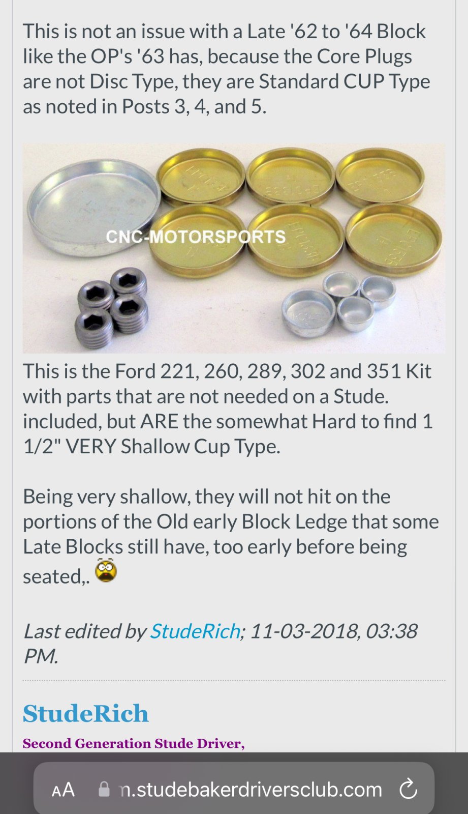

  24. Coming in late again, my girls '60 Lark has the fuel pump looking boss and the hole below it with a pipe plug. Early fuel pumps on the oil filler and a return for the oil filter on drivers side of the oil fill tube and oil filter holes on p*** side of fill tube.
    More tips as I remember them,

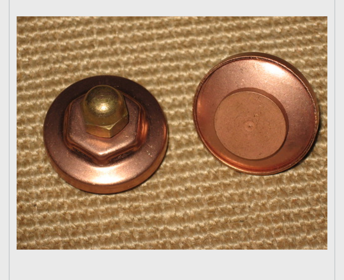

    **Get the stock fuel pump with the gl*** filter on the bottom, rebuild it with a Now and Then Automotive kit (ethanol resistant). The Carter replacement pumps leak oil after awhile from the arm pin and the pin comes out, thankfully the stock fuel pump bolts keep the pin from falling out.
    **If you're rebuilding the motor, have the machine shop bore out the freeze (core) plug holes out to fit in SBC cup plugs. The stock disc plugs REALLY **** if your block doesn't have 100% of the stop intact (a lot don't).
    **Make sure they clean out the block REALLY well (or you do if not rebuilding). Not sure about the older motors but around '60 era there could be some casting sand still left in the block.

    im curious how much bigger the chevy cup shaped plugs are than the stock stude ones. I’m curious if there’s not a indext chart where you could find an existing one by size but given how “thrifty” I hear Studebaker guys are if there was a way to do it without machine work they’d have found it lol

    I missed the part number but these Dorman br*** expansion plugs seem to be in favor. 1 1/2” for future reference. IMG_0419.jpeg Also a ford 289 has a very shallow 1.5” plug that I guess works on the later motors but I’m not finding a consensus on early. They do recommend red thread locker either way IMG_0418.jpeg did find this on the drivers club so thought I’d leave the address showing in case someone wants to follow bread crumbs

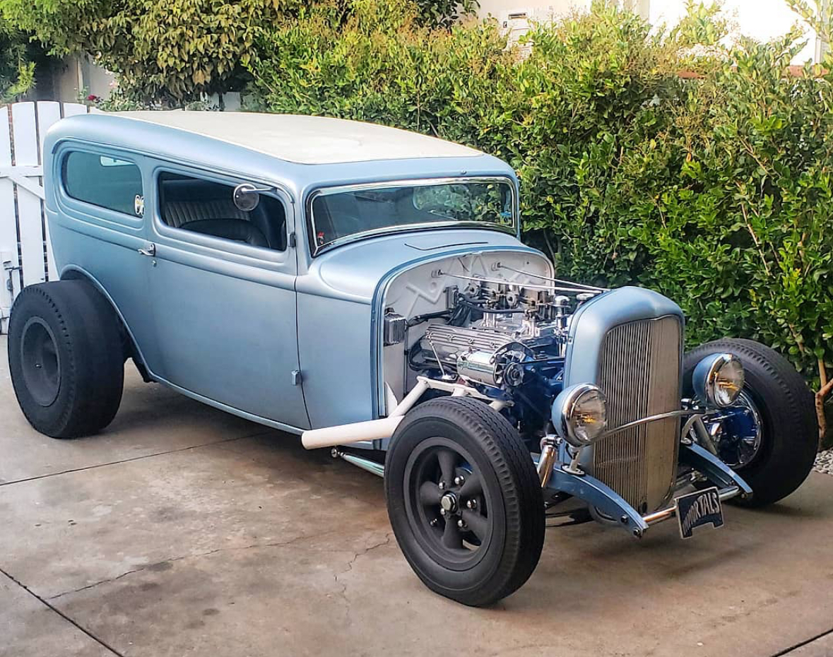

  29. Those last two rods up above are Diana (Tudor) and Tom (Gold roadster) Branch's cars

    Yup, I mentioned that I believe. I actually took the photos of Toms car a couple weeks ago.
    While your here Trent you know of anymore stude powered hotrods? I’ve found a few mocked up but outside of Dean Moons 34 and the Branches cars nothing driving to be found.
