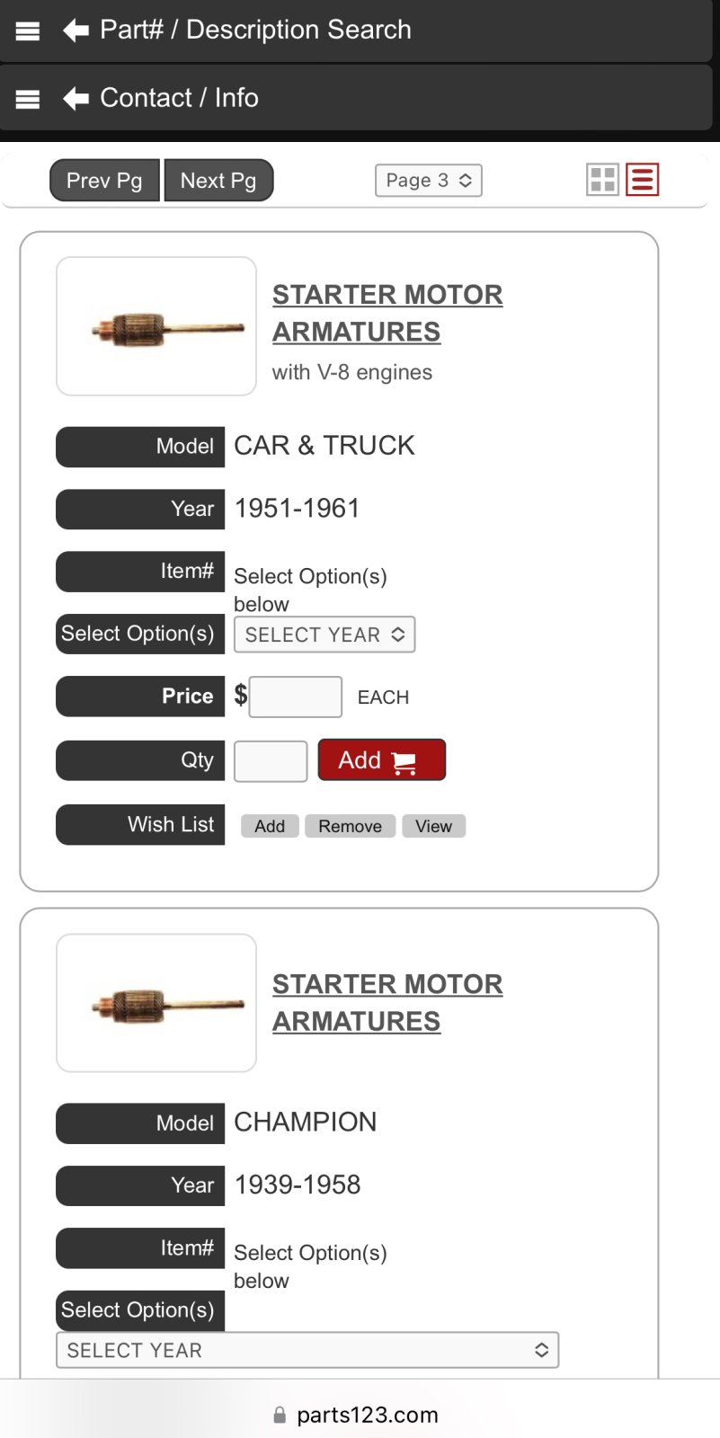

    @Six Ball yesh looks like 77-88 amc/ jeep has a 9 tooth gear with a 25.1 mm diameter compared to the six volt 29mm gear. If you could swap gears that would be a cheap starter quick as I see those jeep starters for like $100 new.
    I’ll take photos of the trans as I unearth it from the caked on oil

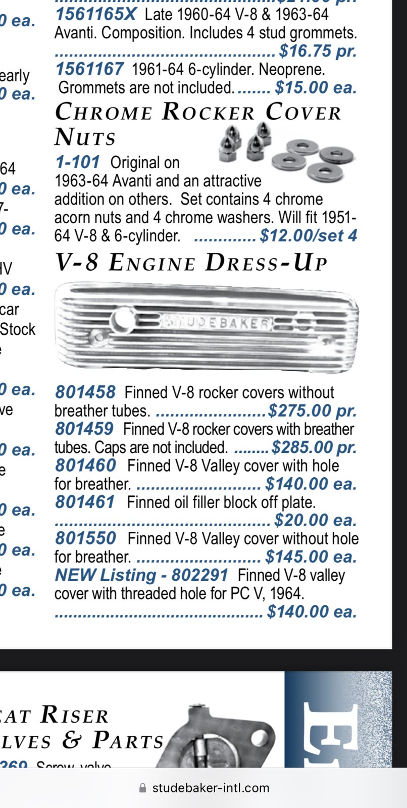

    I have seen a few finned valley pans/covers. I think O’Brien truckers maybe makes one that’s in stock?
    There’s a two bolt finned cast aluminum valve cover that has a few different versions of Studebaker in the center I see pop up here and there. I think the casting floats around and they get done in small batches. The few I’ve seen look like a fairly rough cast. They do look neat though.
    hells gate hotrods offers header flanges, intake flanges and u fab log intakes for them as well.
    I can’t remember who else had a valley cover readily available new. I’m sure I’ll trip across it again sometime soon. Really I’d like a chrome one. Need to call the local platter and buy a lotto ticket lol

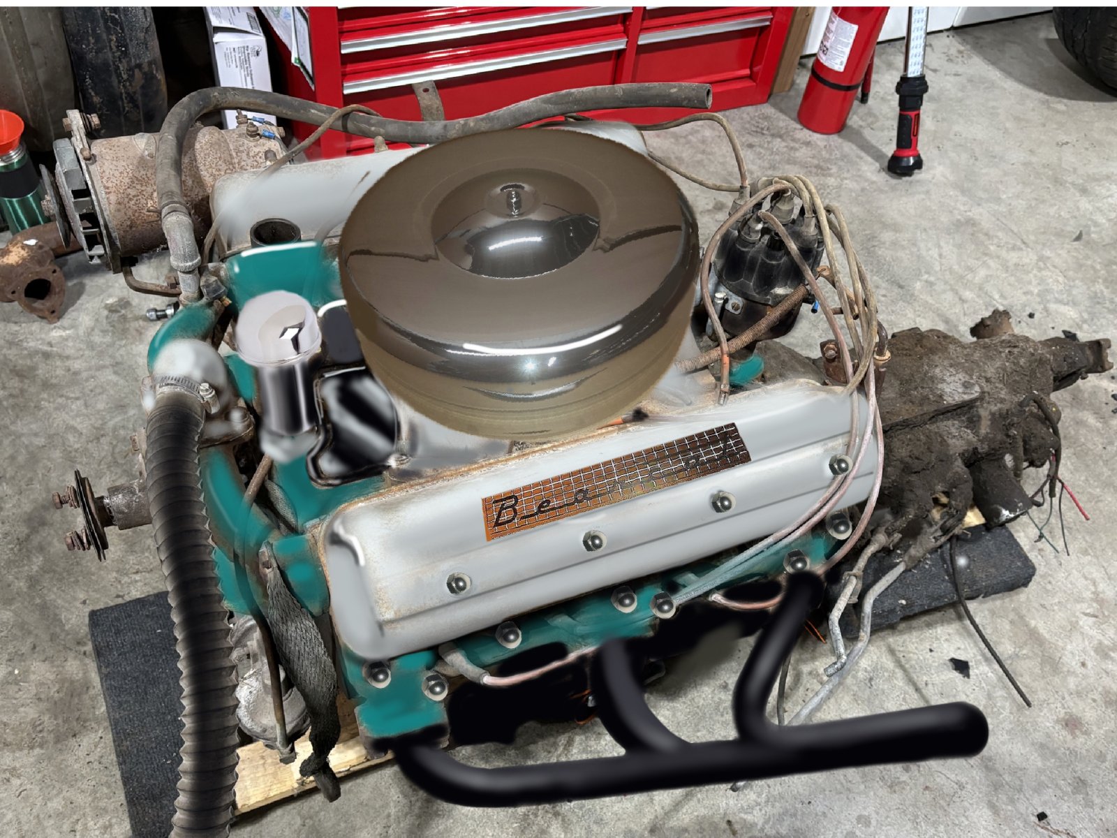

    Guess I never shared this mock up rendering of dressing the motor. Untitled_Artwork.jpeg Thought it could be cool to do a rectangle of engine turned gold leaf and then letter bearcat on it to emulate the stock sticker.
    if my chrome budge actually existed I’d chrome the headers, stock valve covers, valley pan, breather, cap, and the fan.
    you know stuff that unbolts lol
    Ideally this will get a hot ignition, a new or rebuilt 4 barrel, headers, an aluminum timing gear and a cam.
    redzula, brEad, Thor1 and 4 others like this.

    My 53 Hardtop had Bearcat on the covers, I never noticed the gold color. That's going to look great.

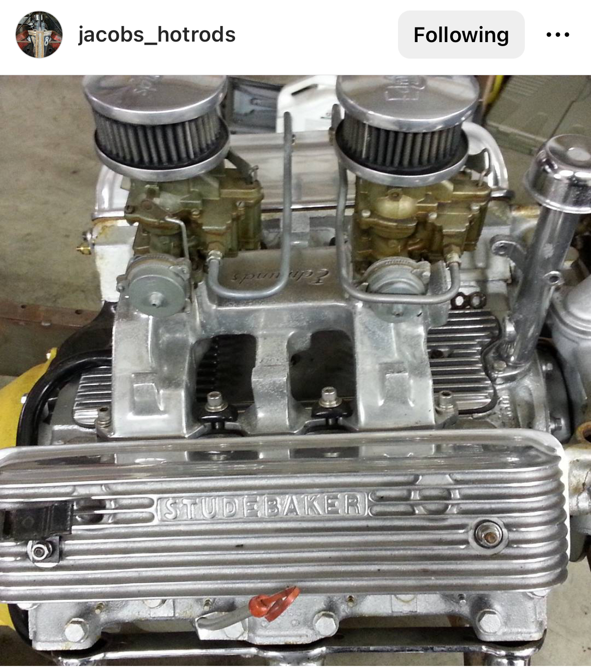

    For your list: Mike VV . Worth reading, listening to. @Mike VV
    Caddy intakes *can* be adapted, but you're going to have a hell of an offset for the very front & rear most port edges - like 3/16" each. Lotta grinding... Or section the manifold 3/8" across the center & rejoin. Hence, the D.Datson street-ram, could be easily tailored for what rpm you wanted to use it in & 2 - 2bbls(like, say, 2 of the stock ones) for better fuel distribution. You are correct, 1 4bbl, ~ 500 cfm is enough, edelbrock 500 has worked very well for many folks. You could use smaller, like the 390's, ~4**'s. Originally, they used wcfb's. There is an Al 4bbl manifold, which is a copy of the oem, & has the same flow limitations, esp in at least 1 runner. Lighter, nicer looking, more expensive, same essential performance as stock. Not sure on new cams, but regrinds in R-1, R-2, & slightly hotter are available from at least couple of hi-po stude dealers. R-1 & iirc, R-2 are good on the street, esp w/a little engine work. I trust these guys, have dealt w/them, they're good as can be. Higher compression really helps stude v8's, but regaining the Quench that the factory never put in is what helps the most. & the best thing is supercharging( ~ 6psi), works on decent stock engines, as the factory demonstrated so often. 2 or 4 bolt valve covers work on either late or early heads, just gotta have the stuff for them - which look do you prefer? & even though there's a fair # of head casting #'s, not much difference twixt them(I'm talking about the 224, 259, 289, 304 - not the 232 ->they'll bolt up, but small ports n valves) other than compression ratios. & that can be changed a couple ways. & the R-2 heads for a blower are actually truck heads w/1point lower compression. Forget about the super rare R-4 heads, MikeVV heads outflow them, iirc. & that is one hard problem w/any factory stude head - they literally will only flow so much w/o a blower, period.
    Also - *needed* is a *factory* manual. & please don't "build" them like chevy/ford/chrys. Stude actually designed & built it's own engines. They did have a lot of the "old ways" construction, it's just something that you have to know about, it works just fine, esp stock, or near stock. Mill looks good. You are going to be one happy man - esp w/the OD.

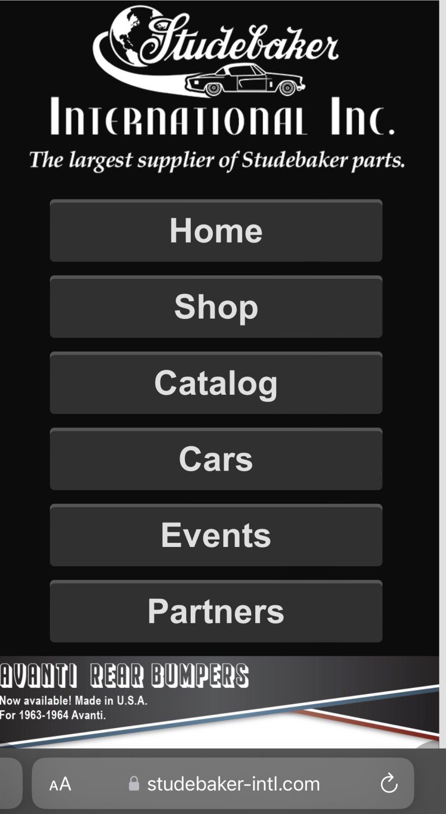

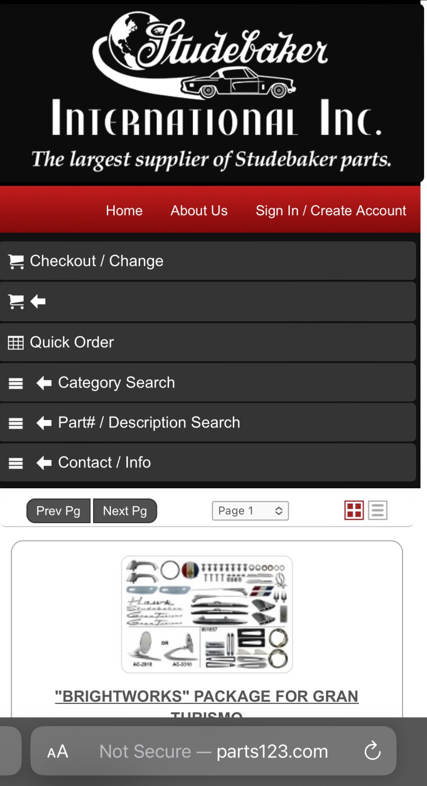

    I’ll read that in a minute Marcus :) just came across https://www.studebaker-intl.com/catalog.html again. Studebaker international. I think they are in Hope Indiana and from what I can tell havnt printed a catalog since 2014 but have moved to using a third party host for the online sales?
    IMG_0597.jpeg Secure ^ that’s a good sign and the page isn’t outdated
    IMG_0596.jpeg But I clicked the shop and it showed not secure?
    IMG_0598.jpeg Did. A quick google and they seem legit enough IMG_0599.jpeg went back to try and figure out the search features and noticed once I started actually using the page the result pages are secure? IMG_0600.png and there’s the valley pan I couldn’t quite remember! IMG_0595.jpeg their 2014 catalog is viewable on the website and as a pdf to print but at almost 400 pages I’ll save some trees.
    anyone used them before? The reviews for the business itself in person online seem favorable but it’s just vague enough wording that no forum posts are coming up chatting about them one way or another.

    I’ve seen this page before which is not secure but their Instagram makes me believe they are probably legit. http://mystudebaker.com
    One of the perks of the websites being clunky and generally run by older guys is that I get the feeling I can just call them and order which makes me feel more comfortable a lot of the time. I get **** for it all the time at work where everyone does supply orders online and I’m still calling them right after they get back from lunch. But I kinda like that now they know who I am, and they generally give a hand with low stock items or let me in on a sale or discount I probably would not have noticed.

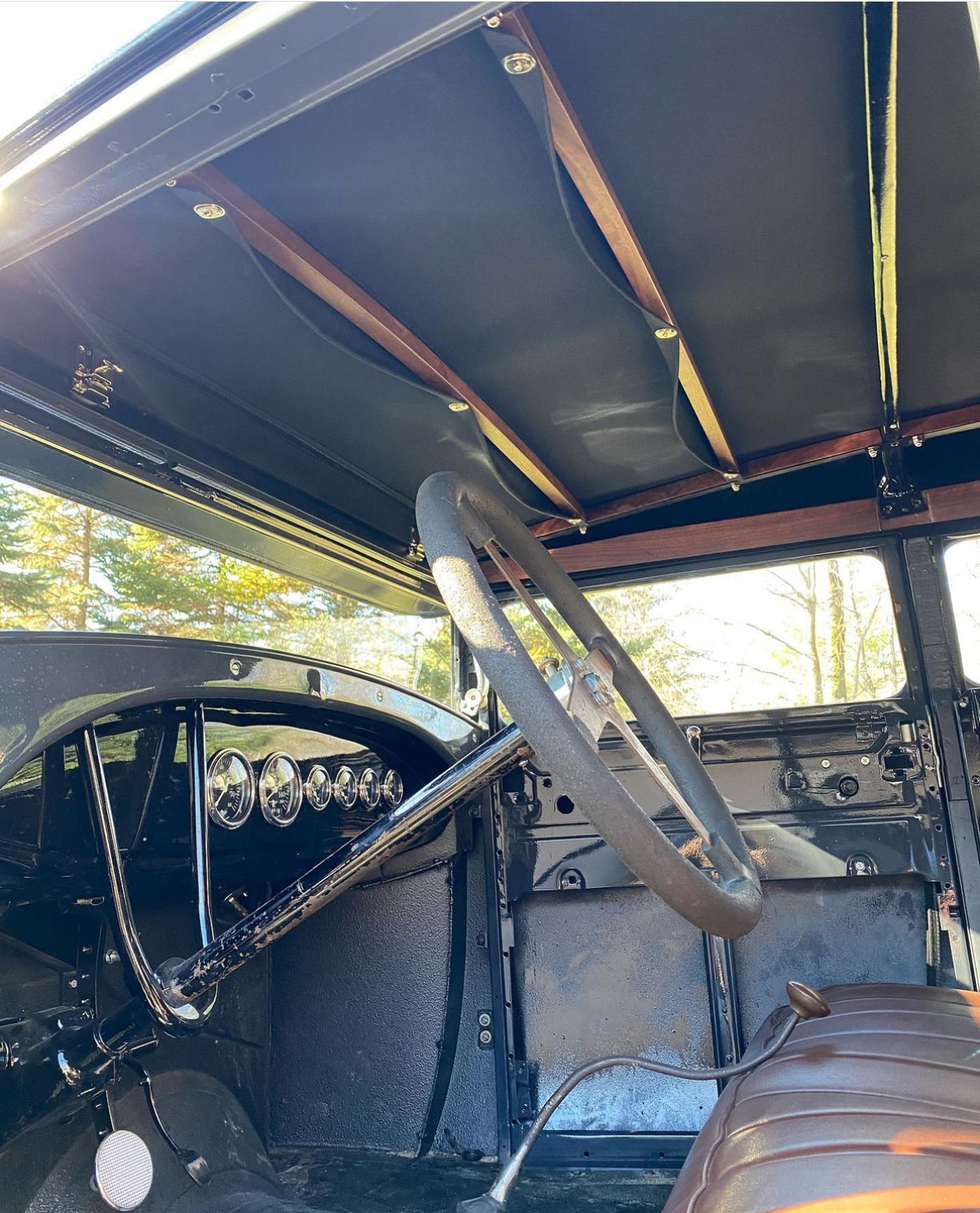

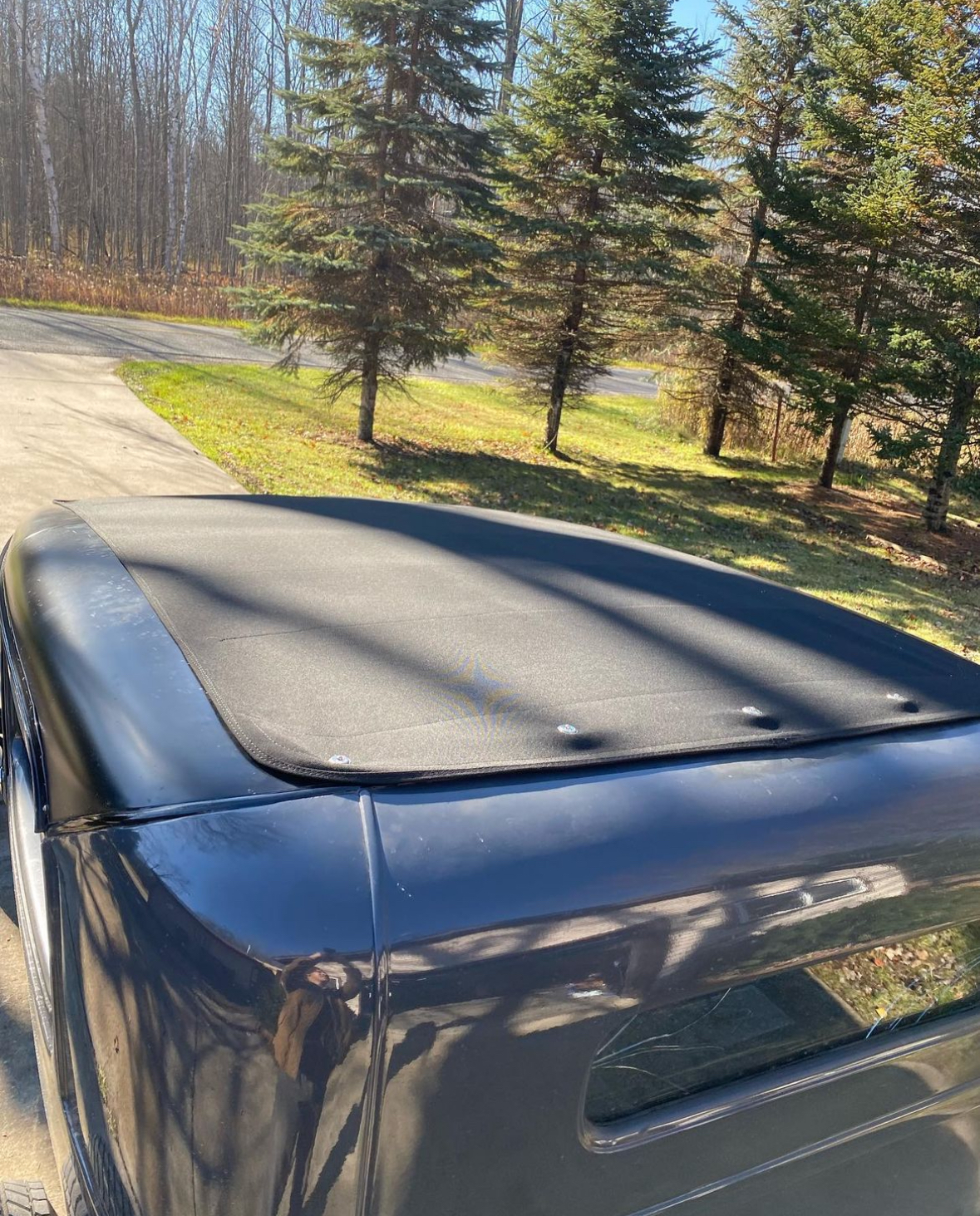

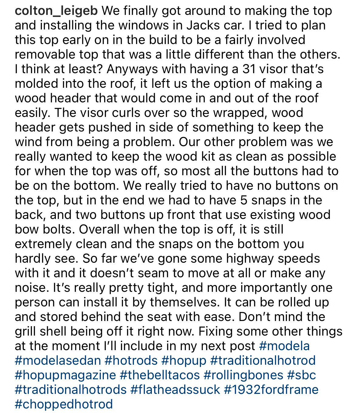

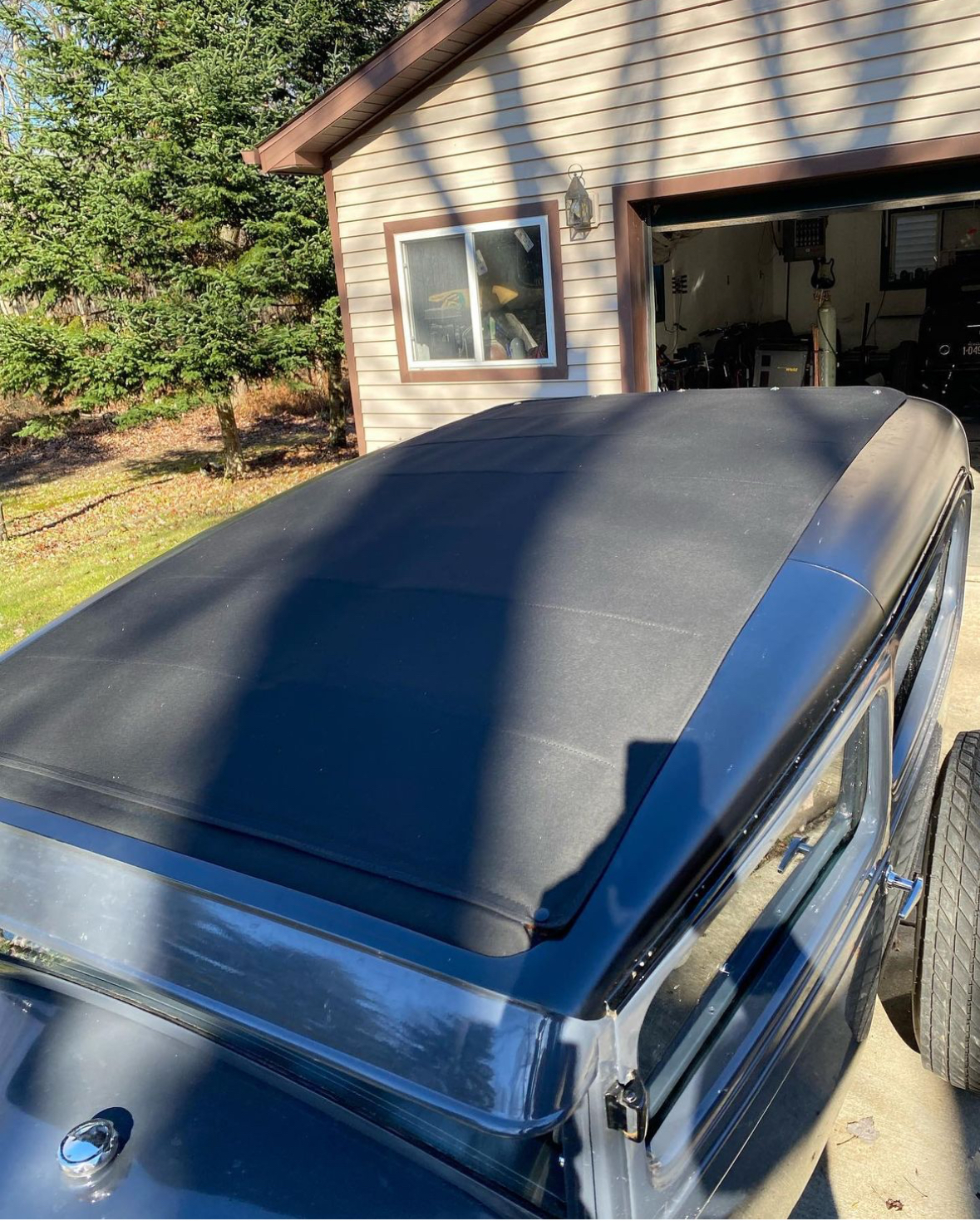

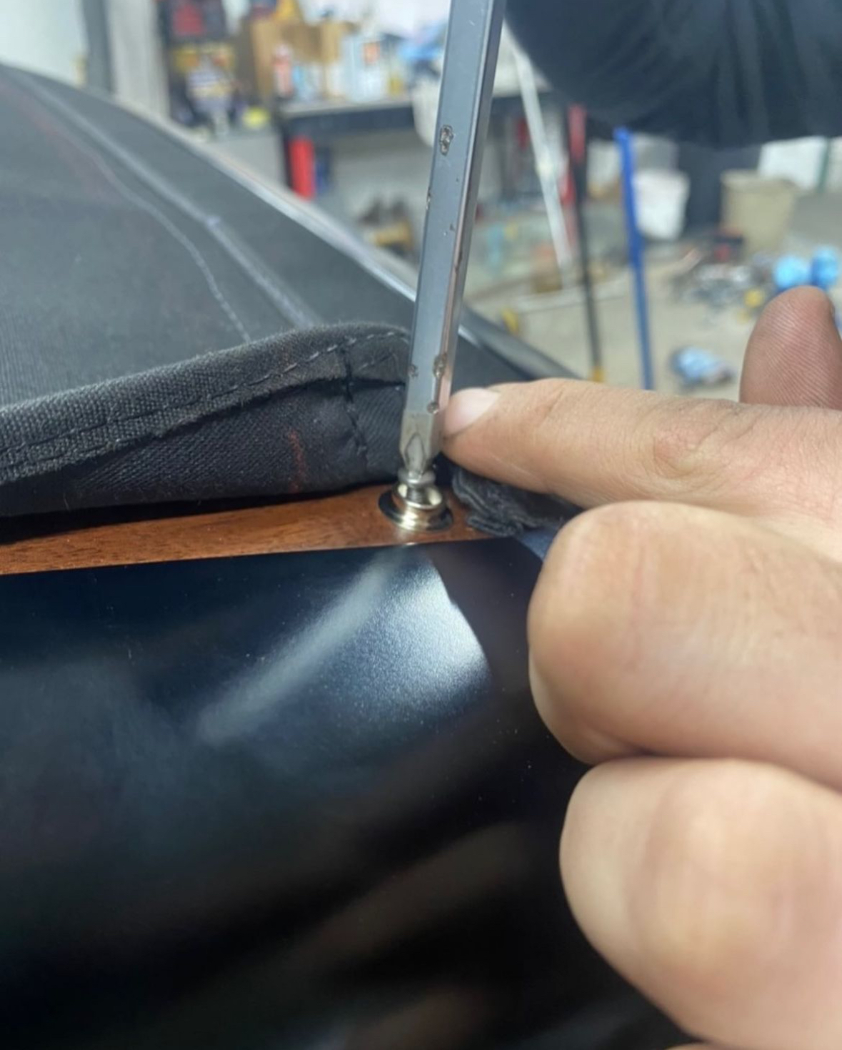

    in non Studebaker model A news Colton - can’t remember he’s his hamb handle but he rarely posts- posted this top he did for his buddies sedan.
    really clever thought I’d share it and save it for later.

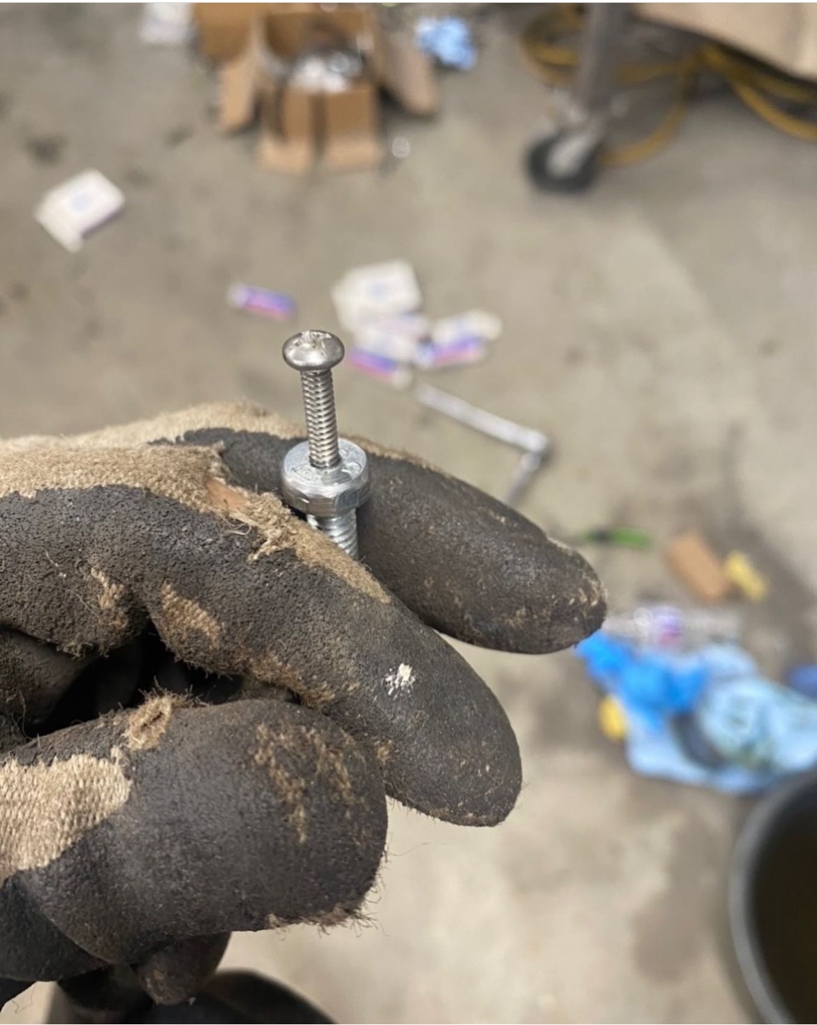

    bought some of those rubber washers that are fused to a metal washer today to stick under the valve cover nuts to get this back together for now and then go back to s****ing stuff off the trans. These valve covers were like glued to the heads. The covers don’t feel especially flat but all I see is old gaskets so maybe they had em cranked down good.
