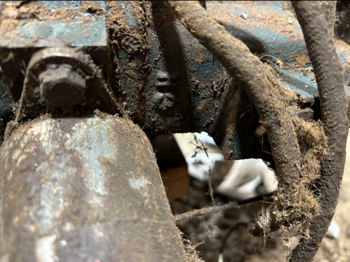

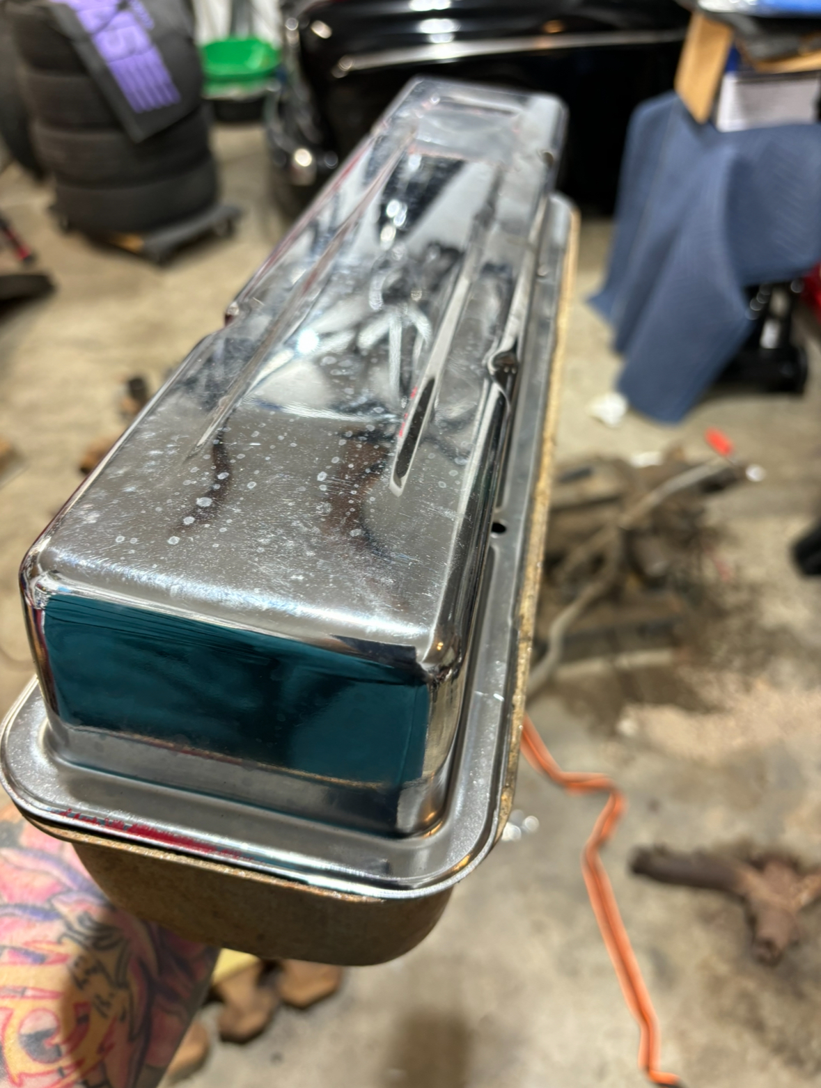

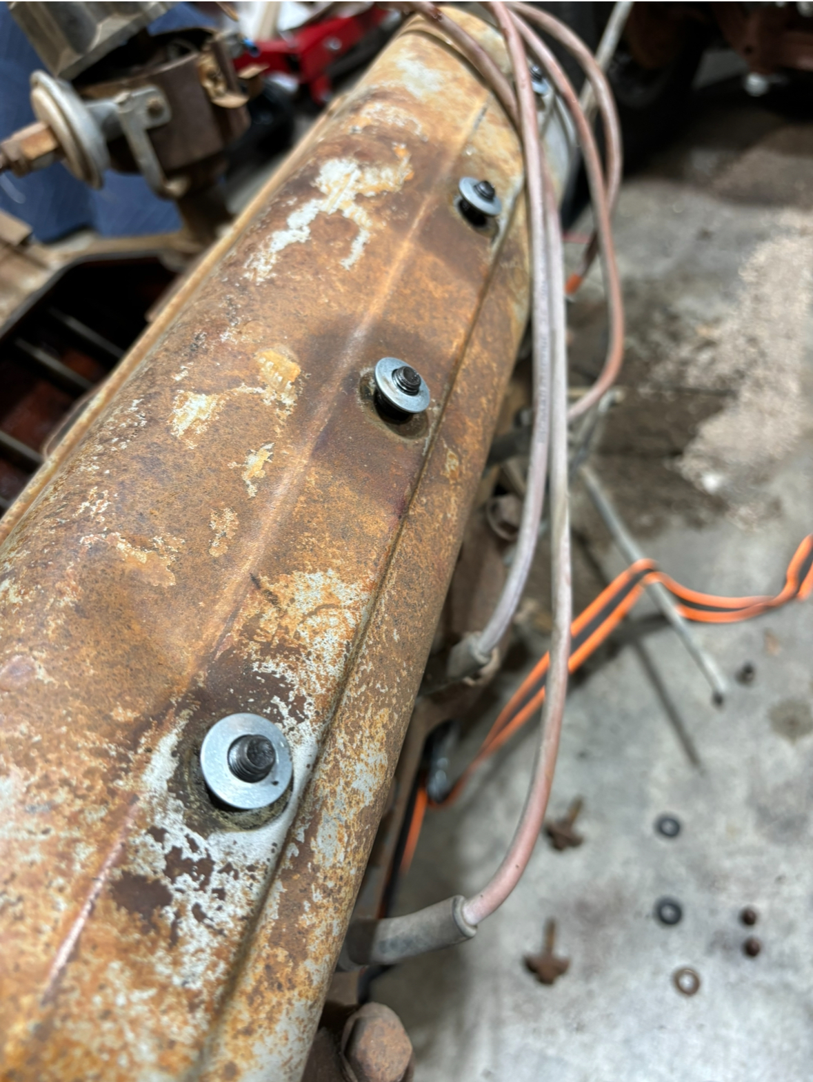

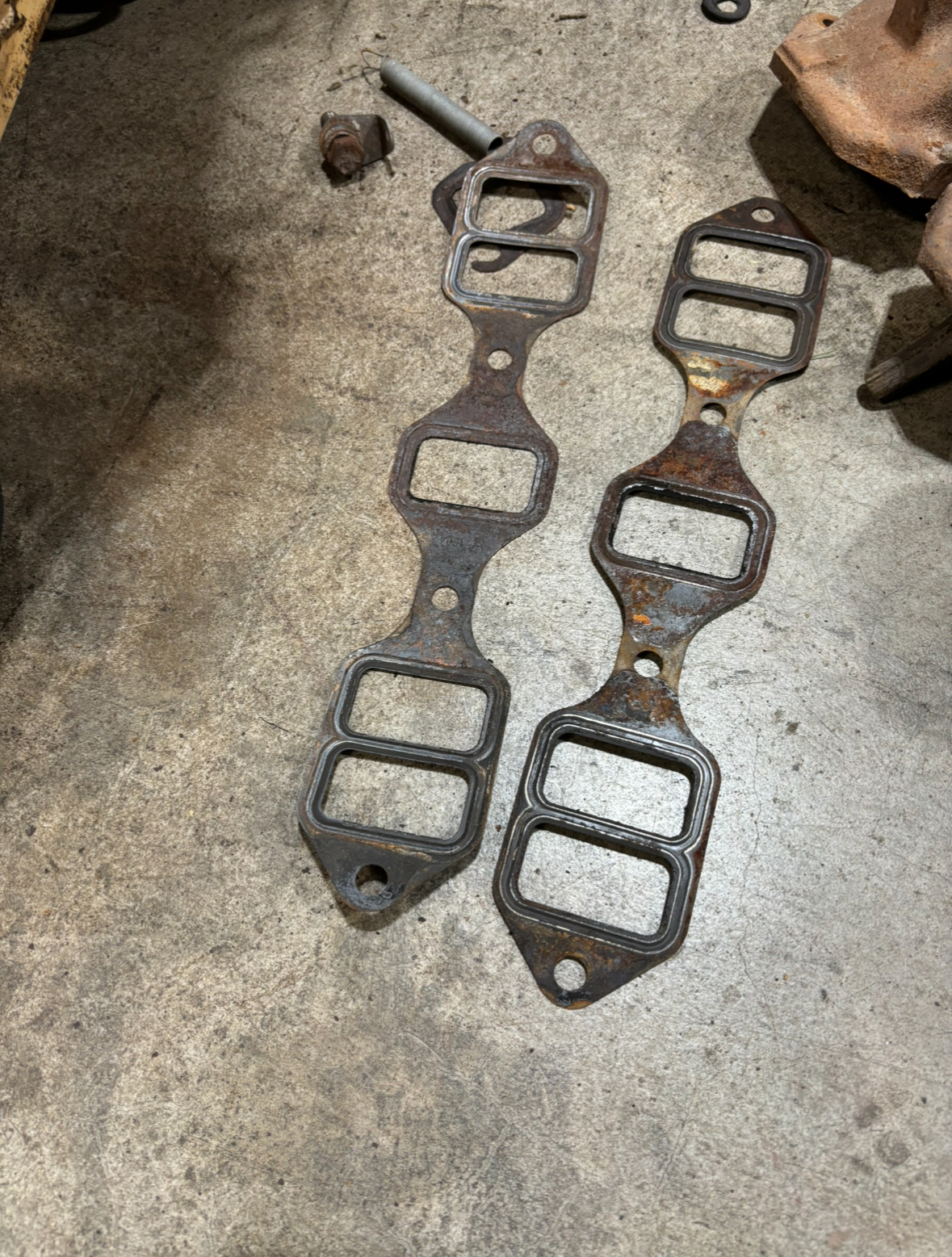

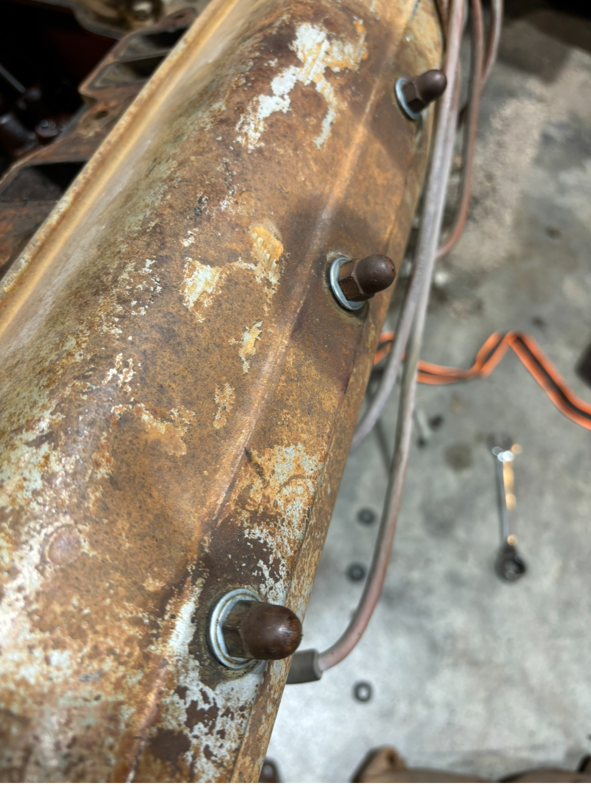

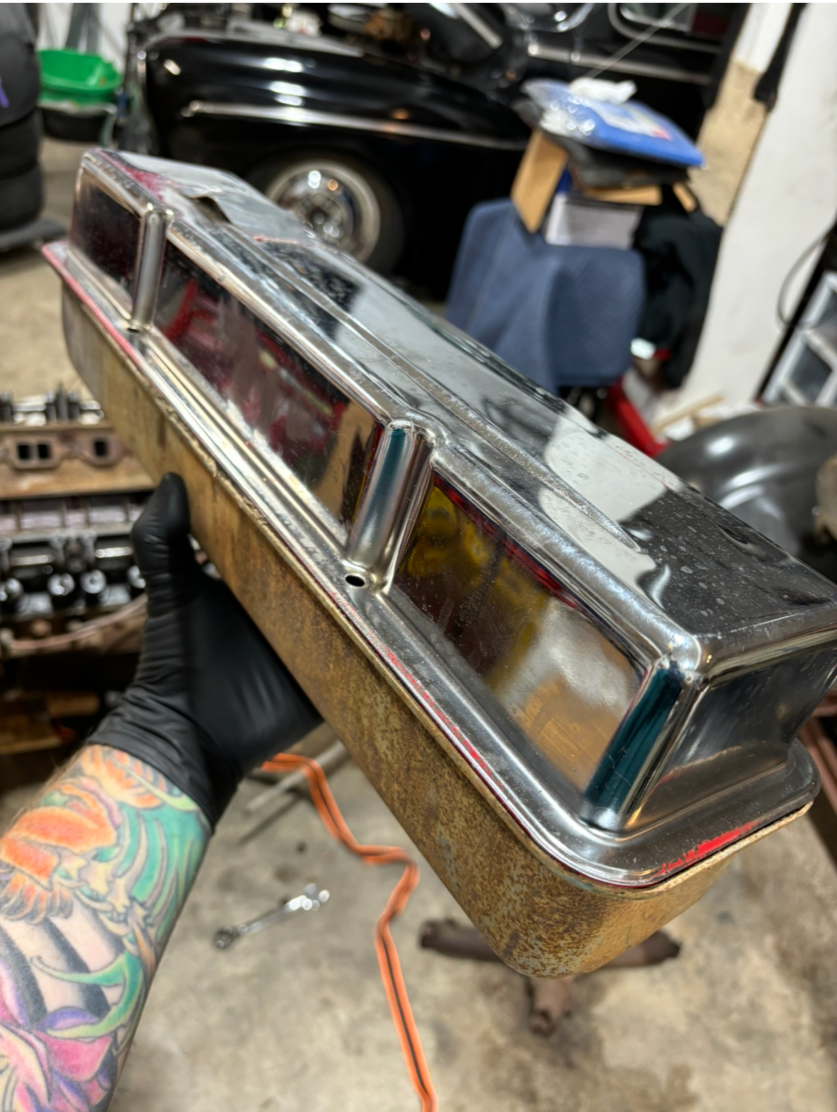

    Quick morning update between chores IMG_0711.jpeg IMG_0712.jpeg sbc valve cover has a nearly identical foot print. Maybe trim off the eyelets but I see no reason the gaskets wouldn’t work. I was shocked how easy those covers went back on the 259. I think I’d have to glue the gasket to the valve cover to keep it in the right place while installing though. IMG_0713.jpeg Random photo of the intake gaskets as previously mentioned. IMG_0714.jpeg IMG_0715.jpeg The rubber, neoprene?, fused washers with a marked 5/16 ID fit perfect. I pushed and twisted them over the studs and then used the acorns
    To snug them down. The stock grommets are a hard plastic, are they part of bottoming then acorn when tightening them? Or does the cover tighten against anything at all behind the nuts? Seems like it would be easy to over tighten these and warp something if not. I just got these just on the right side of snug and called it good. I’ll probably buy the stock replacement grommets but for fifty cents a piece I figured these rubber/

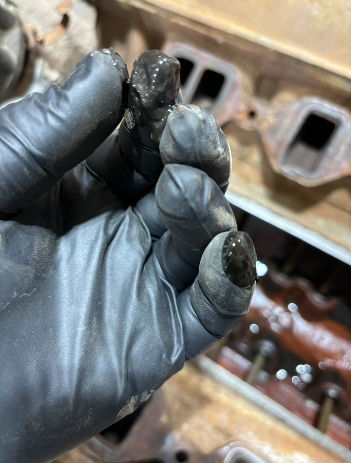

    Metal washers would work to keep **** out. IMG_0716.jpeg IMG_0717.jpeg i dipped a finger into the oil, no sparkles or weirdness but a deeper swipe and I pulled out a battleship gray sludge. I’m ***uming it’s just your standard motor oil sludge, I wiped it out a bit with my hand but I’ll clean it all the way before I put the intake back on.
    this also makes me feel better about having to pull the pan to inspect the timing gear as I’m
    Sure that pan needs cleaned out.

    I've found for rocker-cover gaskets, valley cover, etc, I clean the cover, then used "the Right Stuff" as a glue(other stuff works too, but most eventually let go due to hot oil degrading the metal-to-gasket-bond) for the gaskets & to let it set, put the cover gasket-side down onto waxedpaper laid on a flat surface(maybe w/a weight on it). I've also used tRS as a whole gasket, using the waxedpaper deal. It did take awhile to set properly, but the wait was worth it. (I've since found that silicone-based sealants won't set against waxedpaper, don't remember what tRT is made of. I might've lightly oiled the waxedpaper 1st, can't remember. Been ~ 20yrs since I did it. Was an experiment, & it did work, Stuff helped dry-up engines' outsides). No glue on the head side. Don't really like the chez-whiz-can effect, but it did work well.
    Used it on other need-to-***emble-now parts, just used a very thin bead. I prefer a paper-thin coating of sealant on each side of a proper gasket. I also got away from the felt crank seal w/a neoprene seal kit for the die-cast crank/cam gear cover. Which works very well(slight mods needed), but neoprene doesn't like to sit for long w/o oil. So consider that.
    There are better things on the market now, but I haven't used many of them lately.

  13. Tim
    Posts: 20,781
    Good info thanks

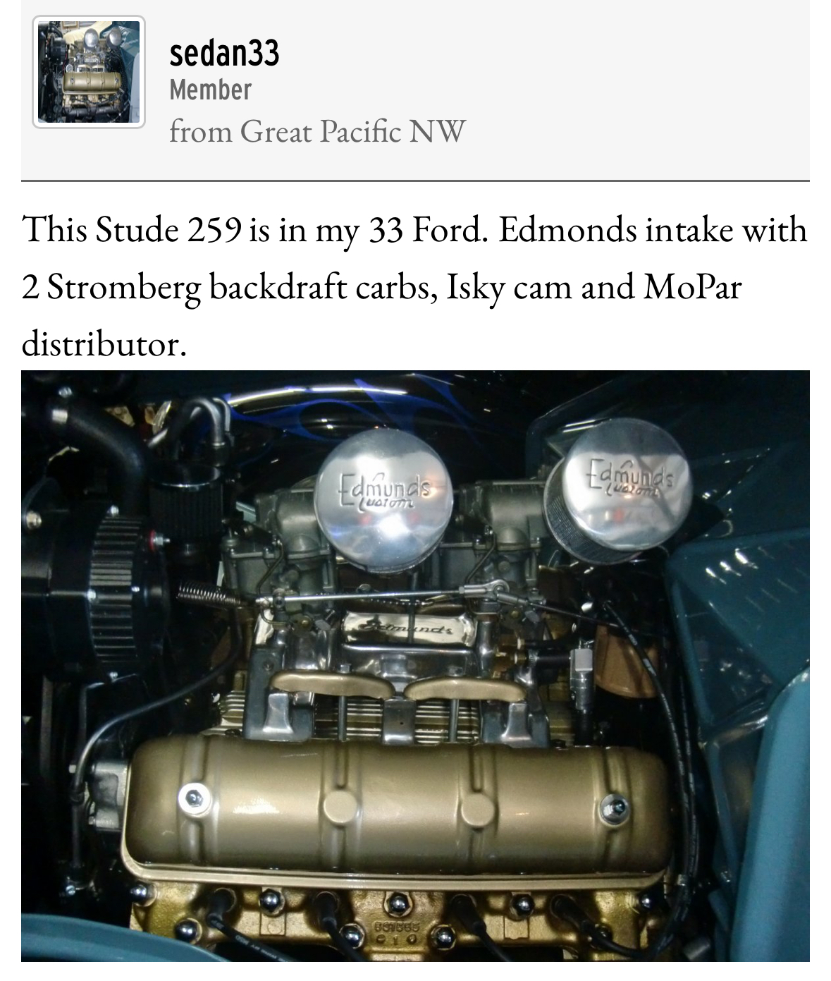

    IMG_0756.jpeg Looks like we can add @sedan33 to the list of guys with Studebaker powered hotrods!
    brEad, Thor1, Stogy and 2 others like this.

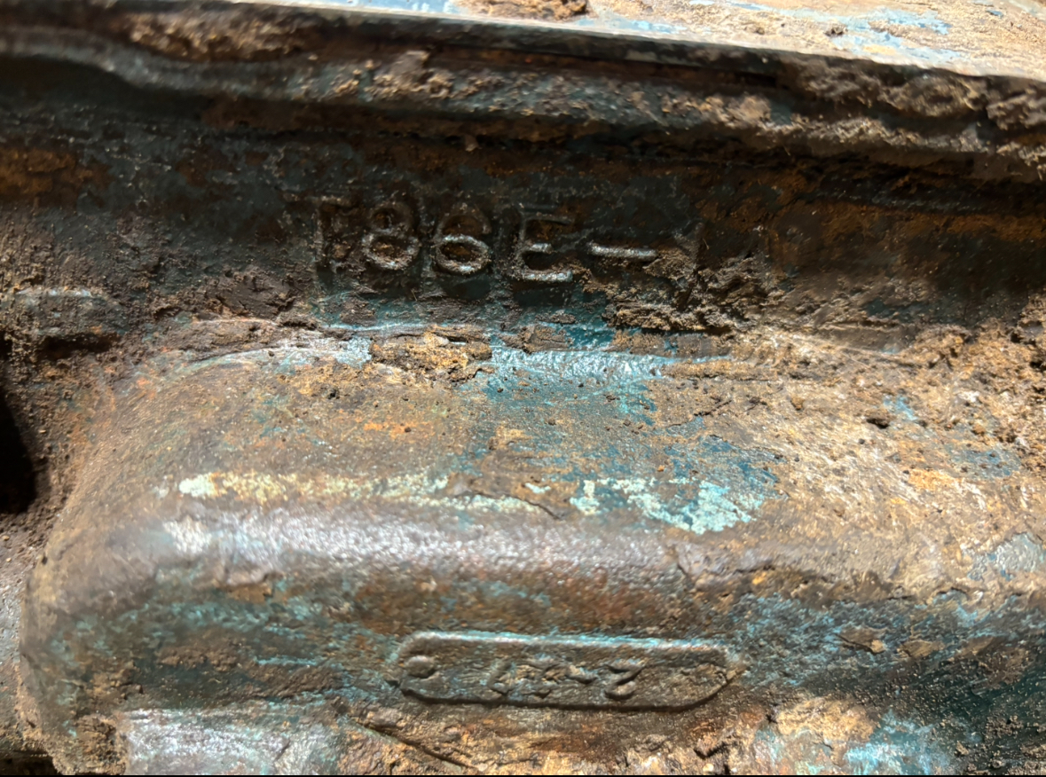

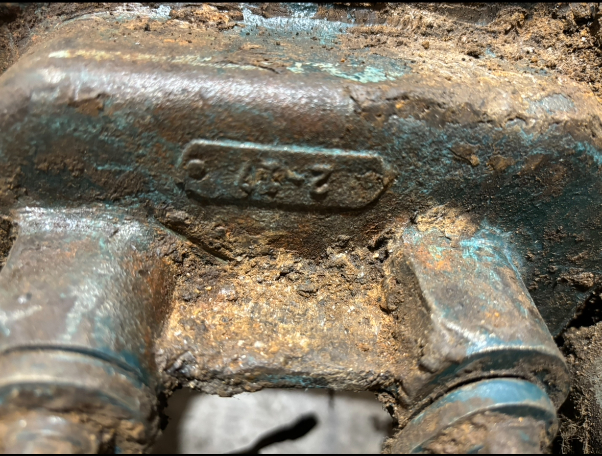

    Growing up everybody hit the dinosaurs/ archaeologist phase. Somehow I think this isn’t what I pictured when I thought about unearthing old stuff but it’s still pretty fun :)
    The shift towers were buried all the way to the top plate I had to find a photo of one to know what I was digging for lol
    Jeff34, brEad, Thor1 and 4 others like this.

    You are probably the first person to see that since they set it in at the factory. Others just saw where it was buried.
    drdave and Stogy like this.

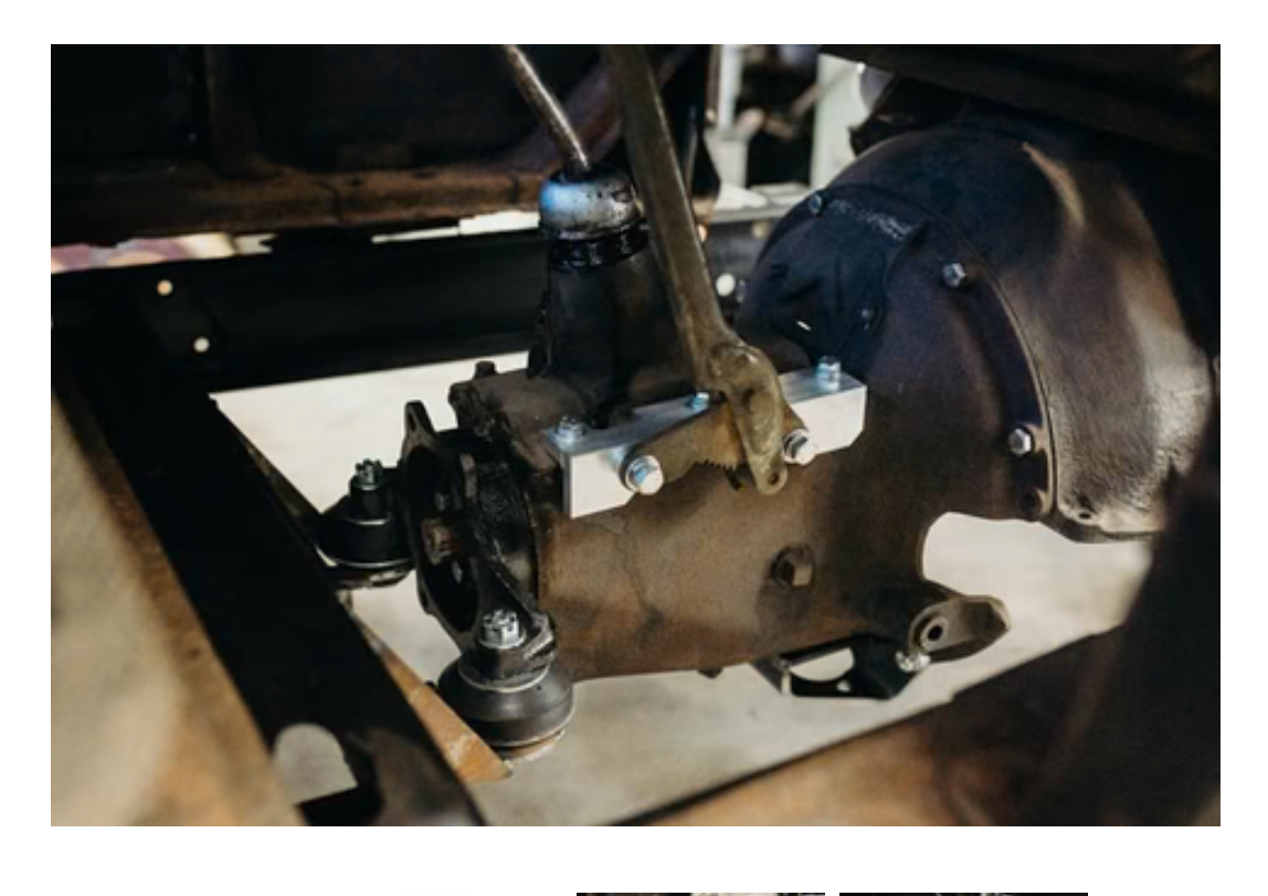

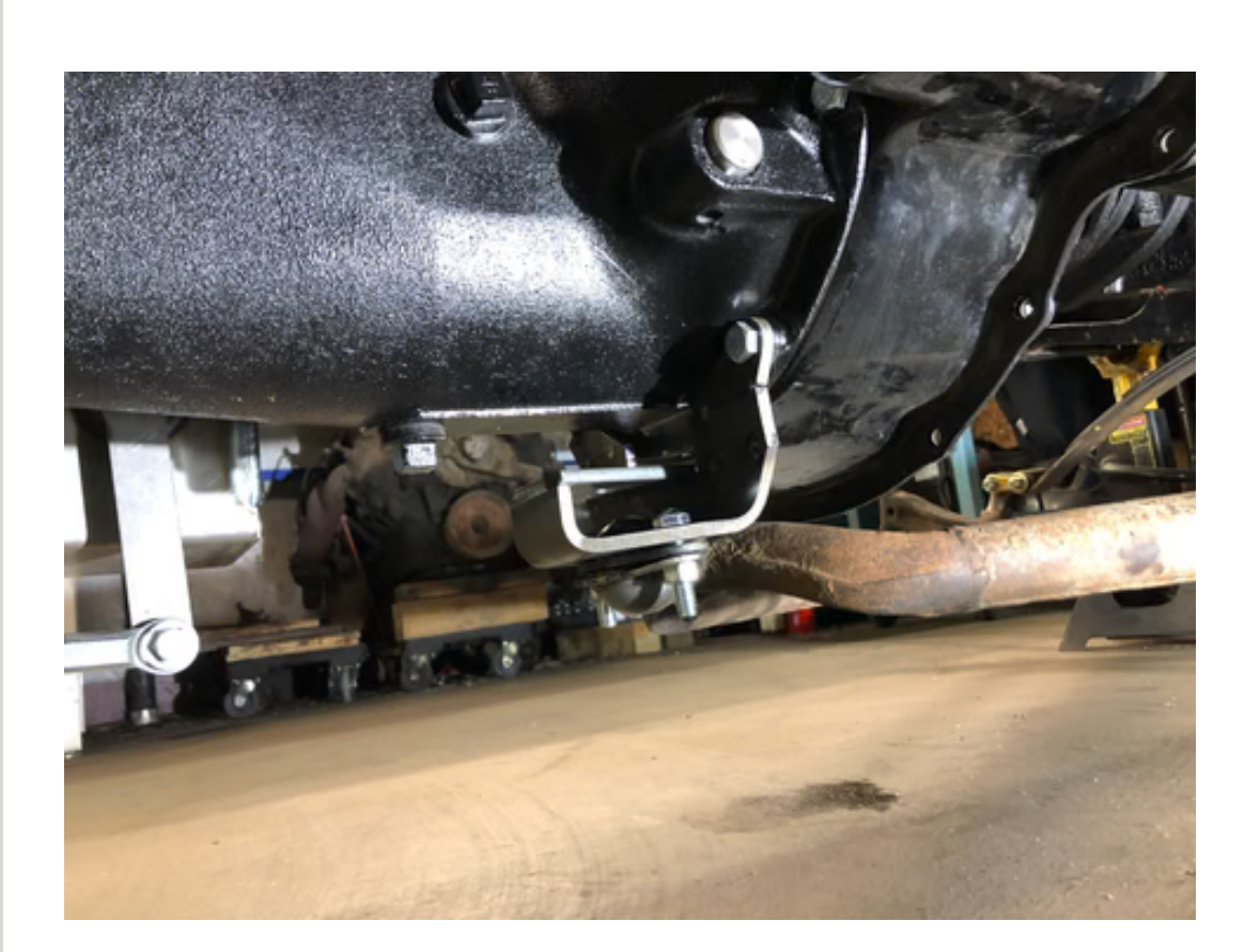

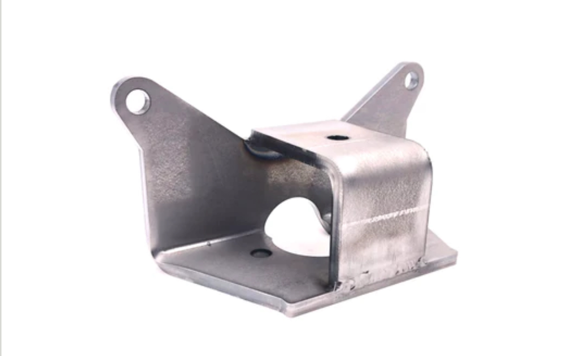

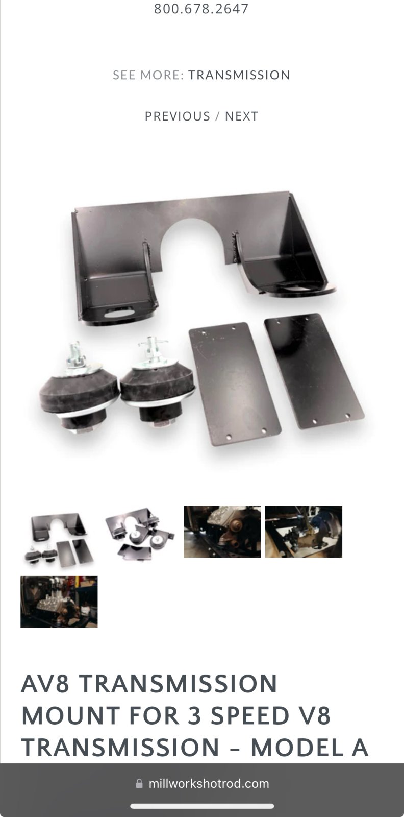

    IMG_0771.jpeg A few photos stollen from their website in case you aren’t familiar. Iron trap actually used this set up for the roadster pickup shop trick and it worked slick IMG_0772.jpeg the two plates you see in the parts pile in the first photo actually bolt to the bottom flange of the cross member front to back kinda boxing it/ stiffening it all up at the mount. I don’t think my trans mount will be this far forward but it’s just something to reference. IMG_0773.jpeg IMG_0774.jpeg This is something I hadn’t noticed they carry until tonight but have seen it done before. Right now I have a tube crossmember that dips pretty low to hold the trans and then has a ball mount. I’m back and forth on reworking keeping it as is or changing it, depends on where stuff lands in the mock up I suppose.
    it’s a little frustrating that I built the whole thing around a drive train it looks like I’m not going to use so it feels a little more “motor swap” sometimes but I think if my stubbornness sides with making it how it should be I’ll do ok.
    any of you guys used a bellhousing wishbone mount like that? I’m considering doing a bellhousing / mid mount just to tighten the ch***is up and much as possible. Maybe if I built
    It like hurst motor mount typically looks I could put a wishbone mount right on the bottom.
    guess we’ll see. Hopefully over the next week I can make some progress and have a little less speculation.

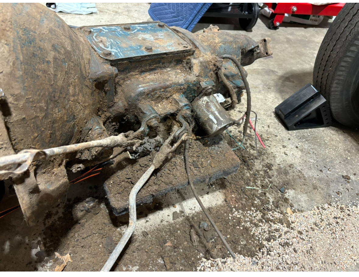

    Actually looking at it the trans mount is pretty close to the bell housing. I believe some years they had a rubber pad that the back of the trans sat on with a separate cross member. Something to ponder I guess.
    anyhow I think I’ve got this thing clean enough to swing into the A. IMG_0779.jpeg IMG_0780.jpeg started to find some numbers IMG_0781.jpeg IMG_0782.jpeg IMG_0783.jpeg i found these photos in another hamb thread of what I believe is the same trans and over drive so I could figure out where to find numbers and what shape I was supposed to be chili out of this oil clay. I can’t even see the r-10 numbers yet but I can feel where they are when I s****e at it. I think it’s gonna take a pick to really get in there. IMG_0786.jpeg IMG_0785.jpeg IMG_0784.jpeg Either way figured I’d add them here for reference

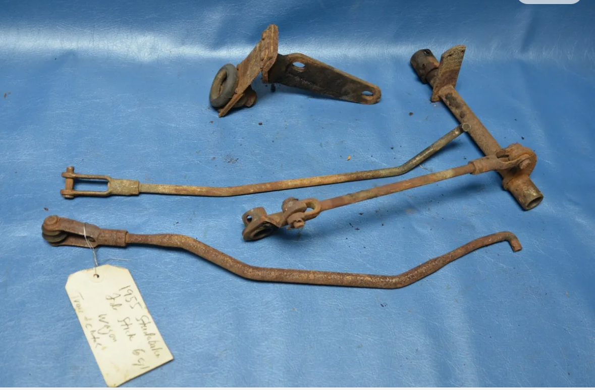

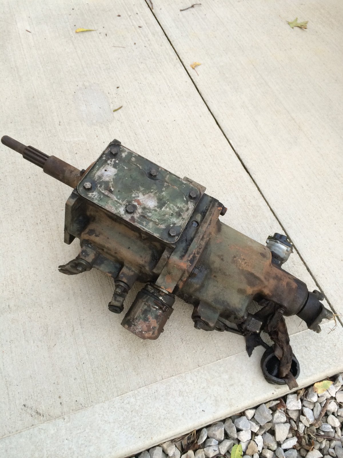

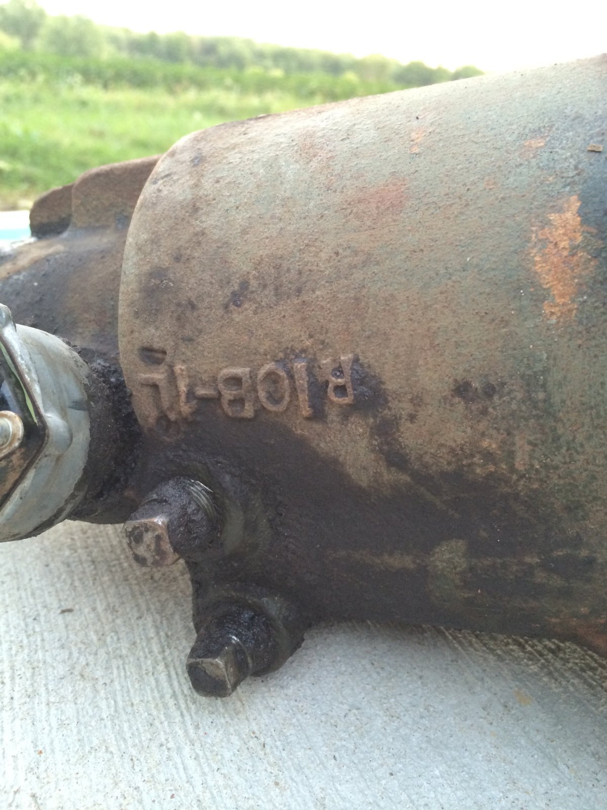

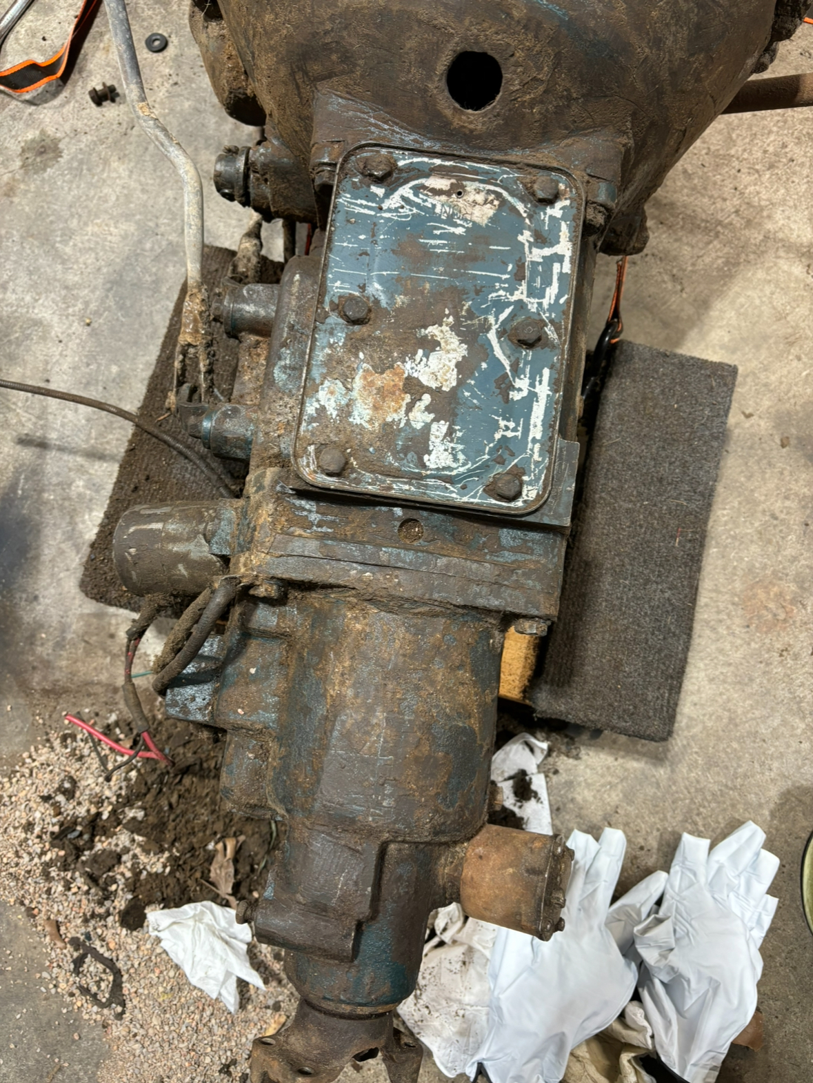

    IMG_0793.jpeg Needs photos right? Didn’t take anything worth looking at but here’s a photo of what I think the clutch linkage should look like. Looks like the pedal pivot just slips over the nub on the bellhousing and cotter pins together?
    and this is a T-86 going into an m5 truck but shows the cushioned support I was mentioning earlier. I believe later ones didn’t have this cross member and he noted it’s installed flip flopped because the notch is for exhaust clearance and should be on the other side. You can also see how far forward the trans mount is.
    Thor1, Primered Forever and Six Ball like this.
