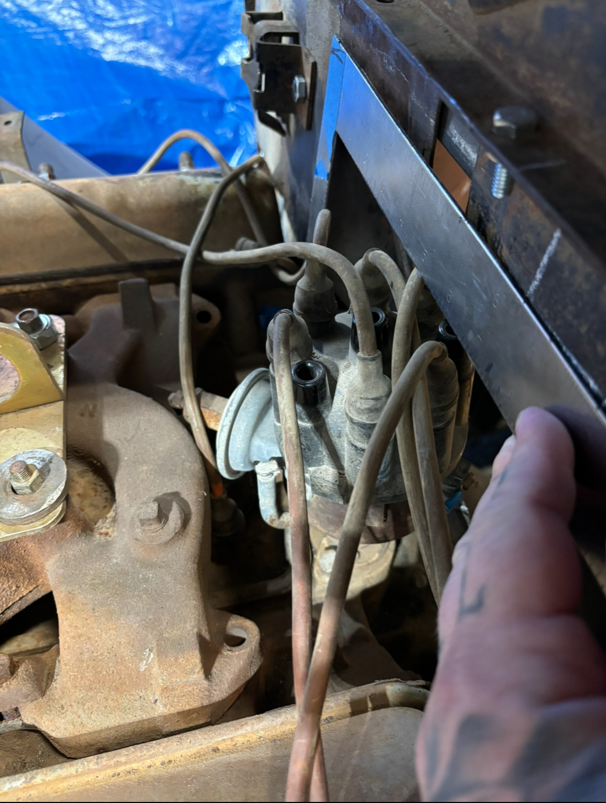

    It's actually surprising how easy it is to actually pull the distributor once the cap is off. In my truck the Mallory has about 1/2" clearance to the firewall. Once you pull the cap and hold down the thing only needs to come up about an inch before it will disengage the gears etc. it's a hemi rather than a stude but I don't image it's a bunch different. Just saying.

    This is kinda what I’m working with @dumprat
    IMG_1379.jpeg Stude looks to me like it would have to come up around 5” before you could start tipping it over and out. IMG_1377.jpeg sits into the firewall recess roughly this much. IMG_1378.jpeg witch puts the forward edge of the flange about dead center of the coil terminal in the center of the cap.
    I would have basically the space the cap takes up to pull up and tip it. I don’t think it’s enough? IMG_1376.jpeg and here’s what my drivers side fender to tire looks like at the moment for no real reason.

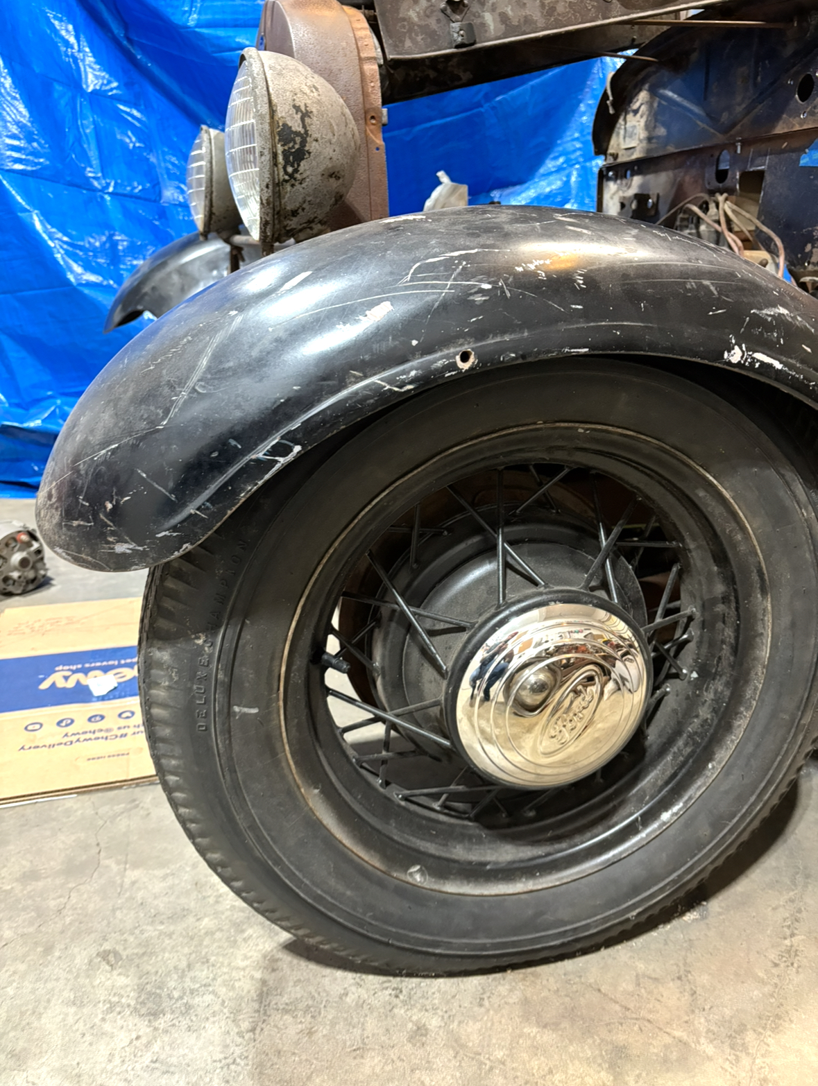

    well here’s a reason! I figured out my “twist” issue that was driving me nuts.
    the u bolts and the plate under the spring pack are not sitting centered or even straight! My ***umption is that the plate is not flat or it’s not aligning correct. It is slight off to one side causing the front to tilt. Just a tiny bit but enough to telegraph at the frame horns.
    it is off behind the cross member as well but just a tiny amount I think having the engine sitting in the car is keeping it more level than if it was un loaded.
    Before finding it I measure the side wall of each tire, the drop of axle side of the axle, the arch of the spring and nearly a dozen spots side to side. All 100% even.
    I dug through photos and found with the old spring it did the exact same thing I just never took notice of it. I had always checked to see if the plate was sinching things down tight but never thought it would be sitting funny as long as the tie bolt in the spring pack was in the hole in the cross member.
    very pleased to have found this. Worse case I make a shim or mill the bottom plate true. Best case I flip the plate 180 deg and it’s fixed. I’m
    Always very **** to put everything back how it was even down to the same but going on the same stud so I’m sure it’s been exactly this way the whole time.
    I sure like that fender being so low but I’ve got some good ideas for adjusting it back down once I get this lean sorted out

    Don't know if you know, but stude used more than one kind of dist type. The early 232 v8, (starting in)'51 & for some time later(don't remember off the top of my head), used a 2-pc dist. Drive shaft w/tang. & gear-drive was separate, & the shorty dist dropped in on top of that. Don't have one right here to measure, but I guess the "tube" below the body was only a few inches long(I'm thinking ~3-4" at most). Very much like an acvw, pinto, &/or S6 dist. Anyways, that might solve some of your (lack of)room issues? ???

    I wasn't sure you knew how long the distributer with the oil pump drive shaft is. Glad to see the picture above. I have seen distributers without the shaft but though it was just missing. There was also a Delco with the bigger "window" cap that GM used late '60s on. Think about getting something down there to prime the oil pump if needed.

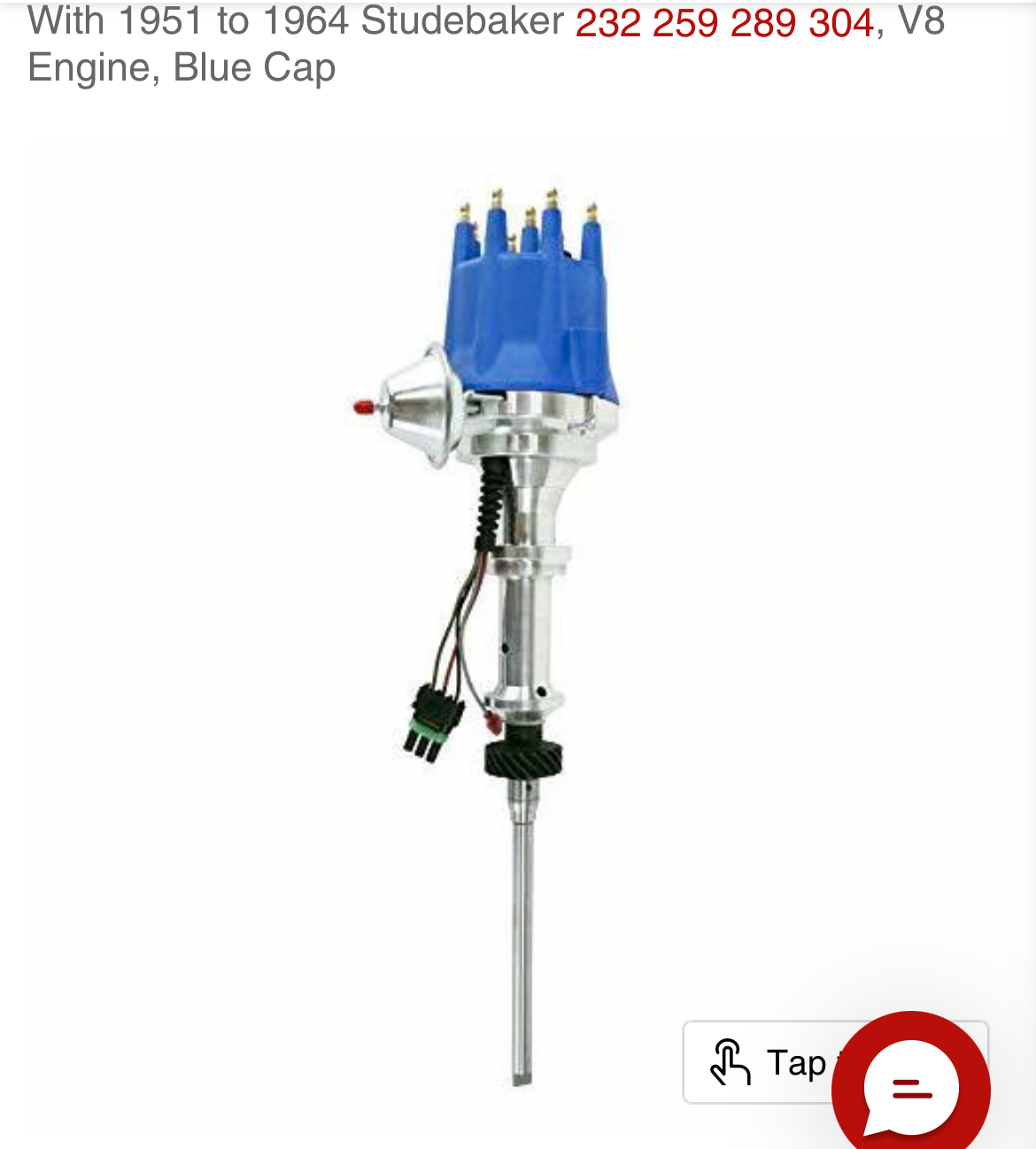

    IMG_1381.jpeg Is there any reason a guy couldn’t push the pin out of the oil pump shaft and make any distributor a “two piece” from what I read about stude two piece setups it should be an offset slot and groove but I’m unsure if the one shown would be like that.
    Would there be a bushing that keeps the pump shaft from moving around?
    Just chewing on ideas.

    Prestolite (Autolite) & Delco Remy The Prestolites use the innards & cap for mid '50s Plymouth (maybe other MOPAR) V8 Delco used innards & cap for Chevy small blocks with small cap. There was a Stude specific rotor for the Delco but the one I found didn't fit but the Chevy did. There is probably more to it than this. We were doing this over 20 years ago.

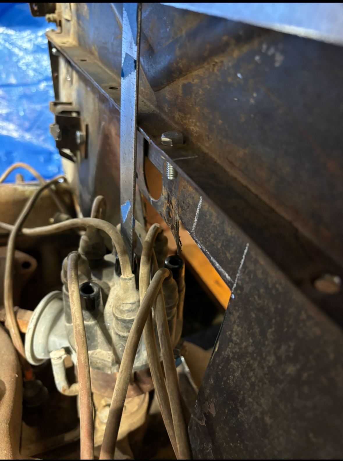

    Woke up this morning and it hits me that if I take a crescent shaped cut out of the flange in the firewall with the same or slightly larger diameter as the body of the distributor that I can probably get close to 4” of up and then tip it out and go the rest of the way.

    Just so you know, the shaft wobbles abit(oh so little, on purpose), but doesn't flex, nor articulate at the joint more than a couple of degrees, at most. That wasn't its' intent.

    @nrgwizard i figured as much, but I figure at a certain point it’s a 2” hole with a 1/2 rod so there room to tilt. It doesn’t need to be removed 100% vertical etc

    I don't remember if it goes into a smaller hole on the block where the oil pump bolts to the block. I have a couple of loose blocks I can take pictures of. I'll try to get out there today. Maybe even try to drop a distributer in one to check angles. I'll try, no promise. Honey Doos. :oops:

    @Six Ball that would be great. If the bore for the oil pump shaft is smaller we just need to know how far up the body needs to come before it comes into the larger bore for the distributor shaft then you’d have room
    To tilt it a hair

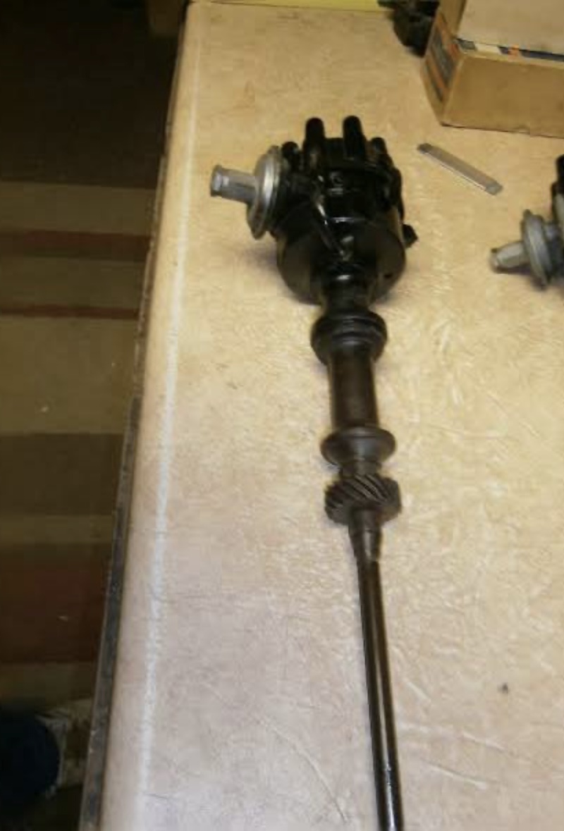

  18. Six Ball
    Joined: Oct 8, 2007
    Posts: 7,078
    Six Ball

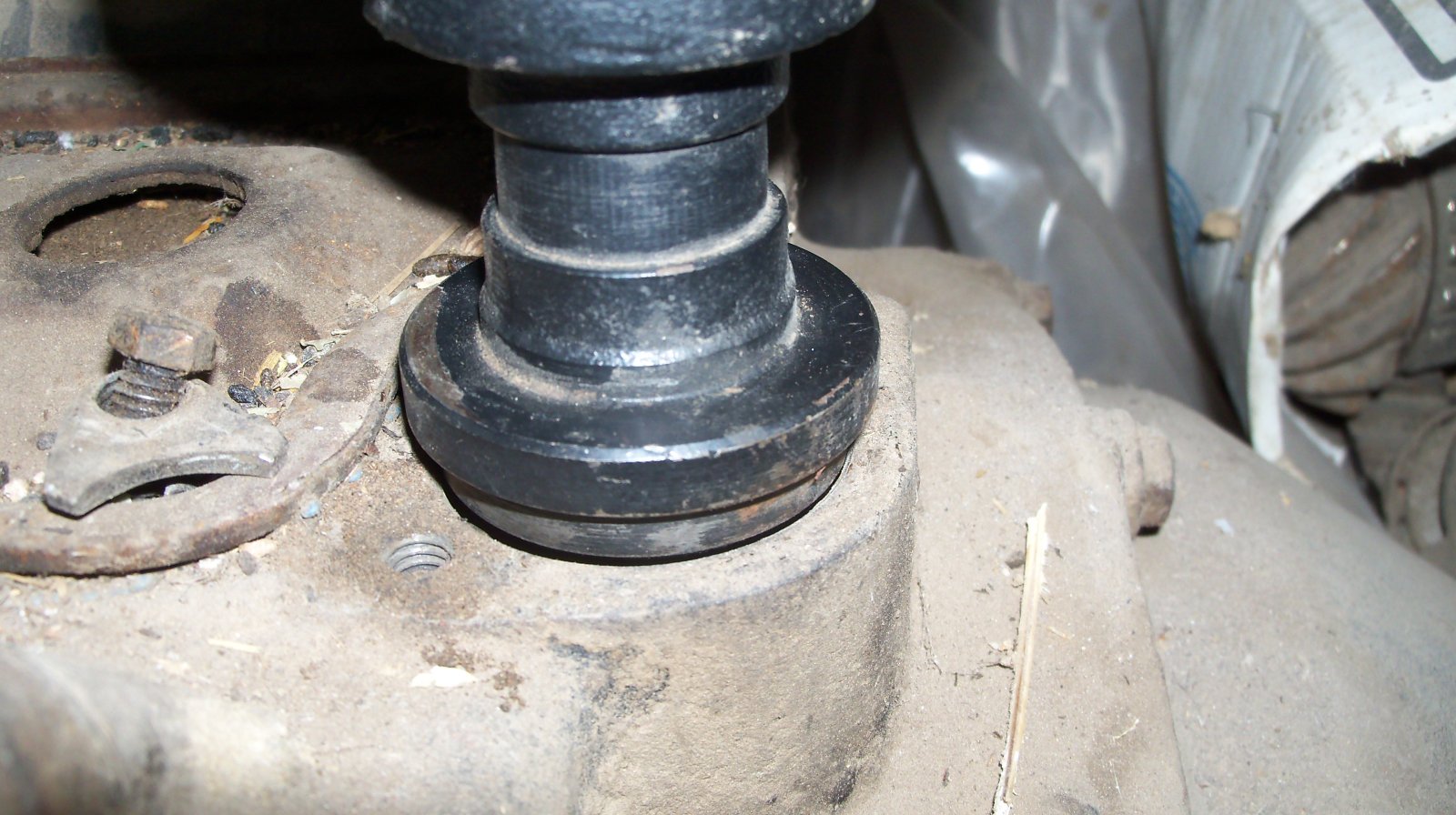

    from Nevada
    I was able to get to the one that is upright but is a tight spot. ("We're in a tight spot boys!")
    The pictures are a little fuzzy. I was not able to get the distributer all the way into the oil pump but far enough for this. The first shot in down the hole. You can barely see the oil pump slot just past the piece of trash I think I pushed into it.
    This as as far as it went in. The wide part sits on the block. The narrow part goes in. No matter for this.
    It will not tilt any significant amount until the gear clears the block. That happens at 5"-5 1/4".
    That puts the top on the distributer body about 10'' above the block and the cap about 13". Hope this helps!
    redzula, Thor1, Stogy and 2 others like this.
  19. Tim
    Joined: Mar 2, 2001
    Posts: 20,827
    Tim
    from KCMO
    That’s fantastic info! Thanks for the effort, time and photos!

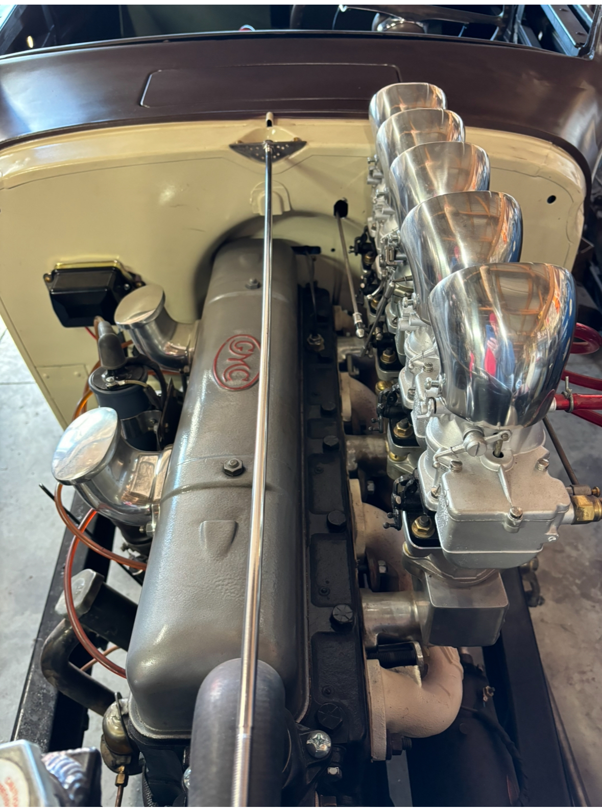

    no stude stuff from me today but how about a gmc with 5 carbs, a caddy generator mount and a pair of 34 5 windows with Cadillac v8’s? IMG_1416.jpeg IMG_1415.jpeg IMG_1414.jpeg

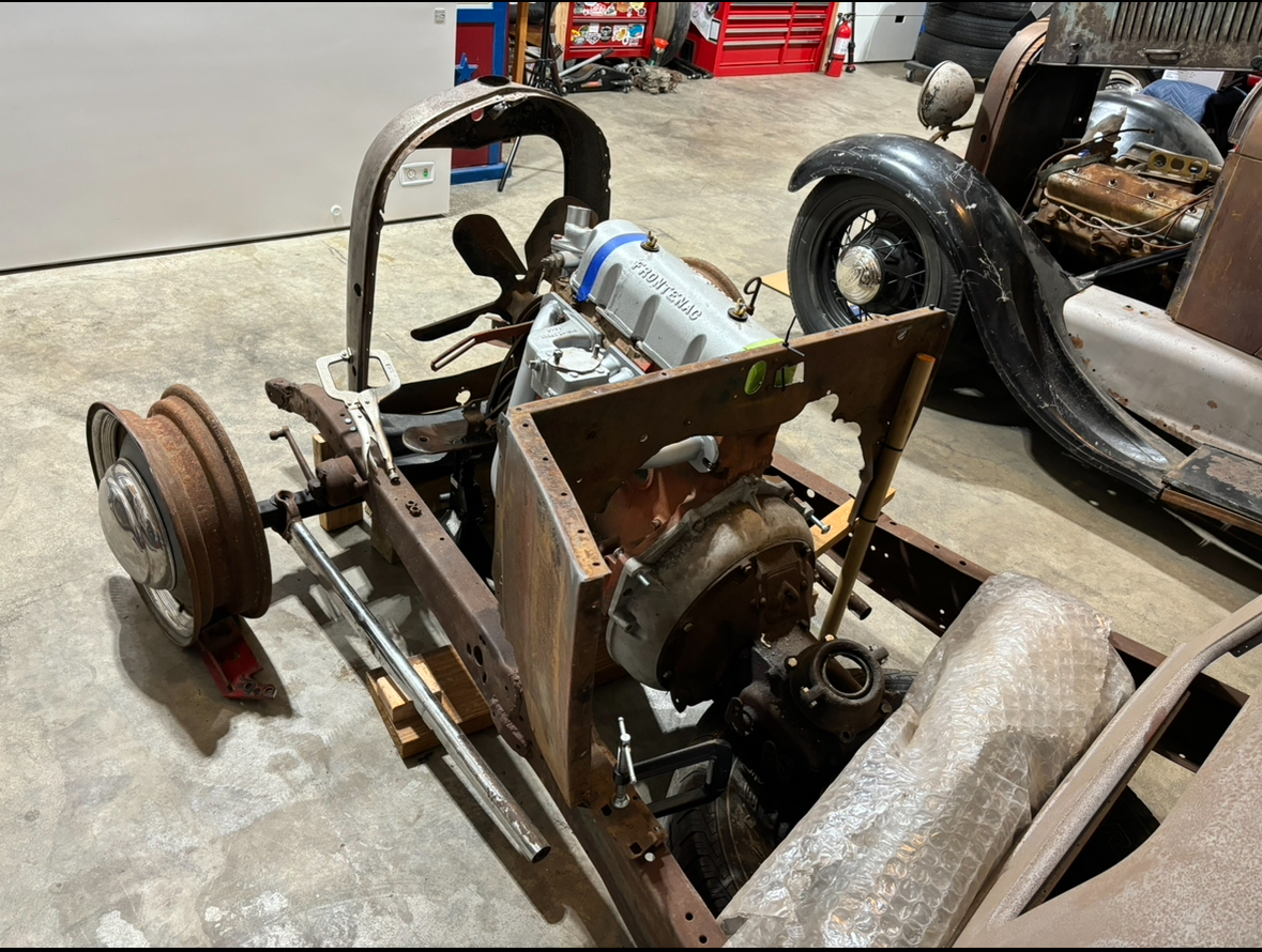

    Hope everyone had a Merry Christmas , I got a tank of shielding gas for my welder I picked up this summer :)
    spent the evening breaking down cardboard boxes and staring at my firewall.
    I told @porkn****** it felt like one of those tile puzzles where you slide and flip the pieces around in the frame.
    The tunnel for the distributor is getting taller and wider with the factory parts moved around for the most part, and the p***enger head is going to need a little room when the motor gets raised.
    about went cross eyed with all the different shapes and slanted surfaces to consider, and how to brace it all while I cut it up. But I feel like I’ve got the jist figured out.
