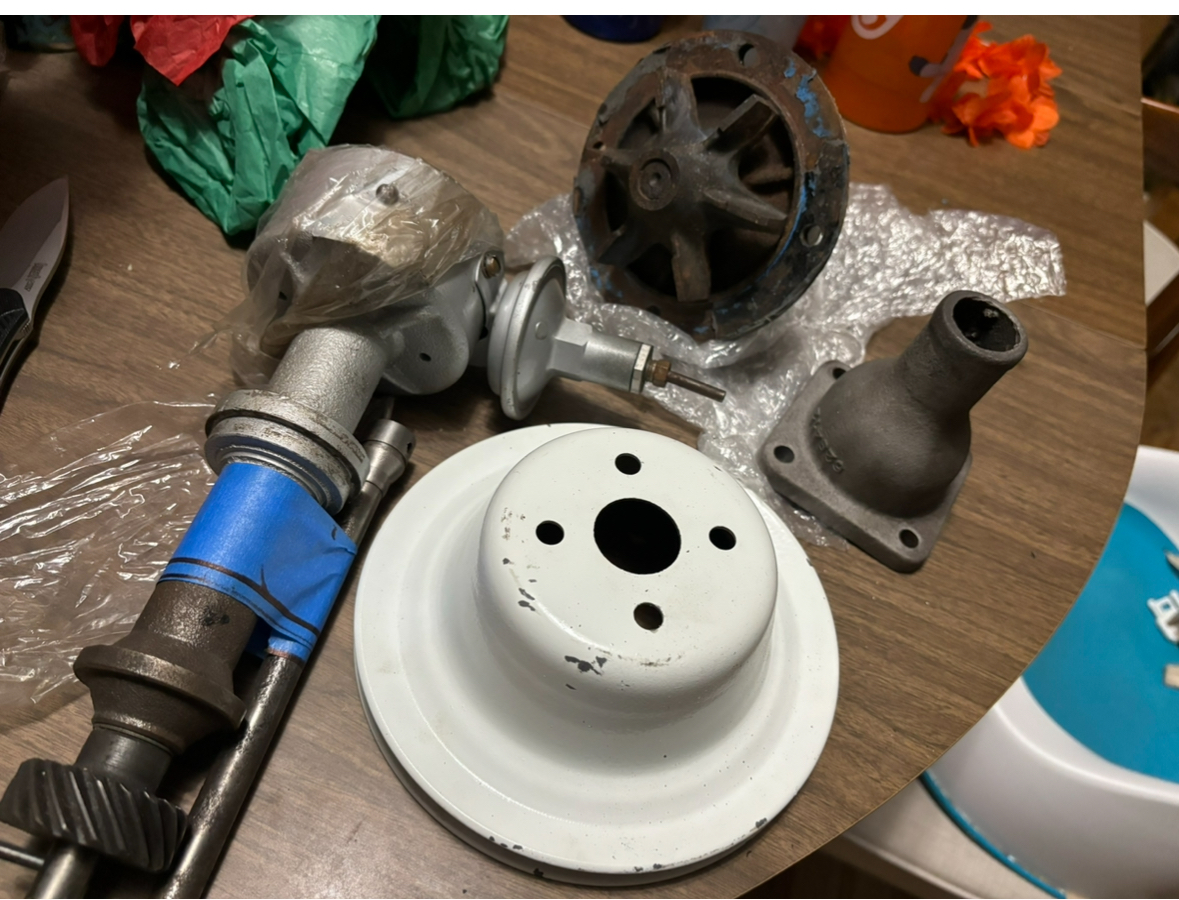

    Well came home from work to a package from Tyler on my mail table! IMG_1688.jpeg water pump, water pump pulley, a straight up water neck/ thermostat housing and a good clean distibutor ! Hot Dang! No ones convincing me Santa’s not a hot rodder now! :)
    thinking I’ll buy one of those gear reduction starters in the spring and hopefully around that time I’ll have the motor and trans mounted in the ch***is and @Austin kays and I can lite it off!

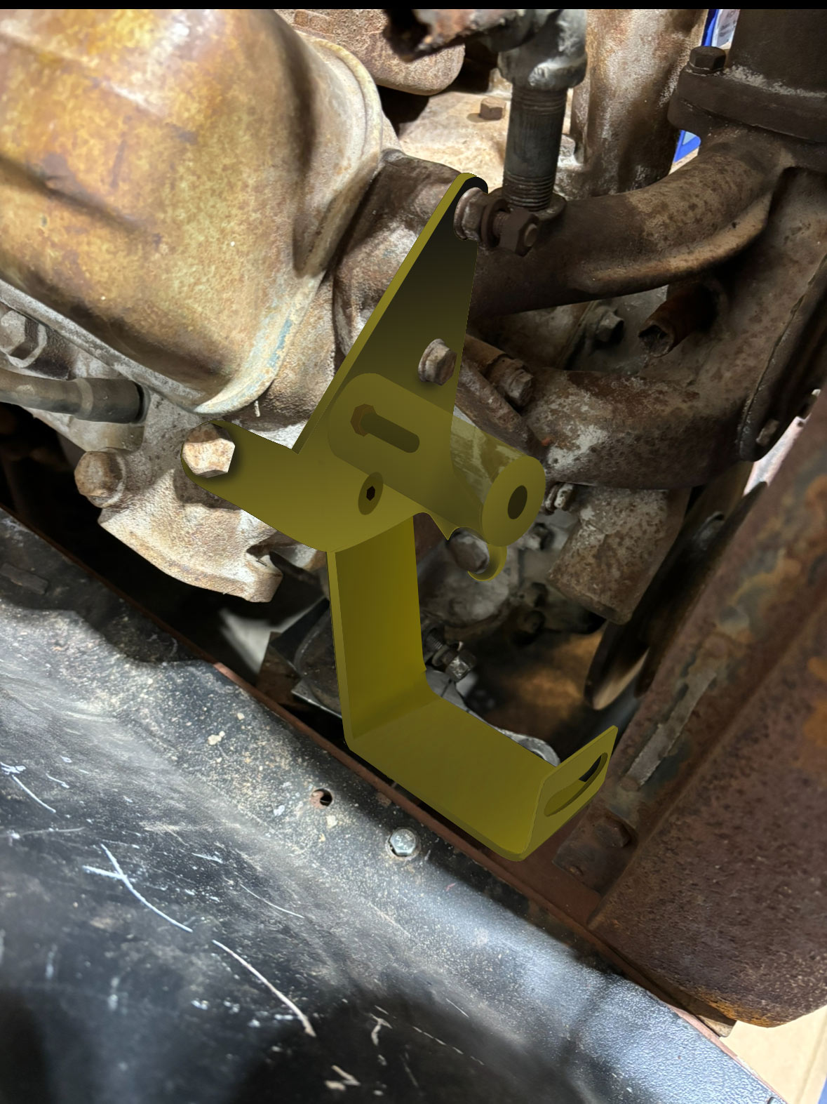

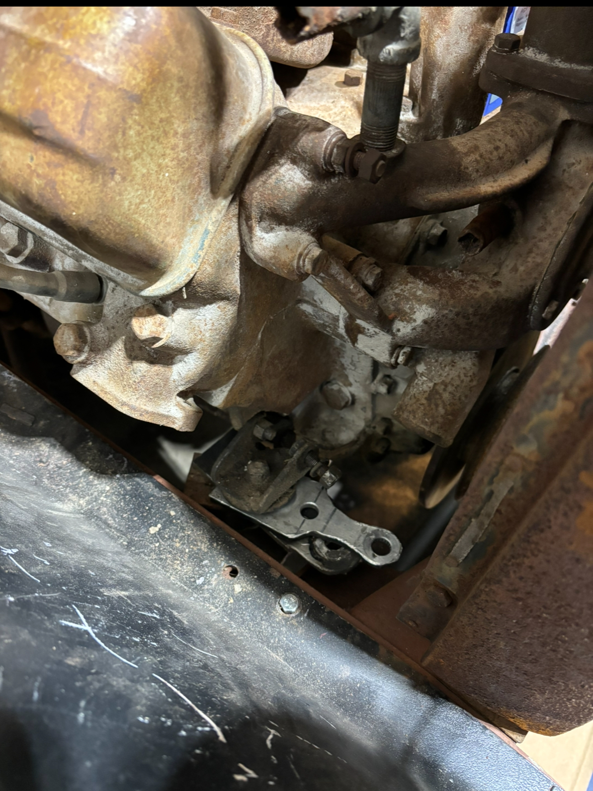

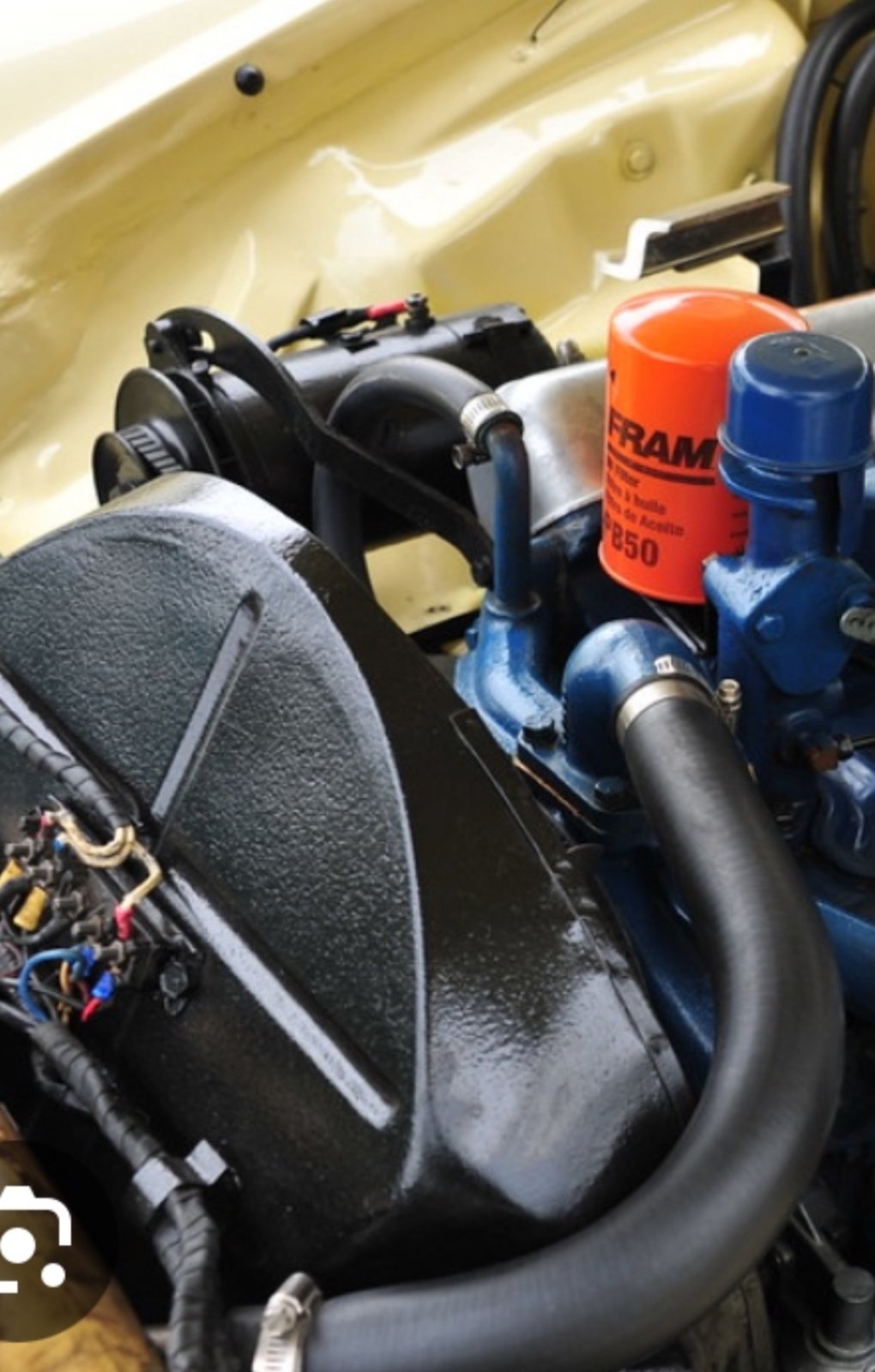

    Ok so caddy IMG_1706.jpeg IMG_1708.jpeg and stude. Similar gap but the hole he’s using for the top mount doesn’t exist. Is running the slotted mount/ bar off a timing cover bolt a good idea or no?
    just chewing on some mount ideas now that it seems a spot is available. Wonder if both mounts could be off the water pump bolts. I’ll have to get a denso alternator to hold up and see

    You could run a plate using those two bolts where that pipe attaches to the head with a stand off for the pivot and a slotted adjust from the cover or lower bolt in the region...certainly doable...the pivot bracket could utilize the head bolt in the corner there too giving three attach points...
    Is that a strut from the lower bolt of pipe to head?

    Stogy I think this may answer you questions. I think all of which your seeing is attached to the water pump/ water crossover and is shown a little bit here as “***umed stock”
    im going to pull the pipe out of the cross over and use it for a temp gauge sensor location as the stock location in the back of the drivers p***enger head is very much in the way. Or about to be anyways IMG_1709.jpeg

    Actually I’m not sure I under stand what you were asking @Stogy now that I re read it a few times but I like the mount idea.

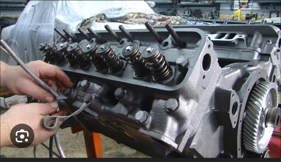

    I’m also seeing a line where the water pump bolts into the block. Is that the head and block meeting? Would be wild to have a totally split water p***age that big. I’ll have to find a photo of a Studebaker head off the motor and take a look.

    Pics help I know...this is an all in one...you could ditch the lower bracket and run an arm with a slot from the lower area as I was proposing first but I thought this might do as well...

    That’s pretty much what I had pictured when you described it. Great rendering! Well thought out design as well, I’m gonna have to go back and look at it a few more times.

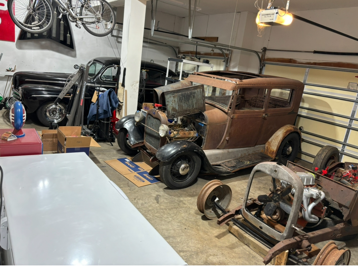

    2024 garage “resolutions” Get the 46 running right and fixed. Slot it into steady rotation. Get the model A running and rolling in time to take it completely apart. Get the 32’ rails welded together, front and rear axles brakes and springs so I can roll it around. Continue tooling up the garage and maybe find a spot for a welding table. Seems about as optimistic as always. Wanted to type it out so I can check back in a year. Here’s to a productive year IMG_1720.jpeg

    Gosh I wish my garage was half that clean…

    @dumprat if it makes you feel any better it took me three days to get it that clean.
    I do generally try to keep the shop very clean though. Probably decades of having to be clean at work just becoming muscle memory.

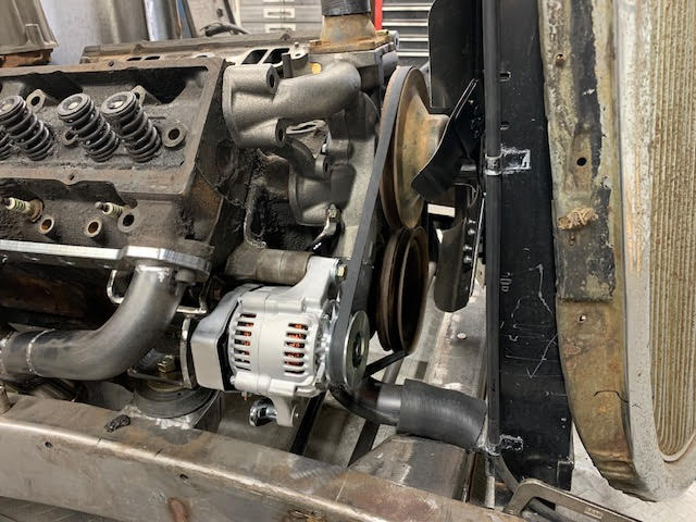

    Id you decide on a one wire alternator to use?
    im thinking I’ll run an as cast one wire alternator. The finish should blend right in and hide in plane sight. If it really bothers me I’ll pay four times as much for the power gen and it should fit the same space. I also like the idea of being to find a one wire alternator on the road easily enough if I had to. View attachment 5917783 Another shot because why not[/QUOTE]

    I do like the idea of it being easy to find one on the road at this point I’d think a 90’s Suzuki denzo would be easy to find as a one wire but I’ll mock up a gm alternator in the space and see if it fits for grins when I get back to it.
