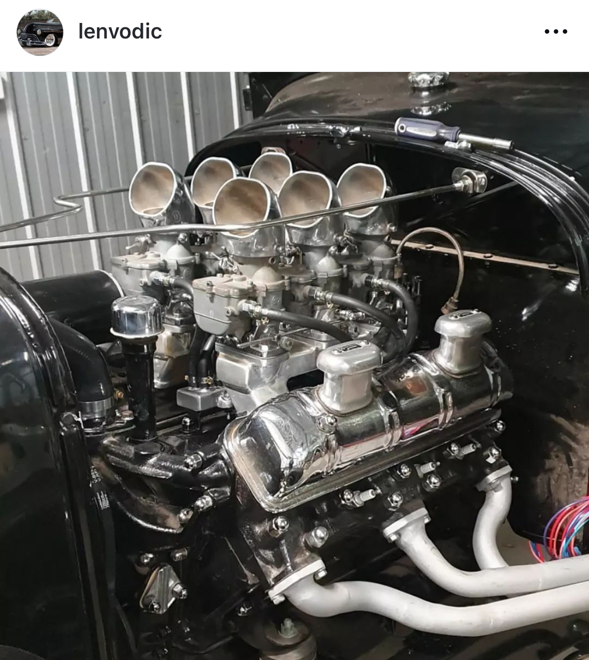

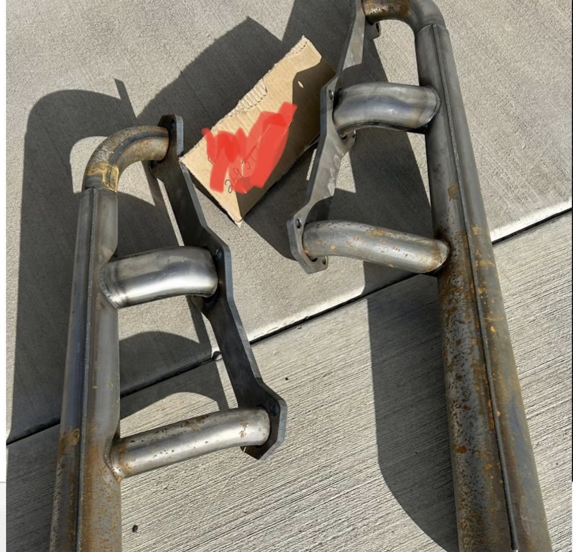

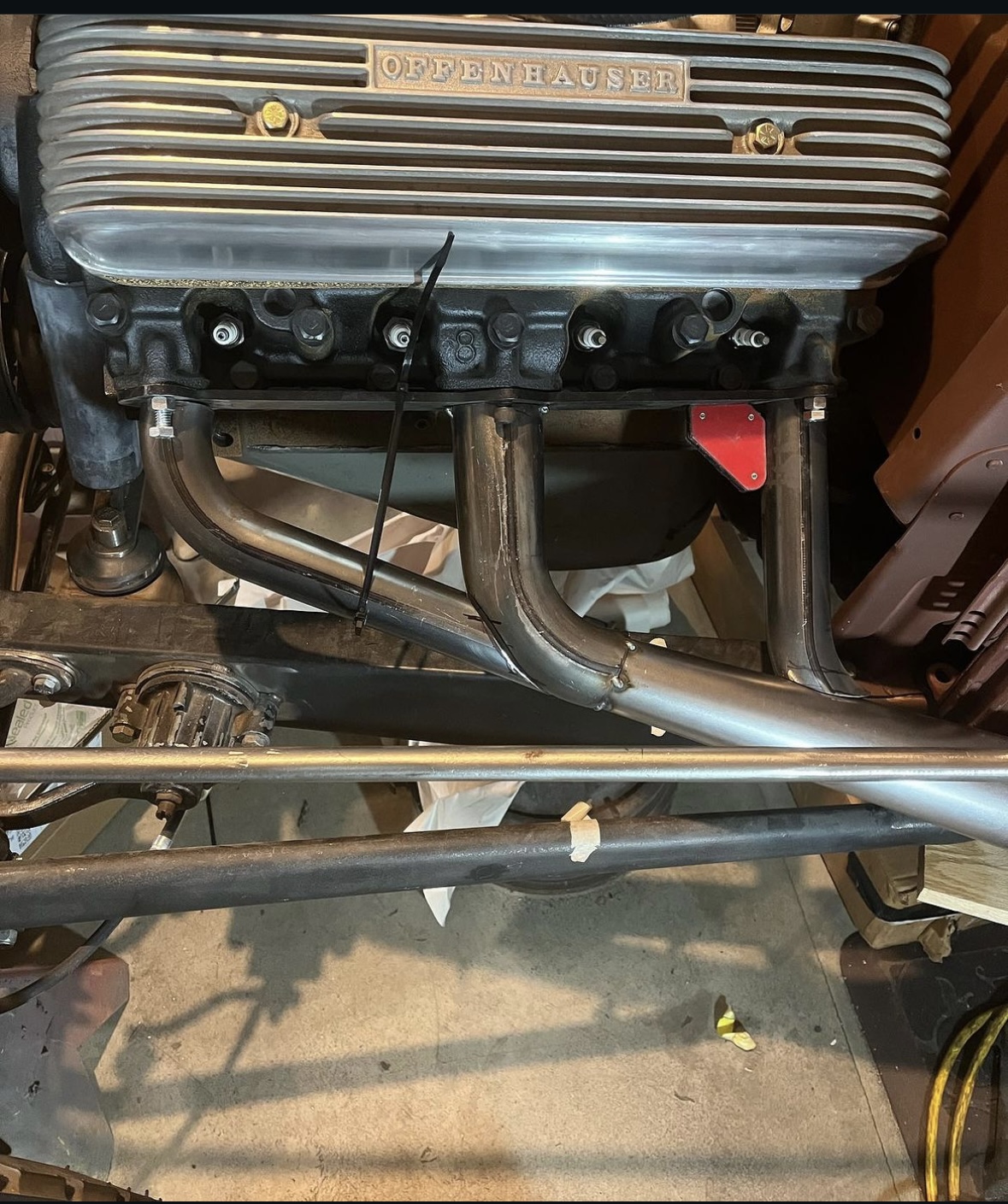

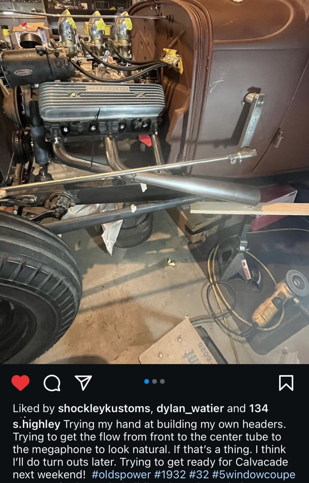

    anyhow saw these olds headers and love them IMG_1907.jpeg IMG_1908.jpeg IMG_1909.jpeg love that the cone flows into the larger center primary and the smaller front primary so perfectly IMG_1910.jpeg for contrast that’s what they would typically look like.
    brEad, Tim_with_a_T, Thor1 and 3 others like this.

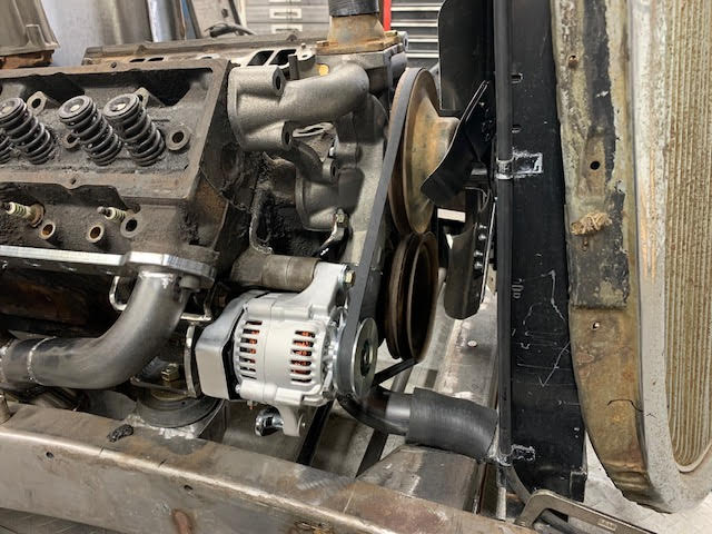

    I'd very much like to add a denso to my project, but am not sure which make/model year to get that is easy to wire and throws decent amps? Any help with which one to get?
    Thanks.
    -rick
    Six Ball and Tim like this.

    Rick I’ll repost it when I get closer but I believe I posted the good one when I chewed on this issue with the last engine set up . I’ve just got to go digging for it
    69fury likes this.

    I really like those headers too. Well thought out.
    Here is a little black 90 amp Denso that Speedway sells for about $130. I'm thinking about one of these if I can't convert a small 6v generator to 12v for my roadster.
    69fury and Tim like this.
