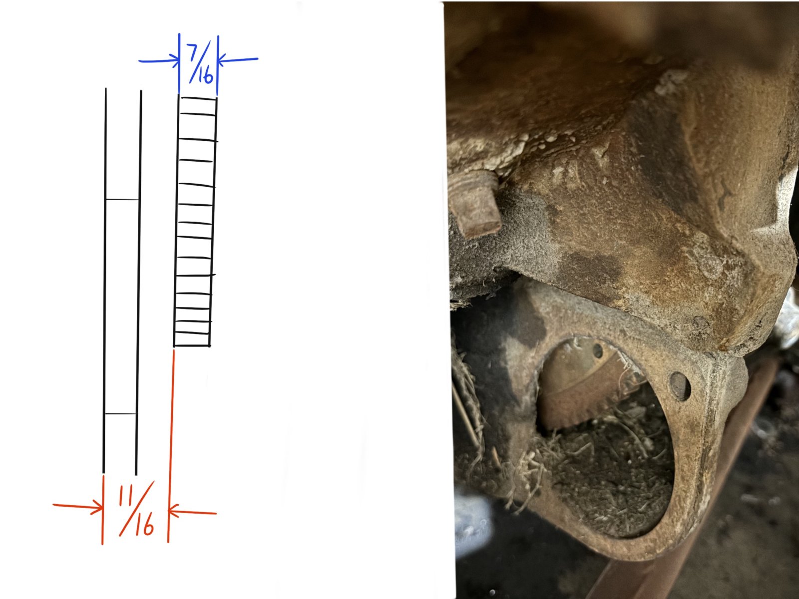

    For ****s and grins here are some numbers and measurements I sent over to the mini starter guys this morning to see if it’s feasible to have them put one together Untitled_Artwork.jpeg Untitled_Artwork.jpeg
    Mounting flange to flywheel and flywheel width at teeth if that’s not obvious.
    turns out I’m really only looking for one starter the other two are for the 12volt engines/ later flywheel

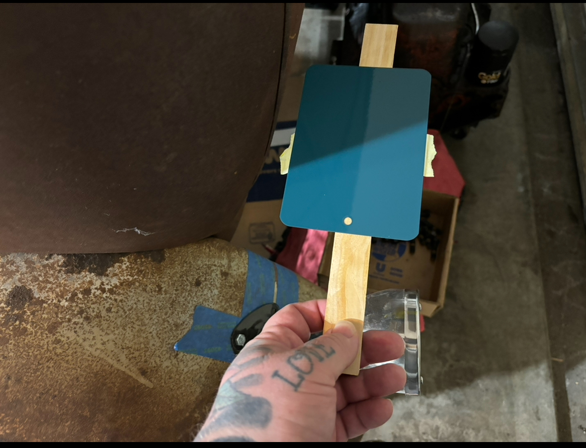

    Heard from Bob this morning, he thinks he has what I need!
    I also got the spray out for the body color in my hands. Buddy nailed it! I’m so excited about it. It’s been years of trying to find a match or formula. My camera could take a clear photo in the dark so I had to kinda trick it to show how different this paint looks in direct light and in the shadows. Should be amazing with black fenders etc IMG_2278.jpeg IMG_2277.jpeg
    brEad, Thor1, Bandit Billy and 5 others like this.

    I think the diameter is different so I would need either a 6 volt manual trans starter or a 12 volt starter for a manual and flywheel.
    @dumprat ive considered it. The shaft size, and attachment method are different between the 6 and 12 volt starters so I can’t just swap one for the other. The 6 volt shaft is larger so if I put the gear from one on a 12 volt starter I’d have to make up the in between.
    I haven’t come across a good reference/ chart for the gears to see if there’s one that would work from another application, maybe a starter rebuilding shop would have one in a book?
    either way for now I’m going to continue chasing leads. Something will pop up eventually
