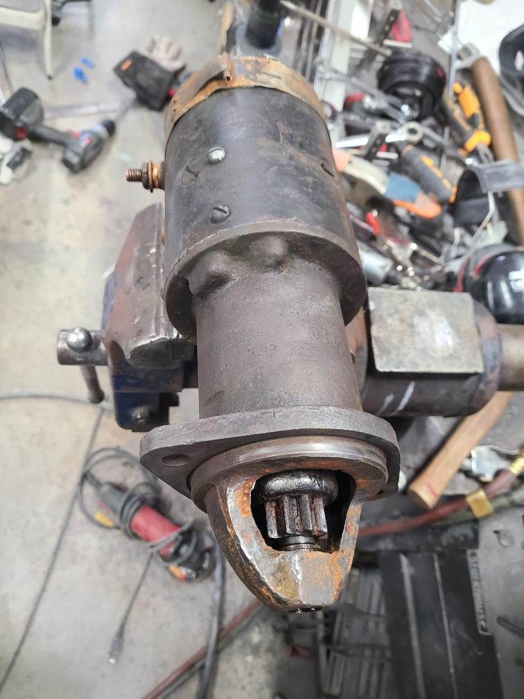

    Ok time for an update!
    I was deep in the throws of my latest reverse engineering trying to figure out a starter solution. I was in the garage with a caliper, googling and basically spinning in circles until about 1:30 am when I realized it was time to call it and go to bed.
    I hoped on to the hamb and looked for something to read, @Irishjr hemi powered Stude thread had popped up so I started seeing what progress he had made when it dawned on me that he started with a pretty nice car…. My brain started creeping as I went back to page one to see him pulling a Studebaker v8 with manual trans out!
    It was offered up to a good home at that point which was years ago but it’s always worth asking so I sent off a PM and in the middle of the night I had a reply! The motor had found a home with a local stude guy as a back up but he thought it would be up for grabs.
    He made a few phone calls and it sounded like we had a starter in our sights! He went to pick

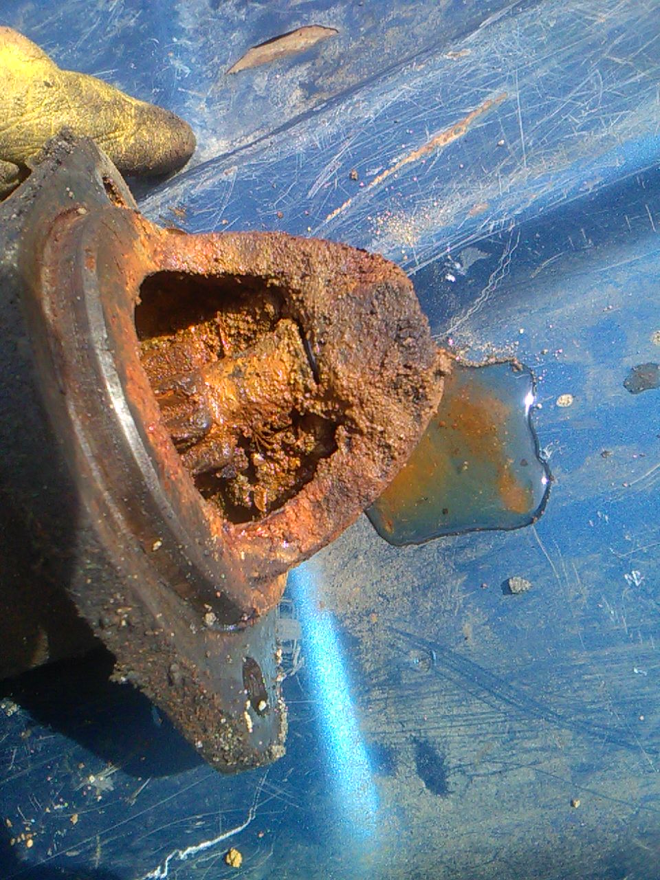

    It up and had found it has been basically sitting in the muck and mire with an out anyone realizing what had happened under that tarp.

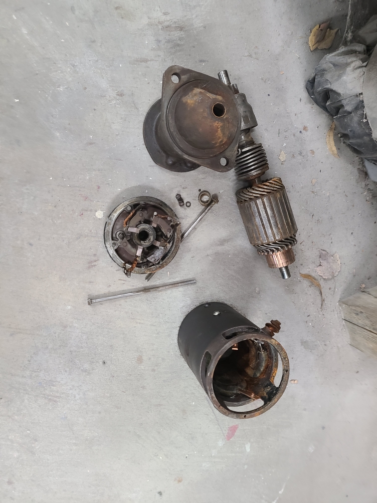

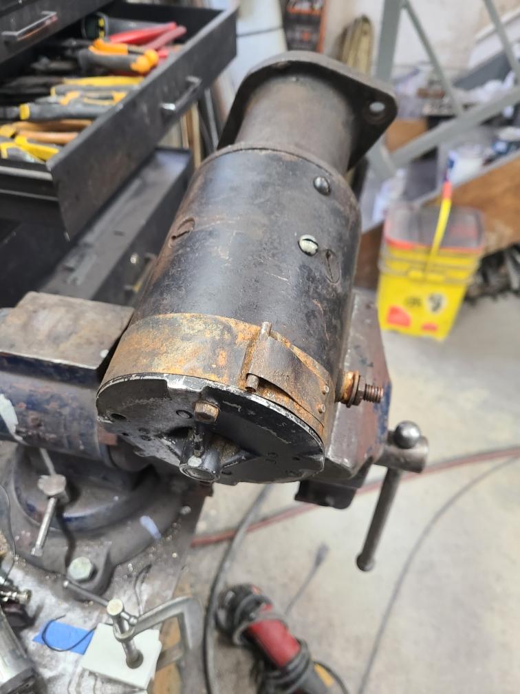

    After a little jump scare of a photo he tore it apart and cleaned it up quite a lot and put it back together. Add 12 volts and it works! Into a box and in record time it showed up at my place today!
    I’m so over joyed to have this checked off my list! I’ll take it apart and clean it further paint it up but knowing I have the correct starter and it works is a victory for sure.
    so here’s some pictures. KIMG1988.jpeg Resized_20240217_164006.jpeg Resized_20240219_122905.jpeg Resized_20240219_122912.jpeg IMG_2474.jpeg Hand for scale, this ****ers nearly a foot long and weights more than bowling ball.

    Yup, those things aren't featherweights. Lifting them in n out for mockup installation = time at gym. :D.
    Don't let it drop & get your hand/arm/other tender body parts get twixt it & the ground. ;( .
    Glad you found one.
    Oh, once you reclean it & test it, check for the 3 bushings' wear. May as well swap'em out now. Not hard when it's all apart, n they're cheap. I used to have the #s, but lost the receipt years ago. If they're going away, armature gets hard to turn, rubs in the case, = large electrical load draw.

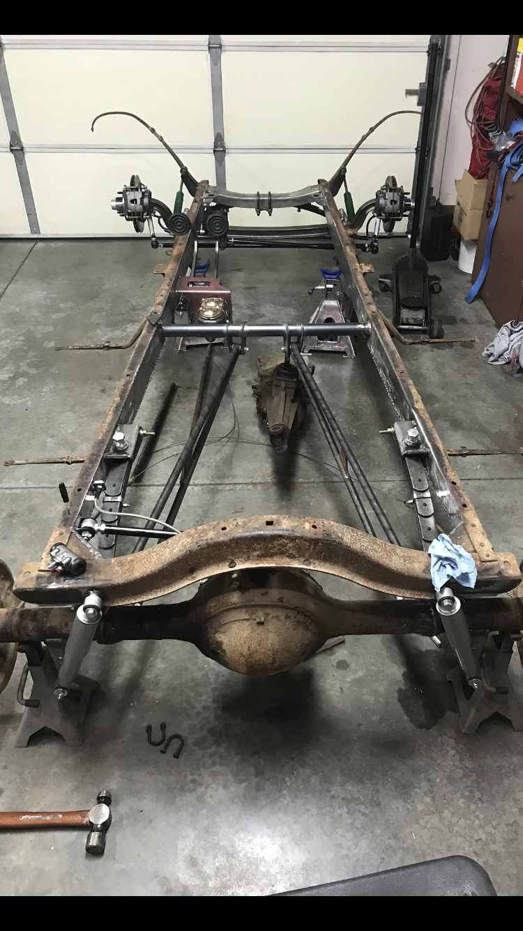

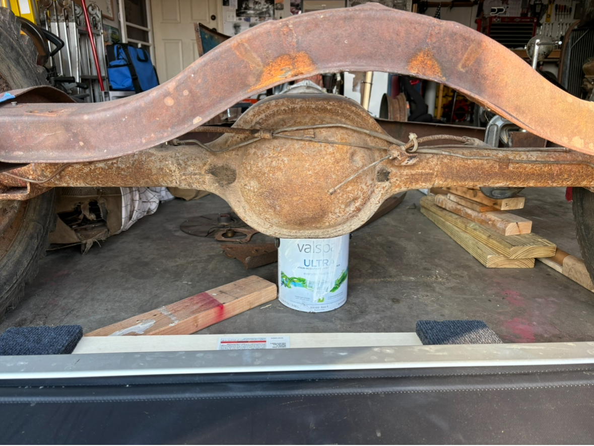

    Next piece of the puzzle? The rear axle and suspension.
    I had initially wanted to prep the A banjo and convert it to open drive. But then the thought of having to dump the clutch in an emergency situation to get out of the way came to mind. The idea of dumping 300 ft lbs of torque on it and sheering a key or breaking an axle instead of getting out of the way really sounds not awesome.
    so… I have this 8” out of a grabber maverick with some ridiculous high high gears in it. It is from what I gather the correct width for running full fenders on an A but it is just narrow enough that I do not think a stock width spring will fit for a spring over application.
    So as much as I hate the look of it vs a banjo I’m hoping I can paint it black and by the time the spreader bar, exhaust and plate are on you don’t notice it so much.
    I see 3:80 gears available for those pretty reasonable and it would use the same ladder bars I had already planned to use.
    so now I’m between finding a source for a narrower than stock model T main leaf, or putting 1/4 eleptic springs on it like this IMG_2463.png seems like price wise could be able the same but I need to look in to it further. I also need to figure out new lower shock mounts while I’m doing it, the 1/4 set up would also need a pan hard bar.
    seems a new main would be the easiest solution to me. I need to start digging around and see who makes a slightly narrower T main leaf

    Man at 48.75 from the top inner edge of the backing plates I’m not even sure that 8” would clear the tires on the inner fenders. I’ll have to mock it all up.
    that puts me at needing a spring that’s 43.75 inches eye to eye installed.

    Nope, if a transverse leaf is mounted in tension you don’t need one. When ford went to mounting them “loose” they added a pan hard.
    only exception I can see is in the front, if you have cross steering you generally need a pan hard bar.
    measured the backing plates and the 8” is a fair bit narrower than the A but the inner side wall of the tire is about the same. I’ll have to gather up the jack stands and mock it up to really see what’s going on. Probably measure a bunch more times before then lol.
    want to have the motor and trans mounted before I cement any rear axle/ rear suspension.
    I also need to see how close you can get a spring over bracket welded to the backing plate with out blocking hardware or brake bleeders
    Six Ball likes this.

    Found these part numbers on an old thread
    POSIES Offers 3 widths (lengths) for Rear Model A springs. These are based on perch eye (hanger) dimensions:
    29-31R - Perch eyes 48 - 49 1/2" (will work on stock Model A rear axles)
    29-31R-C - Perch eyes 46 - 46 1/2" (narrow)
    29-31R-N - Perch eyes 44 - 44 1/2" NEW ITEM DUE Mid october 2019 (ultra narrow)
    I’ll have to see what lead time is on those. Seems like posies has been a year out at least in anything not on the shelf the last couple years
    edit: yikes! Looking like close to $600 for a spring pack plus shipping on those. That counts me out on that option
