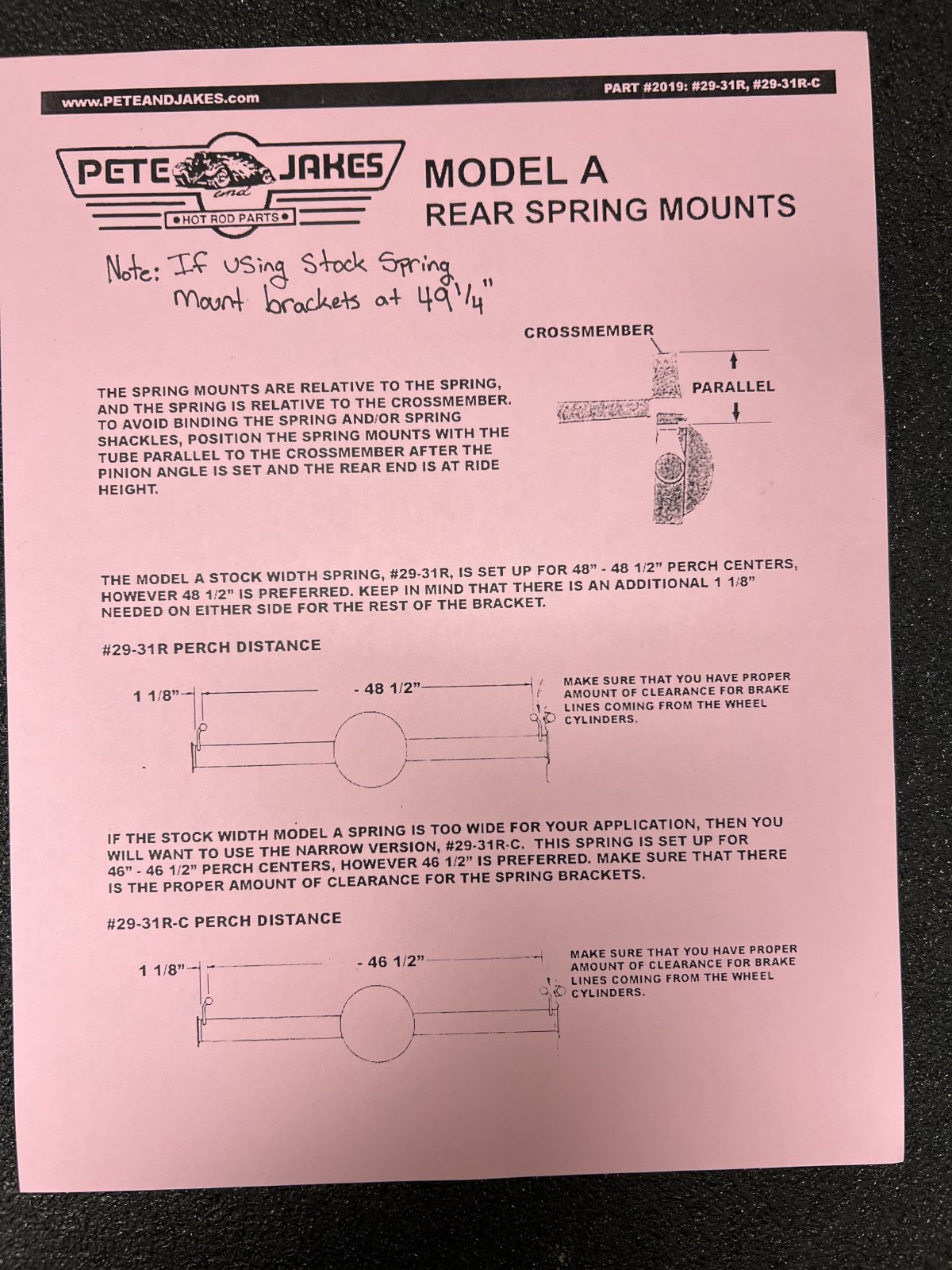

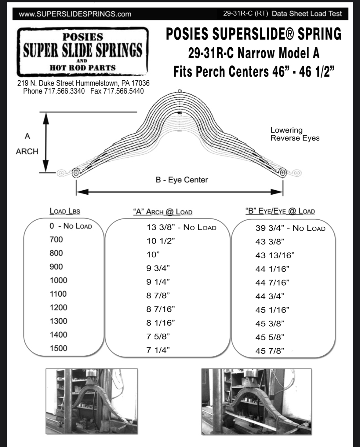

    Looks like we both got reply’s this morning on the status of the leafs. As far as your question of spring hanger measurements I’m gonna say 46.5”
    they are basically trying to fill the gap the “existing” never in stock posies spring left with the same measurements, as mostly confirmed by postings. See below IMG_2530.jpeg couple that with this Pete and jakes sheet that directly references that spring IMG_2543.jpeg i would say it’s safe to ***ume 46-46.5

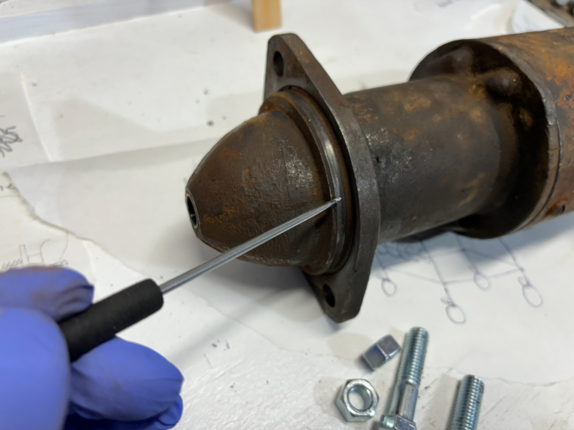

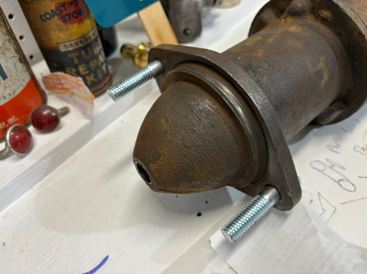

    Random Studebaker starter information I’m adding to the hamb lol IMG_2546.jpeg studebsker v8 starters take a very specific bolt that looks like a bolt with a long shank but is actually a “dowel bolt” where the smoooth shank area is actually bigger than the threads and fits snug into the holes of the starter.
    on studebakers this helps align the starter to where it needs to mesh. If you use a normal bolt
    You can shim it with anything from a very thin bushing to some metal flashing.
    however! IMG_2547.jpeg it would appear that this ridge should align the starter in the hole in the bellhousing. I’ve heard it mentioned that early Stude starters were like this. I couldn’t be sure if they ment early v8 or earlier than that until I had it in hand.

    The snugger you can fit it the better. I don't remember anything about special bolts and we had no problems but less movement will aid alignment. At least you have a starter in hand now and can actually see what it needs.

    Yeah, sounds like it's a supplier issue and the numbers you provided look accurate. Thanks for that info. Almost seems like I might need posies ultra narrow one or to go with another option. I'll have to find my axle mounts and remeasure. I've got a 2WD S10 rear axle so my space is limited.

    @Six Ball yeah these bolts fit but could be just a teeny bit tighter in the bore.

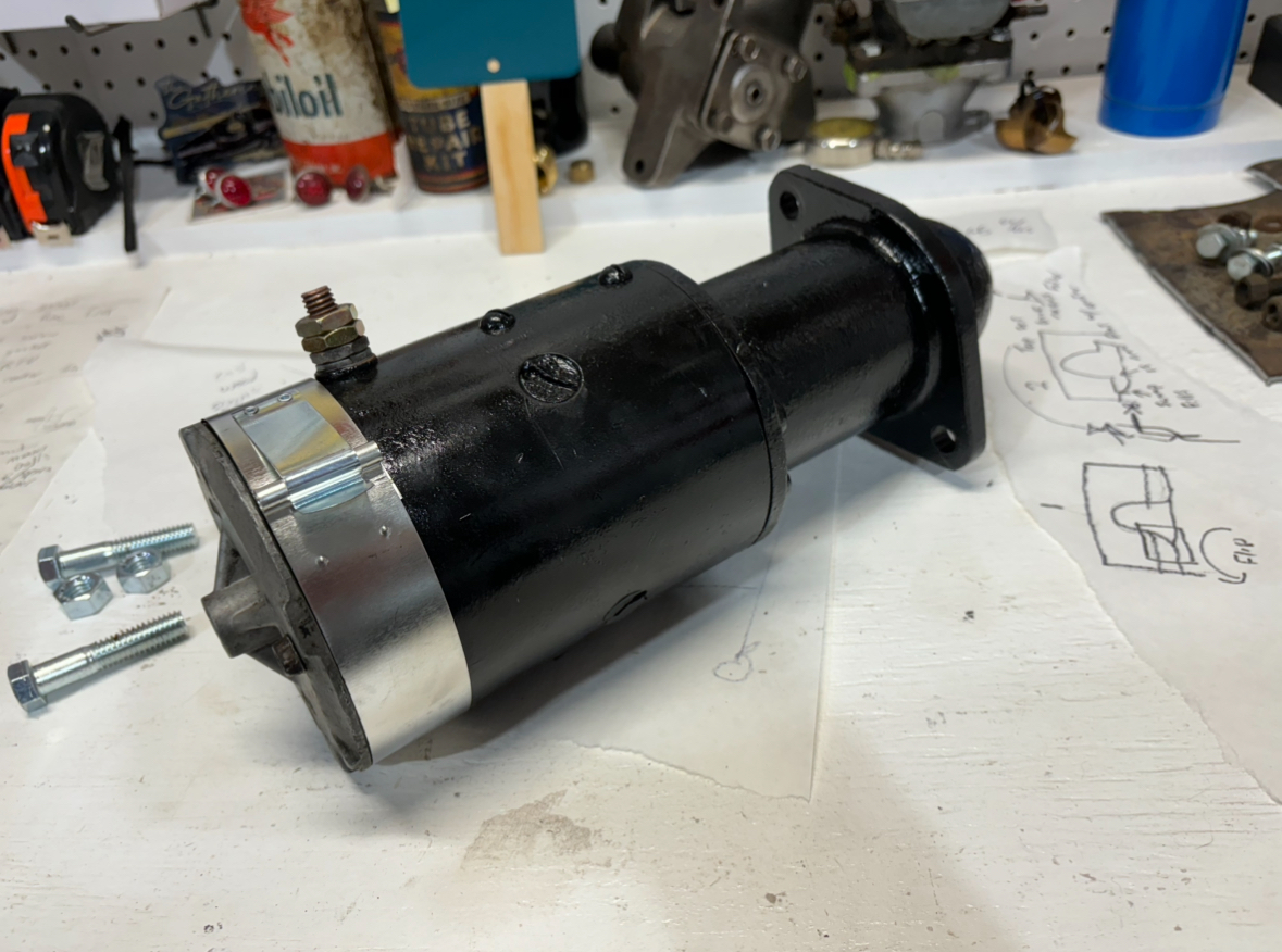

    Dropped the starter off with the rebuilder, just for piece of mind. Figure it’s cheap insurance. Should have in back shortly :) one more thing I can check off the list
    drdave, rjgideon, winduptoy and 2 others like this.
  20. Tim
    Joined: Mar 2, 2001
    Posts: 21,574
    Tim
    from KCMO

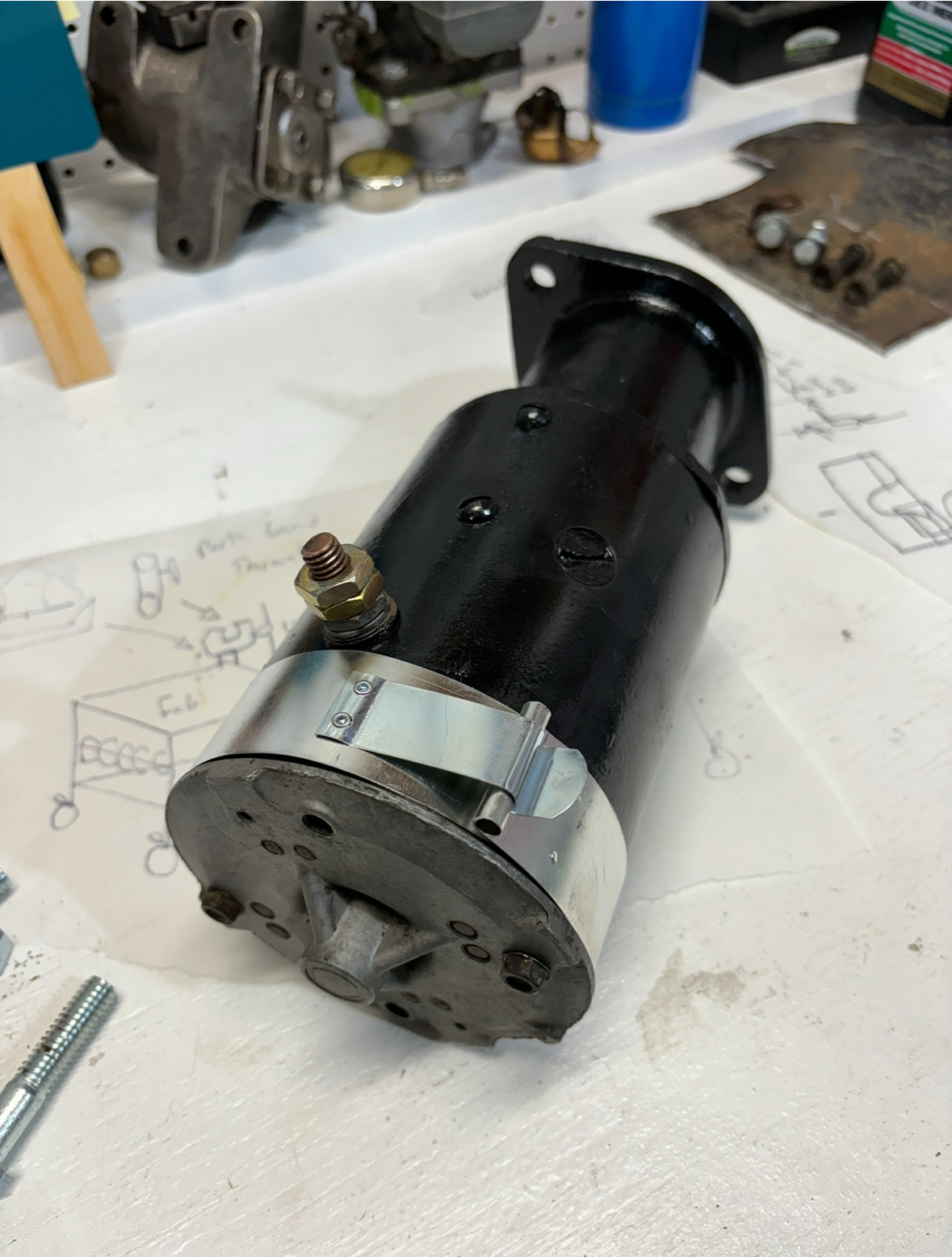

    Paints not even dry and it’s back in my hands. Looks fantastic. @Austin kays pops at summit auto electric in Lees summit did it for me. They do generators as well. IMG_2716.jpeg IMG_2715.jpeg

    He also said with this one in hand he could easily make me another out of existing inventory. Said most of it was the same parts as the tractor starters he builds. Which is kinda what I figured but you can’t copy something you don’t have.
    success either way :)
