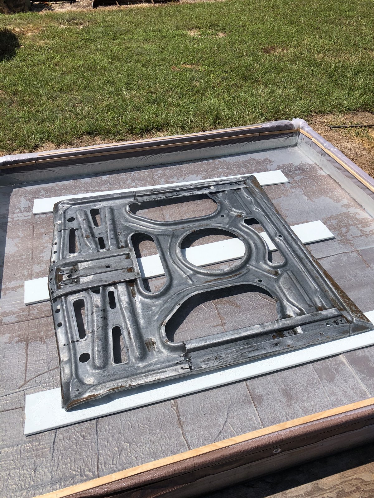

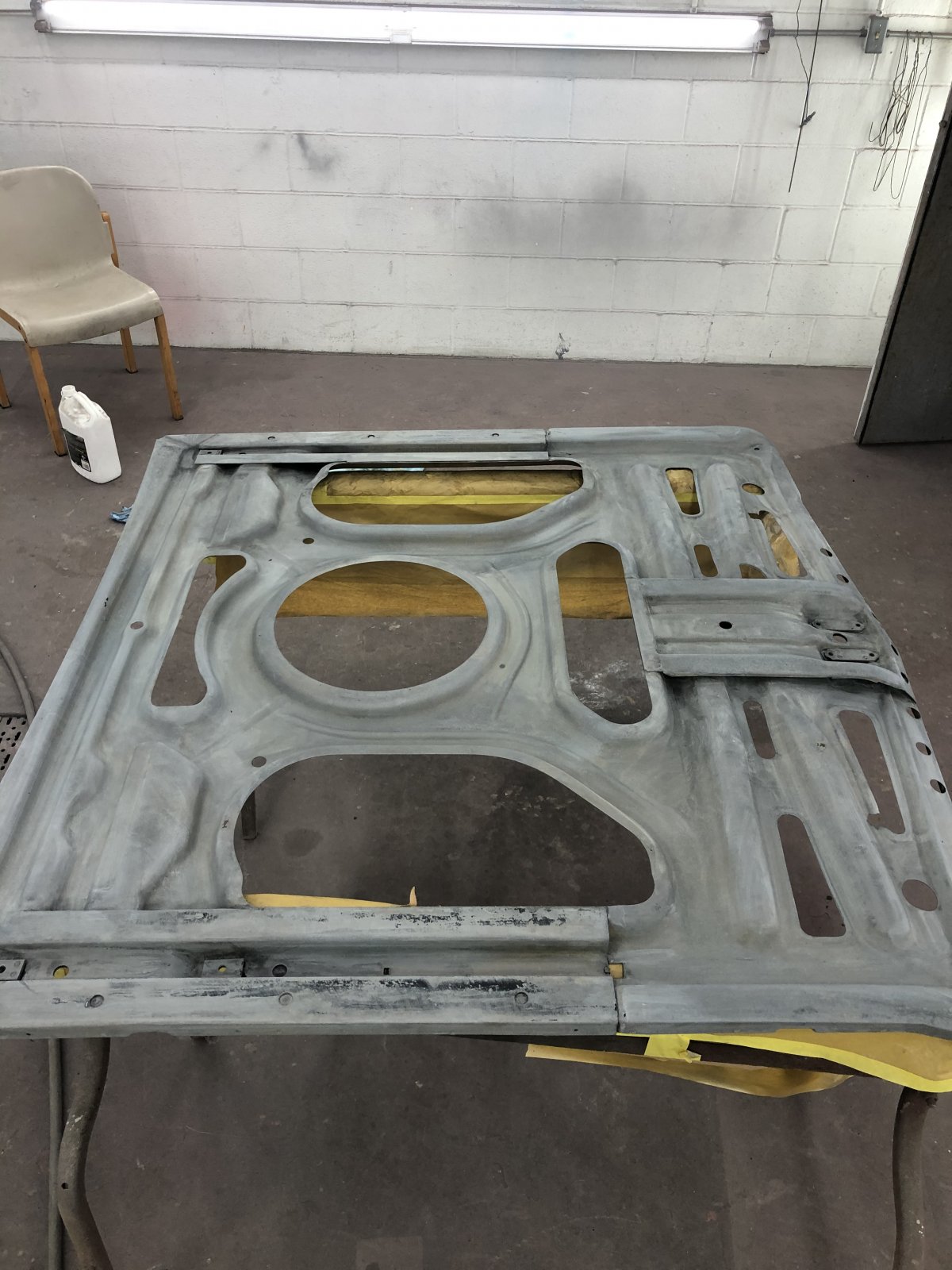

    Not trying to hijack your thread, but I think you’ll be happy with how well it works. D4F6F365-78E1-4DD9-9005-724144F73BEA.jpeg E4A395BF-B9EA-485F-972A-F488BBE9B751.jpeg F6EA0593-C983-4947-A8F4-8ABEFCB8F2DD.jpeg This is the inner structure for the 64 elCamino I have in the shop. De skinned it so I could get it in the best shape possible. Citric acid is my favorite.

  4. Nice! How long did you have it soak? Did you go over the panel with a wire brush?

    The weather was warm which speeds up the process. I let it soak for a couple days, pulled it out, and went over it with a copper colored pot scrubber type pad from the grocery store. I then put it back in for another day. Pulled it out, hosed it off with just a spray nozzle. Blowed it dry and then I wiped it down with some Metal-ready prep and wiped that dry. If you have 10 lbs of powder to 50 gallons of water, then it will probably work fairly quickly, depending on the water temperature.

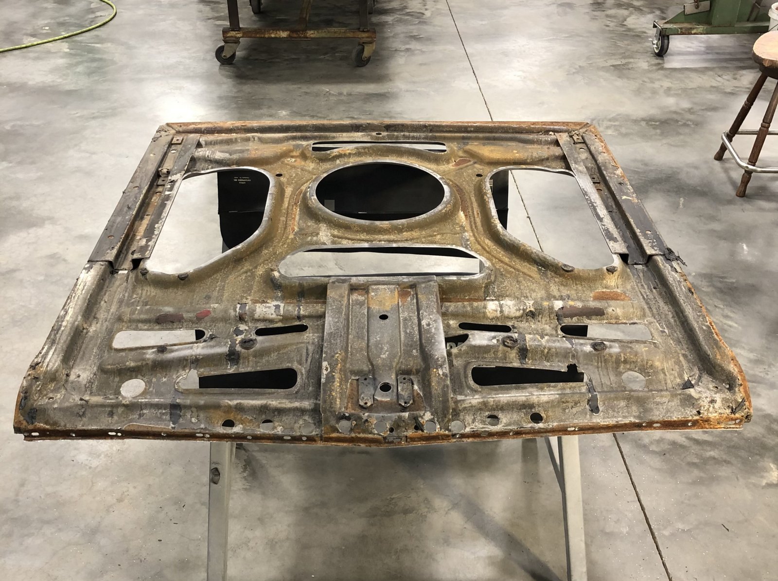

  7. The citric bath experiment came to an abrupt end yesterday afternoon! I may be getting ahead of myself here, so let me go into a bit further detail. The temporary "containment" device I had put together with s**** 2x6's and tarps was not quite deep enough for a full submersion. I figured no problem, place the hood upside down for a few days, and then flip it over for a few days and repeat as necessary. So in it went upside down.
    After a few days of soaking, I took the hood out for a quick p*** with some steel wool (I couldn't find any type of copper scouring pads locally that @ronzmtrwrx showed) and a light wire brushing followed by a rinse. It came out pretty good, though it looked like it could still benefit from another day or so in the bath.

    So, I flipped the hood right side up and left it in the bath to soak for a few days while I would be out of the shop. This would get the hinge area and the bottom of the nose of the hood. My plan had been a couple days in the bath right side up followed by a quick steel wool and then one final soak upside down, final clean up and all would be good with the world. However, when I returned to the shop yesterday, it was clear my very simple "containment" device consisting of a quadruple layer of plastic tarp d****d and clamped over the 2x6's was suddenly not as robust as I had thought. Suddenly those clever citric acid reconnaissance molecules had found a chink in the armour and were implementing their escape! Experiment - ABORT ABORT ABORT!! I knew I should have held out until I found a larger kiddy pool! 20220520_122731_resized.jpg
    So everything was quickly dismantled, rinsed off and let air dry in the sun. I still couldn't find any of the holes in the tarps (maybe I nicked the tarp when I flipped the hood?)...none the less, there was no denying the leak. I have the etched concrete floor to prove it...I've rinsed the floor and sprinkled baking soda to neutralize the acid. Lesson learned...this is an outside experiment!
    The hood which was right side up during the great escape, had a minor amount of flash rust which my original plan to flip the hood one more time would have taken care of...however.

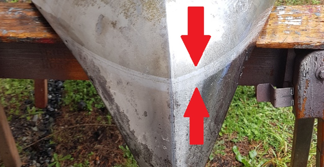

    I have to ask, is that a seam? A stamping line maybe? If so, could you show the other side. I'm curious what Henry did there. Thanks.

  24. That's not a seam...it was the "high tide" line in my make shift citrus acid bath/pond.

    While I did see the top and the bottom High tide line (that was just plain Island funny by the way), it was the middle line that stood out. Had me thinking the standard hood might be made from a deluxe hood if push came to shove. Thank you!
  26. I think the centre hard line was probably the citric acid bath level while my makeshift container was still doing it's job... creating a "parting line" between acid bath and air. The softened grey area on each side of the "parting line" is likely the result of the "container" no longer containing.
