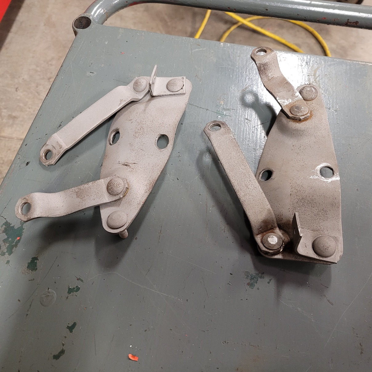

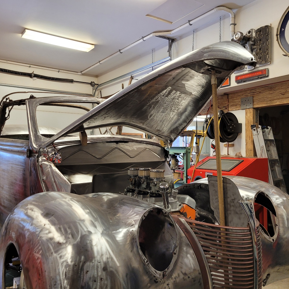

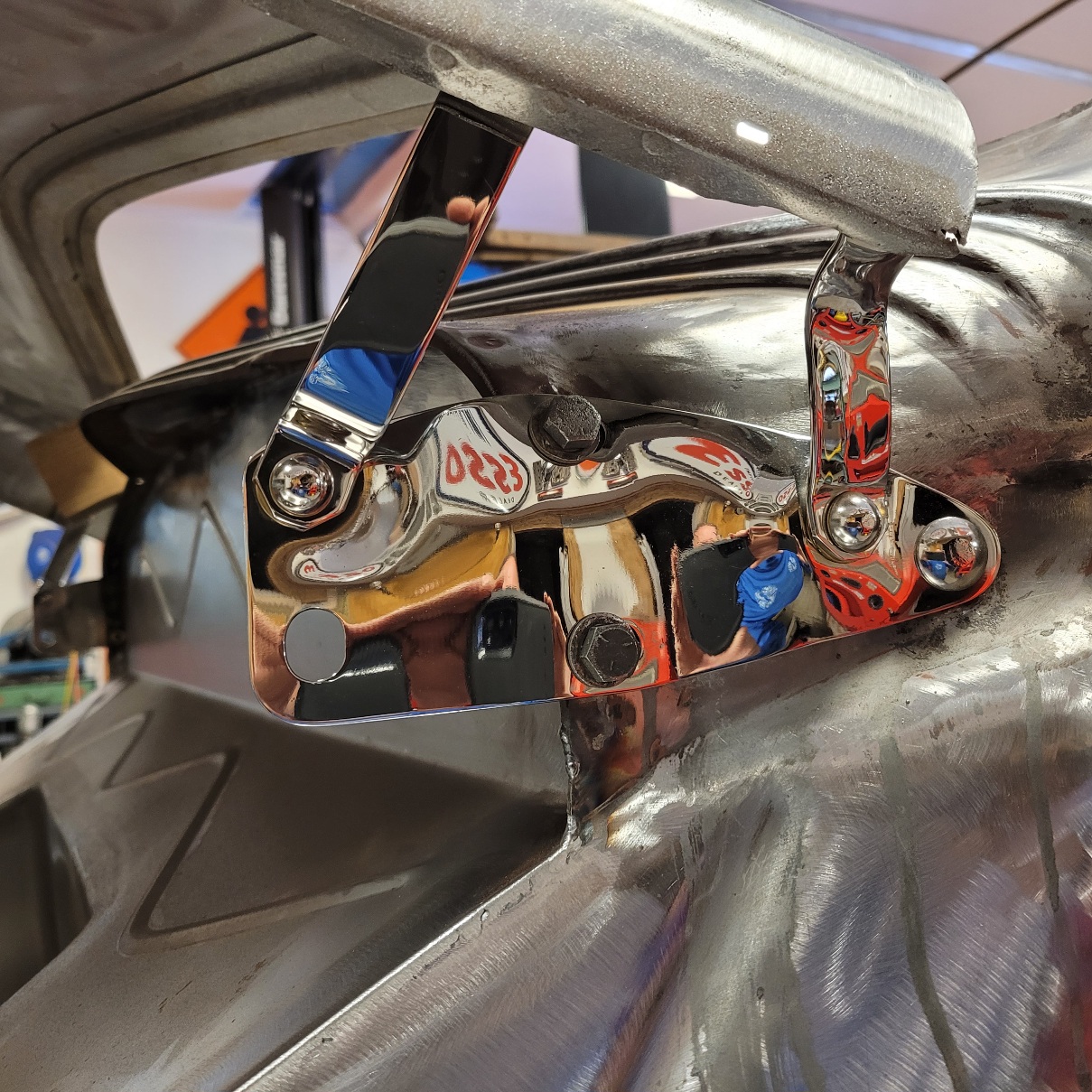

  4. Work on the '32 became a 7 month long project...but it's pretty much done. I'm just waiting for one more part to be delivered followed by an hour of install time and it will officially become the road warrior I intended it to be at time of purchase (Woohoo!!).
    In between waiting for parts on the '32, I would occasionally tinker away on the '38 but wasn't making any real progress. Now that the '32 is pretty much done, I'm back on the '38. To be honest, I was struggling with and not looking forward to the next task which was installing the hood top. I'm not sure of the correct way to do it, but I chose to install the hinges to the cowl and then the hood to the hinges. Frankly, each time I went through the install/removal process, it felt like I was wrestling an octopus! I kept thinking I'm glad this thing is not in paint yet (note to self, once painted I really need to find (or hire) a/some friend(s) to be the spare set of hands during re-***embly after paint). Anyway, each time I ***embled/dis***emble/re-***embled the combo...it never seemed to fit right nor could the previous results/adjustments be consistently replicated.
    Having admired the hood fit on Tony's (aka @X38 ) sloper project, I reached out and asked the secret to his success...he responded...new SS hinges! My old hinges were tweaked, loose/sloppy but tight at the same time (I know that doesn't make sense, but they were loose on the bench and tight and in bind when bolted to the cowl and hood). I had been working away to try and hammer on the rivets, bend and tweak the arms, enlarging the mounting holes to gain adjustment etc. to get the fit better. I was trying everything I could short of resorting to full dis***embly/welding up holes/re-riveting etc..
    So, I found someone (Grump's Garage) that still had those little shiny SS hinges in stock and on the shelves (getting harder to find these days) and that was willing to ship to Canada (which is also becoming a chore) and placed the order.
    Tony's advice was on the money! With the new hinges installed (still had to wrestle the octopus) and after a few adjustments (which required minor hole enlargement), the hood top fits pretty well, opens and closes smoothly, and lands in the same place each time the hood is opened and closed. I taped a couple "shims" along the cowl to replicate the thickness of the hood lacing once installed (after paint) and made a few minor side to side shifts to the front fenders and grill to get everything matching up pretty well. There is a reasonably consistent overall gap between the hood and the cowl and the "beak" of the hood lands pretty much on the center of the grille. I'm pleased with the results. I will now go about adding the small lower braces to the inner fenders and generally firm everything up front before working on fitting the hood side panels.

    I'm glad to be able to share the pain of birth with someone, nothing like a shared experience! I can see from some welds and notes you've written on the cowl that we share more than hinge issues. I'd like to say it's satisfying when things start to come together, but for me it's more simply a relief! Great work.

    Coming on great. My hinges are super sloppy, and I thought i'd resolved it by buying some second hand but new hinges. Looked at them the other day, and they're junk, the rear arm on one side will hit the cowl, and the other side doesn't swing fully, hitting the body mount, guess that's why they were for sale. Really annoys me that people sell their 'junk' to make a buck of another hot rodder, its not the first time i've bought parts in good faith to find out they are trash. Anyway, just looked at Grumps, they've sold out. Anyone know of any other good hinges? '

    On my '39 convertible I tried to rebuild original Ford hinges, bought Bob Drake Repos, nothing helped fix the hood fit problem. Finally tracked down some NOS Ford hinges, instant success. In comparing the NOS hinges to the repos, you could see that the arms are no where near being correct in shape.
  10. Thanks for the positive comments guys...
    Joe's Antique Auto (https://www.joesantiqueauto.com/) was still showing stock when I was looking but he no longer ships to Canada which I found disappointing as I had purchased quite a number of items from him over the years and always found he had good stock at fair prices and had options for shipping. I just noticed @neilswheels that you're in the U.K. so Joe's may not be of value to you either. Perhaps you could find someone/friend in the US that could act as a forwarding service?
    I've heard a number of people that weren't happy with the fit of the regular steel hinges, but the stainless steel hinges seem to be of better quality. The ones that I got were made in the USA by Vintique.

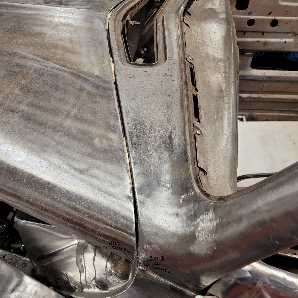

  14. Next project is fitting the hood side panels, but before starting on them, I wanted to get the grille fitting a bit better. Specifically on the p***enger side at the top. The grille pulled away and down from the fenders in this area. I had tried making adjustments between the grille and fenders, tried opening it up on the flange using the stretcher (didn't work well due to the support spot welded on the underside) and even hit it a bit with hammer and dolly...but it simply wasn't moving.
    So I finally decided to stop ignoring with hope that it would go away and get serious making real adjustments. After removing the grille I split the top and side flanges with a cut-off wheel and opened them up to where they needed to be.
    I then added slivers of steel to take up the gap created.
    I also had to split and open up the reinforcing panel on the bottom side and re-weld it in the new location.
    After a bit of grinding the fit between the grille and fender is much better and I can start fitting the hood side panels.
    Deutscher, brEad, bchctybob and 7 others like this.

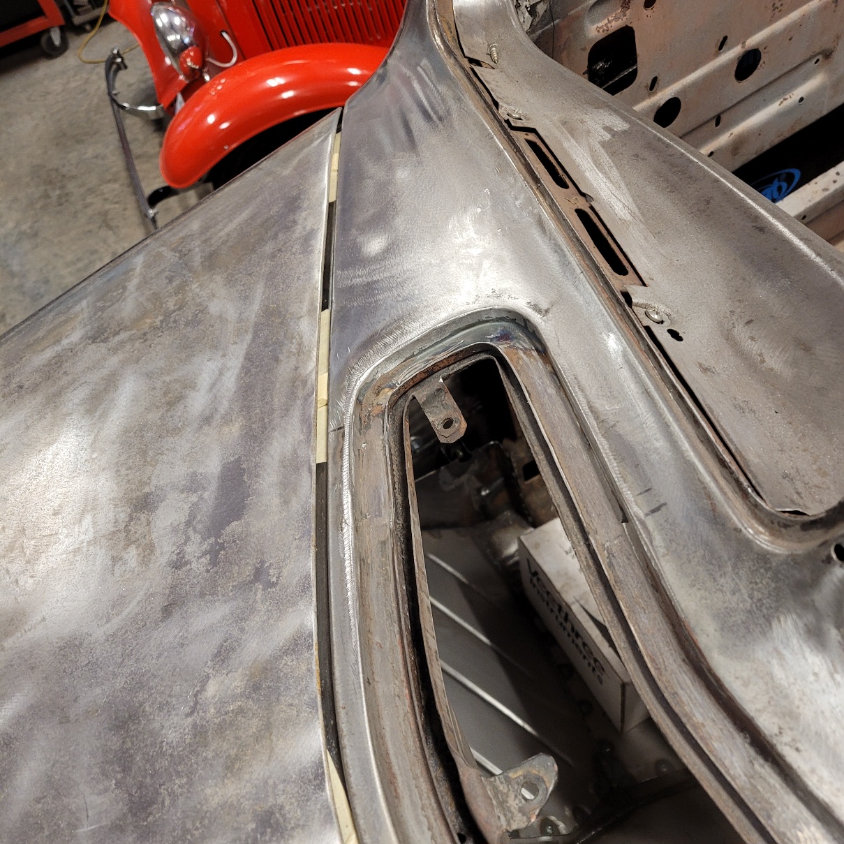

  22. It's been a few weeks since my last update...and I've finally made enough progress that it's worthwhile to post. I've been working on fitting up the left hood side panel. I had been thinking (and worrying) about it for awhile. The issue stemmed from the poor fit of the left front fender to the cowl. I had posted a question about it earlier and the advice at the time was to wait until all the supporting brackets were installed and the front sheet metal was fully adjusted to optimize the fit. Good advice, but it still fit very poorly. and nothing I was able to do seemed to close the 3/8" gap.
    I then went back to some of my earlier photos taken when we first purchased the car. I don't have the best pics of the area, but based on what I could see, I'm not sure the hood or fenders ever seemed to fit very well. 1938 Ford Club Cabriolet 006.jpg 20130901_095915.jpg
    It was time to take a more drastic approach. I made a template of the arch of the inside top of the fender in the area where it was supposed to meet the cowl, and then turned that into a new fender flange.
    20230315_143743.jpg 20230315_143811.jpg I then laid the new flange on top of the fender to mark the area to be removed and ran a cut-off wheel a little further to allow part of the original flange to "relax" against the cowl.
    A little time behind the welding helmet, followed by some face shield time to grind and finish the weld followed by more time with the hammer and dollies yielded a much better fit.
    I then realized that I hadn't gone quite far enough forward with my new fender flange and it resulted in a pretty harsh transition. Again, out came the cut off wheel to allow the transition area to better blend into the desired shape.
    20230401_103412.jpg 20230401_104422.jpg 20230401_105128.jpg 20230401_112855.jpg
    I then made the same changes to the hood side fastening system as the right side. I cut some of the recessed areas out and moved them to other locations which appeared they may have previously been cut with a beaver and then cracked as well. 20230401_122318.jpg 20230401_122323.jpg 20230401_122329.jpg 20230401_124024.jpg 20230401_124033.jpg 20230402_122716.jpg The bottom line, over the past few weeks, I had the left side panel on and off the car about 100 times (I was going to say a million, but didn't want to seem like I was exaggerating!). At the end of the day, I'm pretty happy with the fit of the panel.
    I also added a couple more fender bolts to "help" clamp the fender to the cowl. I did this on both the left and the right side. I figured, just because Henry decided they weren't necessary (or was too cheap to add them), no reason I couldn't or shouldn't. I made a quick bracket to back up the cowl, tacked it into place and drilled a couple extra holes for the additional nuts and bolts. That really seemed to help pull the fenders and cowl together.
    That's all the updates I have for now. For my next task, I may transition my efforts to the rear axle housing, rebuilding the pumpkin, switching the Lincoln Versailles rear disc brakes to drum etc. I'll continue do***enting the progress.
