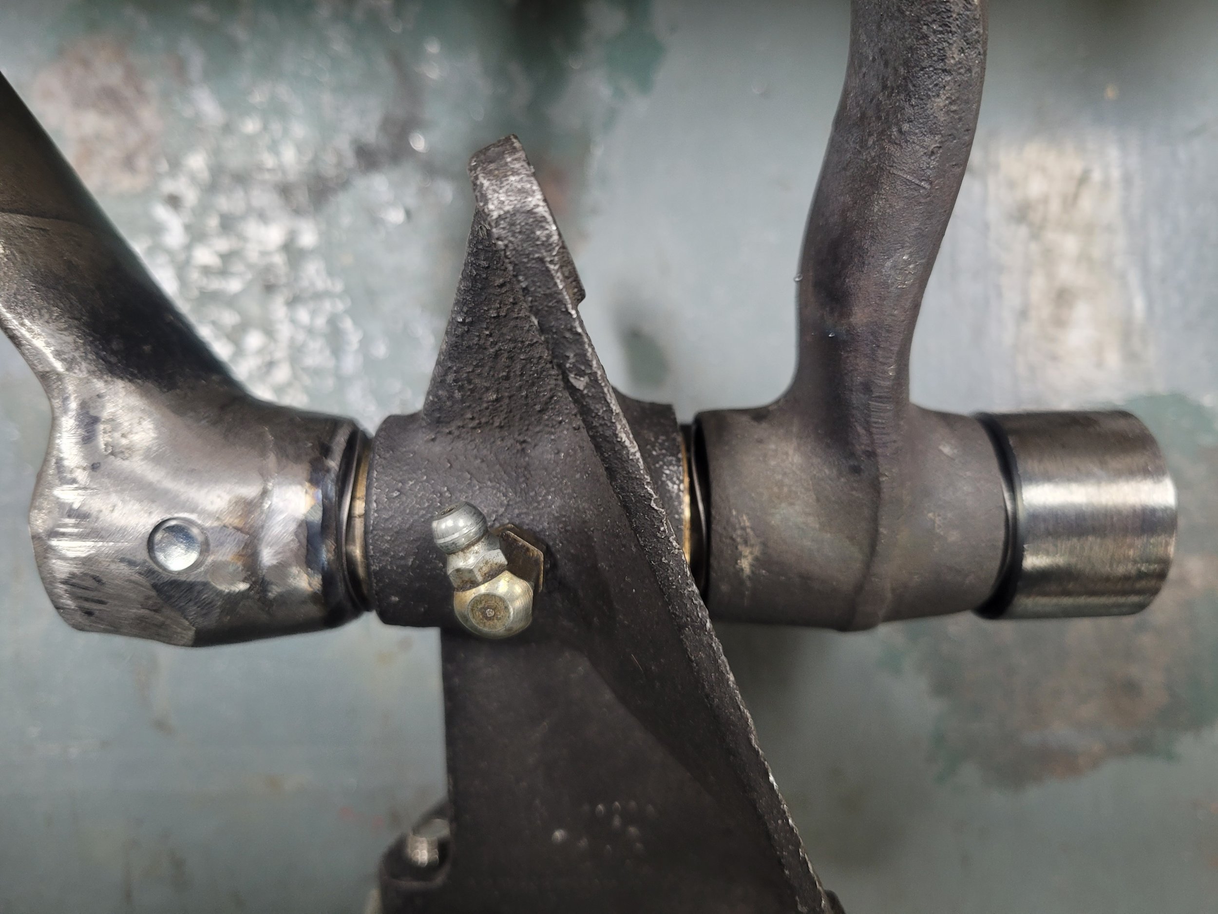

    The issue with '40 style pedals is the pivot shaft is press fit into the bracket that bolts to the ch***is and both pedals "float" on the fixed shaft. This is unlike a '39 where the clutch is fixed to the shaft. The brake pedal still floats on the shaft, but the shaft is allowed to pivot in the ch***is bracket thereby transferring the clutch pedal movement to the other side of the ch***is bracket and brake pedal to activate the clutch arm. I wanted to change my master cylinder from a disc/disc 1" bore Corvette master cylinder to a disc/drum 15/16" bore master cylinder which also provided a good opportunity to come up with a better attempt on the pedal ***embly, specifically for the clutch. I had sent out a couple queries for a genuine set of '39 pedals, but was unsuccessful at the price I was willing to pay (and maybe that's on me).

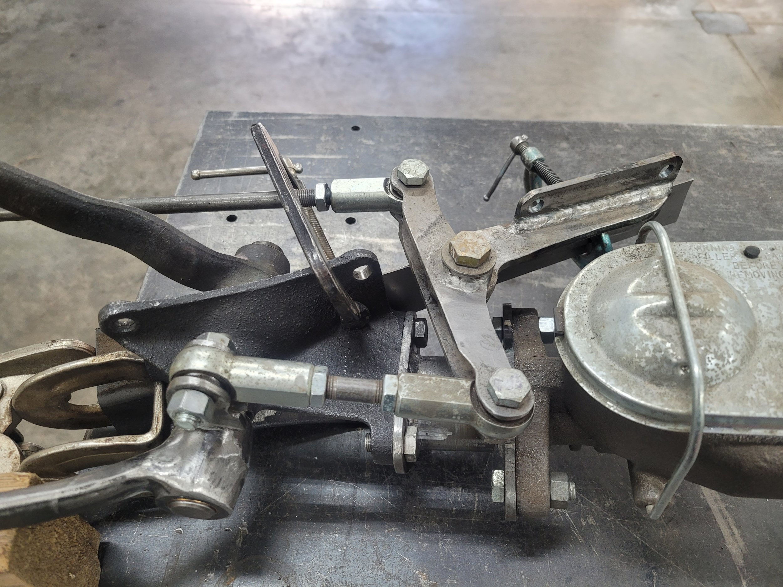

    So first thing was to dissemble the pedal set (along with my Rube Goldberg clutch activator) which involved pressing out the original fixed pivot shaft. Once the shaft was out, I scoured my steel cache and found a piece of cold rolled 3/4" shafting that was longer than the original. I also increased the size of the hole that was bored into the ch***is bracket using an adjustable reamer set such that I could press fit a pair of br*** bushings into the bracket leaving a gap in the middle for greasing. I also drilled and tapped a hole to install a new grease zerk (I also plan to score a small grove in the bushings so the grease has a place to migrate.
    I then cut the new shaft to the desired length and on one side I made and attached the clutch activation arm and mocked it all into place.
    I now needed to fix the clutch pedal to the shaft...but it had to be removeable. The clutch pedal had a grease zerk with a thread that was 3/8" NF. With the grease zerk removed, I installed the shaft and center punched it through the grease zerk opening. I then drilled through the shaft and out the other side of the clutch arm. I took a 3/8" NF bolt and machined off the threads on the bottom end to create a threaded pin.
    Installing this bolt in the grease zerk, through the shaft and into the other side of the clutch arm locks the clutch pedal to the shaft. (Note that I left the new bushings in place (I installed when I originally rebuilt the pedal ***embly). I debated removing them and then making a steel sleeve to take up the space, but I couldn't see a benefit for the effort).
    I then installed wavey washers between all the arms and pedals to take up any slop.
    So there you have it...a set of '40 style pedals made to work like the more desirable '39 style. And, the new Disc/drum master cylinder also now fits thanks to a few minutes with a carbide bur. 20241108_143901.jpg I still need to add the clutch pedal return spring...that's the next mini project.

    Velly interesting! So for clarification, the system in the first two photos is not what you used? You are going to use the simpler system as shown in the last photo? If that is what you are doing it looks very similar to the modification I made in my first 40 with small block chevy and 3 speed trans back in 76. It worked well for me. I like it!
    brEad likes this.
  3. You're correct Sam...the first/more complicated version is on the cutting room floor. I'm using the second simpler version.

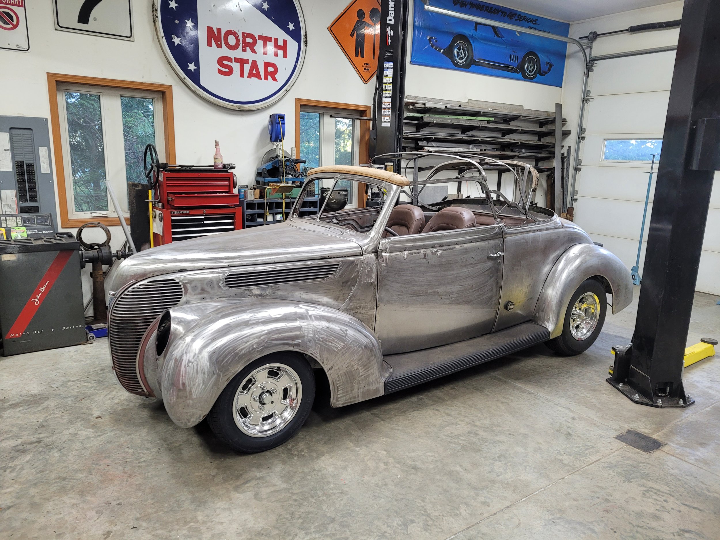

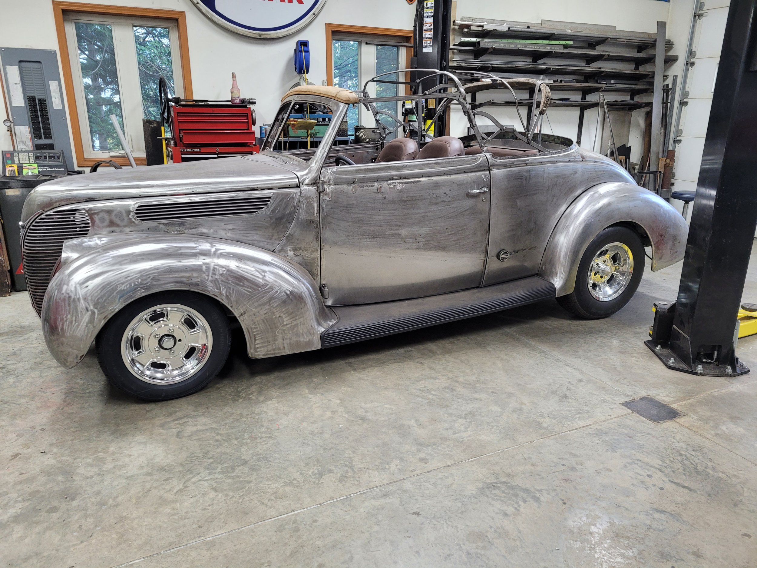

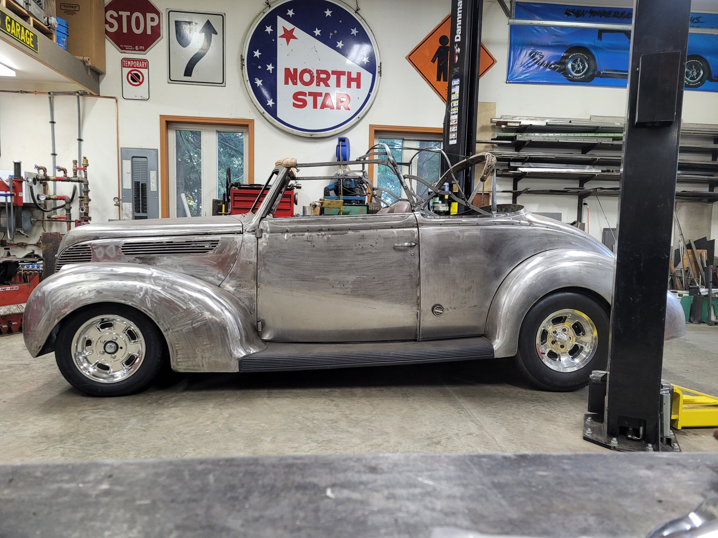

  10. Now that the ch***is is pretty much done (still need to run plumbing and exhaust, but I'll save that for when the body comes off again)...it was time to put all 4 tires/wheels on the car and let it stand on its own for the first time. I couldn't help myself...and shot several photos. It made me smile.
    As a side note...my front wheels are Halibrands, the rears are the Edelbrock knock offs. The rears use a tapered lug nut. The fronts use a shanked lug nut. I have the longest shanks I could get (1 3/8" I believe)...between the lug nut shank length, the wheel stud length, the just shy of 1.750" thick wheel mount surface plus the .250" hat for the spinner mounts...the lug nuts would only be holding by a scant thread or two. I need to come up with longer wheel studs. I guess that'll be my next project.
    20241203_144104.jpg 20241203_144110.jpg 20241203_144406.jpg 20241203_144449.jpg 20241203_144734.jpg 20241203_144807.jpg

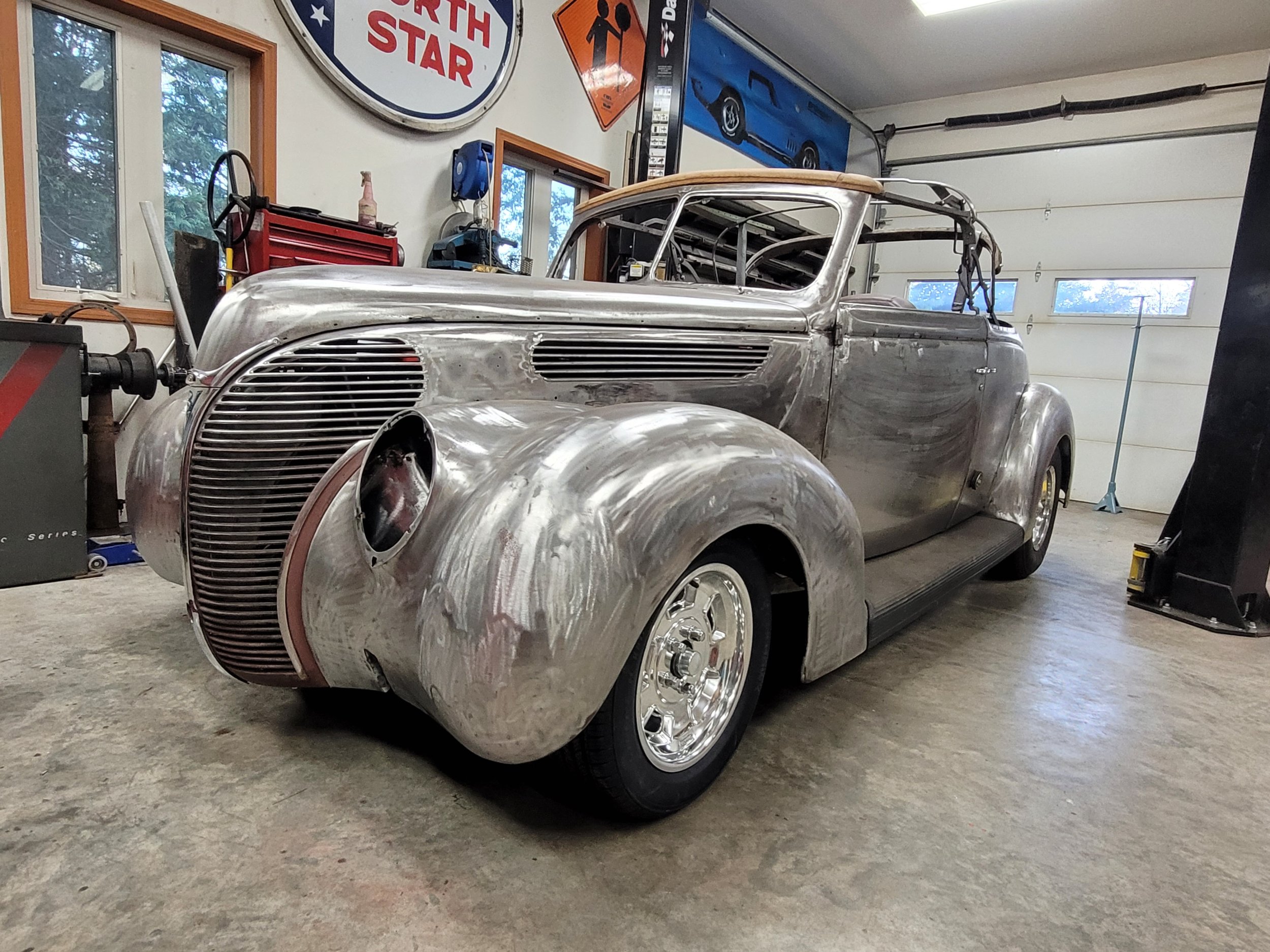

  21. I'm trying to get the last few metal fabrication type things wrapped up before I start on the bodywork phase. With that in mind, it was time to get serious about mounting up the rad. After drilling the new firewall to install the support rod brackets, the new PRC aluminum radiator was positioned in place. I've used their radiators in a few builds and like their quality, fitment and the fact that there is no epoxy, they are fully welded. They will also work with you if you have the need for custom locations of outlets, sizing, mounting details etc.. For this rad, I just ordered their off the shelf unit.
    Once the rad was mounted, it became clear that fabricated panels for the sides of the radiator are necessary to make sure at least most of the air is directed through the rad, rather than around it.
    With the further aid of CAD (Cardboard ***isted drafting), 18 gauge steel was cut, bead rolled and then installed on each side of the rad. There needed to be enough room between the radiator side panels and the sides of the hood to allow the hood sides to be removeable but still direct most of the air towards the radiator.
    Next was the fan shroud. I prefer engine driven fans wherever possible. So, with the water pump, pulley and fan mocked into place, I marked the fan cir***ference on the protective cardboard taped to the radiator. I also like to have the front of the fan 1/3 to 1/2 inside the shroud, so I measured the depth the shroud would need to be (1 3/8" in this case). The rad was then removed and placed horizontally on the bench.
    And, spacers were added to a cardboard cut out of the fan cir***ference.
    A few measurements were taken and sketches made. The details were then transferred to steel, cut, folded, hammer/dollied (the flange next to the fan blades) and welded. The resulting 2 piece shroud was fabricated. I make them in 2 pieces to aid removal and installation for future servicing.
    Here's the shroud in place after finishing the weld and installing nutserts to hold it in place. I've used this set up on a number of cars and, knock wood, they've all cooled very well.

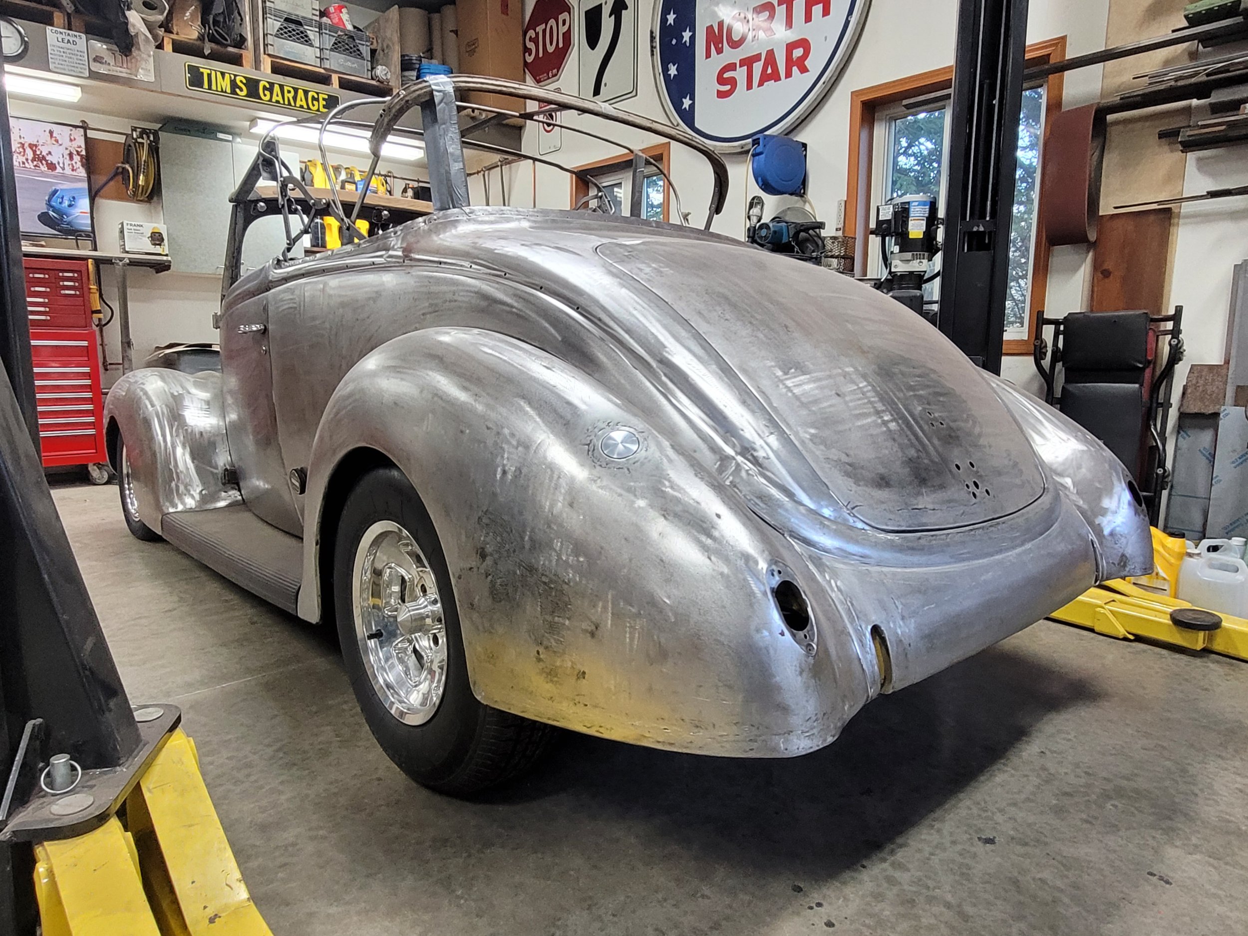

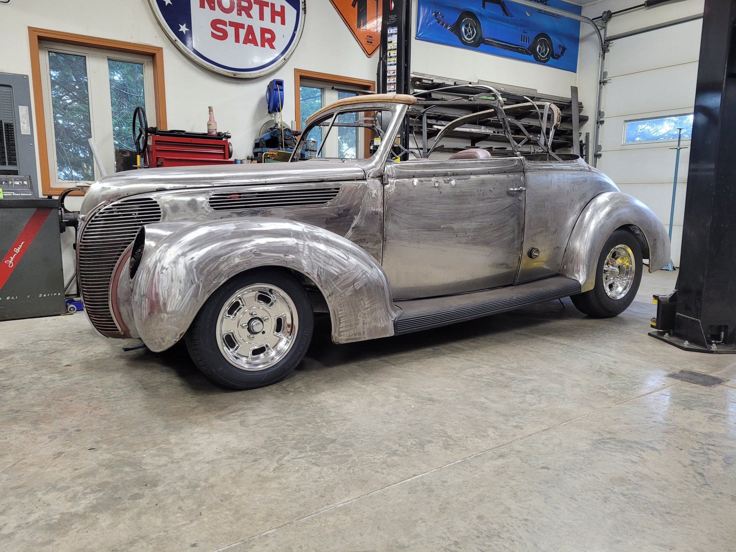

  26. I've been doing a bit of work around the decklid. First was adding a set of adjustable bump stops so I could close the decklid in a consistent location. I know that the weatherstripping has a say in the matter, as does the trunk latch, but I wanted something more positive. I made the little "shelves" on the large side because I intended to also add a set of locating pins for the decklid to close onto (again, to consistently locate the truck from side to side). Well after a couple attempts, I realized the angle the trunk lid closes at relative to the "shelves" was not going to work with pins...so that idea was abandoned.
    Next was a couple trunk rain gutter drains. I drilled a hole on each side of the latch and then through the bottom of the tool tray and inserted some 3/8" OD tubing. I welded them in at the rain gutter and JB welded them at the tool tray.
    View attachment 6301358 View attachment 6301359

  29. Thanks Gene, hope to see you (and maybe your project?) this week.
    Bill, It's going to arrive at the car show in a hermetically sealed garage on wheels, get carefully dusted at the hotel and then rolled in front of the host hotel entrance for an afternoon of power parking! That is, IF the weather permits. :rolleyes: Like a log! :p We drive 'em!! See you Tuesday...and I'm looking forward to it!
    We have a hardware chain in Canada (Home Hardware) that has their own line of Alkyd rust paint (Beauti-tone). It's very similar to Rustoleum and Tremclad, except it is fully tintable to any non metallic color. They use one of those color scanning cameras and are able to match the paint almost perfectly. My intent is to use this paint on the underside and interior (under the upholstery) of the car (tinted to match the planned outside color). So, with that plan in mind, I removed the rear fenders and gave them a fresh sanding with 80 grit on the DA sander and treated them with phosphoric acid to neutralize any remaining rust that might be deep into any of the microscopic pits. It also leaves a zinc like coating as a future corrosion resistance barrier.
    Then the alkyd primer was brushed (I haven't got the alkyd tinted topcoat paint yet) on the underside of the fenders.
    The fenders were re-installed (the difference in color between the phosphoric acid treated fender and the non-treated steel of the body is evident) and then the first day of "making dust winter" began! The whole car will get a skim coat of filler followed by hours of block sanding. I like my cars to be laser straight.
