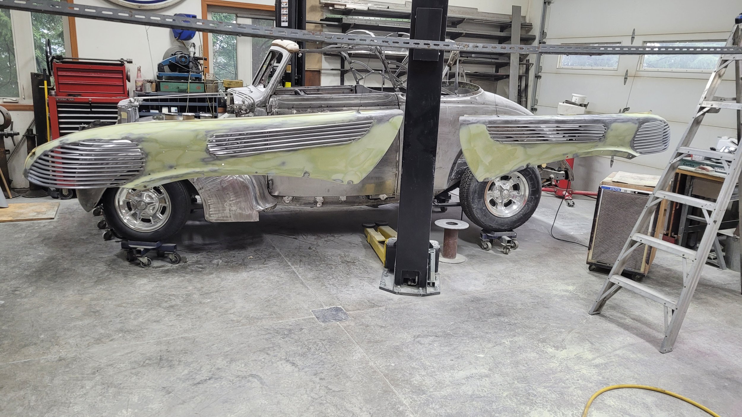

  7. After a couple week hiatus to hang with my buddies in So-Cal for the GNRS, it's time to get back on the '38. In reality, while representing a major step forward, the body work stage is probably my least favorite task of a build. For the next several months, I will be wearing a dust mask when in the shop and will have my filter fan box nearby at all times (I blow the filters out at least a couple times per day when I'm sanding filler). When I was younger, I never bothered with the filter mask, but I was not too bright either and would pay the price with hacking and coughing each morning. I've also never been great at "selfies" either...but here we are.
    I should also add, that in the past when using phosphoric acid to convert rust, I would then spray PPG epoxy primer over the phosphoric acid etched panel. Then do my filler work on top of that. That system seemed to work well for me. But, with the price of PPG epoxy primer going through the roof and much of it being sanded off while doing the filler work anyway, I decided to try going straight to the filler stage directly over the panel (after the acid treatment). Opportunity to learn from my mistakes!! It turns out, that the filler was not happy with the phosphoric acid basecoat and had issues bonding to the panel (internet search confirmed this little detail...doh!!). So, I ended up having to pretty much sand and clean off all the acid. It was better to find that out now! Anyway, after the fenders got a thin skim coat of filler along with the required sanding, they were removed from the car and set up on saw horses.
    I then stood them up back to back using small pieces of plywood screwed between them to hold them together and masked the underside. They then received a couple heavy coats of PPG K38 high build primer. They'll now be set aside for a couple months to allow for any possible shrinkage before they get a guide coat and the next round of blocking sanding. In the mean time, I'll move on to the next panels.
    While bodywork is my least favorite part of the build, it is rewarding to see a panel in one color of primer!

  18. As can be seen below, I've been working on the continuation of making dust.
    My revised metal prep process includes 10-15 minutes of wet time with a phosphoric acid solution, followed by being wiped dry, then 10-15 minutes of wet time with a baking soda solution to neutralize the acid, followed by another wipe dry, then a quick wipe/scrub with a water soaked red Scotch Brite pad followed by a wipe dry and then an aggressive blowing off to remove any remaining moisture. The metal is then ready to accept the filler work.
    The next 2 panels to receive the metal preparation, filler work and then finally the high build primer are the decklid and the hood top. After watching the video posted in post #425, I decided to give the polyester filler primer Slick Sand a try. It's pretty thick and my Harbor Freight purple primer gun struggled with it a bit. I had already re-drilled the orifice up to 2mm but it may need to go another size up.
    These parts, like the rear fenders will now sit for a couple months while I move on to the next panels so that any shrinkage that might happen can occur.
