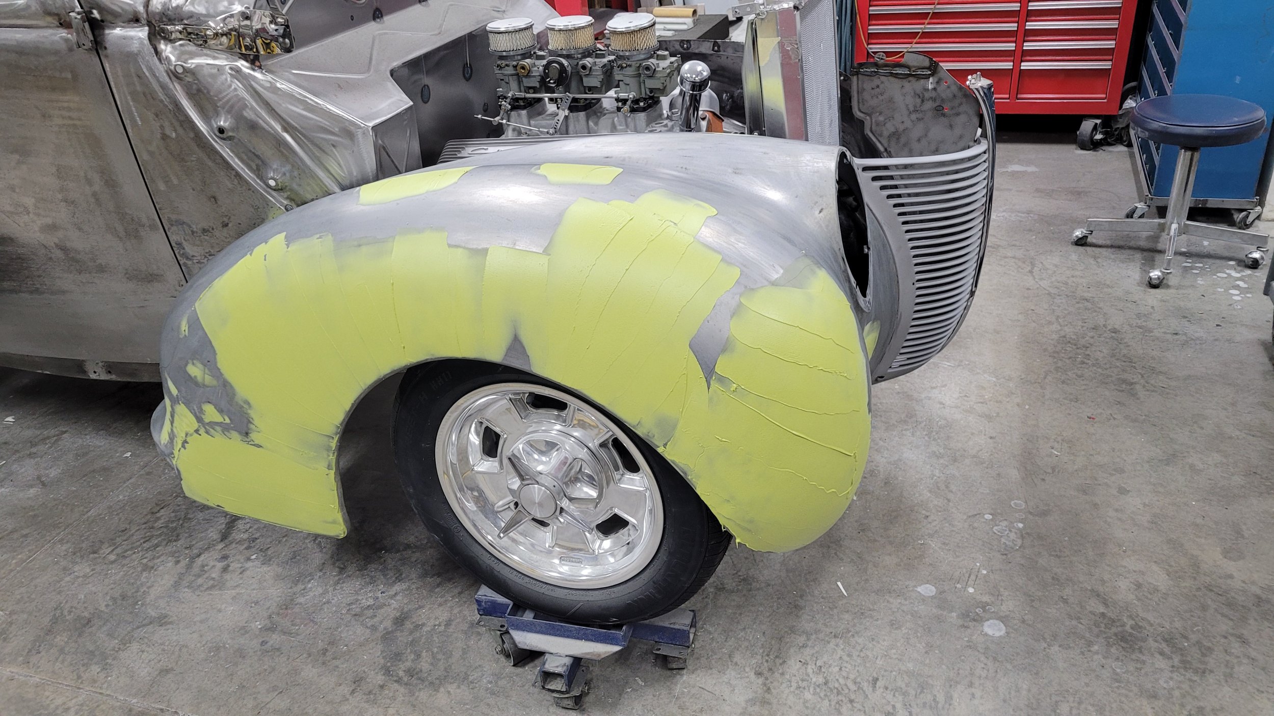

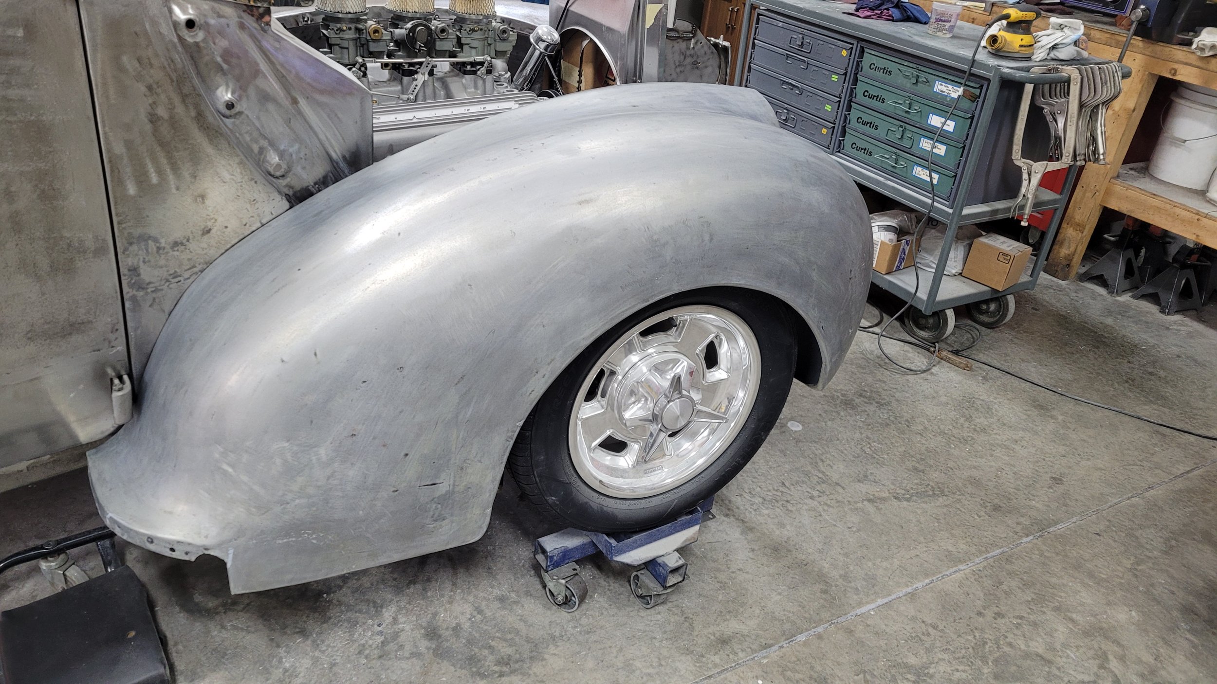

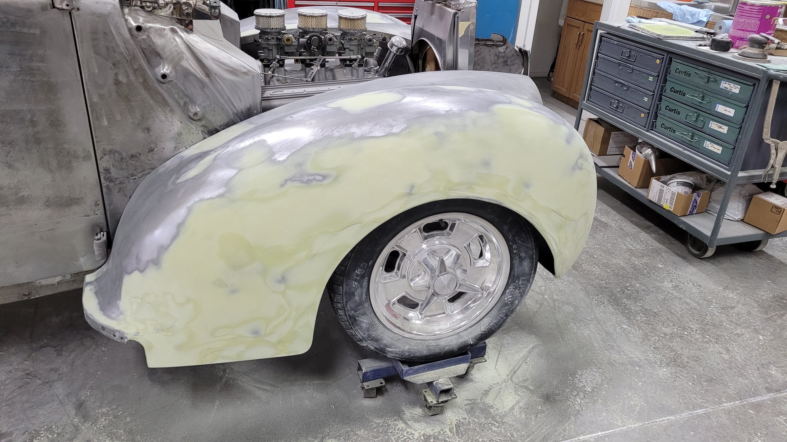

  6. It's been a few weeks since my last update...between life events, I've been able to find a few small pockets of time here and there to work on body working the front fenders.
    Once they were metal prepped, they received about eleventy-two coats of Rage Gold filler.
    Followed by sanding and removing eleventy-one coats of filler.

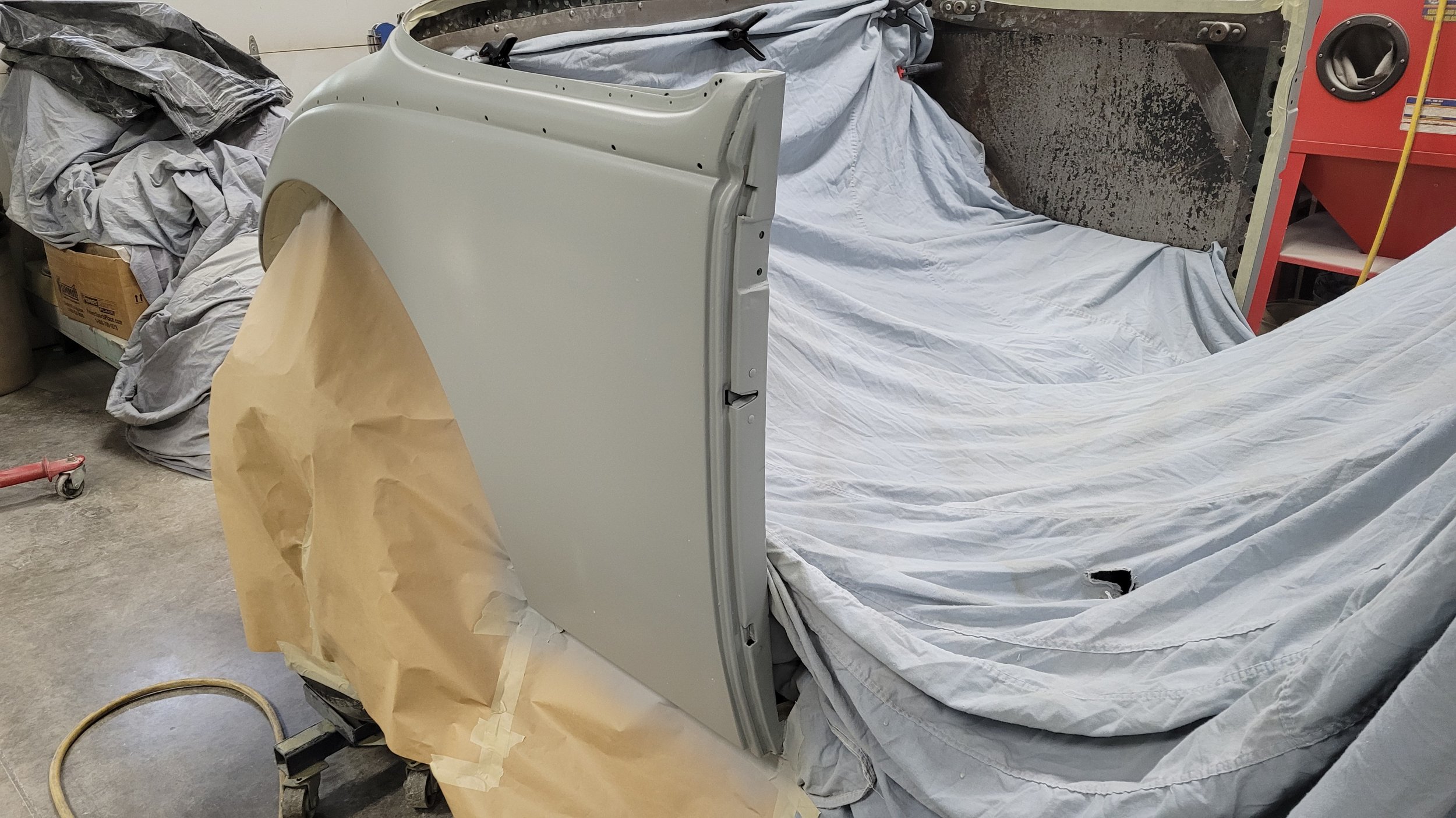

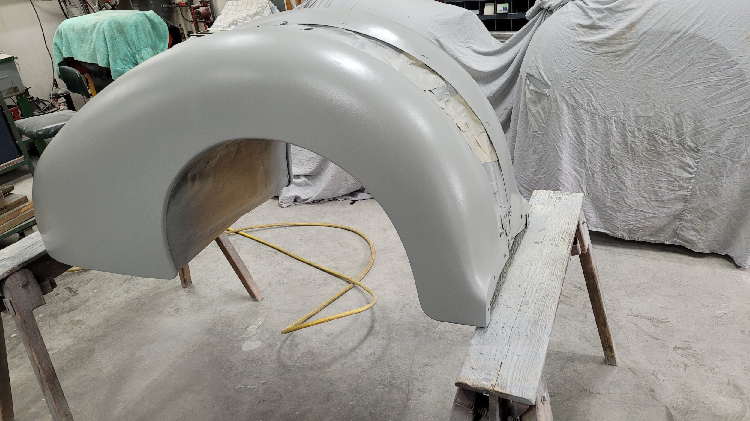

    Once done, they were removed from the car for a few coats of high build primer. There's nothing like a panel being all one color again to show the areas that somehow require additional attention (I missed a few spots on these!).
    The front fenders will join the other primed panels slowly curing and awaiting guide coat and additional block sanding (not to mention additional work on the areas that I missed).

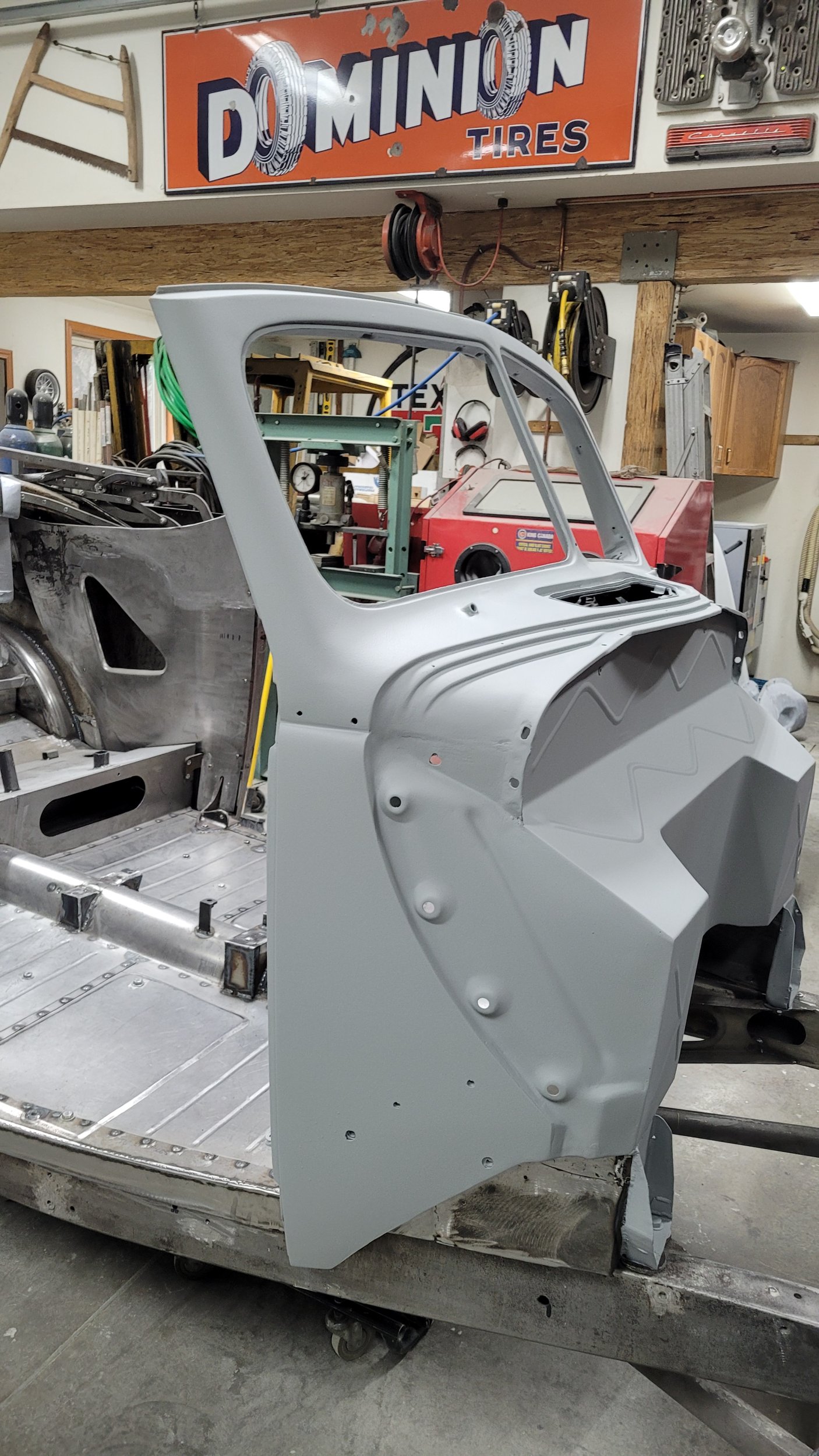

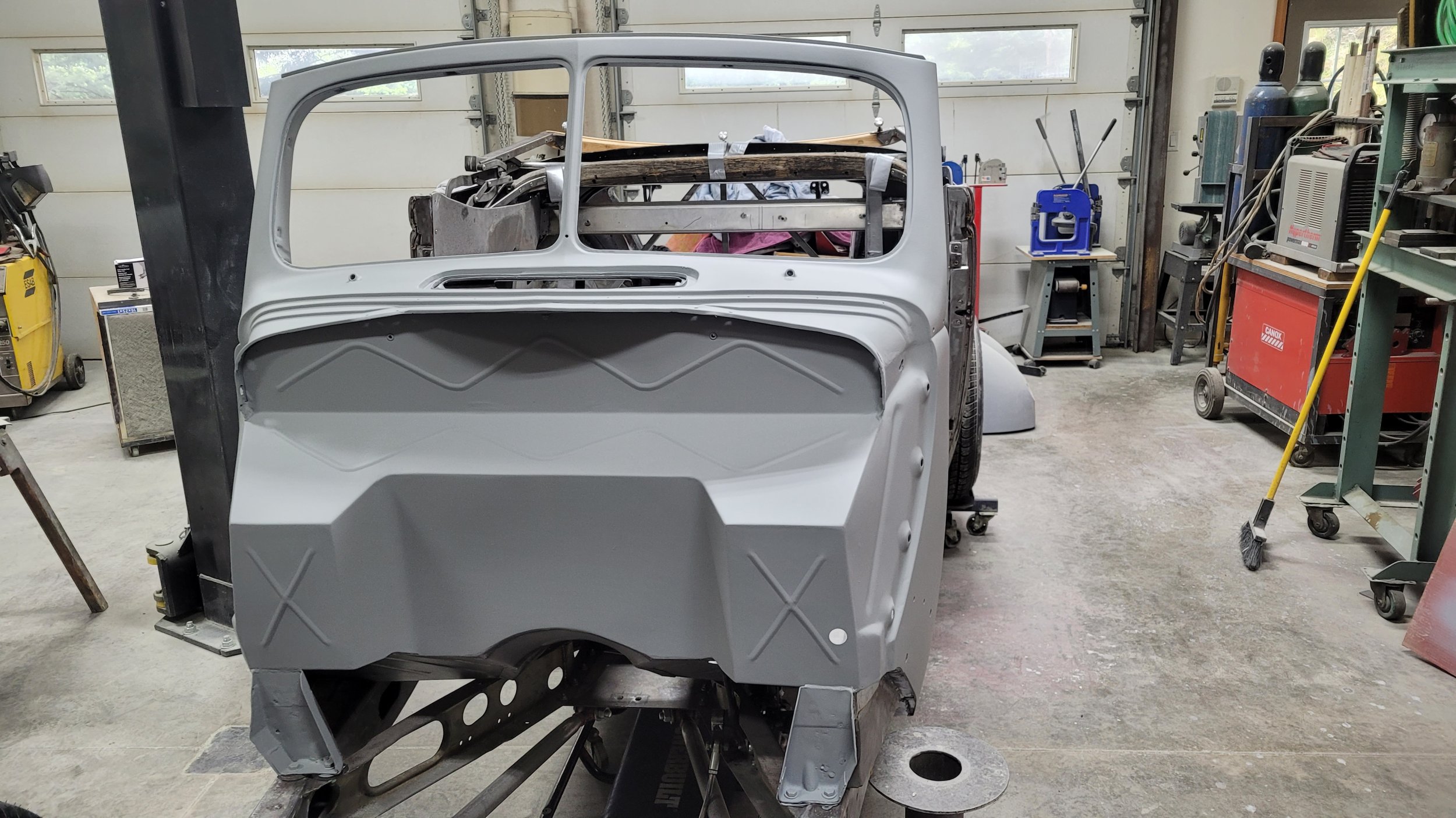

  14. I've been slowly plugging away at the body work...next up was the cowl and dash. After stripping pretty much everything that was in the way and that would unbolt, I cleaned up the sheet metal one last time, applied filler, sanded filler, added more filler, sanded more filler and repeat etc...until it was ready for the high build primer. 1000012678.jpg 1000012679.jpg 1000012695.jpg 1000012814.jpg 1000012815.jpg 1000012816.jpg 1000012834.jpg
    I was curious about trying out the "stink block" that Darryl Hollenbeck mentioned in his video (linked in post #495 above). I had done a bit of research and found the product he references is actually an Owen-Corning gl*** foam insulation product used in the construction industry. I sourced it locally and used it as the first round of blocking out the rear fenders (the high build primer had been curing for a few months). The foam gl*** works very well in quickly conforming to the compound rounded shapes of these cars and parts. The foam gl*** and guide coat, works very well at quickly levelling out the panels. I was/am impressed! After a quick lap of the rear fenders using the foam gl*** as the sand paper and block, it quickly levelled out the primer/panel and showed some highs and lows that were left after the first round of body work. After I was done with the foam gl*** sanding block, the freshly "straight" rear fenders got another (and I believe the last) coat of Slick Sand high-fill primer.
    Next up will be the doors.

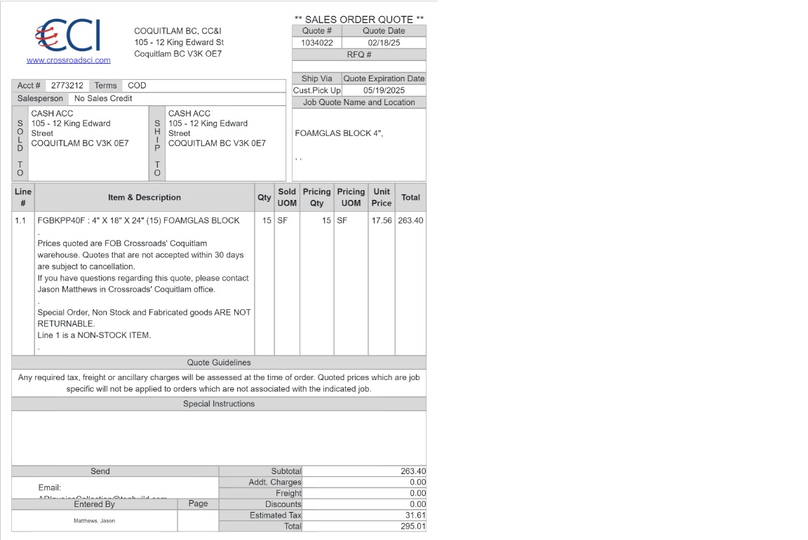

  16. This is a copy of the invoice for the block that I purchased. It gives the product number, supplier and the cost (in Canadian $) for the 15 sq ft (5 pieces, 18"x24"x4")

    Owen-Corning gl*** foam insulation product FGBKPP40F Foamgl*** Block

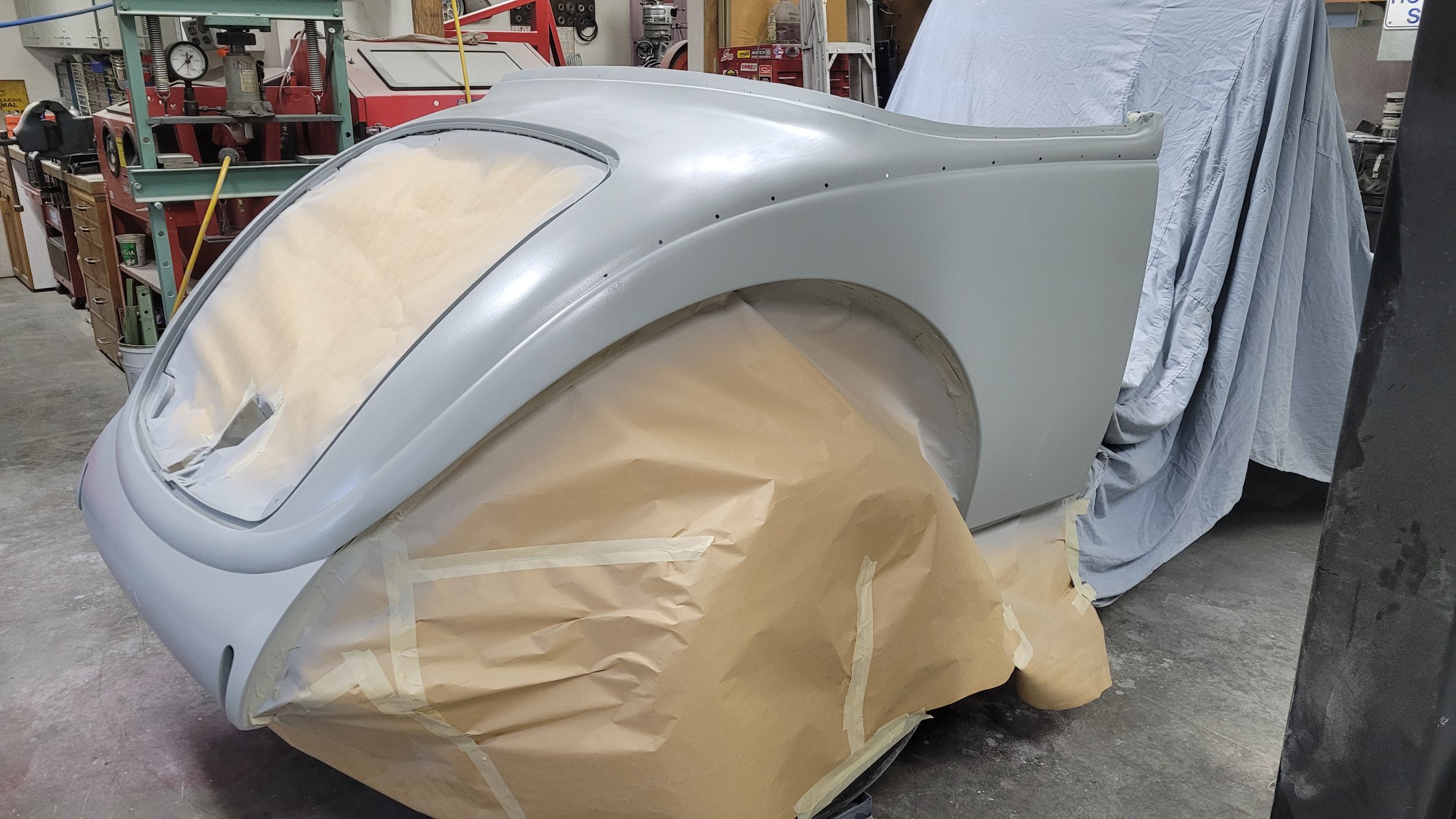

  21. The last section to complete the body filler stage was the rear 1/4's/body tub...
    Once done with the filler, a quick round of masking tape and the rear 1/4's/body tub got a few coats of high-build primer (Yay...all one color again!!!).
    I will be switching gears for a few days to do a round of maintenance on the '32 so it's ready for Deuce Days in Victoria next month. I may even try to get in a day or 2 of Coho fishing! Then it'll be guide coat and the progressively finer grades of sandpaper block sanding will begin.

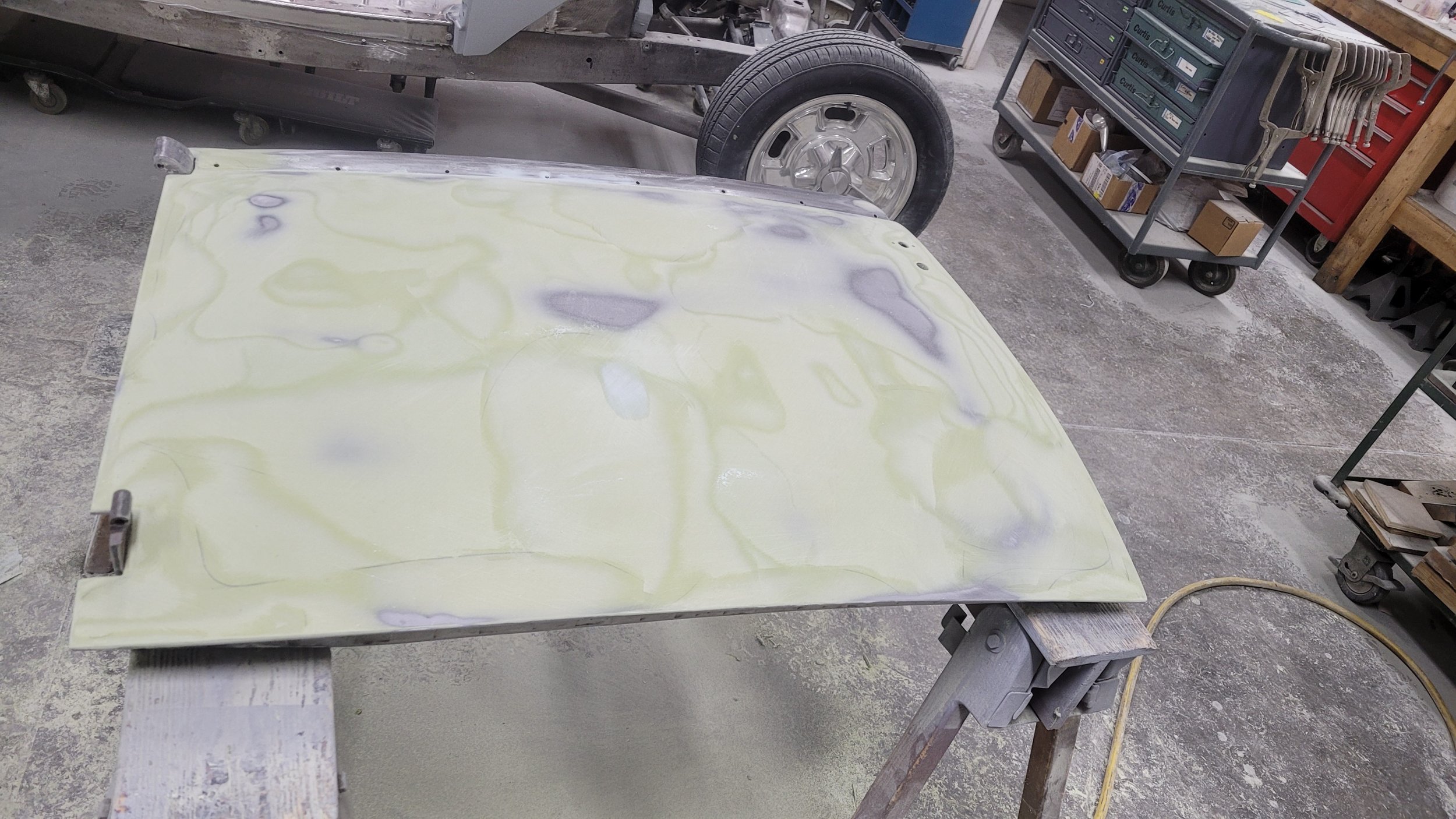

  24. It's been a couple months since I showed any progress on the project cabriolet. It's been an action packed 2 months (included fantastic Coho fishing, getting the '32 ready for Deuce Days and road trip, a trip to Manitoba to help with a family construction project, attending Deuce Days and the follow up Curmudgeon road tour (do***ented in this thread: https://www.jalopyjournal.com/forum/threads/can-am-curmudgeons-are-road-trippin-again.1338625/), a round of service for the daily drivers and boat, yard work and house maintenance...as such, the cabriolet sat idle while the hi-build primer "cured"...until now.
    With the hi-build primer cured for a couple months, it's time to start block sanding. The dry guide coat was applied and then the first round of block sanding was completed using the foam gl*** block. This was then followed by 150 grit on the sanding blocks.
    Once complete, the door was set aside until the second door was completed.
    And, after both doors were to this stage, they received another couple coats of hi-build primer and were again set aside to cure (sorry, no pics). This was followed by the decklid and hood top which were treated to the same guide coat, foam gl*** block, 150 grit sanding process.
    Before receiving the next few coats of primer and being set aside for curing as well.
    The panels are coming out nice and straight...I was hopeful that I might have gotten away with being able to block sand all the way to the ready for paint stage with the just the first layers of hi-build primer...but that was being a bit too optimistic. I should know better...I've gone through this many times before and know what it takes to get a panel arrow straight (below is the reflection in the 1/4 panel of our '28 roadster I painted it black so it had to be arrow straight!).
    So with patience, panel by panel I will get there...even if it means going over the process a few times.
