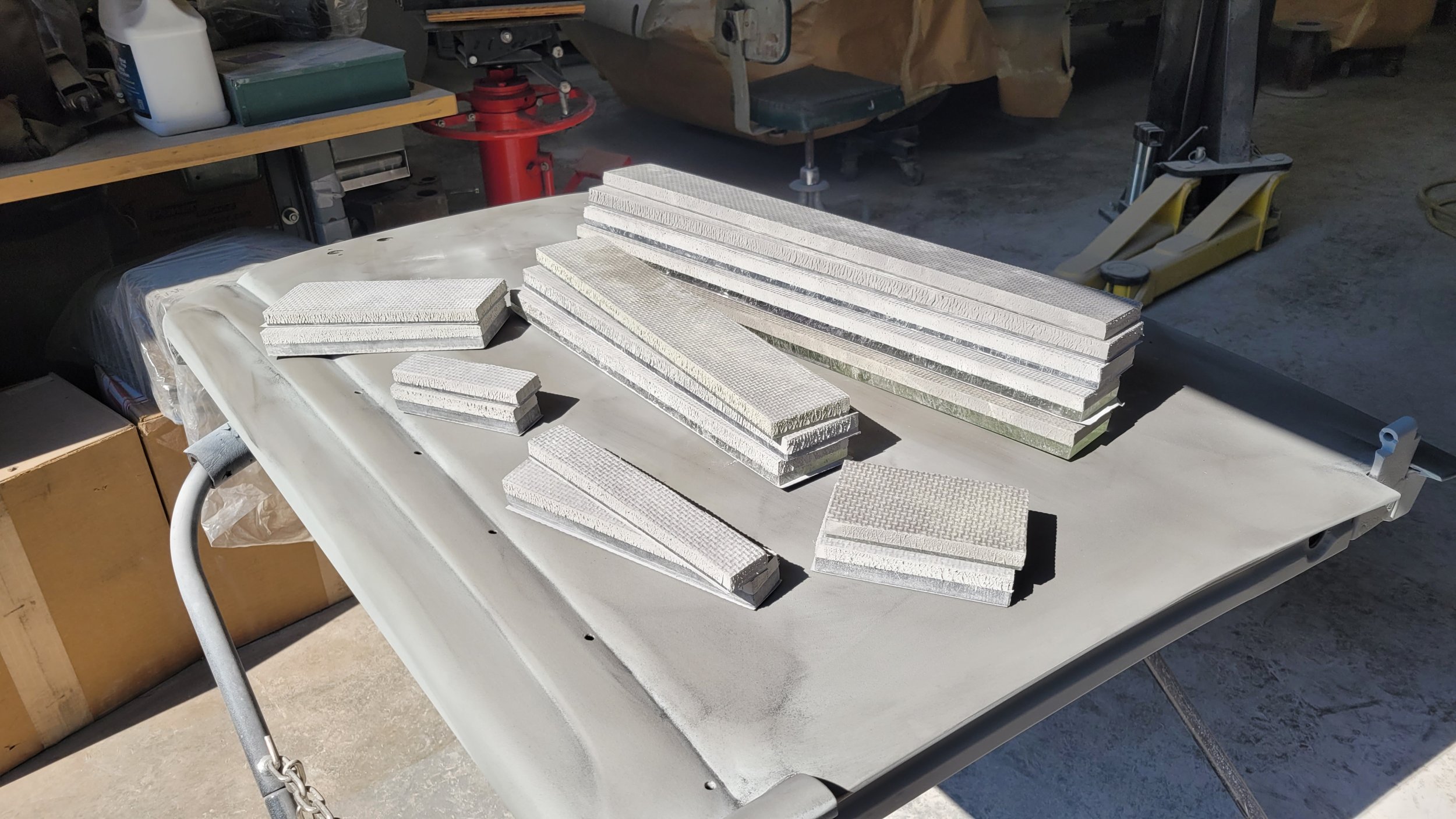

    As I said above, I'm continuing with the block sanding aiming for laser straight. With that said, a small update...per the video I posted earlier showing Darryl Hollenbeck's body preparation process, he mentions the "Next Level" sanding blocks that he likes and uses. I have a pretty good collection of the "DuraBlock" sanding blocks, but decided to try out the "Next Level" blocks. I must say, that I like them a bunch better than the DuraBlocks. They are available with various thickness backing so they are able to conform to the shape of the panel being block sanded. They are also available in various lengths and widths...here's the collections of blocks that I purchased. I will add that in the longest lengths, I've not used the most rigid long block. It would be good on the hood or quarter panels of a 60's era Cadillac, less so on the gentle roundness and curvature of the '38 Ford panels.

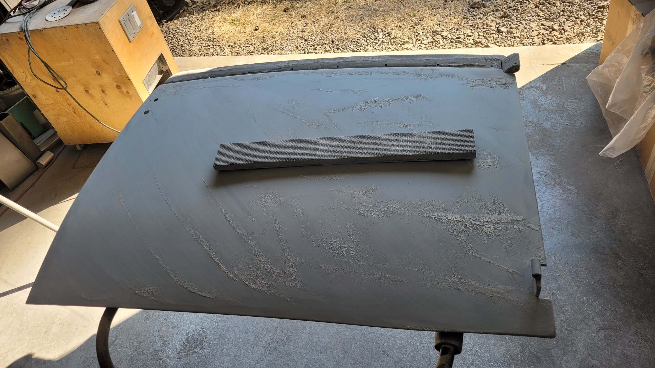

    Here's one of the doors in the dry 3M guide coat with the long board I used for blocking.
    1000015459.jpg And finally, this is what I'm after...I've walking the block across the panel in a crosshatch pattern a couple times...all the guide coat is removed evenly with no burn throughs, high or low spots visible. Feels like money! This is with 150 grit on the board. Once all the panels are at this stage, I'll begin scratch management be blocking with progressively finer grits to remove the sanding scratches from the previous paper (220, 320, 400 and then 500 grit).
    It feels good to reach this stage...panel by panel.

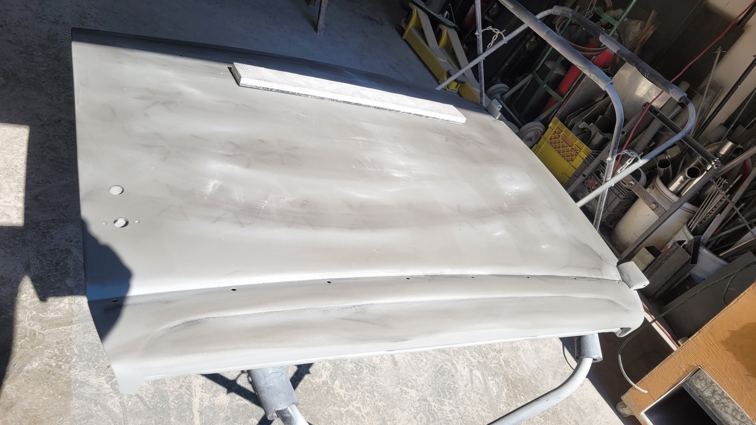

    I'll tell a story on myself...while block sanding on the hood with 220, I had the hood on top of my plywood filter box. This resulted in 2 small raised pressure points (see the "eyes" toward the rear of the hood in the photo below) on the hood that I wasn't paying attention to while sanding...bottom line, the 2 raised pressure points sanded too deep which became noticeable when the hood got moved to the fender stands...DOH!! With the hood properly supported, a quick p*** with spot glaze and re-blocking brought the straightness back to the hood. I know better, but obviously lost myself in the moment.
