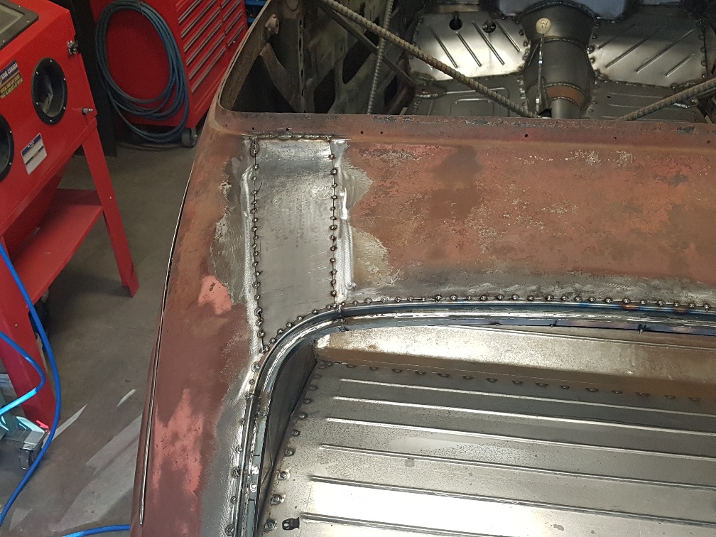

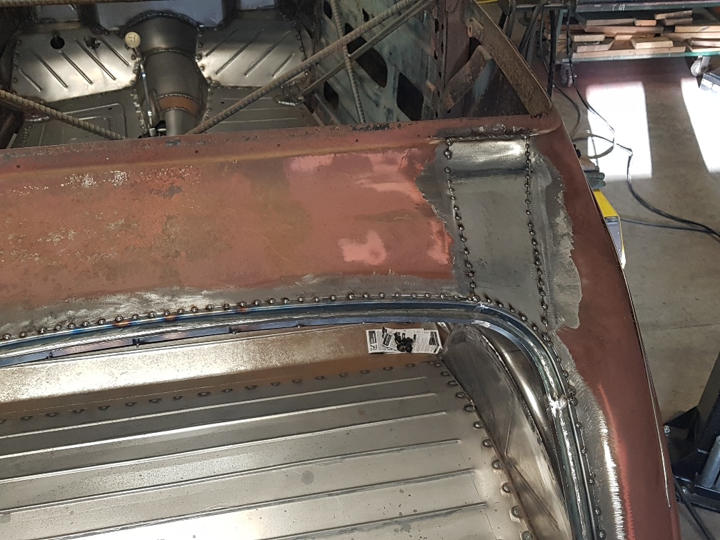

  2. Next up was the sections around the bumper iron recesses...more of the same. I should also add that I have an english wheel that I made (and can provide pictures if interested) using a square tube trailer tongue jack as the mechanism that applies pressure and a very simple "over centre" cam as a quick release to change out the wheels. It too works very well. That said, the other tool I use to help with the hammering is one of those cheapy HF planishing hammers with the 3 different dies and the air hammer that provides the impact and noise. I frankly was shocked at how well that little (and cheap) tool shapes metal....ok on with the show.
    20200403_145846_resized.jpg 20200405_135550_resized.jpg 20200405_153459_resized.jpg 20200412_111104_resized.jpg
    On panels like these, I like tacking with the mig welder, grinding the tack welds flat and then welding solid with the tig welder (I should also add, that this project is my first foray into tig welding...learning new things is part of the fun of this hobby!).

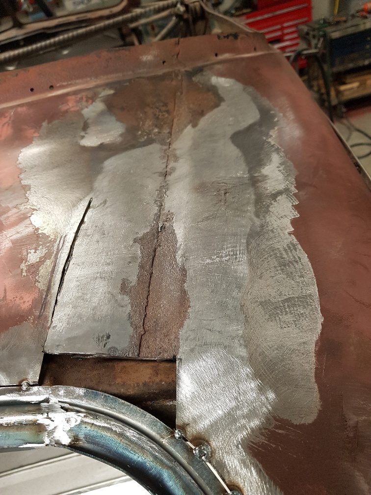

  3. Now that those areas of the tail pan were coming together, it was time to devote some attention to the area in between. The upper 1/2 of the panel was in not too bad condition, though it did have a couple pretty good dents in the center that were filled with lead. I guess nobody tried hammering them out because the trunk latch brace would have been in the way. Now that the brace was no longer there, they were easily hammered out. The bottom 1/2 of the panel however was terminal, so a little time with the tools and the replacement was ready for welding into place. Here I'm overlaying the panel to compare shape...pretty close.
