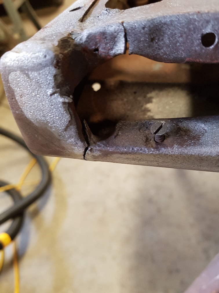

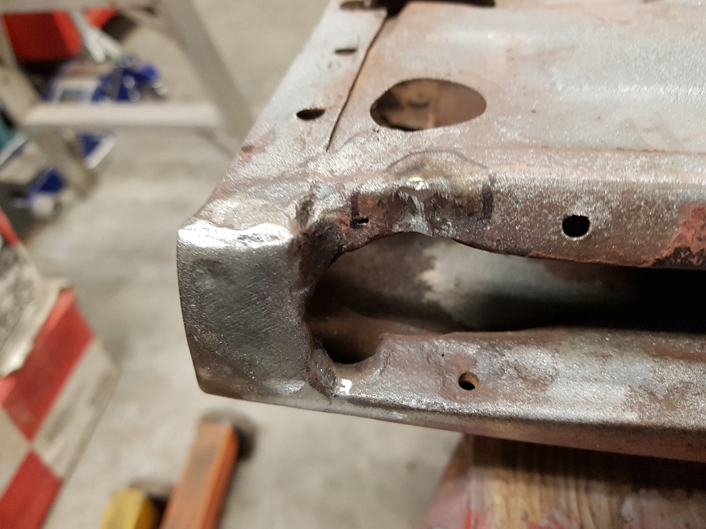

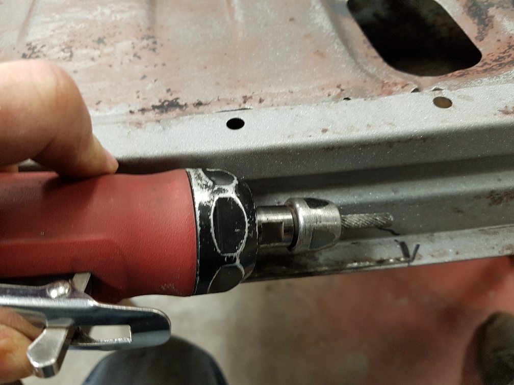

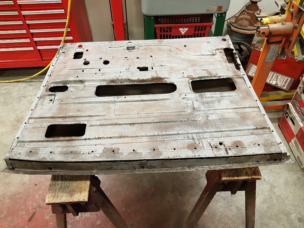

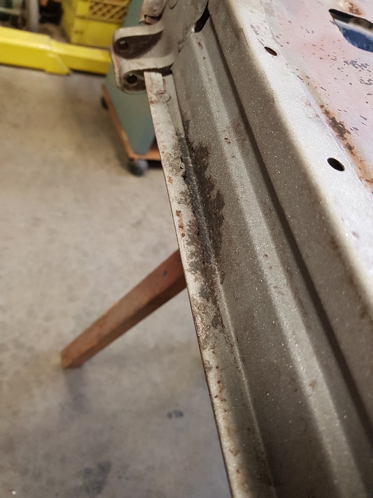

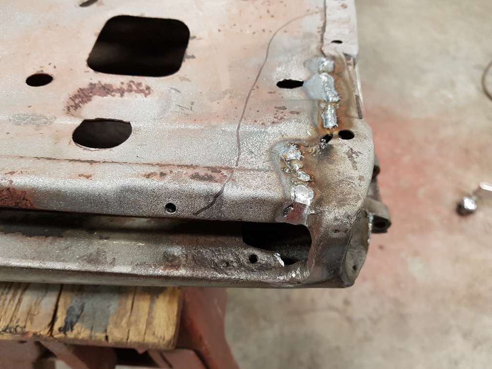

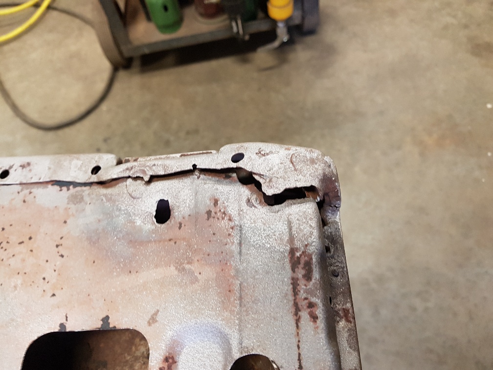

  6. Just a minor update on some of the goings on over the past week and a bit on the '38. I took the 2 corner braces and the trunk latch bracket that were still attached to the original tool tray and carefully cut them free. They spent a little time in the sandblast cabinet, followed by cutting and replacing the rusty bits, hammered on them some until they were the shape needed and then welded them into place. Little projects like this seem to always take way more time than you would ever imagine.

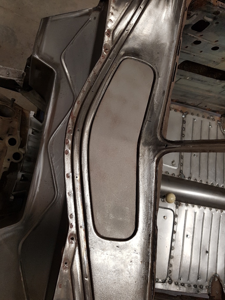

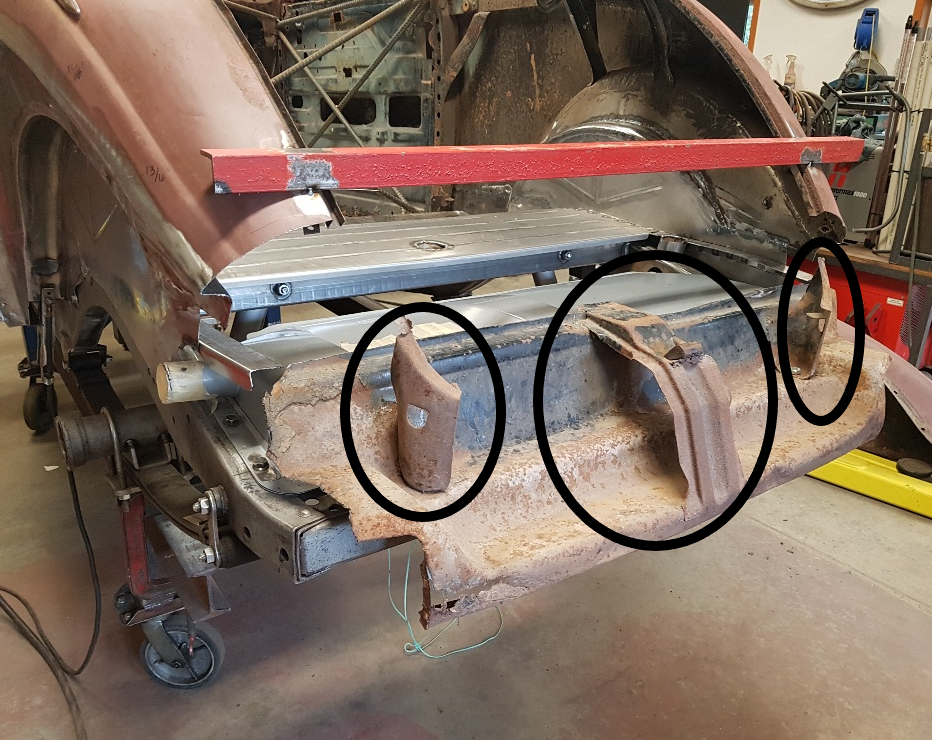

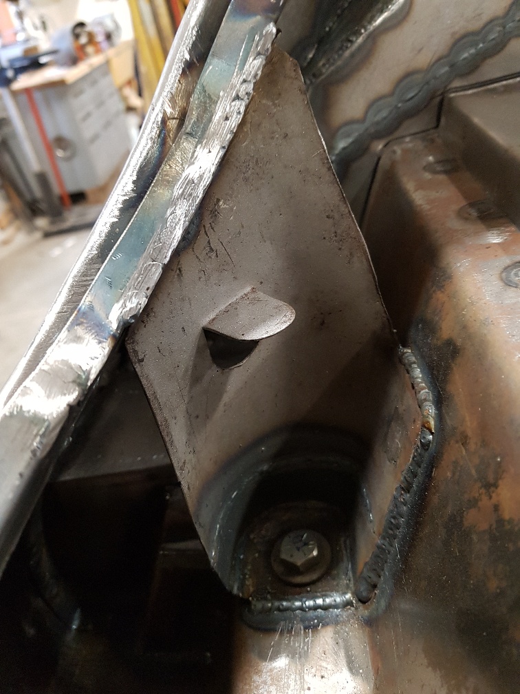

    I then switched my attention to adding a bit more triangulated body bracing between the trunk and p***enger compartment to help provide a bit more rigidity to the back half of the car. While there, I also added a small 1" heavy wall tubing crash bar between the rear wheel wells and the door post on each side. I know they won't help much in a major collision, but they may provide some added protection in a minor accident. Before adding these braces, I temporarily installed the top irons to make sure there was no conflict for the space.
    20201223_151548_resized.jpg I then spend about 3 days bolting down, and shimming the body. I used the 2" round x 1/4" thick disks of conveyor belting as isolators along with S/S fender washers as shims. Once firmly bolted down, I cut free all teh interior bracing. Once all bracing was out, I spent another 1/2 day adjusting the shims further for the driver's door fit. No pictures, but the progress felt real good!

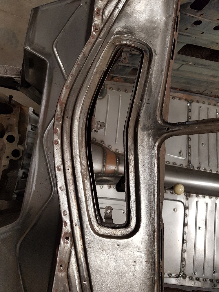

    I had also mentioned in an earlier post that I needed to get a few more pictures of the repairs to the cowl vent. Here's a couple more pictures of the metal work in that area. Also note that I cut out the holes for the windshield wiper towers. I plan on using a Specialty Windows kit for the wipers and towers.

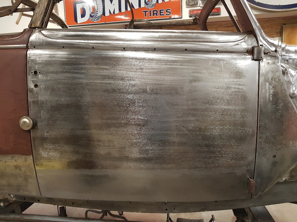

    Thought I might give a bit of an update. I've spent the last week working on the p***enger door as it had the least damage of the two doors. First order of business was to strip it to ***ess the actual condition. Using the HF sandblaster, I blasted around the edges and the inner panel. The old primer was removed from the outer skin. I'll add that the old primer sands like a combination of concrete and bubble gum. I used a 3M strip-it disc, 80 grit DA, a belt sander (yes I said belt sander) with a 40 grit belt, and a disc sander with worn 36 grit disc. I finally got it down to clean metal and found some deep rust pitting, a few perforations, some rust swelling at the flanges, a number of stress cracks and broken welds and more than a few dents with stretched sheet metal including some major binding of the door skin at the lower hinge. 20201224_142708_resized.jpg 20201224_142750_resized.jpg 20201224_142818_resized.jpg 20201224_142851_resized.jpg 20201224_142900_resized.jpg 20201224_142912_resized.jpg .
    My first priority was to restore the strength/integrity to the door by welding up all the cracks using the mig welder.

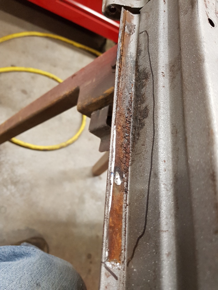

    I next went at the swollen flange under the upper hinge. I ran a zip wheel down the inside edge of the folded door skin flange and then used a carbide burr to cut the perpendicular cut line (see photo below) as it's awkward to cut in the area. After removing the folded flange and cleaning up and treating the metal underneath (Phosphoric acid/Rust Mort Rust Convertor), I laid in a new piece, welded it up and ground it smooth.

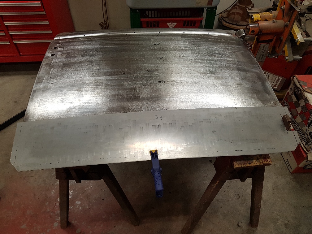

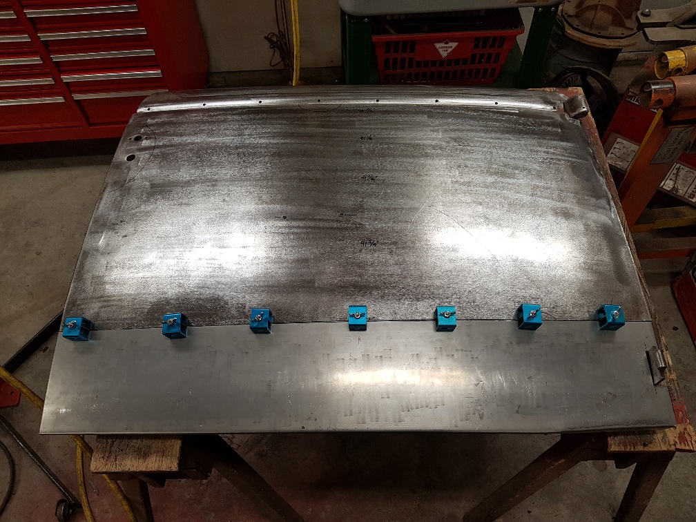

  14. The bottom 6" of the door skin and the bottom part of the inner frame were terminal. But, before I cut them off, I welded in a piece of 1"x2"x .125" wall tubing just below where the window will roll down to. This serves to maintain the door frame shape while I cut it apart and will remain in place inside the door as a side impact bar should the car get T-boned in the door area. I'm very aware how little steel there is between me and the surrounding traffic while driving my 1928 A-V8 roadster. I want this car to provide more peace of mind.
    I then used the door skin and door bottom as patterns for making their replacements before I cut the lower 6-7" of the door skin and door bottom free. I rolled the replacement door skin on the English wheel and the door bottom was folded on the brake followed by a few minutes with the shrinker.
    20201231_092751_resized.jpg 20201231_134125_resized.jpg I then folded the replacement door skin edges to 90 degrees in the brake prior to clamping it in place on the door. Once I was happy with the fit, I tacked the new skin in place using the mig welder (I find it easier than tacking with the tig) and then ground the tacks flat.
    20201231_140047_resized.jpg 20201231_140056_resized.jpg 20201231_143706_resized.jpg

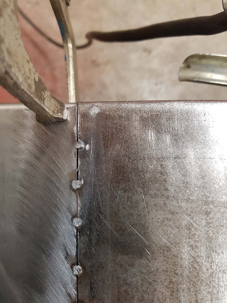

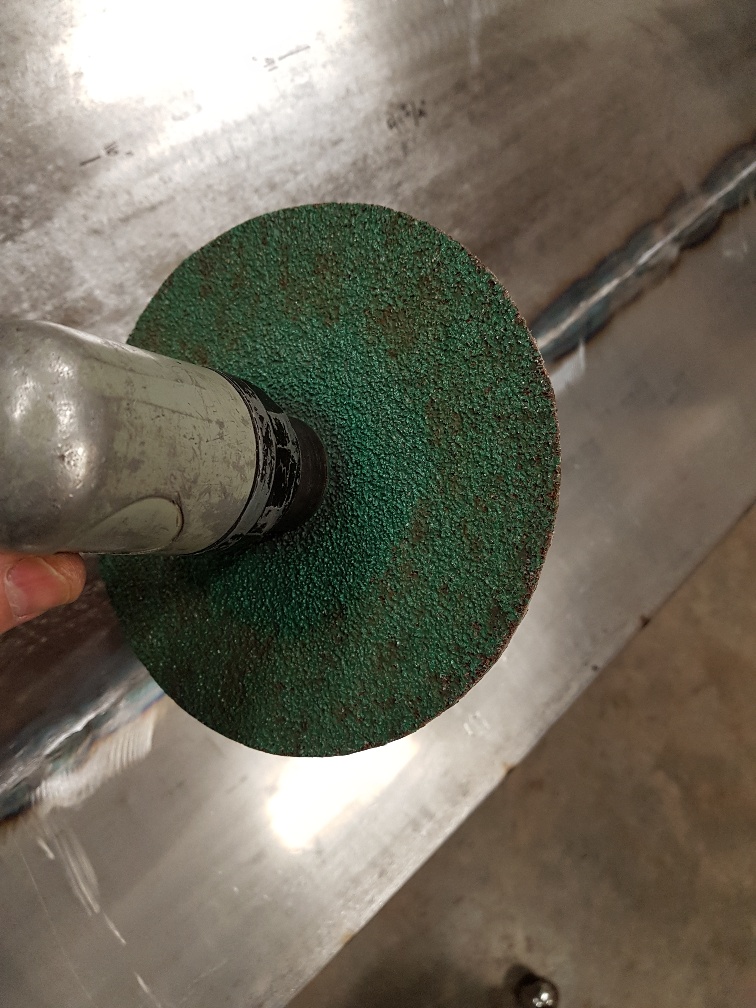

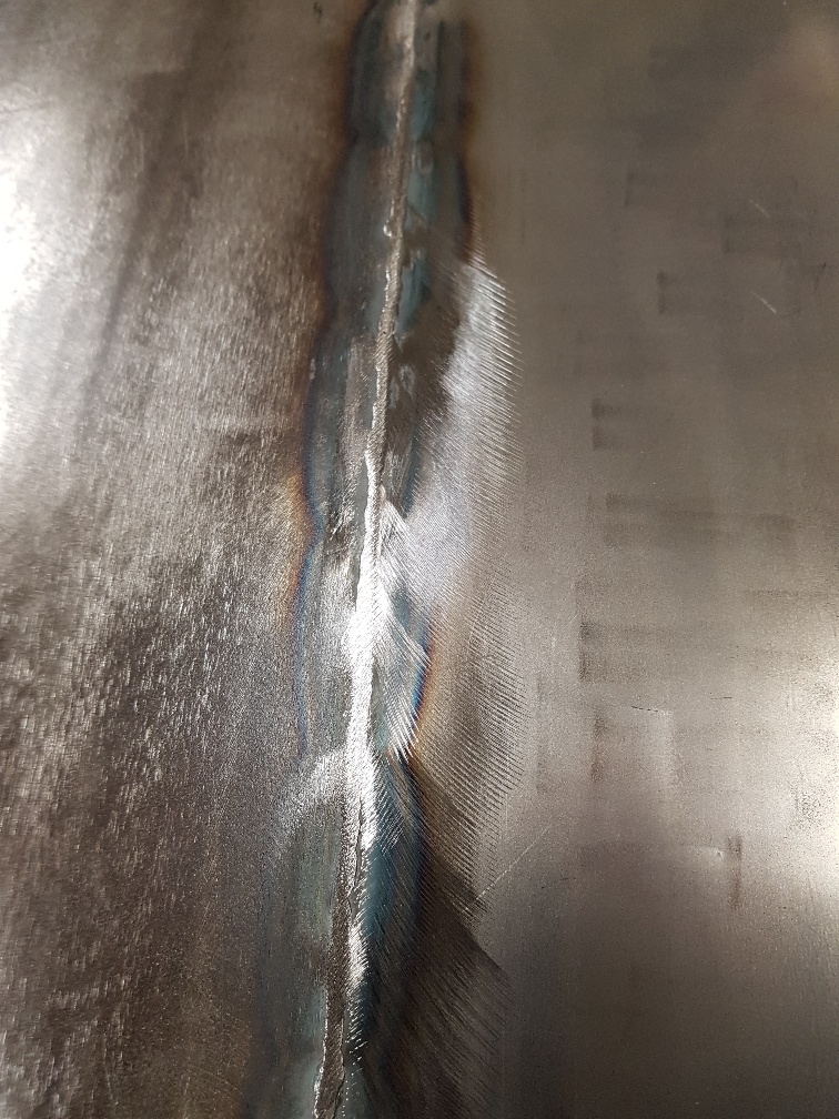

    I'm going to go into a bit of detail as to how I welded on the door skin because I hope it might prove helpful for someone going forward. I will add the following caveat, the tig welding approach is new to me (this is the first car that I've done/am doing with tig), so if you see something that I'm doing that could be improved upon, I'm open to suggestions. And, my tig welds are far from perfect. That said, this approach does seem to be working for me so thought I would share it. The mig tack welds are about every inch starting in the middle and working my way out to each side. I then ran the tig from one side to the other (from left to right in my case because I'm left handed). I run about 2" of weld, stop for about a minute or two, then carry on welding the next 2" until I cross the entire panel. The exception to this is the outermost 2" on each side of the replacement door skin where I welded with the mig welder. I mig welded the edges because I don't have access to the back side in those areas.
    Now, after the new panel is fully welded, there is some warpage (some might even consider it to be a significant amount of warpage!). I want to tell a story on myself...when I began welding on hotrods with an oxy-acetylene torch 35 years ago, I got similar warpage (maybe even more so) and ruined quite a number of panels trying to shrink those warps out, or worse, covered a lot of bruising with significant coats of mud. I now have a better understanding of the process and will share. If you know all about this, you can nod knowingly, but I'm hoping this might prove helpful for someone like myself 35-40 years ago ;). Consider, this panel has a fair amount of convex shape, but after the welding I had a number of areas where the shape turned concave.
    20210101_113133_resized.jpg 20210101_113153_resized.jpg The key is to know, that the panel was the correct shape before the welding...and the only place the panel could have changed is clearly shown by bluish coloring along side the weld called the heat affected zone (HAZ). The first thing I do is to knock down the raised area of the weld trying as much as possible to not touch the adjacent metal on each side of the weld to preserve its thickness. Note, the HAZ coloration has not even been removed.
    I use a couple different style grinders for this. I use a small 2" Roloc style disc (with a sharp disc 24-36 grit) as well as a 7 1/2" flexible 36 grit disc without a backing pad. I put 2 discs back to back so I can use both sides of the grinder depending on what, how and where I'm grinding (be careful of your knuckles). The other thing that I do with the back to back disc grinder set-up is once the discs begin losing their sharpness, I use a dedicated pair of aviation snips to cut the outer 1/4" of the disc off all the way around (so the disc is now 1/2" smaller in diameter). It then cuts like a new disc again. I do this until the discs are down to about 2-3" in diameter. I then throw them out and restart with a couple new 7 1'/2" discs again.
    Enough about the grinders :rolleyes:, once the weld is ground, I use a hammer on dolly technique over the entire length of the weld to planish out the shrinkage caused by the welding process. All of the hammer on dolly work is contained within the HAZ. I really like using Martin body hammers and dollies as they have a very nice balance and heft to them. And my favorite dolly for this process is the Martin 1064 Egg shape. The shape is pretty much perfect for cars of the era that we are working on. Enough with the Martin sales pitch (I have no affiliation).
    Stretching the weld over the length removed all the concave shape and allowed the panel to fully relax back into the proper convex shape. I then used a Martin Door Skin hammer (model 170FG, I can get a picture of it if anyone wants) and a Martin Toe dolly to fold over the door skin at the edges. Next, I spent time hammer off dolly to work out the remaining high and low spots before going over the weld area with an 80 grit disc on a DA sander. Once done, I painted the inside of the door with Rustoleum primer, stuck some Dynamat on the inside door skin while I had good access, and then re-welded the inner panel in place.
    And lastly, re-hung the door. Next project will be the drivers door...it's in worse shape.
