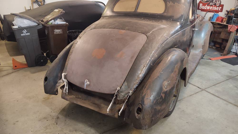

    Got a quick question for ya. Would you mind snapping a shot of the decklid hinge braces and how the hinges mount under the body on your car? You're the only guy I've found that has any pics of the underside of that part of the body. I'm trying to piece my 38 back together after it got "pickuptized" back in the day. I'm gonna have to replicate or reproduce something for my decklid to mount to, and I want to be as close to original as I can.
    Thanks! IMG_20210117_170442908.jpeg IMG_20210117_204538806.jpeg IMG_20210117_204544374.jpeg
    Sent from my moto z4 using The H.A.M.B. mobile app
  3. I'll get some photos for you tomorrow.

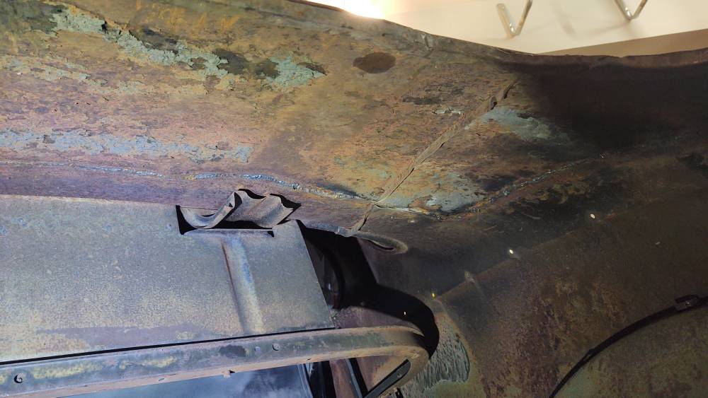

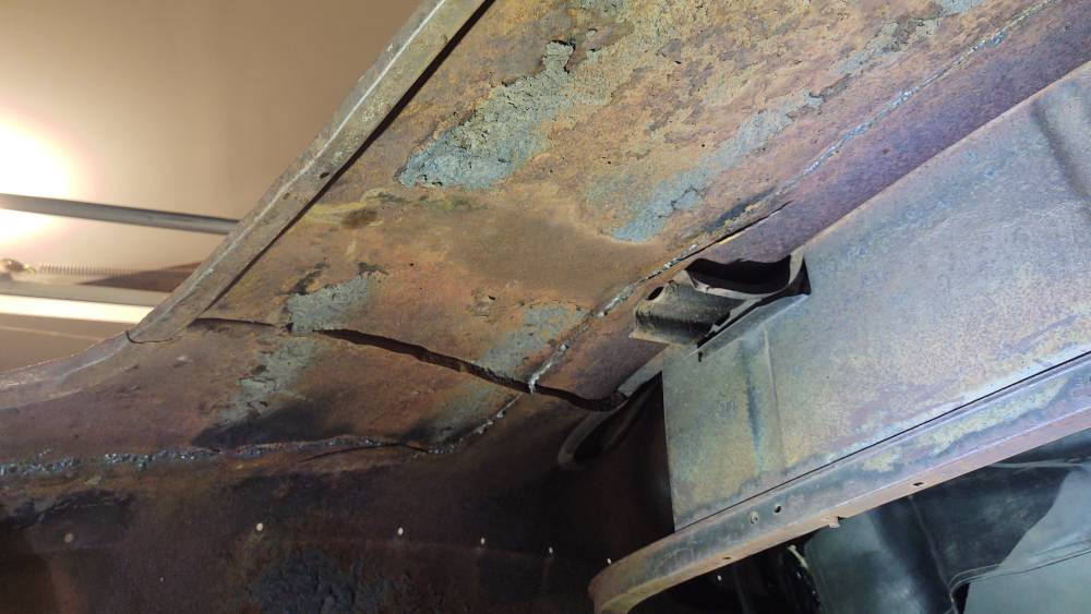

  7. I think I'm ready for the next update as I'm almost done with the driver side door. It was ugly...if decent cabriolet doors grew on trees, I'd have fetched a ladder! Given they don't, my option was to dive in on the repair. Here's a bunch of before pictures of what I was up against when most of the primer was removed. The bottom 6-8 inches had previously been patched and repaired a couple times. The original repair consisted of about 1/2" thick lead. On top of that, there was a steel patch that had been rivetted on and on top of that was another 1/4" plus of body filler.
    There was plenty of rust through.
    The lower hinge mount was really bad!!
    And the top front corner, was toasty!
    First order of business was again to weld up all the hidden and not so hidden cracks (no pictures, but if you need to see what it was like, you can hold the pictures of the p***enger side door up to a mirror). I then decided to tackle the upper front corner as it seemed simple enough. I cut and hammered on some steel until it closely resembled what I thought it should look like. The masking tape with numbers are reference measurements from the leading edge of the patch panel.
