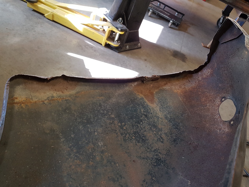

  8. In my mind, the next update was going to be the driver's side rear fender as I was pretty much done the passenger fender. But, as I was hammering out the last few dings and dents, I noticed a couple thin spots in the lower front area, then as I looked closer I noticed a small tear, some deep pitting and a little too much rust at the running board flange.

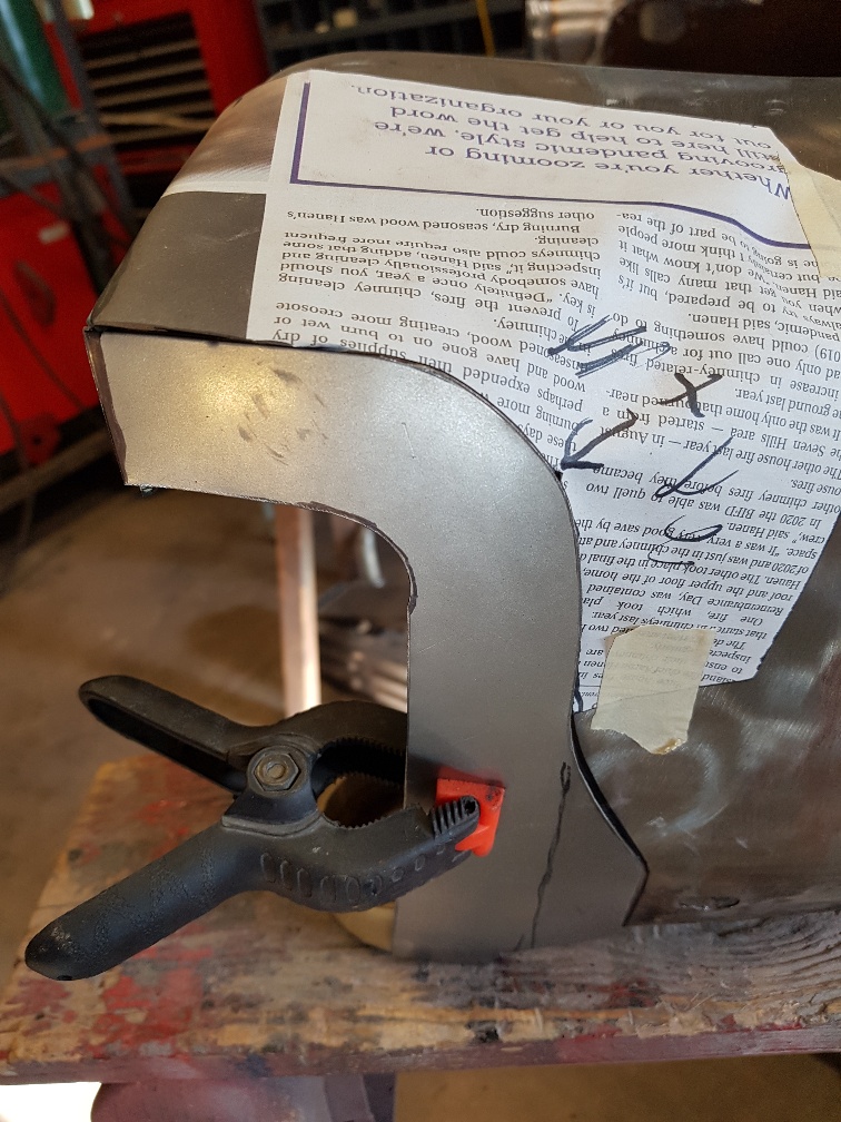

    So, I made a new running board flange and began laying out a paper pattern for a replacement panel.
    The panel seemed pretty straight forward so I thought I would try it as a single piece (in addition to the running board flange). A few minutes on the brake gave me the lower flange and few minutes bending the tin over my knee and leg gave me a pretty good start on the upper bend where the side of the panel wraps around to the front of part of the fender.
    I then spent some time on the shot bag and the HF power hammer trying to sink in the concave shape necessary to match the fender. I argued and beat the panel trying to get it to submit but realized that I was getting further from my target and it was simply not going to give in easily.
    So, out came the tin snips, and one difficult panel became 2 much easier panels with a small weld in the middle.

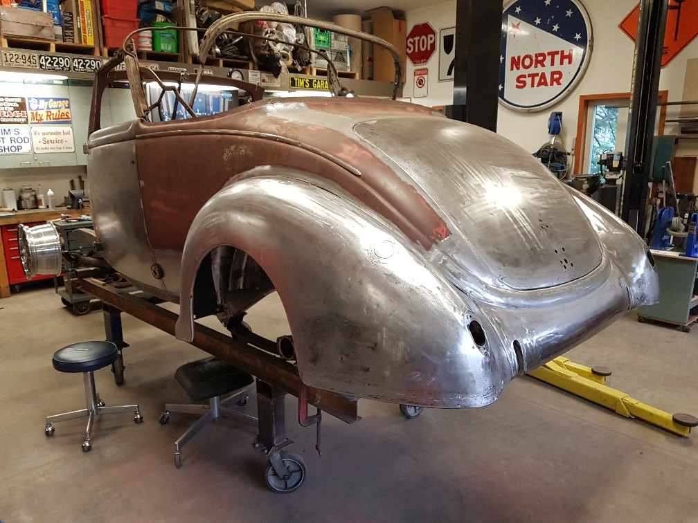

    And lastly the finished repair after welding, grinding hammering etc. 20210204_155042_resized.jpg

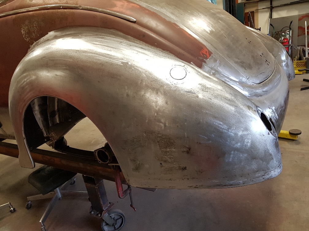

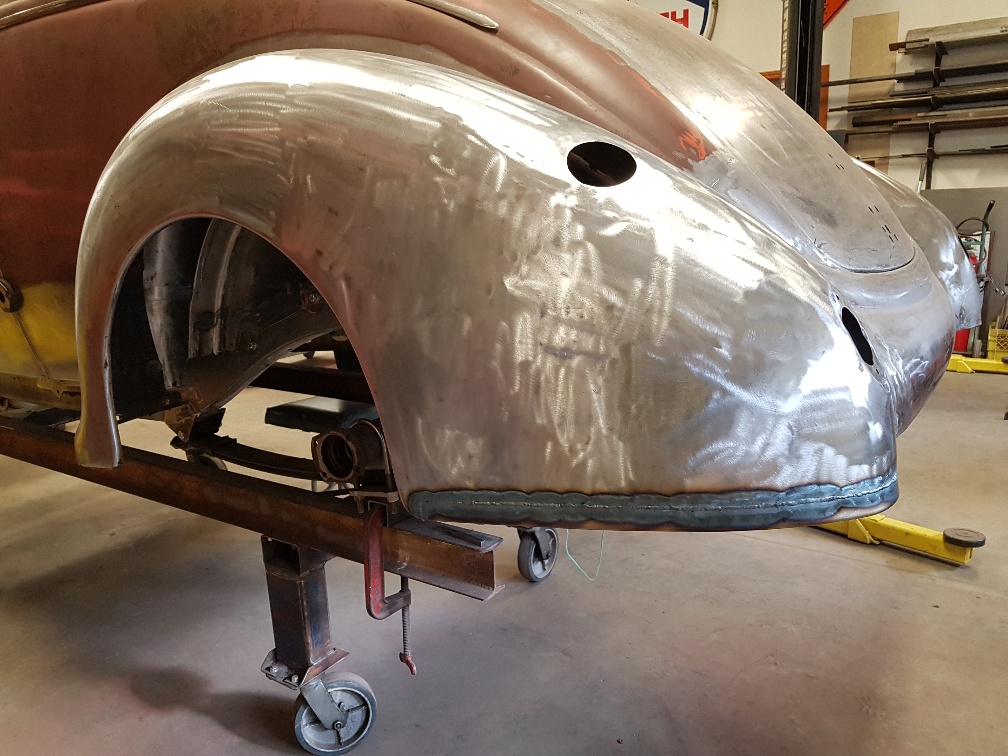

    That said, it might be a good time to provide a weekly update on the happenings in the shop and on the project. This week was dedicated to the drivers side rear fender. As I stripped the old primer, I became concerned as there was a 1/4" layer of filler across the entire fender. This was not expected as the fender appeared in pretty good shape based on the underside. There was however the expected minor damage on the lower lip that was readily obvious. Once the fender was stripped of primer and all the filler, it was actually in pretty good condition so I'm not entirely sure why it was covered in filler. Here's a picture showing the inside of the fender.
    Like I had done on the passenger fender, I replicated the lower lip/inch of the rear portion of the fender and welded it on. 20210211_122601_resized.jpg
    I then closed in the gas filler hole and installed one of those smooth pop up motorcycle type fuel caps. I know it's a bit street roddy, but forgive me because I like them anyway. Once that was installed, I metal worked all of the welded areas as well as the dings and dents on the fender. I also had to run the shrinking disk over the "cheek" of the fender to remove some of the stretched metal in the area before I called it done. 20210212_141551_resized.jpg 20210212_141604_resized.jpg

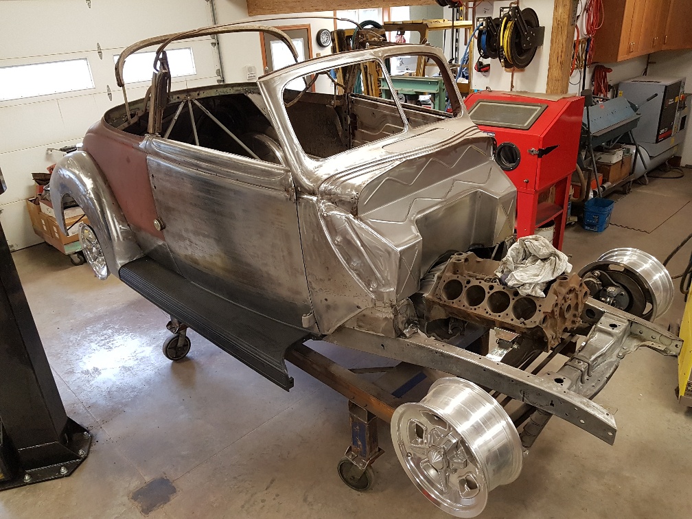

    I closed off the week by opening up the box containing the Bob Drake reproduction running boards for a trial fit. The box contains those three words that can bring concern to most of us. Specifically, "made in China". But, I must admit that they look good and fit pretty well. A few holes needed the rotary file to bring them into alignment, but generally I'm very pleased with them.

  17. I'm glad you posted the last pic because it solves a mystery for me. I see the feet at the bottom of the firewall, which my body does not have. But the frame has the holes. I have been wondering what the holes were for. Your pic is the answer.:)

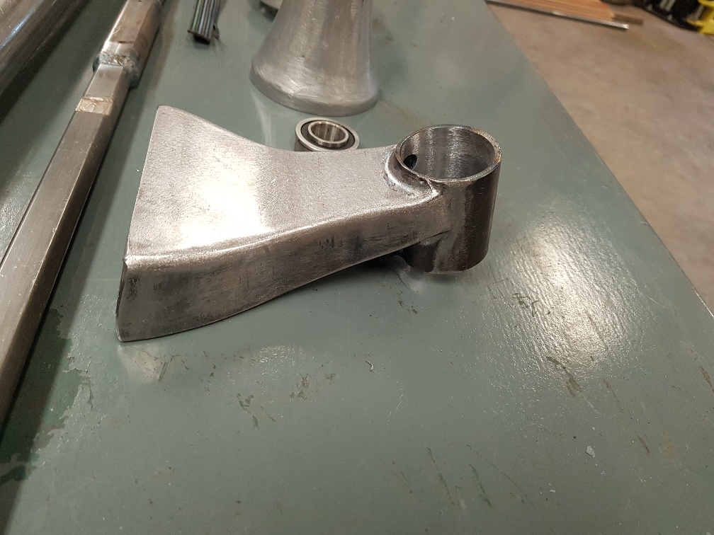

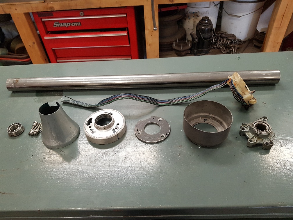

    It might be time for an update. Before I move to the front clip sheet metal, I thought I would spend some time connecting the steering wheel to the steering box. Sounded easy enough, except I wanted the delicate sized column of the original, self cancelling turn signals and to fit the aftermarket banjo style wheel I picked up a number of years ago. So, I rummaged through my collection of junk and treasure to see what might work. I had most of a real ugly 1967 Impala floor shift steering column that was too thick and clunky looking between the steering wheel and dashboard area and too thick and ugly down the length of the column with its collapsible mesh area. The nice thing about the column is that it did not have an ignition key, nor a shifter.
    20210227_120023_resized.jpg I also had an incomplete '65 Corvair column which had a nicely tapered transition from the narrow part of the column to thicker part at the steering wheel. It wasn't quite fat enough at the steering wheel end to match my aftermarket modern style banjo wheel or the Impala fat end. As well, I didn't have the turn signal switch, shaft or any other components. So I decided to use only the tapered transition part of that column. In the picture below, this was originally all one piece (I didn't take a picture of it before I cut it). In order to make it as compact as possible, I cut it down to the height of the attachment screw bosses in the coned section.

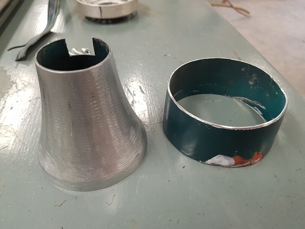

  30. I accidently hit post rather than upload a file (DOH!)...so the post above is incomplete...carrying on...is a picture showing where I cut the Corvair tapered cone to reduce its overall length but retain the screw hole mounts.
    20210227_113016_resized.jpg 20210227_113035_resized.jpg So, from the Impala column I used the upper most section that housed the turn signal switch, the turn signal switch, the upper bearing and bearing retainer and the shaft. I then had to turn an adapter ring to transition from the Impala upper section to the smaller diameter cut down Corvair tapered section. I rummaged through my miscellaneous junk aluminum pieces and found a suitable chunk I could turn on the lathe (I believe it may have been an old piece from a drum sander/pulley). I also then needed to turn a steel disc that would be welded to the column mast and be used to hold the lower sections (Corvair and aluminum adapter) and the upper section (Impala section, bearing and retainer and turn signal switch together). For the steering column mast, I thought about using the original '38 outer mast, but it was a bit too banged up, so instead I used a piece of 1 1/2" x .065" wall welded steel tubing. For the lower shaft bearing, I used a wheel barrow axle bearing (https://www.amazon.ca/gp/product/B002Y289VO/?tag=atomicindus04-20)

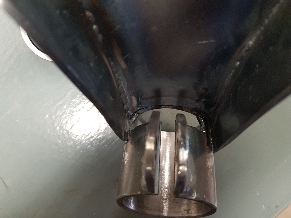

    In order to hide the turn signal wiring, I strategically cut slots into the steering column mast so the wires could be routed into the mast within/behind the Corvair tapered cone section and come out behind the home made steering column drop. So that the wires don't interfere or get rubbed by the steering shaft, I made and installed a "wire trough" within the column and welded it in place. It's a bit difficult to see, but I hope these pictures help to show what I mean. I also welded the steel adapter ring to the outer mast at the height necessary to connect all the pieces. 20210302_145040_resized.jpg
    I cut a slot behind the steering column drop for the wires and also cut a slot and welded tabs to the backside in order to pinch/hold the column tight.
