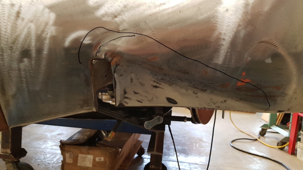

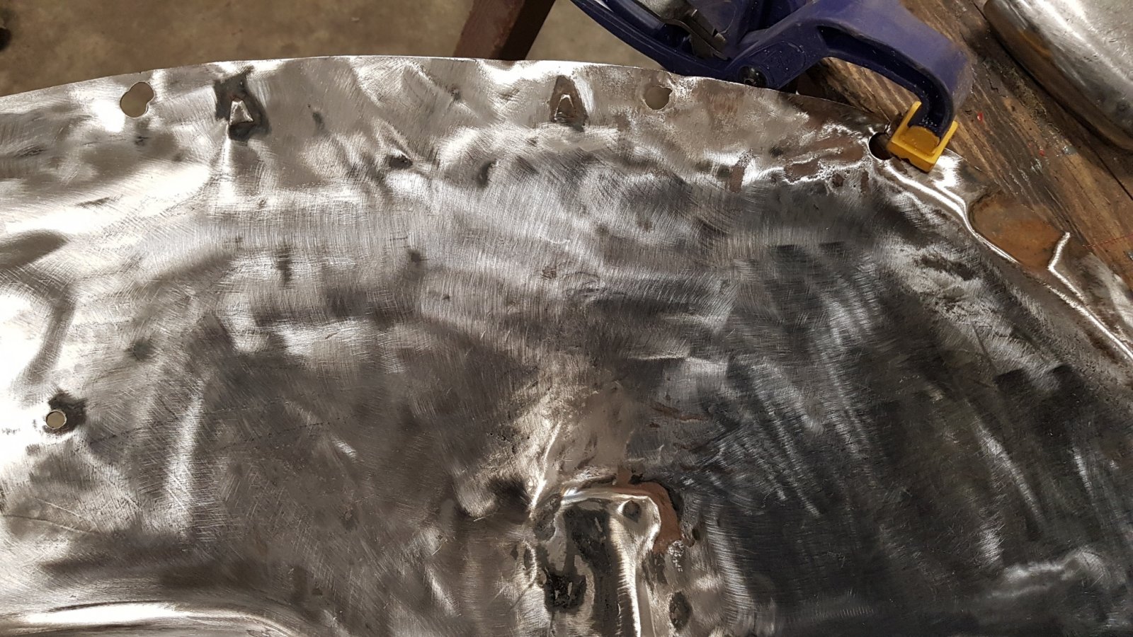

    After working this morning replacing and repairing the broken snow blade on my ATV (after yesterday's snowfall!), I spent the afternoon back on the '38. Specifically on the hammered up driver side inner wheel well panel. Here are the first 2 areas I decided to concentrate my efforts towards. I know about repairing accident damage in the reverse order of impact (last damage in is the first to come out). The problem is that the damage is not exclusively the accident damage, the damage made by the previous body man must also be reversed. I decided to try a "middle out" type approach.

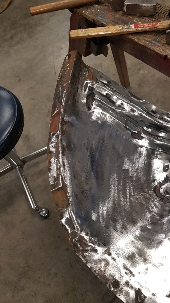

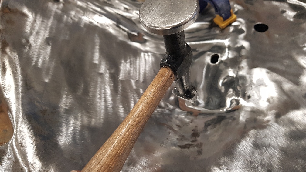

    The first order of business would be some time on the HF planishing hammer. It reminded me of removing the "walnuts" after stretching sheet metal on the shot bag. The little planishing hammer does a pretty good job of that task. .
    In fairly short order (15 or so minutes), it did a pretty good job of smoothing out that area of the panel.
    20211207_141957_resized.jpg Next a few minutes with body hammers and dollies worked out a few of the remaining "worst" spots.
    20211207_142325_resized.jpg For now, this area was close enough to move on to the next area.

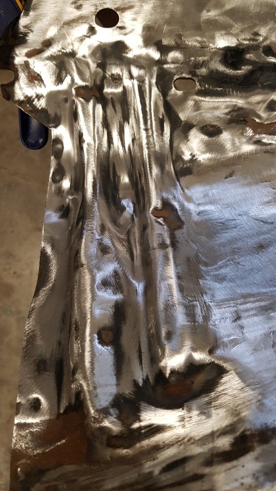

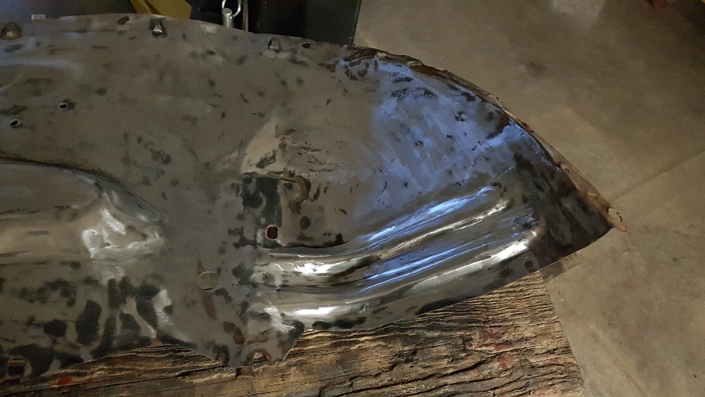

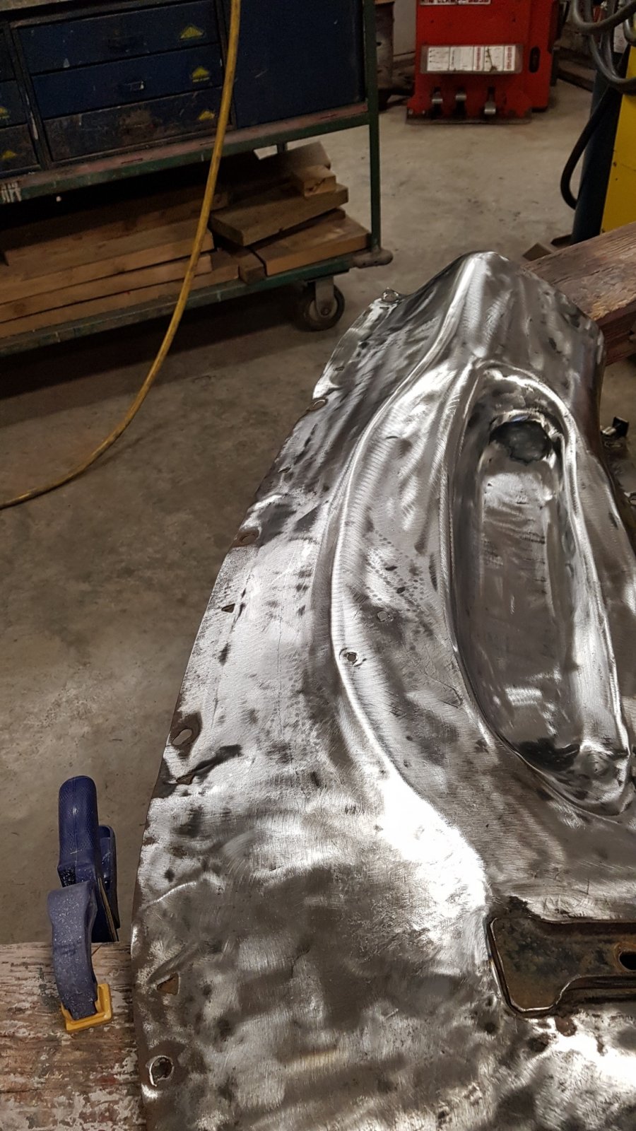

    The 2 ribs that run front to back about 2-5" up from the bottom of the panel were pretty badly banged up. It took some patience with the hammers and dollies to knock them close to their intended shape and resting place. I still need to work on the leading edge of the lower rib, but for now, it seemed like a good stopping point.

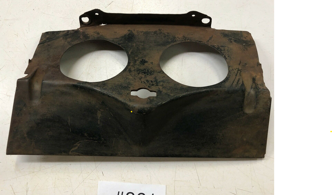

    You made a lot of progress on that panel for one day! You asked if anyone had an inner fender the other day. I don't , but I think I have one of these out in the shed. This one is on Ebay for around $ 30.00 right now. Mine would be free to you but You would on the hook for the shipping . I think mine is in a little better shape than this one.
    Sam
  3. That's very generous Sam. Thank you for the offer! I think my version of that panel is also in pretty good shape. I'll verify tomorrow.
    Jim Bouchard and loudbang like this.
  4. @The 39 guy , I checked the version of that panel that I have and my memory was correct. I do have one and it's in good shape. Thanks again for your generous offer.

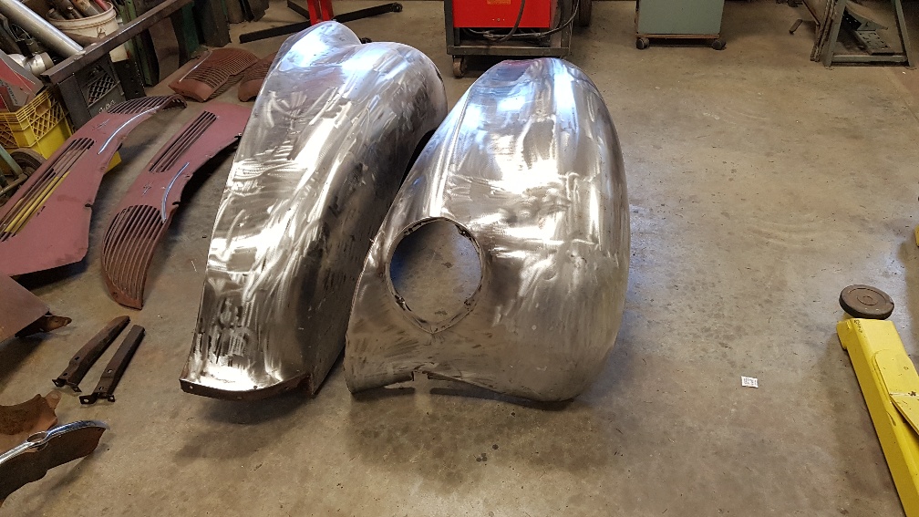

    My plan for the day was to continue straightening out the driver side inner wheel well panel. That is until the sun made a showing and the temperature in front of the shop felt like it was in the mid 60's (F). It was a better day to get something done outside the shop. So, out came the saw horses, the strip it disc on the disposable HF grinder and I made dust (outside dust! the best kind, way better than in the shop dust! I've made both.) stripping the front fenders. Once down to bare metal, I could see there are areas the need attention, but they are in better shape than I thought they might be. Especially after seeing the condition of that drivers inner fender panel...perhaps the driver side fender had been replaced following the fender bender? I've said it before, the primer (looked to be at least 3 colors and in varying thicknesses), is a tough, slow strip.
    For those out there asking why I don't just have the car/parts sandblasted or dipped, the price I was quoted to have the parts dipped (which was my first choice/plan) was north of $20k and was told it would take between 8-12 weeks...couldn't justify it (either time or money!)! And as for the sandblasting, I've had really nice panels come back warped like tortilla chips by people/companies that were supposed to know what they were doing...not to mention the logistics of living on an island, ferries, open car trailer, weather in the Pacific North West etc. Bottom line, a couple hundred bucks in strip discs, some carefully chosen the****utic time with the body parts yields acceptable results. Ok, I'll shut up now and here's a couple pictures of today's project.

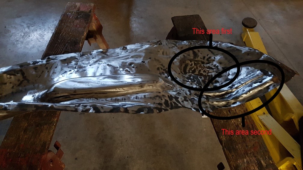

  7. There hasn't been a lot of progress in the shop over the past few weeks. I've been dealing with a shoulder issue that's simply rendered me pretty much useless. The remedy (cortisone shot) should happen early in the new year.

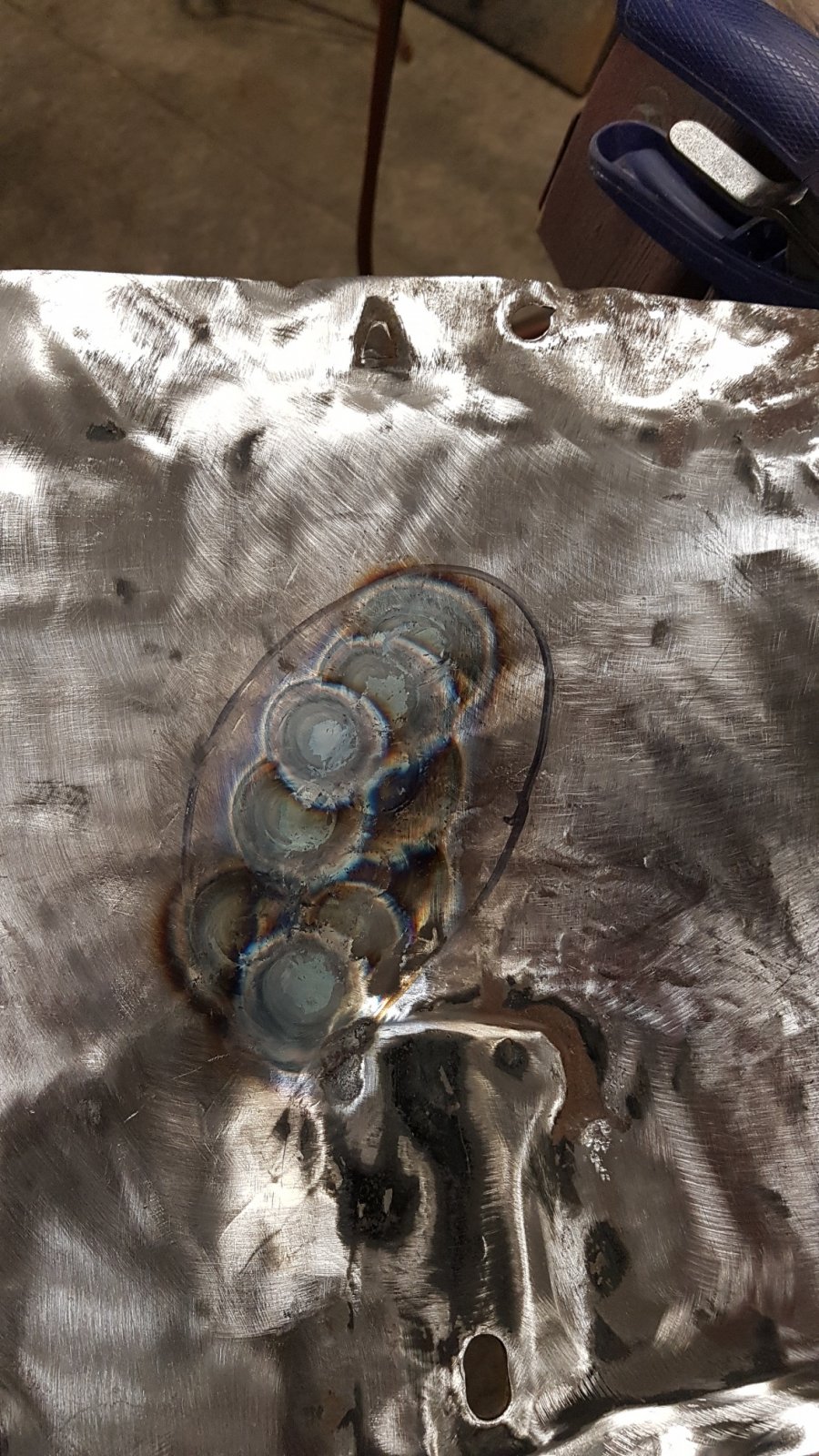

    I did make a very small amount of further progress on the driver side front inner fender panel. Specifically, after hammering out most of the damage in front of the brace, I ended up with an area of "raised pucker" from the stretched sheet metal behind/above the brace (circled area). I used the oxy/acetylene torch to shrink the pucker out. 20211212_104110_resized.jpg
    20211212_111323_resized.jpg After the first p***, there was still a slight pucker remaining, so one more round of heat shrinking with the torch and it came out. (Sorry about the second picture being upside down...I've tried a few times to correct it, but apparently it's beyond my limited tech ability).
    I then re-introduced a curved/flowing character line that ran from the brace to the rear vent outlet area. I didn't take a picture of the process because my hands were busy...but I used the English wheel with the flat die. I rolled it through with only slight pressure on the wheels, but applied downward pressure on one side of the panel as it rolled through to introduce the character line. The character line is visible in the following picture...and may need to be "softened" a bit with a hammer and dolly.

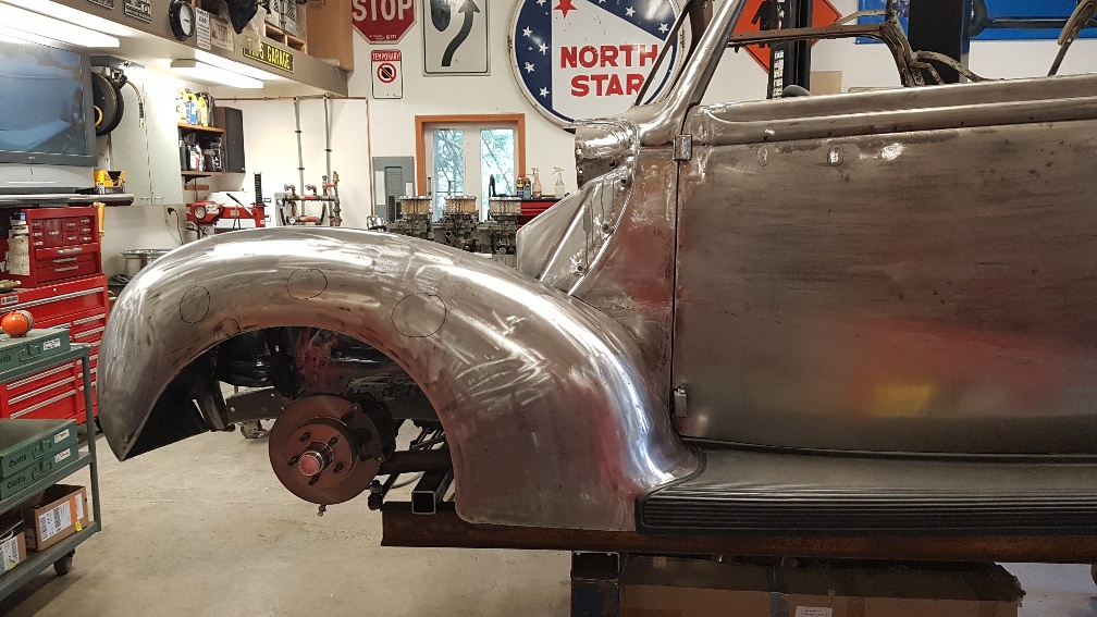

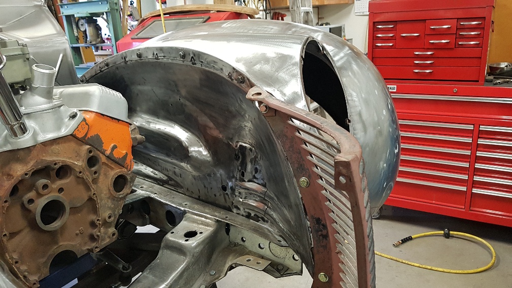

    After beating on that mangled mess of a driver's side inner fender panel, it was time to marry the panel to the fender and grille to see if they all still fit together.
    20220313_115243_resized.jpg The fit wasn't too bad, but it wasn't great either. I had to make a slice in the two lower reinforcing beads of the inner panel to allow it to relax (see circle) and open up to meet the fender and grille. I won't weld up the cuts until I get all of the front sheet metal together in case there is a need for further "adjustment".
    1938 Driver inner fender.png I then took this ***embly and began mounting it to the car to see if we were still on the same page. The fit with the aftermarket running boards was better than I expected. They will still require a bit of work. But again, I don't want to make any cut and weld type adjustments until the rest of the sheet metal is attached to the car.
    20220316_151406_resized.jpg 20220316_151425_resized.jpg 20220316_151433_resized.jpg

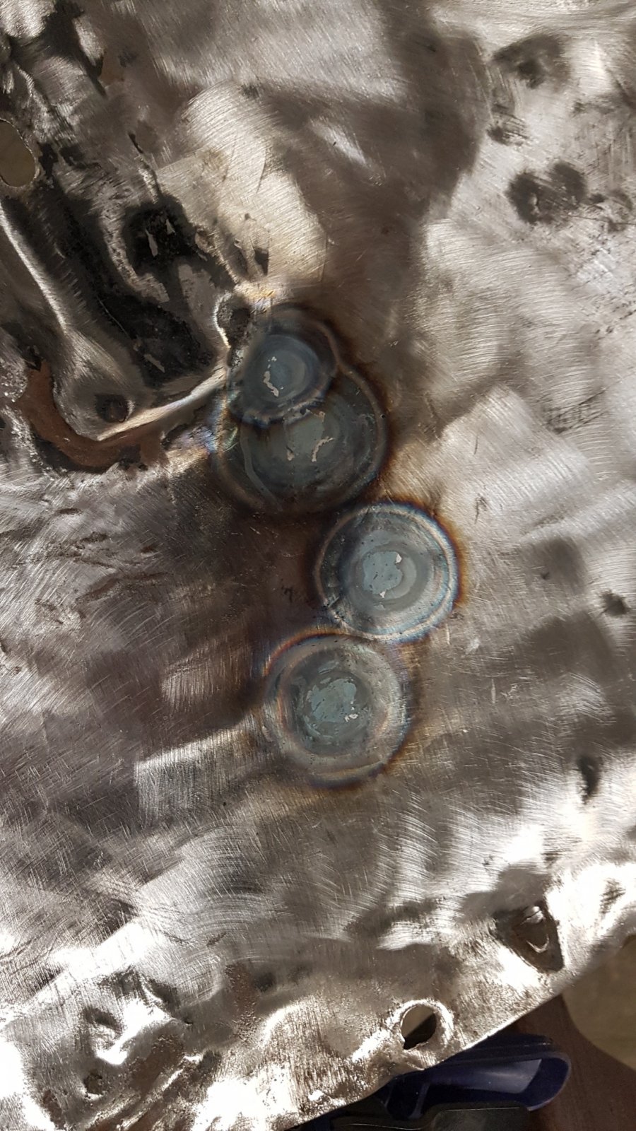

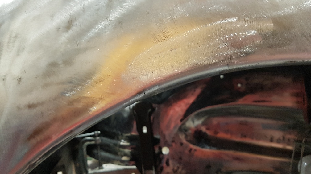

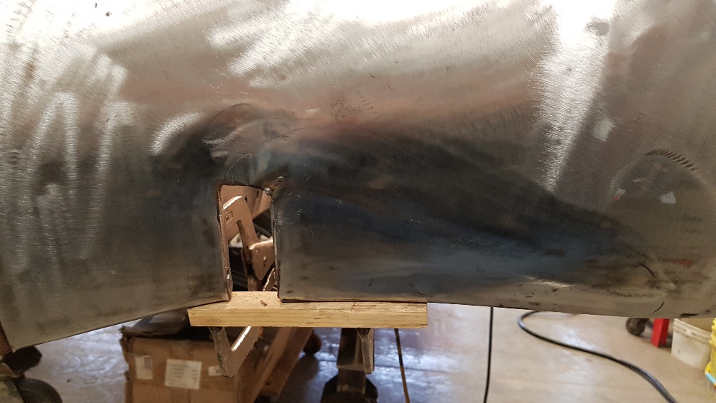

    I did a bit of light hammer and dolly work to remove 3 small dents/low spots (circled in felt pen on side of fender). I then turned my attention to a small crack on the bead. After straightening it, I thought about just welding it but it seemed to be work hardened and brittle, so I decided to cut it out, make a small patch and welded it in. 20220322_123813_resized.jpg 20220322_123820_resized.jpg
    It was now time to address the front lower portion of the fender where it looked as though someone ran up on a curb or something. It had a pretty nasty crease and the outward side was pushed back about an inch plus.. The opening for the bumper iron was also cracked and badly distorted (including the doubling plate behind). It seemed the best approach was to remove the doubling bracket, repair the damage and then weld it back together. I ground out the spot welds with a carbide burr because there was not enough room for a drill and then more hammering on stuff and welding happened.
    20220322_123932_resized.jpg 20220322_124131_resized.jpg 20220322_140009_resized.jpg That's it for now. With shop time limited to 2-3 hours every other day or so (that seems to be the limit that my shoulder is able to endure), progress will continue to be slow (but I'm still moving forward none the less!).

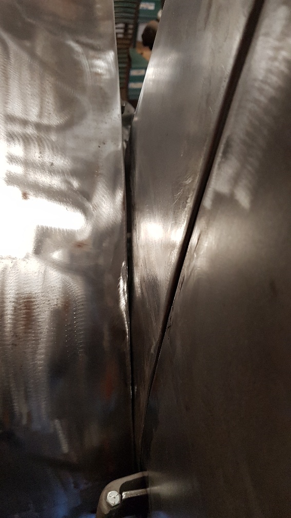

  19. I thought I might also add (in case you guys have any specific ideas and/or knowledge on this), the fit of the fender at the cowl is not great. In the center where the bolt is (near the door hinge), it's able to **** the fender up to the cowl, but forward of the bolt (toward the hood opening) there is about 1/4"+ gap and at the lower edge of the fender (below the door hinge) at the cowl there is about a 1/4" gap. I know that I could/should have fender welt in there, but it still seems like a pretty wide gap to me (see pics).
    I could cut the fender flange free and allow it to better meet the cowl and weld in a sliver of filler steel...but again, I think I'll wait until the rest of the sheet metal is attached before making any cut and weld adjustments. Are there any other solutions to this? Adding more fender to cowl attachment nuts/bolts to help **** in the fender? Or?

    having played with the front sheetmetal on my 39 Standard, I would recommend that you put all of the front end on the car, with all of the support brackets that go along with it, including the inner fenders, and the grill, hood and hood sides. it is shocking how much the fenders can twist in and out for adjustment. Example, the gap you are talking about there, went away on mine when i put the grille and inner fender panels in.

    Over on my build thread I had the same fit issue on the cowl side and marked a line parallel to the cowl and cut a sliver out of the fender, welded back together and the fit is good. this fender had a million (320) rust holes in the crown, but good shape. The other one I'm dealing with now has no rust issues, but bad shape and a LOT of old repairs and welded splits. It is proving difficult.
    So...am enjoying seeing what you are doing here. Carry on please...carefully!

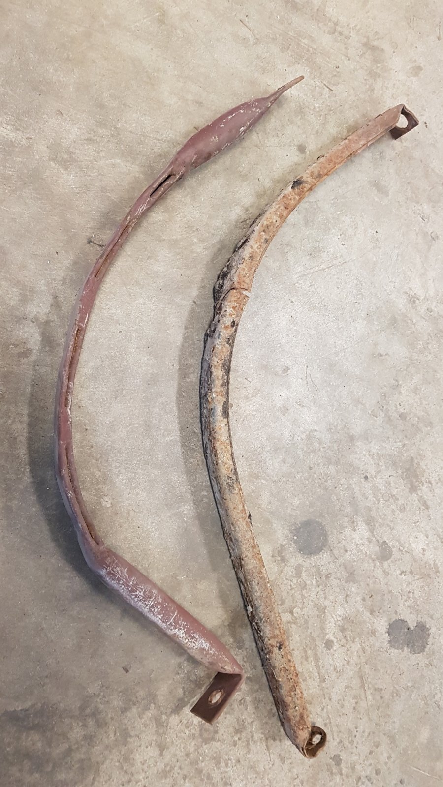

  28. And on another note, with all the stories of poor customer service and backorders and ****py parts and suppliers etc. I thought I would relay a good news story. I ordered some items from the Early Ford Store. They quickly shipped everything they had in stock and cancelled any items they didn't (no backorders). That's good service but not the coolest part of the story. A****st the parts I ordered were front fender braces because the ones that were on our '38 were junk! (see below)
    I was just going to make a new set, but given I was placing an order anyway, I saw that the Early Ford Store sold the braces at a reasonable cost, so I just added a pair to my order. When the order arrived I was shocked to find the fender braces were actual original Ford pieces (don't know if they're NOS or off a car, but they are in excellent shape) and I know they are the correct shape and will fit! I thought that was cool.

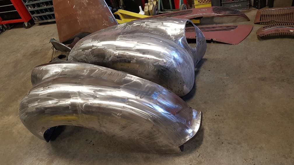

  29. I still have a bunch of fender repairs and adjustments to be made, but it looked pretty cool to me to see the car with the front fenders and part of the grill back on. :) 20220402_151144_resized.jpg

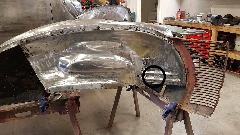

  30. And speaking of repairs...does anyone have a couple pictures of what a good version of this panel is supposed to look like? I was about to start banging and shrinking it into shape, but then it occurred to me, maybe it's not supposed to be straight, symmetrical and flat across the bottom? Thanks in advance (the panel goes at the bottom and behind of the grill in front of the radiator.
    20220402_150759_resized.jpg 20220402_150827_resized.jpg 20220402_150836_resized.jpg
