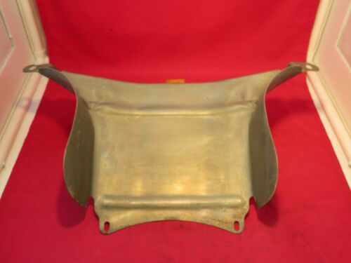

  6. From the description in the Ebay listing for that panel:
    "Often Missing, this shield goes under the radiator between the Radiator and the Front of the engine. Helps protect the front of the engine from road slush."
    I had perhaps mistakenly presumed that this panel went in front of the radiator to direct wind into the rad. The panel was just one of the parts in the trunk (the engine and trans were long gone) so I never saw it installed. If the Ebay description is correct, this will go into the spare parts pile. Does anyone know for sure? TIA
    Deutscher likes this.

    I believe you are correct, the front of the radiator pan has the crank hole doesn't it?
  8. Yes part #81A8240-B from your picture (I have that item as well) has the crank hole. I was struggling to see how and where the 2 panels would tie together so the description in the Ebay listing makes sense. Thanks again for your help.

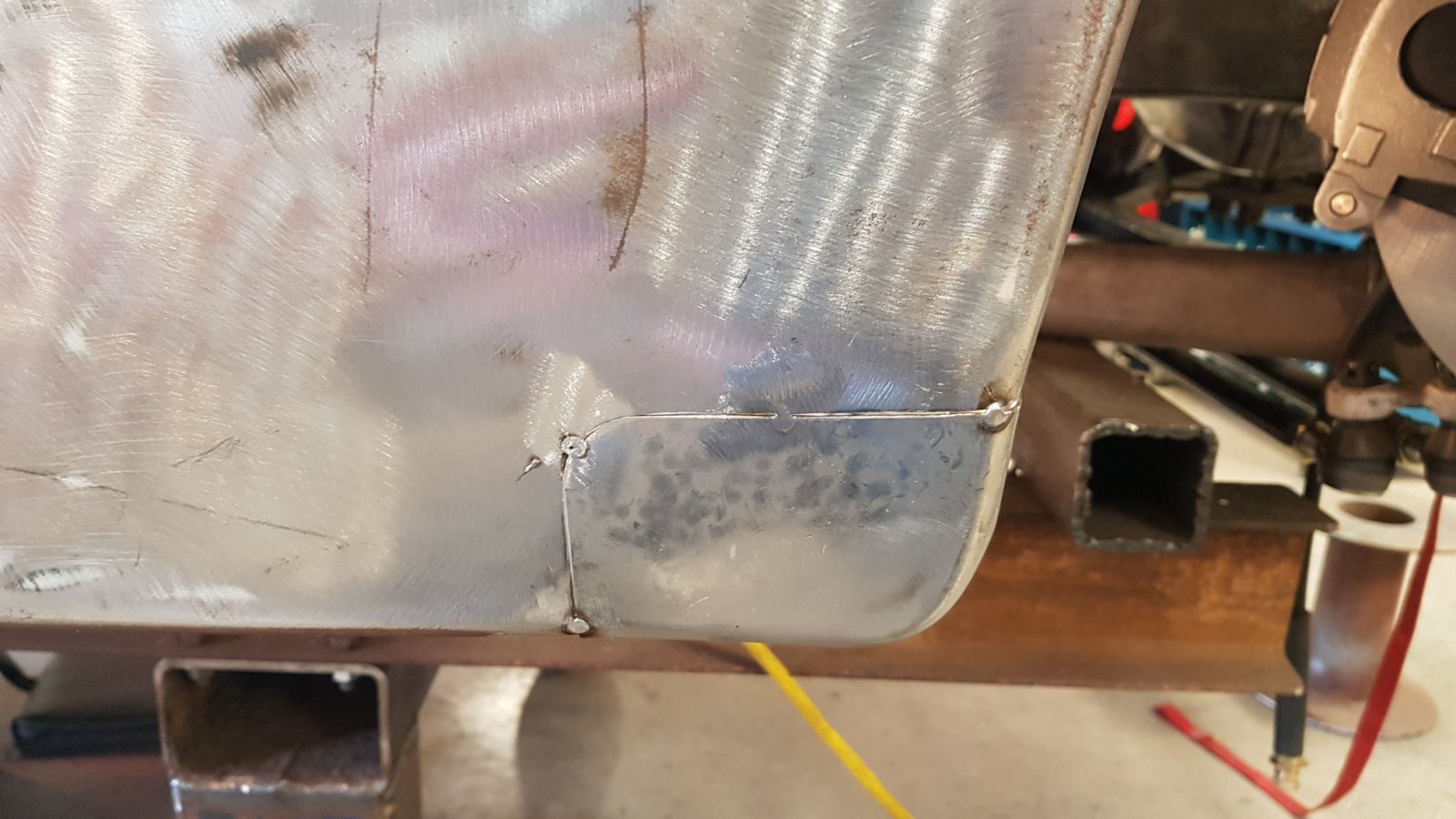

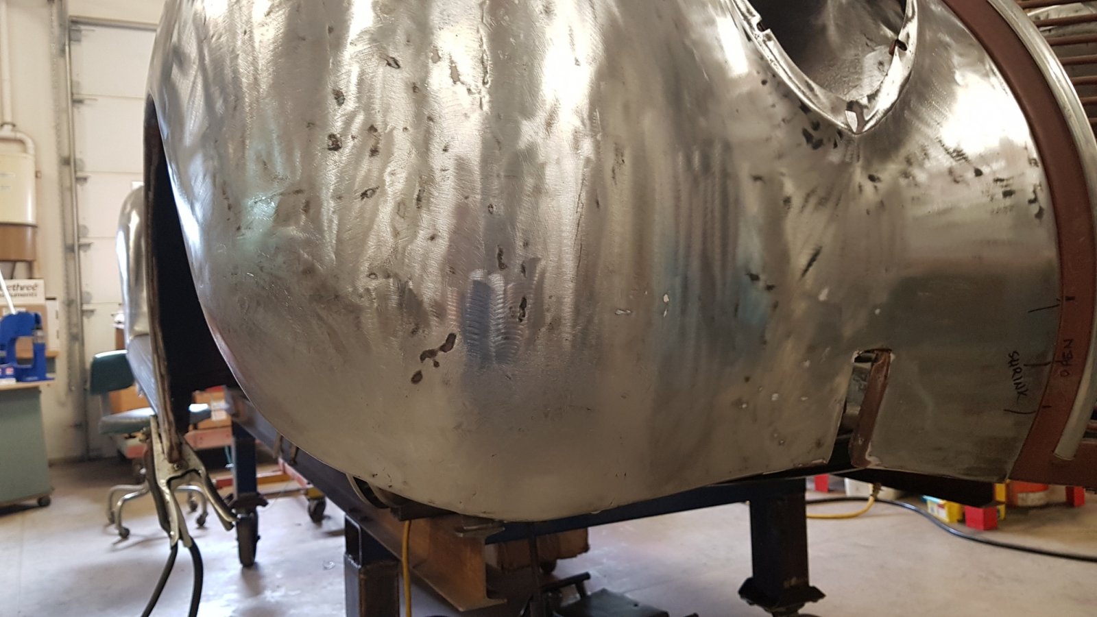

  10. Thanks guys. After spending a couple days lifting, pushing, prying, hanging and adjusting the front fenders and grille, I think I've finally got them close to where they need to be. The one thought I had while wrestling with this mess, sure glad they aren't painted yet! And, make sure there is help available for the install once painted. I used the front fender bumper cut outs and their relationship to the front frame horns as a guide. I still need to figure out the best order for the final installation, at the moment I'm thinking about ***embling the fenders, grille and aprons together and then installing that as a unit (this time, I ***embled it one piece at a time). Any advice or comments?

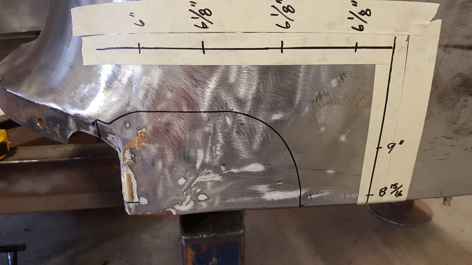

    Now that it was in place, I can repair the p***enger front fender. There are 3 previously welded tears/stress cracks in the wheel well beading. On the surface, they don't look too bad, but the repairs could be done better. Starting with the worst one, I need to duplicate a patch with this shape before cutting it out. It's probably cut deeper into the fender than necessary but it seemed like a natural area to cut as there were a couple deep dings (metal stretched) as well as a bit of surface rust and pitting. 20220411_110532_resized.jpg After rough cutting an 18 gauge piece of steel for the patch, I marked the shape I needed at the wheel well and used this combination of dies on the bead roller to start to round over the wheel well bead.

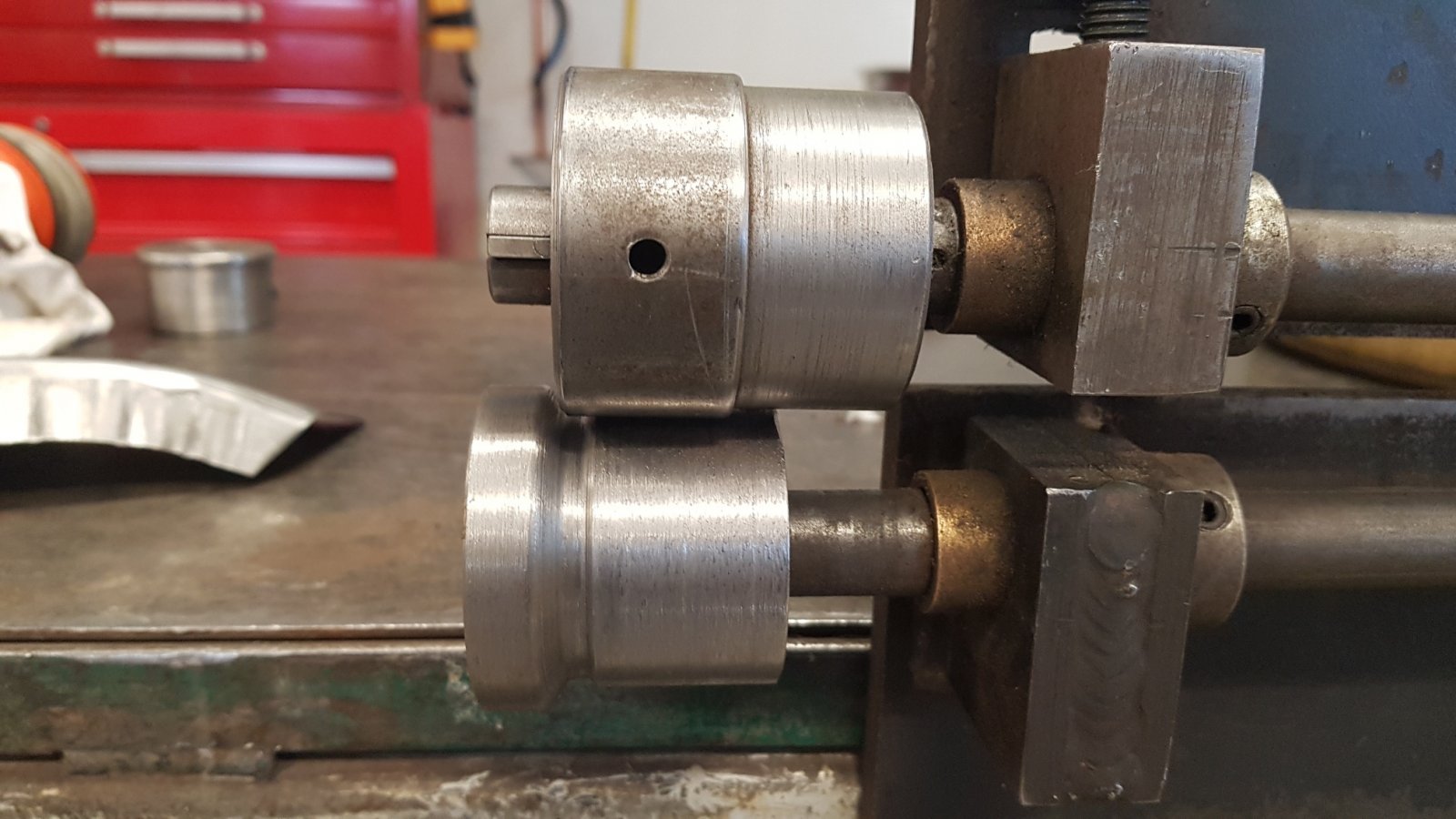

    Once the starting point of the bead was rounded over, I used the flat wheels on the English wheel to help the edge over further. I didn't take any pictures of this, but basically I rolled the rounded over edge right next to the corner of the flat wheels while applying downward pressure on the outside of the patch. A couple p***es doing this and the wheel well bead was pretty close to a 90 degree flange. I then took the patch to the shrinker to help the patch to conform to the desired shape.

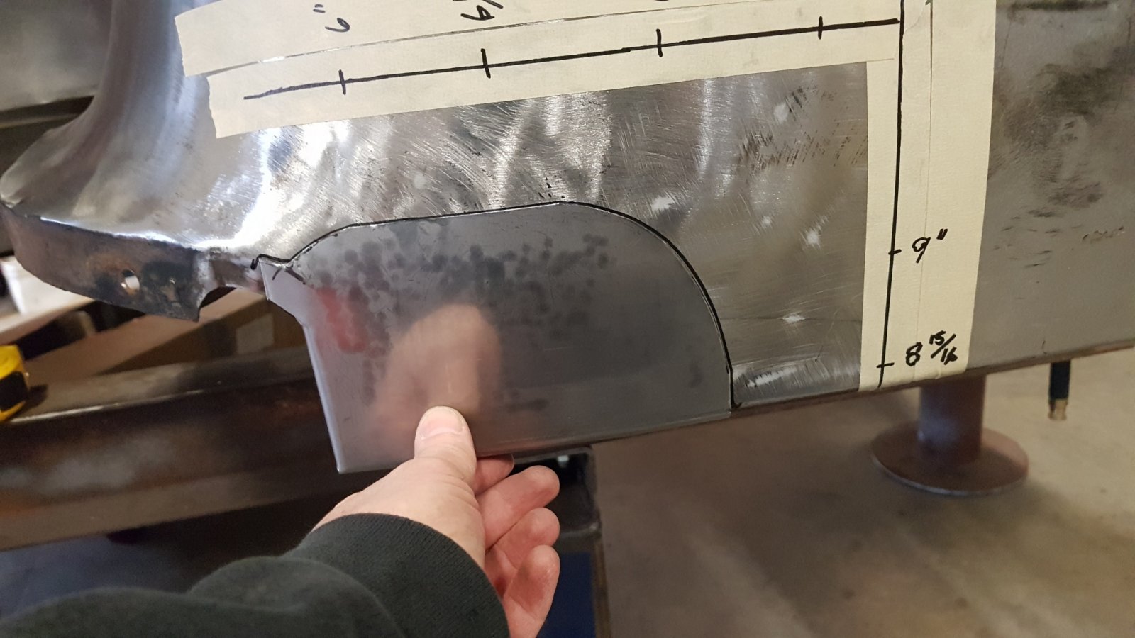

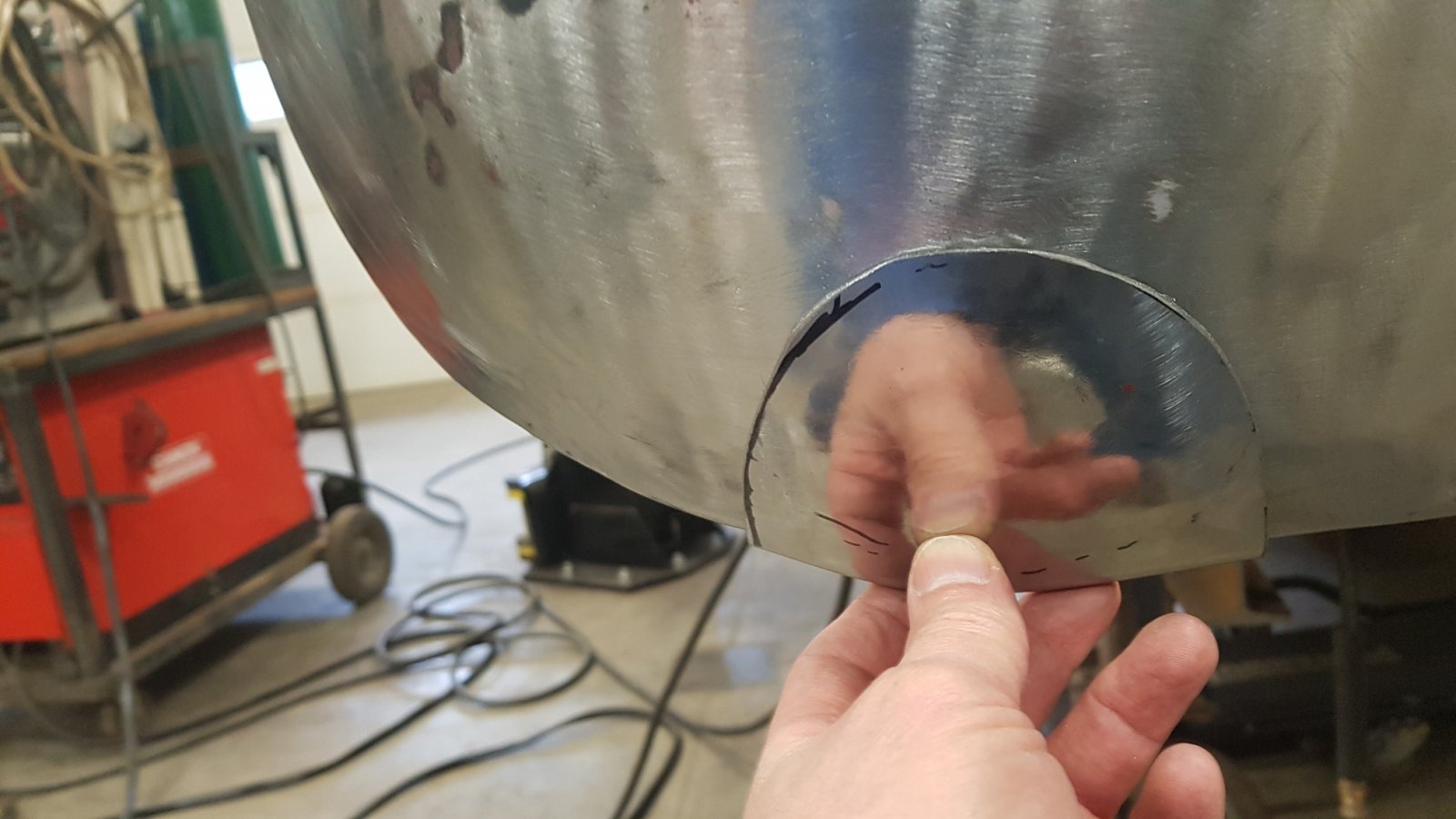

    20220411_110906_resized.jpg I started comparing the patch panel to the fender area.

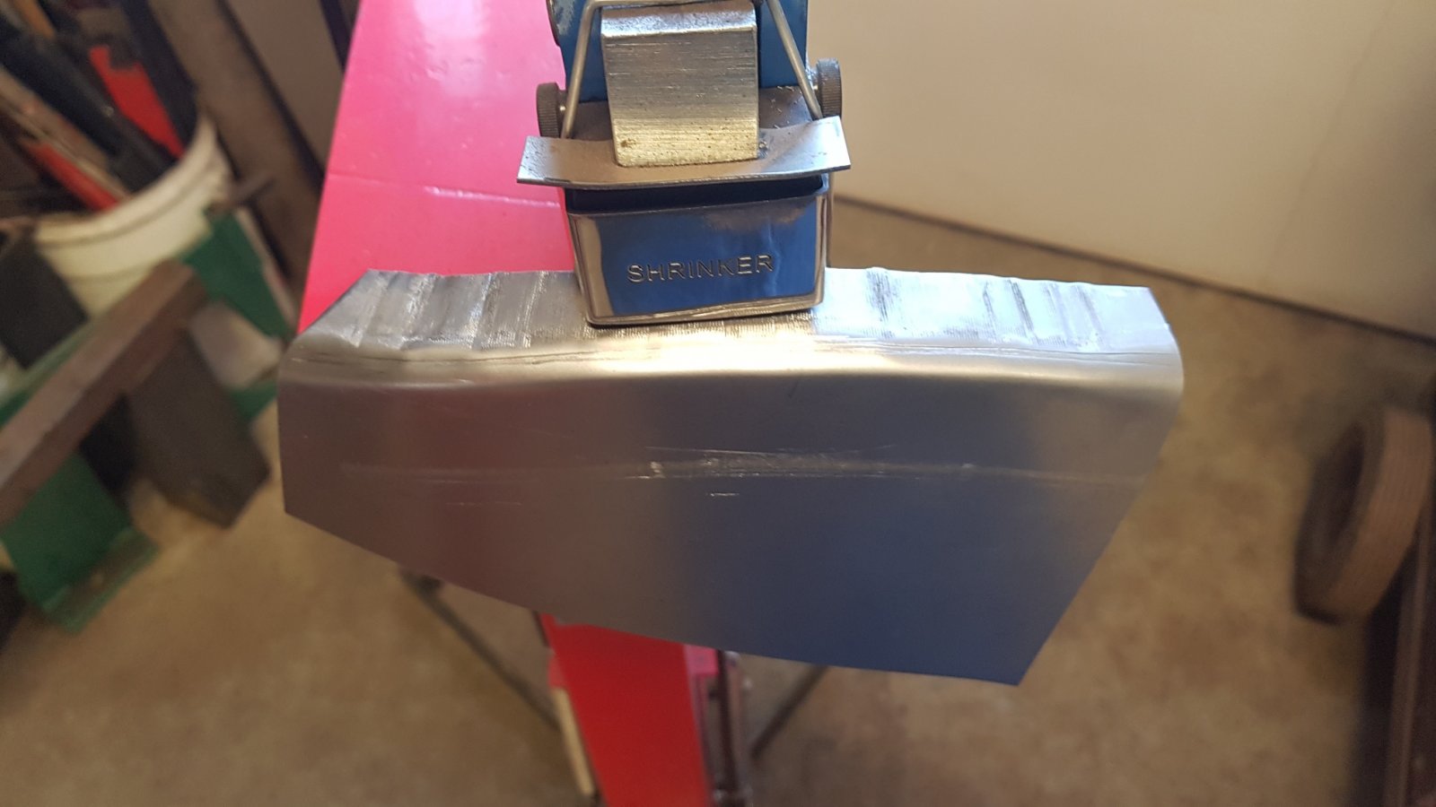

    20220411_110947_resized.jpg Next step was to introduce some stretch in the middle and a little shrinking around the edges to replicate the roundness of the fender. I used the little HF planishing hammer for the stretching, and a bit more time very gently shrinking around the edge (again, no pictures...I really need to remember!). I then slowly brought the wheel well bead around a little bit at a time with a pair of pliers until it closely matched the original shape of the bead.
    20220411_111659_resized.jpg After t******* the patch close to the finished size, I cut out the original section of the fender. From the back side, the previously brazed crack repair is obvious.
    The new patch is tacked into place and a little more hammer and dolly work brought the patch to the final shape. When this picture was taken, I still had to bring the fender and patch into alignment at the bottom to flatten the transition from fender to patch.
    A bit of time with the tig welder, grinder, hammer and dolly and this is the finished patch in place.

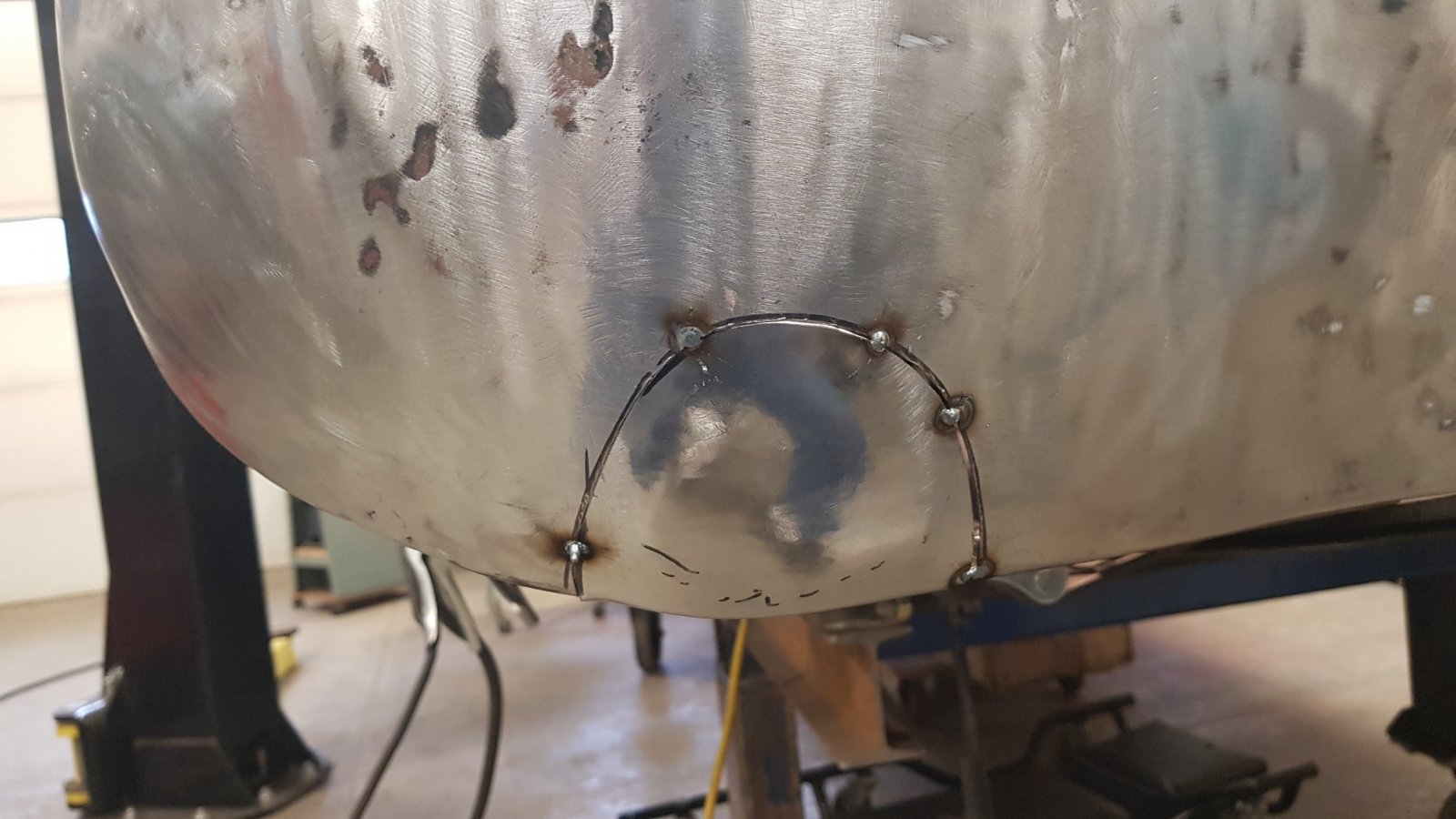

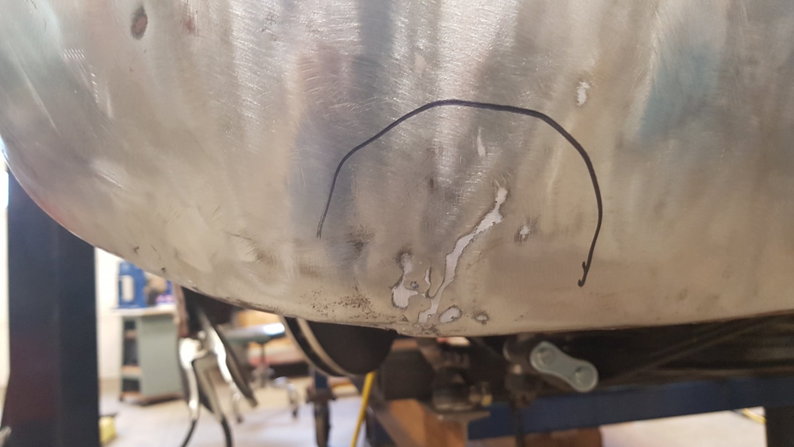

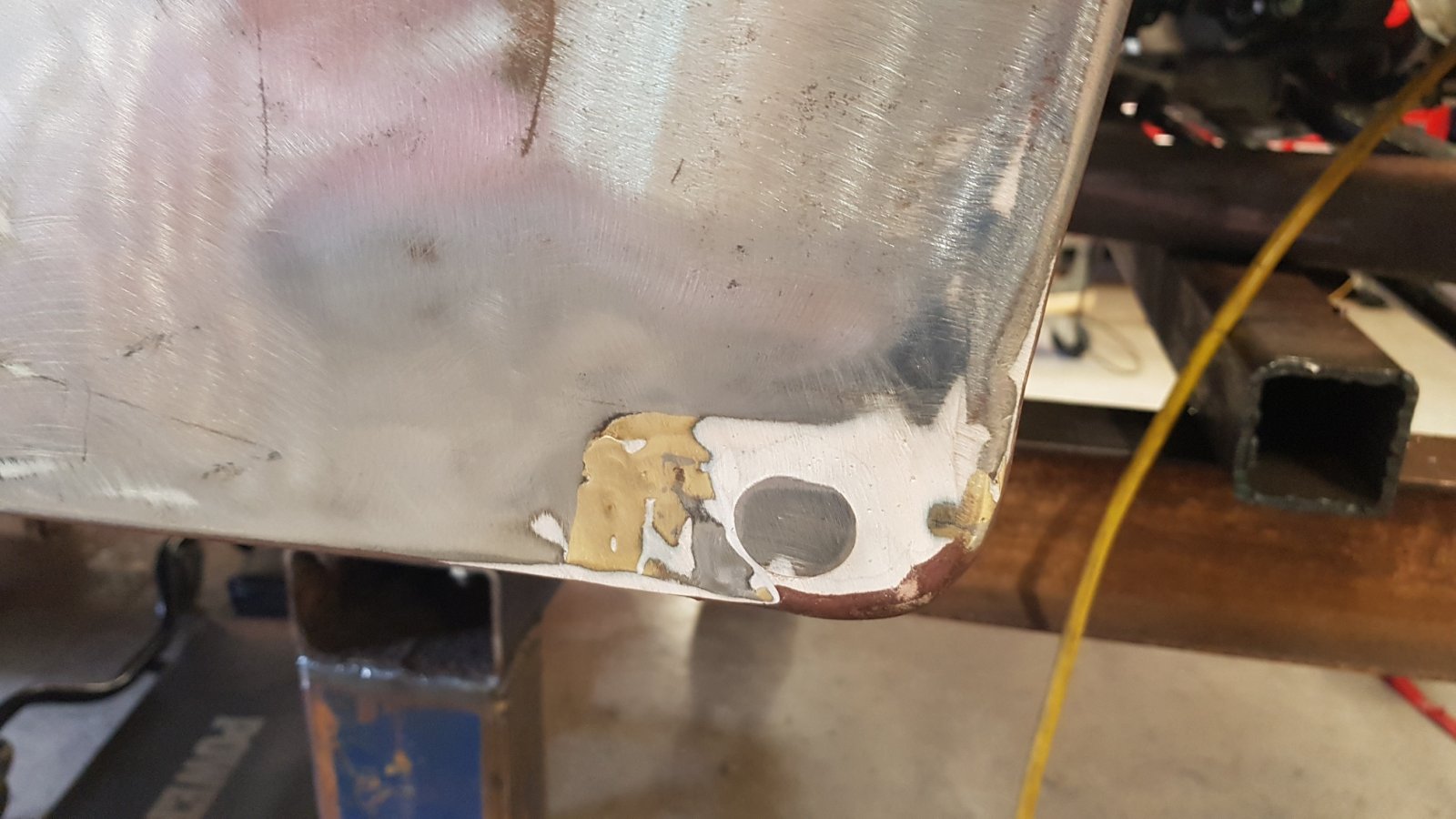

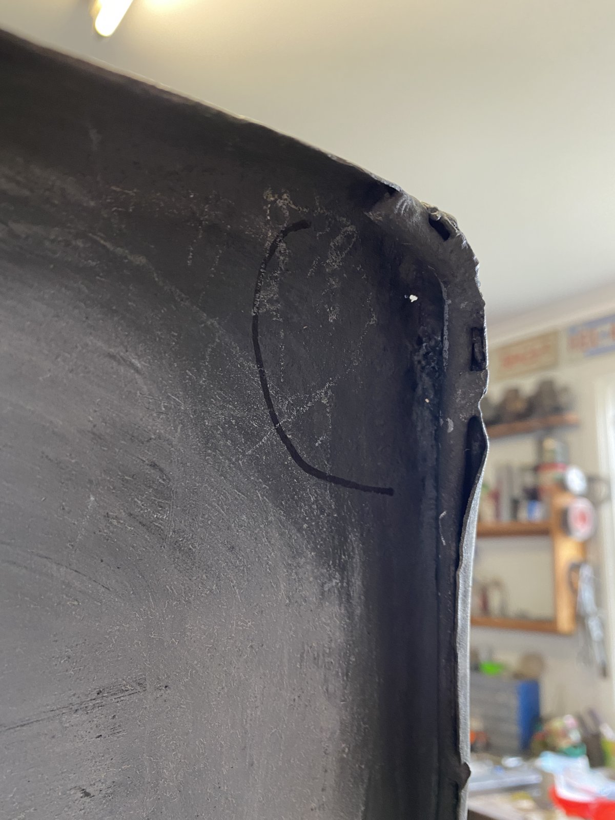

    So I got another few hours in the shop today and made more progress on the p***enger front fender. Just inside of the last patch on the lower front of the fender was another previously repair stress crack. I marked the area of concern and started to make another small patch panel.
    I took a small piece of 18 gauge from the s**** bin, ran the HF planishing hammer over it to give it some shape, folded a soft flange on the bottom with the brake, and then shrunk the edge of the flange to help "bring it around". After a number of test fits, I managed to sneak up on the desired shape.
    After t******* the damaged area out, tacking the new panel in with the mig and then tig welding the patch into place, this is what I ended up. I should add that this is not my prettiest tig work, but the pieces are stuck together as one.
    And then a little time with the grinders, sanders and hitting it with hammers to get to this.

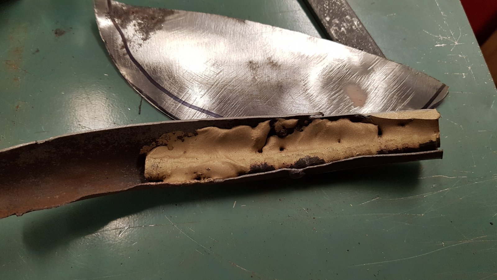

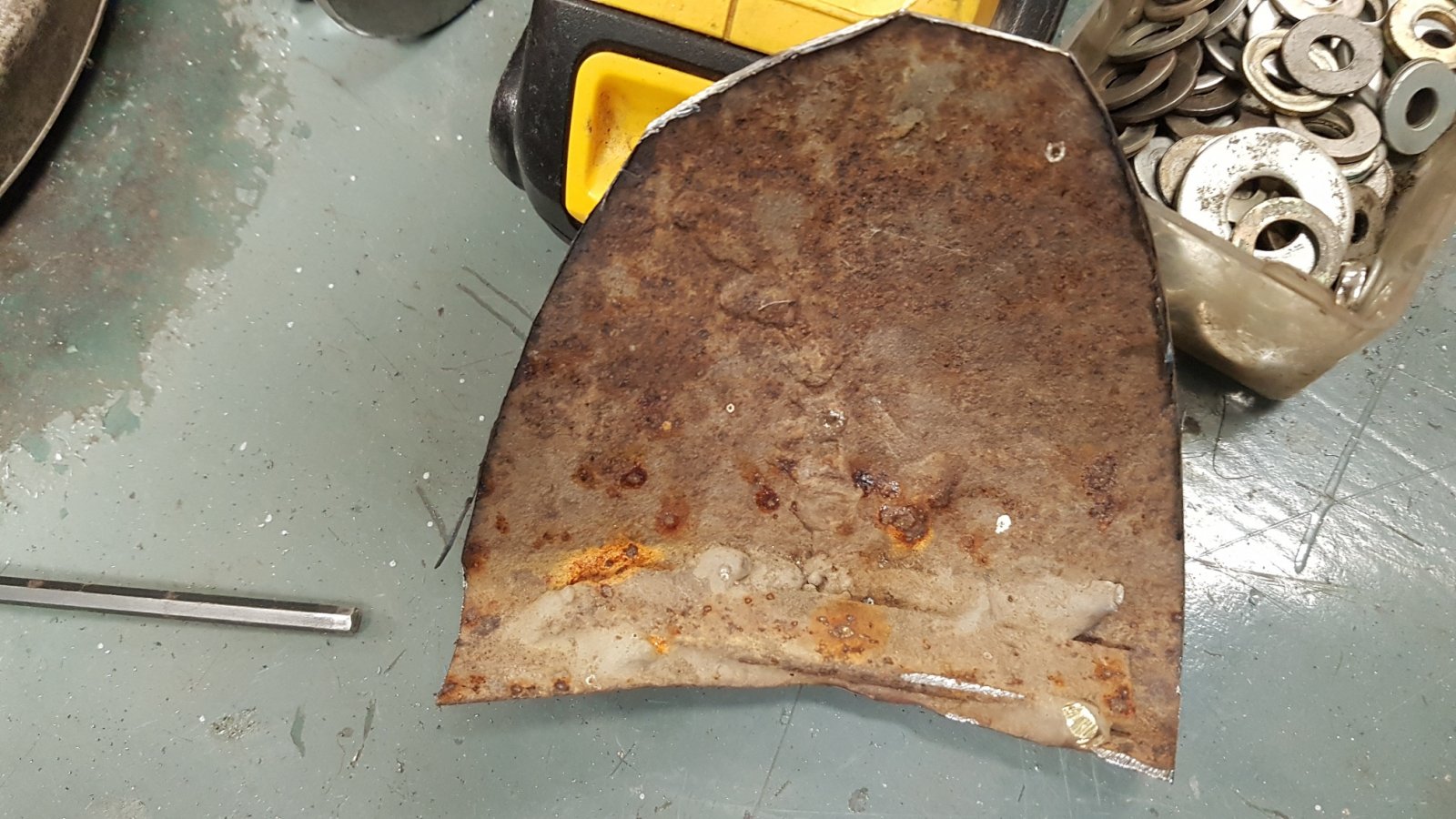

    20220415_134708_resized.jpg This is the backside of the piece that was cut out. While still rusty and dirty on the backside, the old chunk of bar stock was brazed into place.
    20220415_134748_resized.jpg Next up will be the bottom edge of the fender behind the wheel well. The previous craftsman repaired the damage by caving the area with a hammer, drilling through the fender and inserting a carriage bolt, grinding the head somewhat flat and then filling in the caved portions with br*** and bondo. Yeah...no, that's not how we're going to leave it!
    All for now.

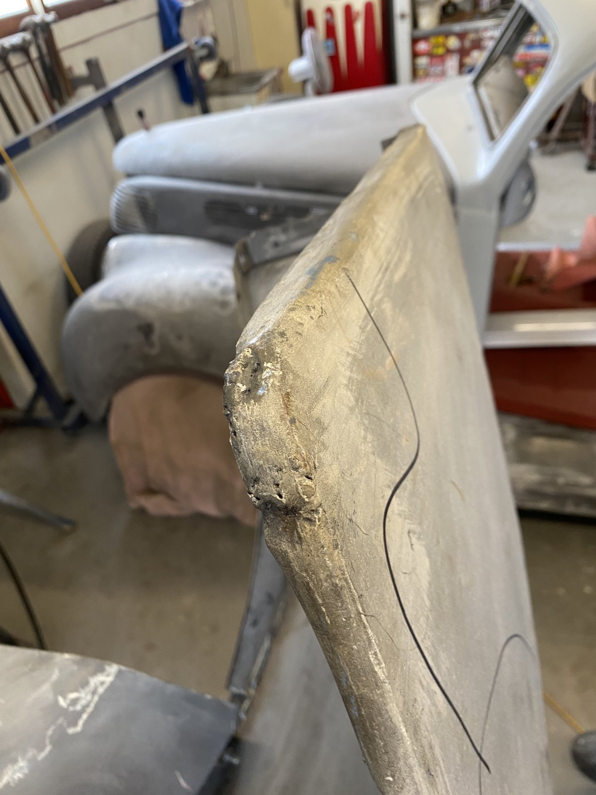

  19. I'm interested in/curious about how you made your patch? I'm debating in my mind how to make it, how many pieces and where to make the joints.

    My corner is like this, with rust holes, misshapen and a steel rod welded the whole fender lip.
    For material, I used what I cut out of the rear fender when I put in the filler door. I figured it's the same thickness, same metal.

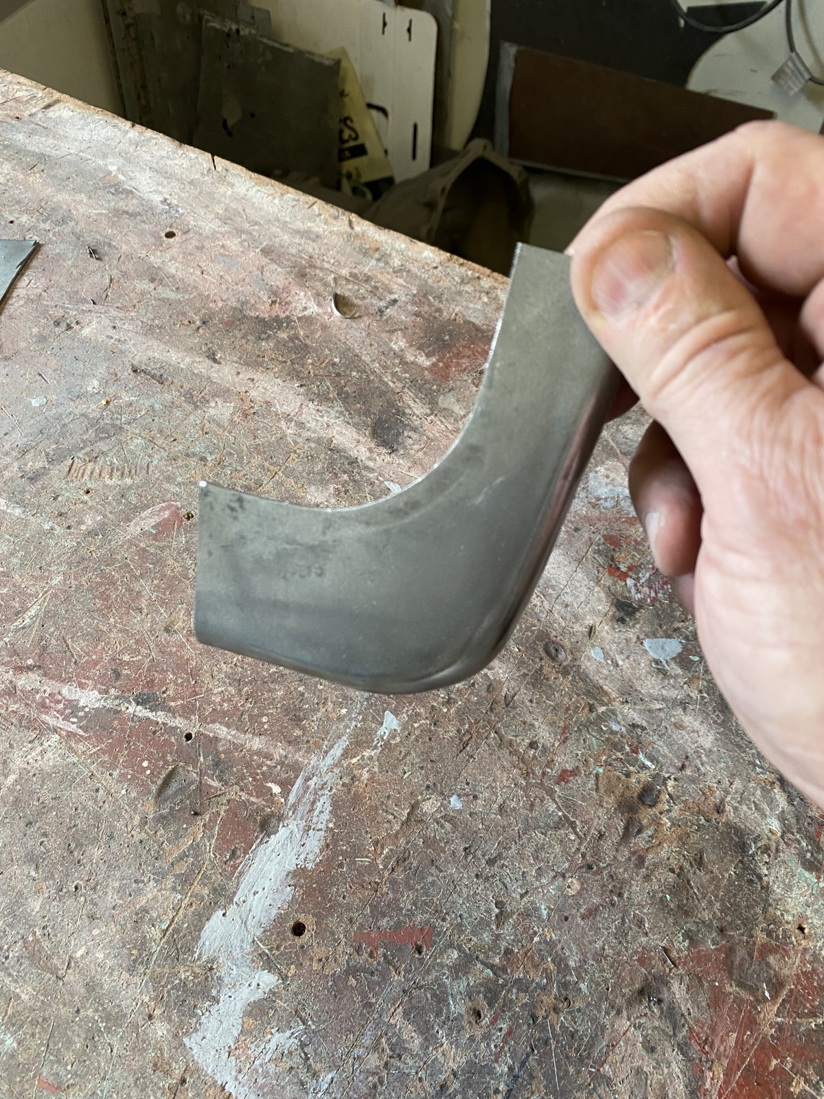

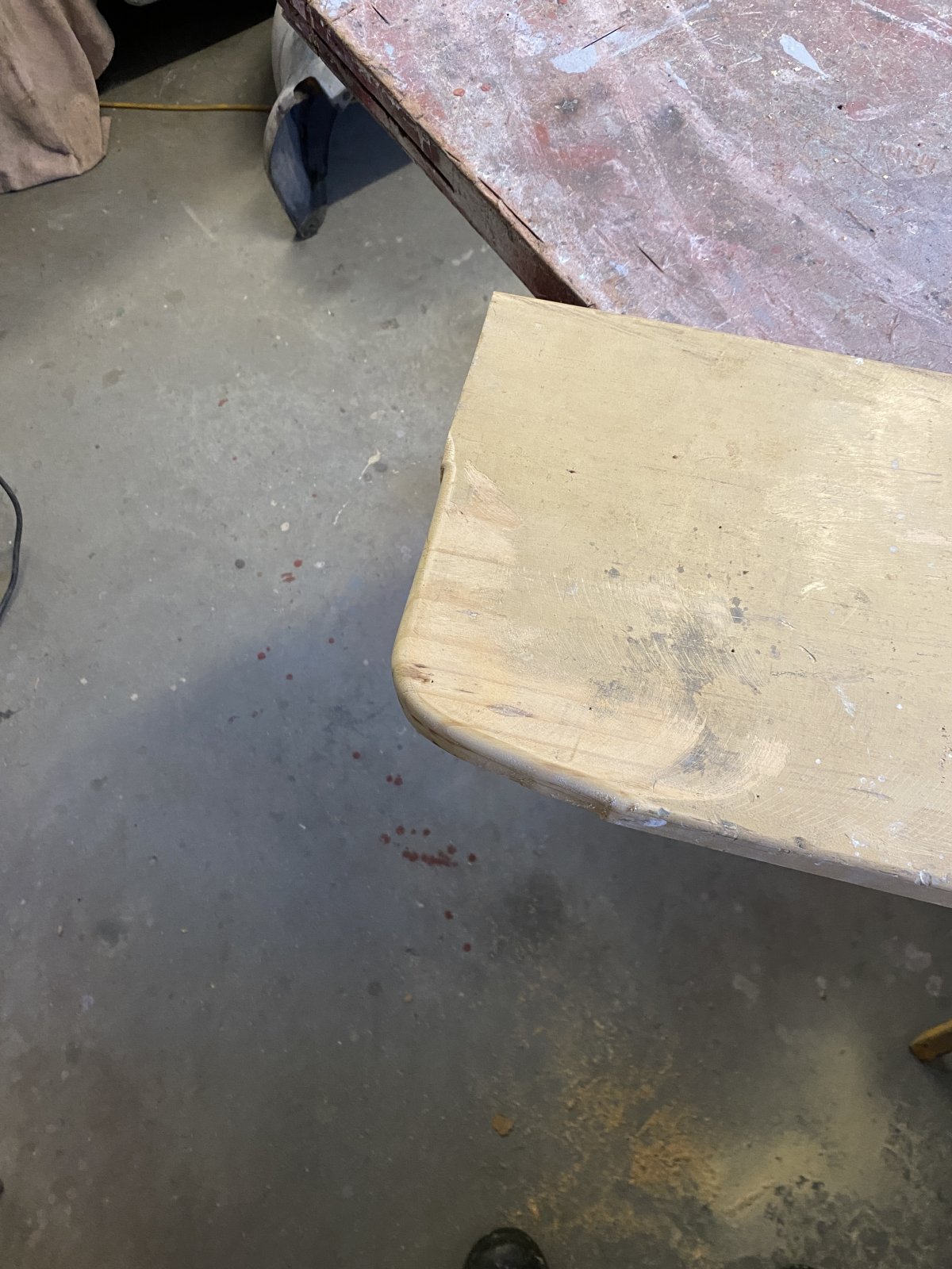

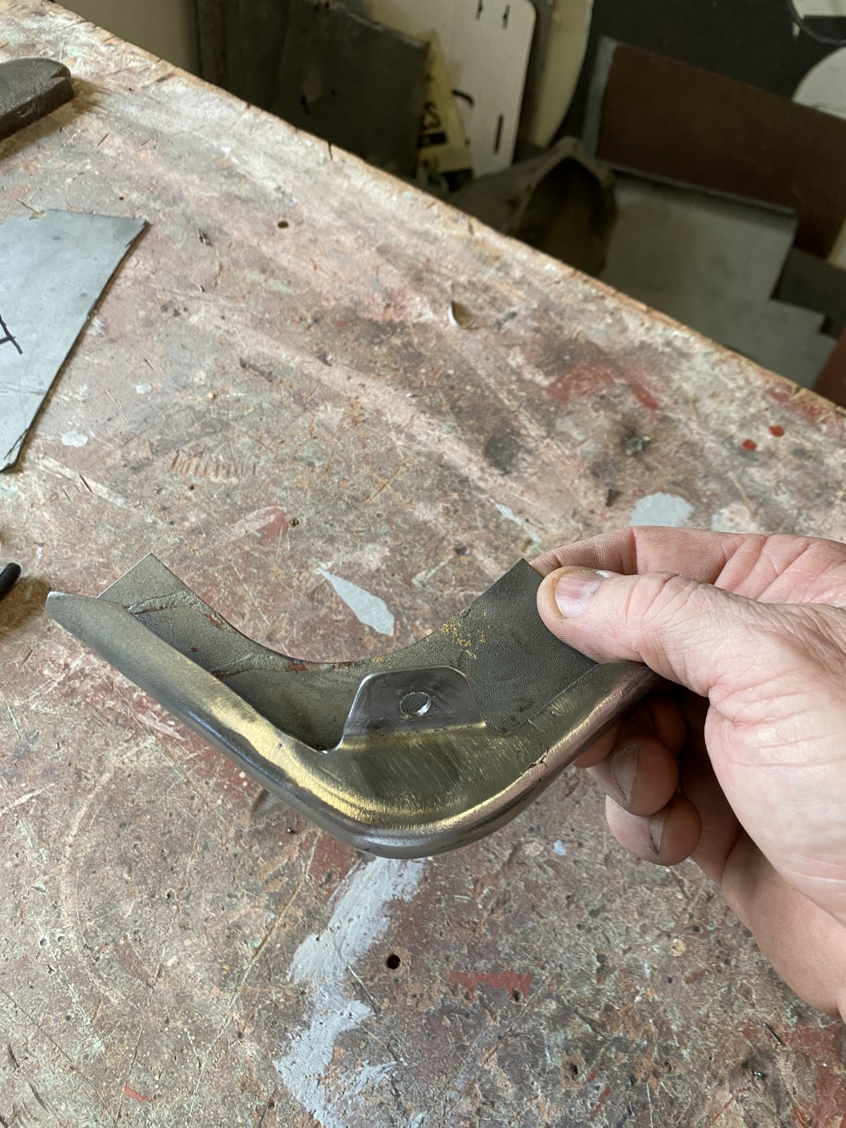

    I formed the corner over a quickly made hammer form, bent the corner radius half way as I was going to form the inside tab section the other half. I used a T dolly to round the lip and ground a piece of bar into the corner radius to tweak that. Welded it together and dressed it like this:
    Basic hammer form I used to get me started. Sorry, I didn't take any more pictures :rolleyes:
    Deutscher, bchctybob, brEad and 4 others like this.
  21. Good approach. Thanks for posting,. I'm going to use your method.
    X38 likes this.

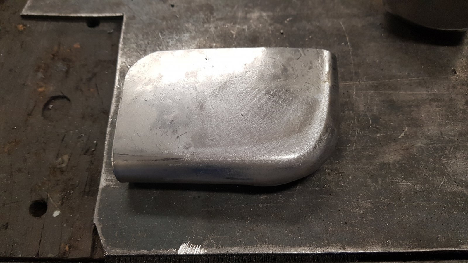

  22. Thanks guys....and special thanks to @X38. Tony your method worked perfectly. Starting with the wood buck cut and rounded from some s**** I had in the pile, I then trimmed a small piece of 18 gauge s**** from under the foot shear, I got to this. 20220416_104214_resized.jpg 20220416_104845_resized.jpg
    After a couple minutes with the hammer one piece was shaped, I then grabbed another small piece to make the inside fender brace attachment...once shaped, the two were welded together and metal finished.

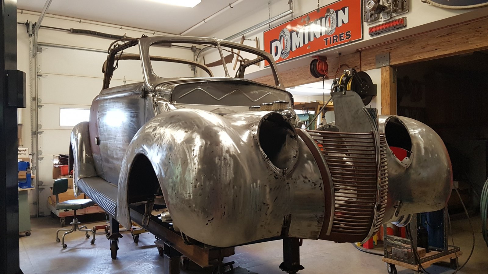

    And, as I was sitting on my stool feeling good about being able to make progress again, I took this picture of the front end slowly coming together. I thought it was looking pretty cool.:cool:;)

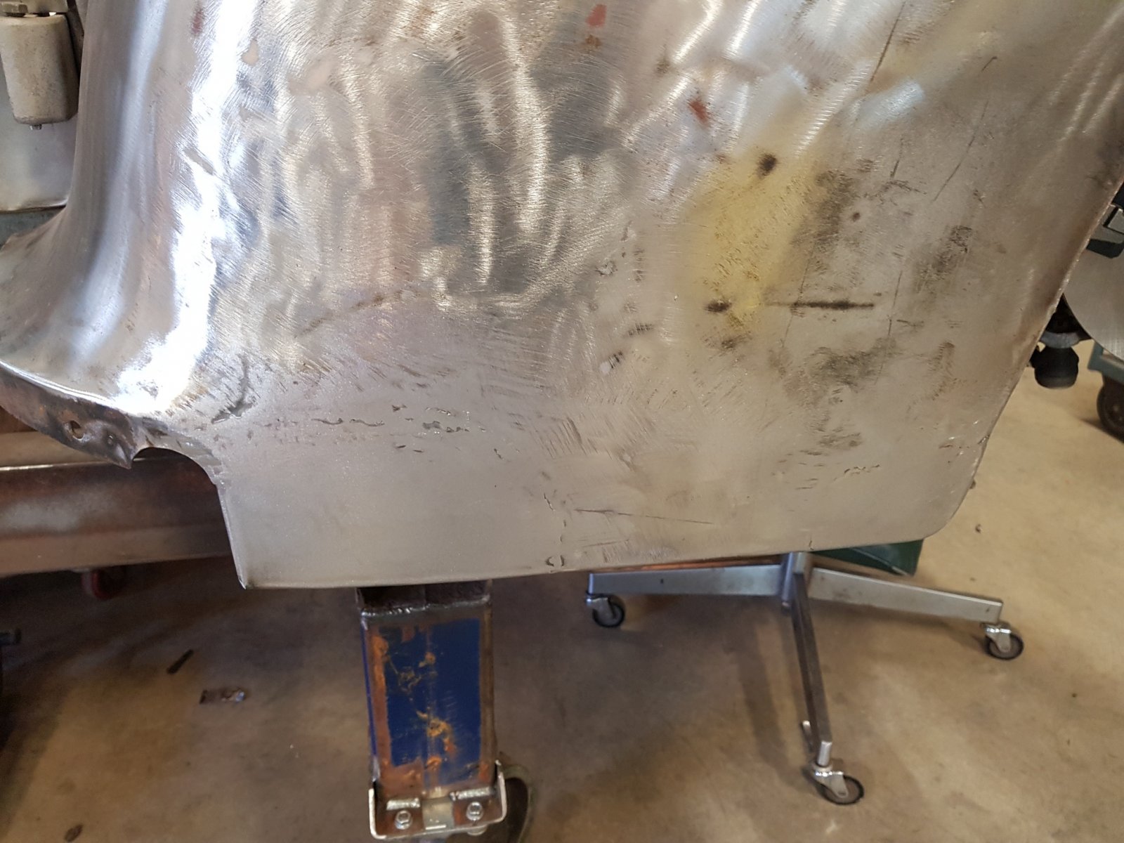

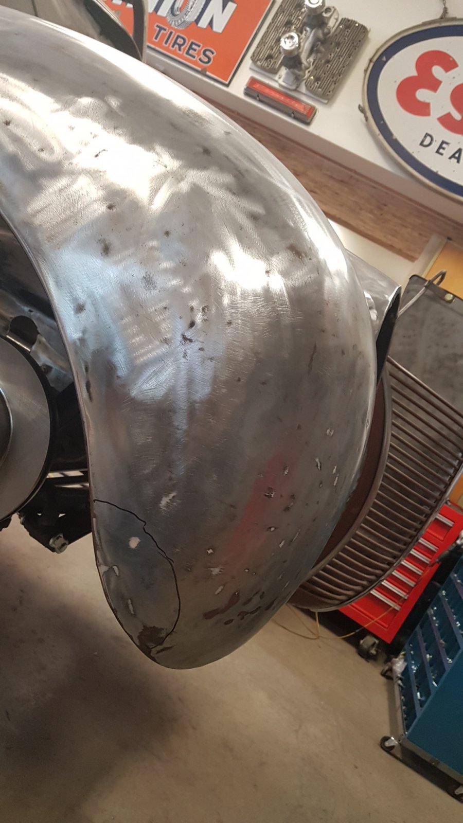

    Might be time for a minor update. By chipping at it a little at a time, I finally managed to get the last repair to the front p***enger fender completed. Again, evidence of previous repairs completed in br*** less than ideal steel welding. Using masking tape, I marked out a couple straight(ish) lines and then measured and marked out the distance to the edges. This gave me a target to aim for with my patch panel.
    20220420_140452_resized.jpg After making a cardboard template, I made a couple flanges on the brake for the bottom and back edge, a little time hammering the bottom over a round bar gave me the rounded edge, then a couple mintes with the planishing hammer to give the flat part of the patch just a hint of shape. The process of making and installing sheet metal patches may seem a bit repe***ive, I've often said that building a hot rod is easy...you just shape, cut, weld, grind, repeat.
    And, again some less than perfect (though fully penetrated) tig welding and it's permanently installed.
    And more time with the grinders, sanders, hammer and dolly etc. and then re-install the running board. One thing that this helped me to realize, while I had access holes cut on the inside of the boxed frame for access to the running board nuts and washers, it was still a pain in the **** (with dropping nuts and washers into the boxed frame, fishing them out with magnets and apparently my fingers are not as nimble as I once thought they were!). So, while the running board was off, I drilled out the holes in the frame for the running boards and welded nuts in place. I will do the same on the driver side. After the second running board nuts are welded in, next up will be the hood components. 20220510_110005_resized.jpg 20220511_154651_resized.jpg
