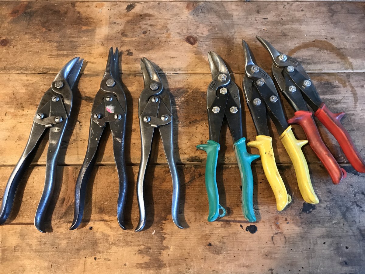

    I've had very good luck with Wiss brand snips. The snips on the left are older Wiss "Metalmaster" series and are absolutely excellent. The ones on the right are newer and decent, but not as nice. All of these came from garage sales for around $1 each.

    Midwest brand are better than Wiss. Wiss used to be a good brand. They always loosen up and have to be tightened. Other than that, I would say Wiss takes second. Midwest brand are the same as the old craftsman brand.
