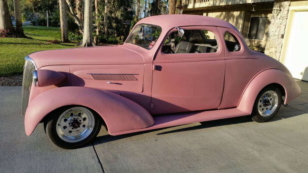

    Added some red to the epoxy primer and sprayed my 37chevy. Had the car for 42 years, in the process of a frame off, lt1, 6 speed resto 20171212_164221-1.jpg 20171212_164002.jpg

    I was apprehensive at first but after it looks so much better than before, also makes a good guide coat for block sanding

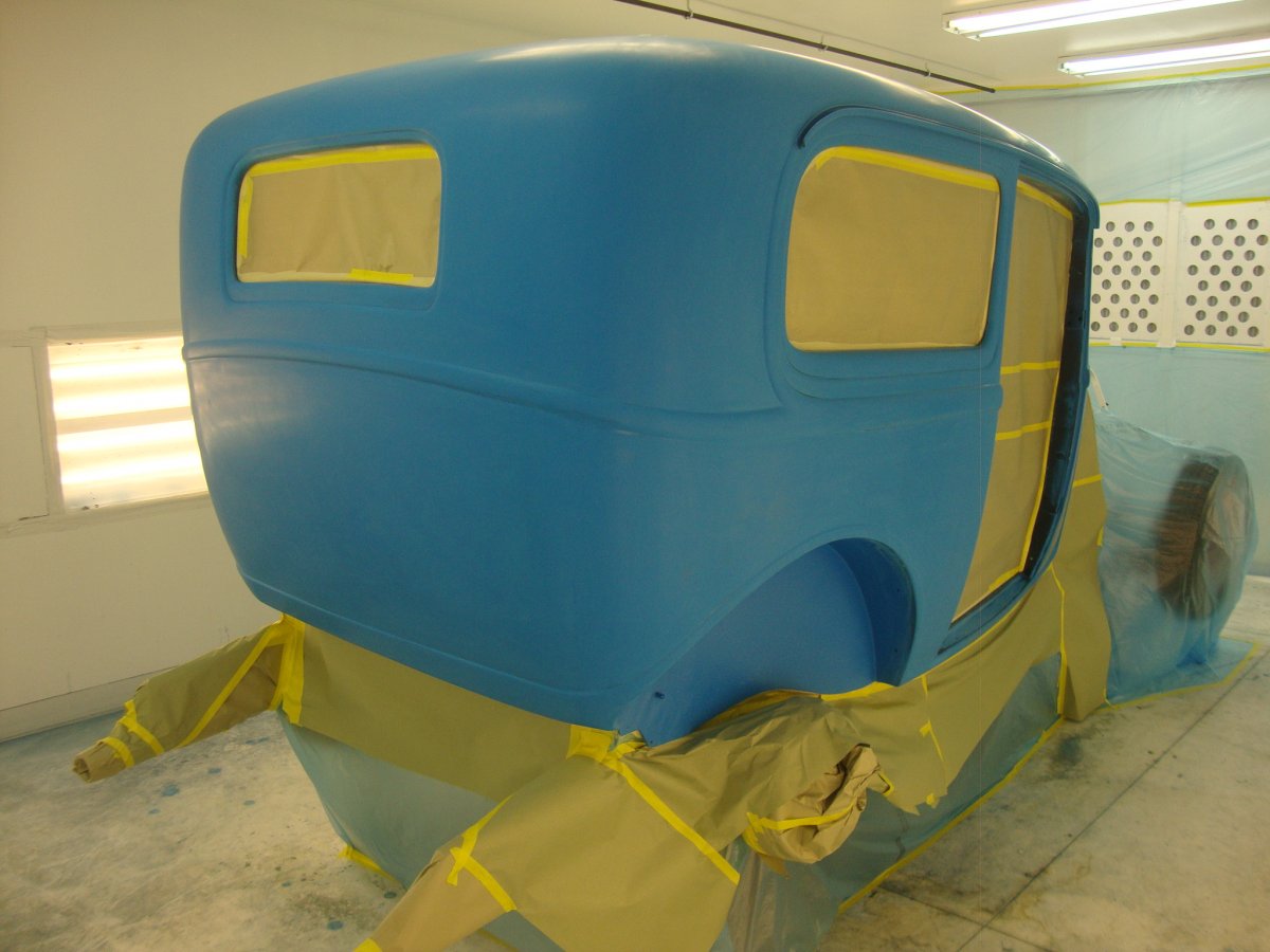

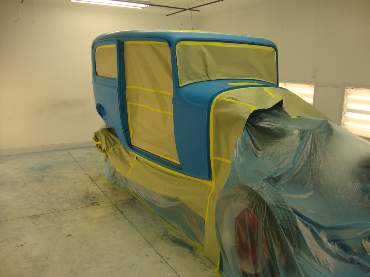

    Before the color coat went on this Smurf blue was sprayed. DSC03000.JPG DSC03001.JPG

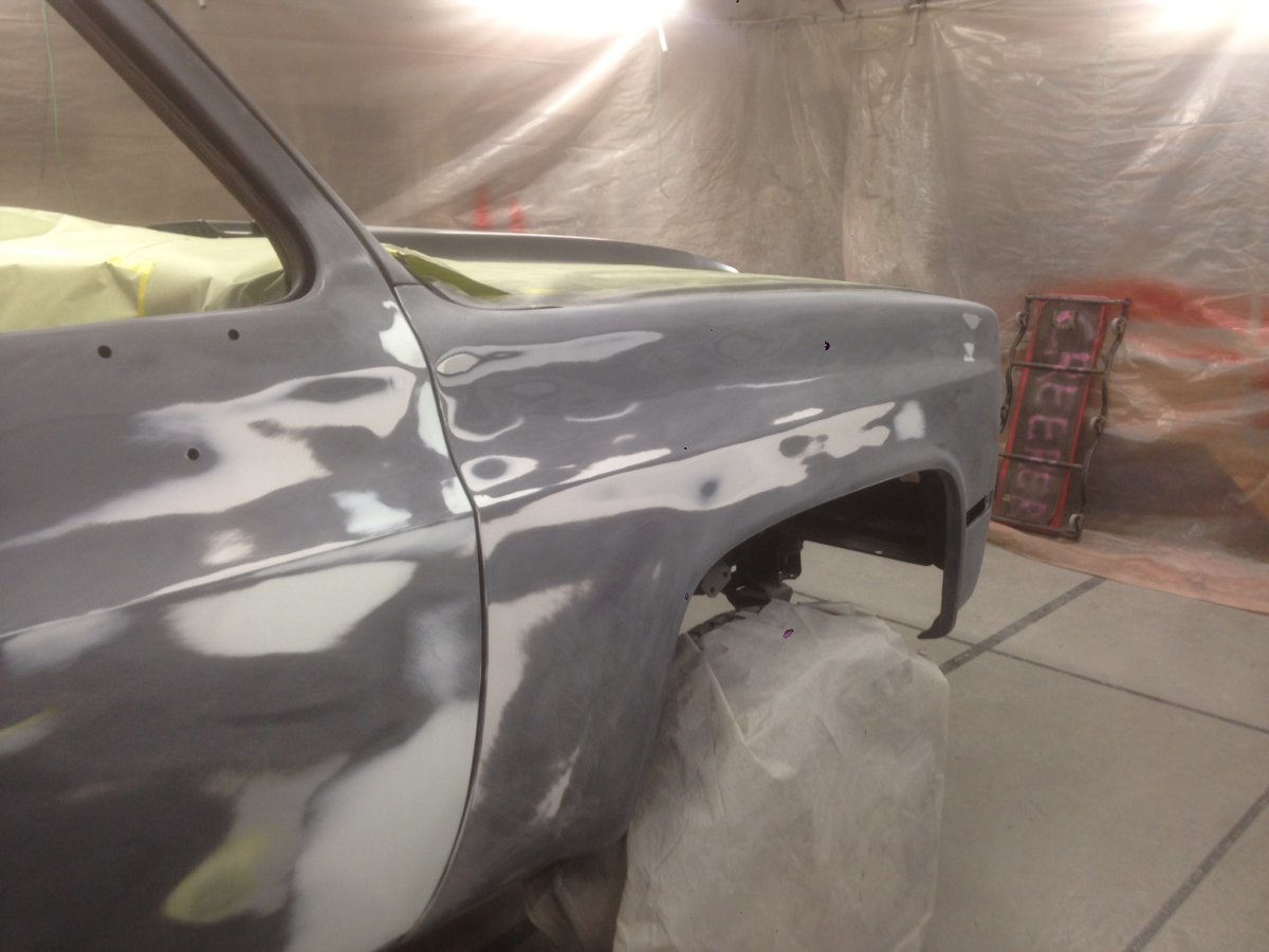

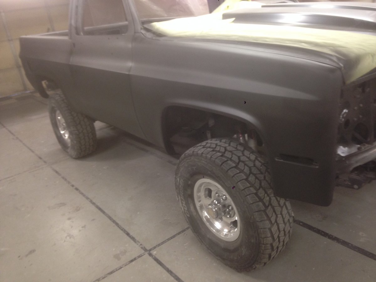

  16. Anything one uniform color looks better that 50 shades of bodywork no matter what color it is.
    That's mind boggling :eek::eek::eek: sometimes. It totally removes any illusions of progress.
    I like my primer tinted black :D
    Turn grey when you sand it, great guide coat for the first sanding.
