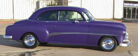

    Anyway, Here is how I got purple primer for my car. (This is all straight outta PPG's specs, BTW.)
    I used PPG's K93 Tintable Primer. Mine was tinted using DMC 934 purple, which is really a tint for PPGs "Concept" paint. THe deal is, tho, that this made it kind of like a transparent primer. Almost like a candy. The purple pigments used are by nature transparent, as are many blues like you mentioned. Therefore it took several coats to get any coverage. Also, this is not a finish you can leave out in daylight all the time. It will last about 3X as long as the popular DP90 black primer, but it will still fade pretty bad. (The attached pic actually shows my 2nd re-coat of this primer due to fading from having this as my daily driver for about 7 yrs.
    If this is to be your final finish on the car, I'd go along with overspray's recommendations to use flattener in real paint. Primer ain't meant to hold up to UV rays like paint.
