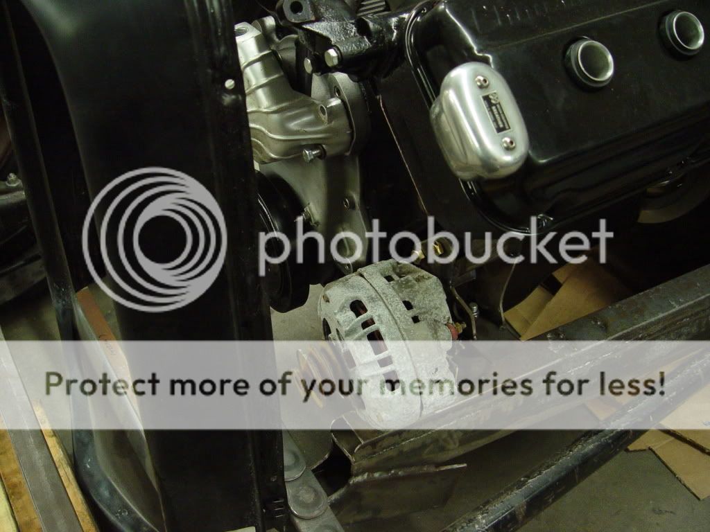

    Okay, I took a couple pictures last night of where this thing pretty much HAS to go. It's the only place I really have room.
    YES there is space down by the pan in this picture, but there won't be when the front of the frame is done. The shocks will be mounted down there.
    This is the early Mopar alternator I'm going to try to use. It will sit higher up which will mean it will have to come forward about an inch to clear the block which means so will the pulley.
    Hopefully this clears up the reason for the thread.

    That looks good. I still prefer the small Nippondensos, if you still need more room, but they look less trad.

    Scooter,
    I don't see anything wrong with the last picture you put up. I should have gotten in earlier, though. For those with room forward, most alternators don't care which way they turn. You can flip them around to face backwards and hang out in fromt of the motor. Resist the temptation to couple one directly to the crank, though. If you get rpm happy at all, it won't live long.
