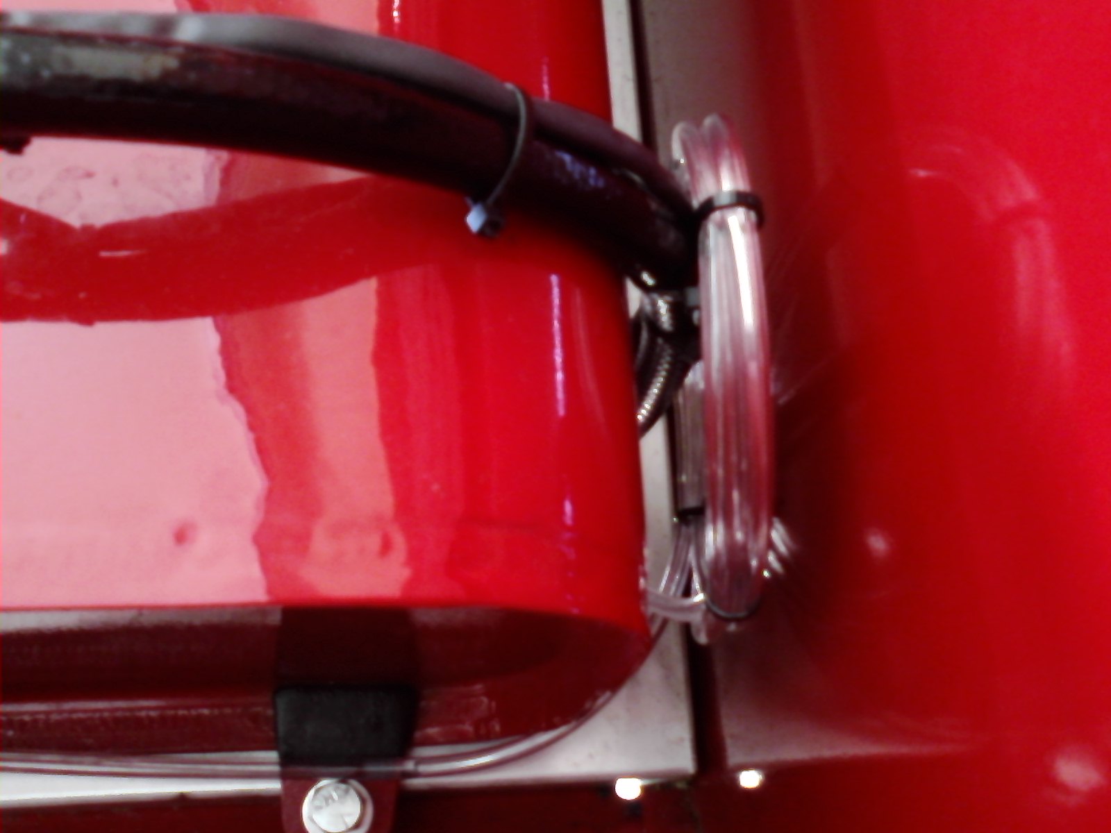

    I have a coil of tubing in my vent line just above my tank, that doesn't seem to help. Someone on the H.A.M.B. suggested attaching a fuel filter w/1/4" fittings to the vent line so the tank could breath. That seems to help, but it's not the cure all.
    It was also suggested to run a vent line as high above the tank as I could and create a 180 then back down, kind of like a upside down J trap. I don't see how that would make any difference.
    Again, the fuel filter on the end of the vent line does seem to help!
    ANY OTHER IDEAS?????

    OK! Here is what I have and have done today! Hope the hell it works! I used a puke tank and screened the lines inside and filled it with activated charcoal and attached it to a fuel filter and then on to the curley-q on top of the tank!

    OK! This was this mornings project. Still smelled gas, off came the canister.
    I came off the curley-q with 3 loops as high as and behind the tank.
    Then I dropped through the floor and attached a fuel filter with 1/4"
    fittings then from the filter a 3' line terminating in the frame rail.
    This afternoon it was 84 degrees---2 days, No smell!
