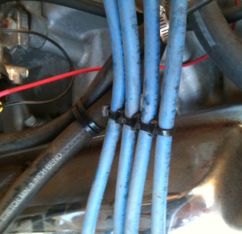

  18. Deep Purple
    Joined: Feb 22, 2008
    Posts: 161
    Deep Purple
    I like this idea:
    --along the side of the valve cover then behind covers --
    I have it so now, but only with cable ties
    Any ideas for another fasteners ?
  19. Deep Purple
    Posts: 161
    Deep Purple
  20. Dirk35
    Joined: Mar 8, 2001
    Posts: 2,067
    Dirk35
    I made my own with zip ties. Takes 4 ties to make a holder. Don't pull them too tight. I got the idea from the Weekend Hot Rod TV Show.
