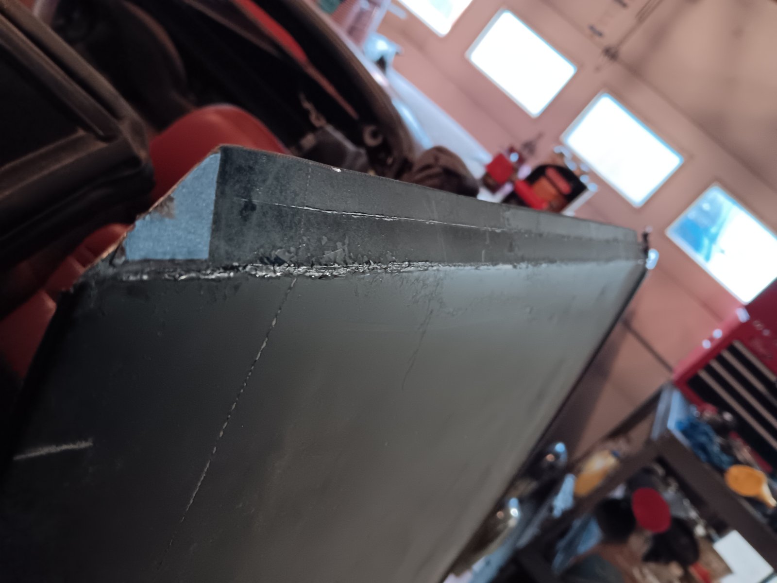

    Here's the victim, with the smaller piece in place and the hood cut, but not bend yet...

    Oh, and why? You might say... The hood is going to open from the windshield end...... The smaller piece which is the first 6 inches of a donor hood will be fixed.

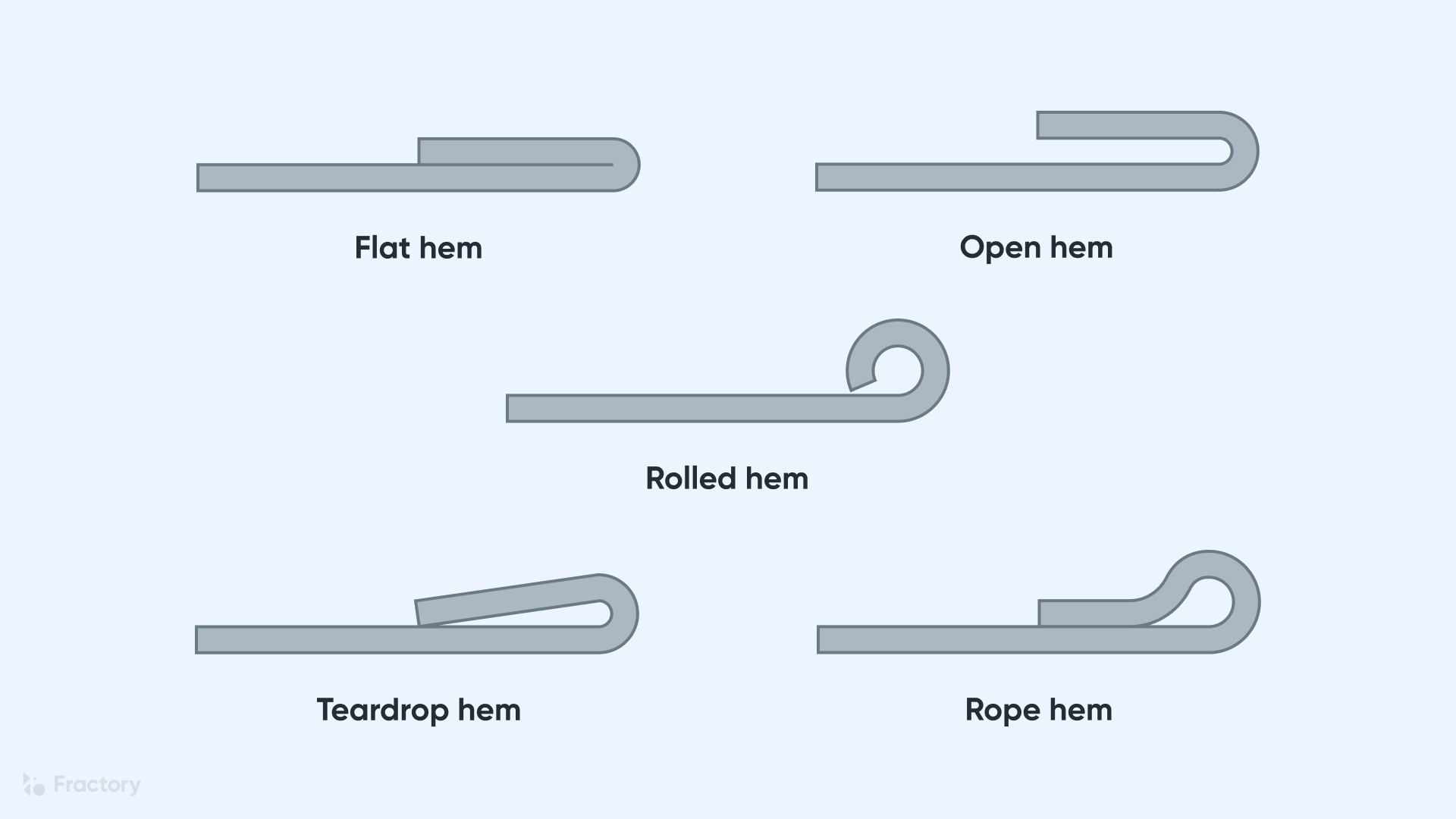

    So you're wanting to hem the edge?
    You won't want to use a brake.
    Think of it as a door skin. Tip it to start the flange, hammer/dolly/shrink the flange to a 90, and then hammer it over to form the hem.

    If you are going to be using a tipping die, it won’t happen all in one p***. Good: you will have opportunity to correct any wiggle you induced. Bad: you will need probably four guys to help do the job. Two holding the back edge of the hood, one turning the wheel, and you guiding the business end and shouting directions.
    If you want to do the full and flat hem you probably won’t need to do any shrink/stretch along the way. Do the last roll of the hem between two flats on your bead roller. You will need to hammer and dolly the curve back into the front edge of the hood. Shouldn’t be too bad if your helpers listened well as you were rolling.

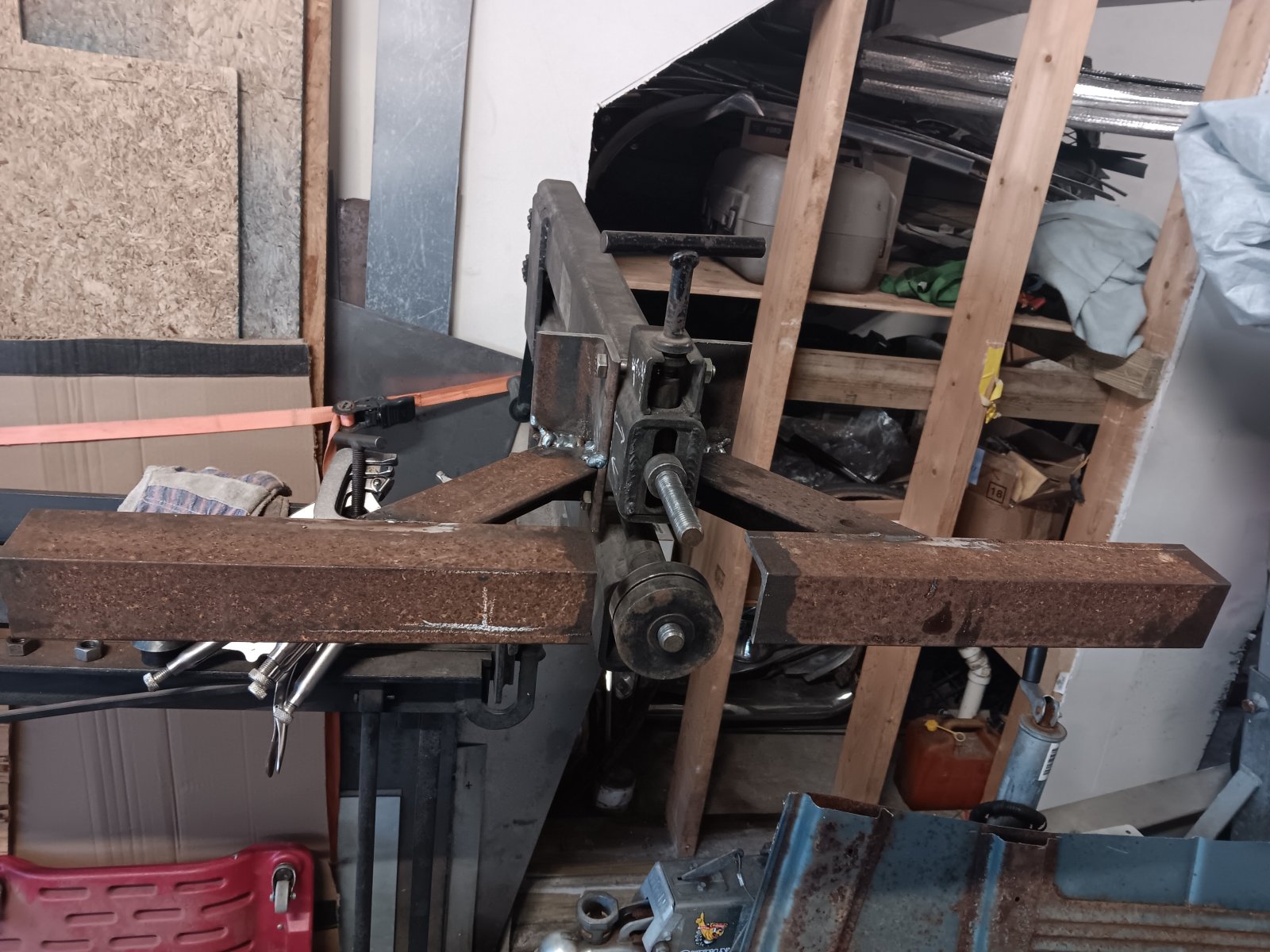

    Built a fence for the bead roller. Step 1, check...

    If using a fence your cut needs to be exact. If tipping by following a line drawn on the part you have opportunity to adjust a little as you go. Slow and steady wins the race.

    I plan to cut and grind smooth. I just can't picture 4 or 6 hands moving the hood and staying on a line without a guide like a fence... Got any suggestions?

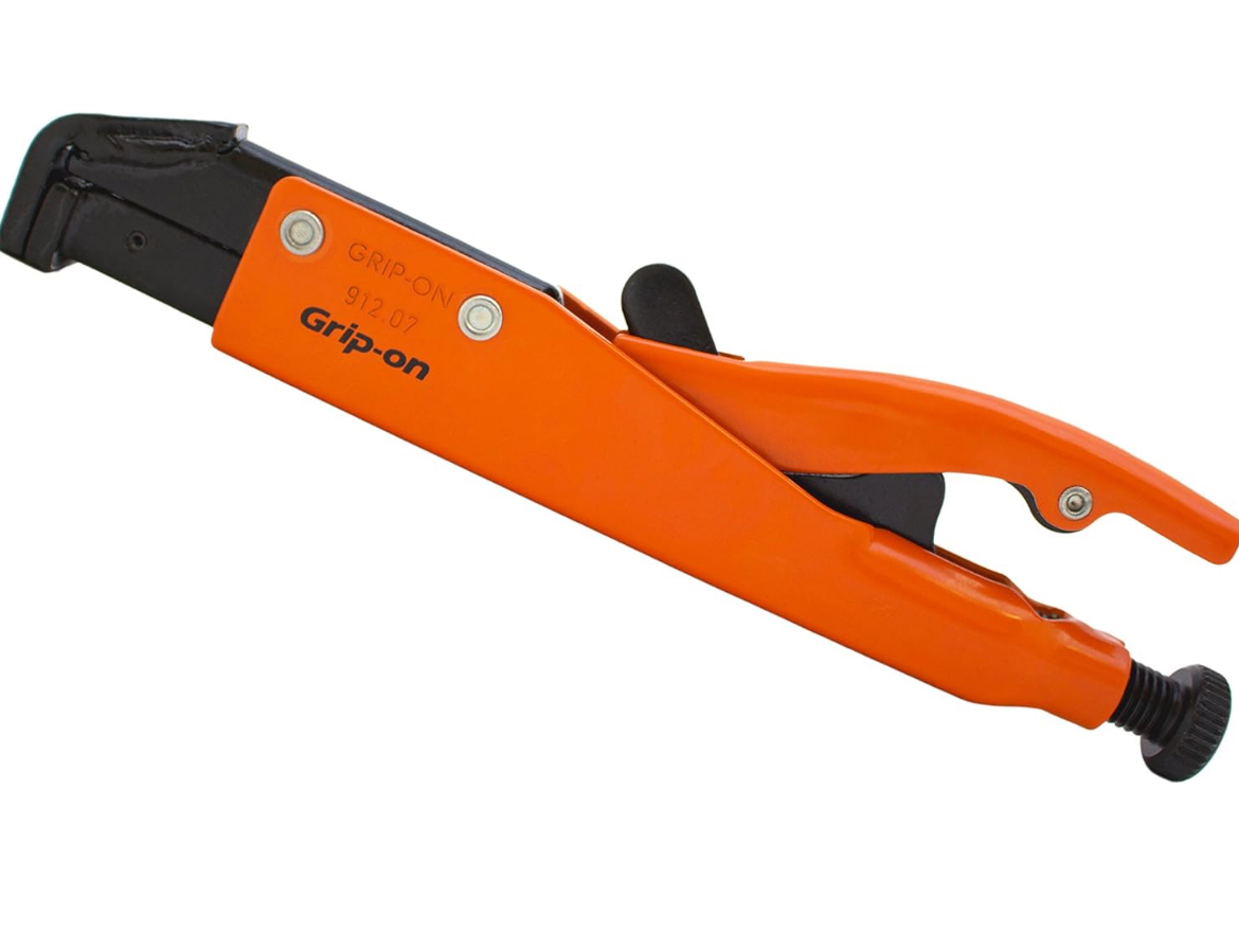

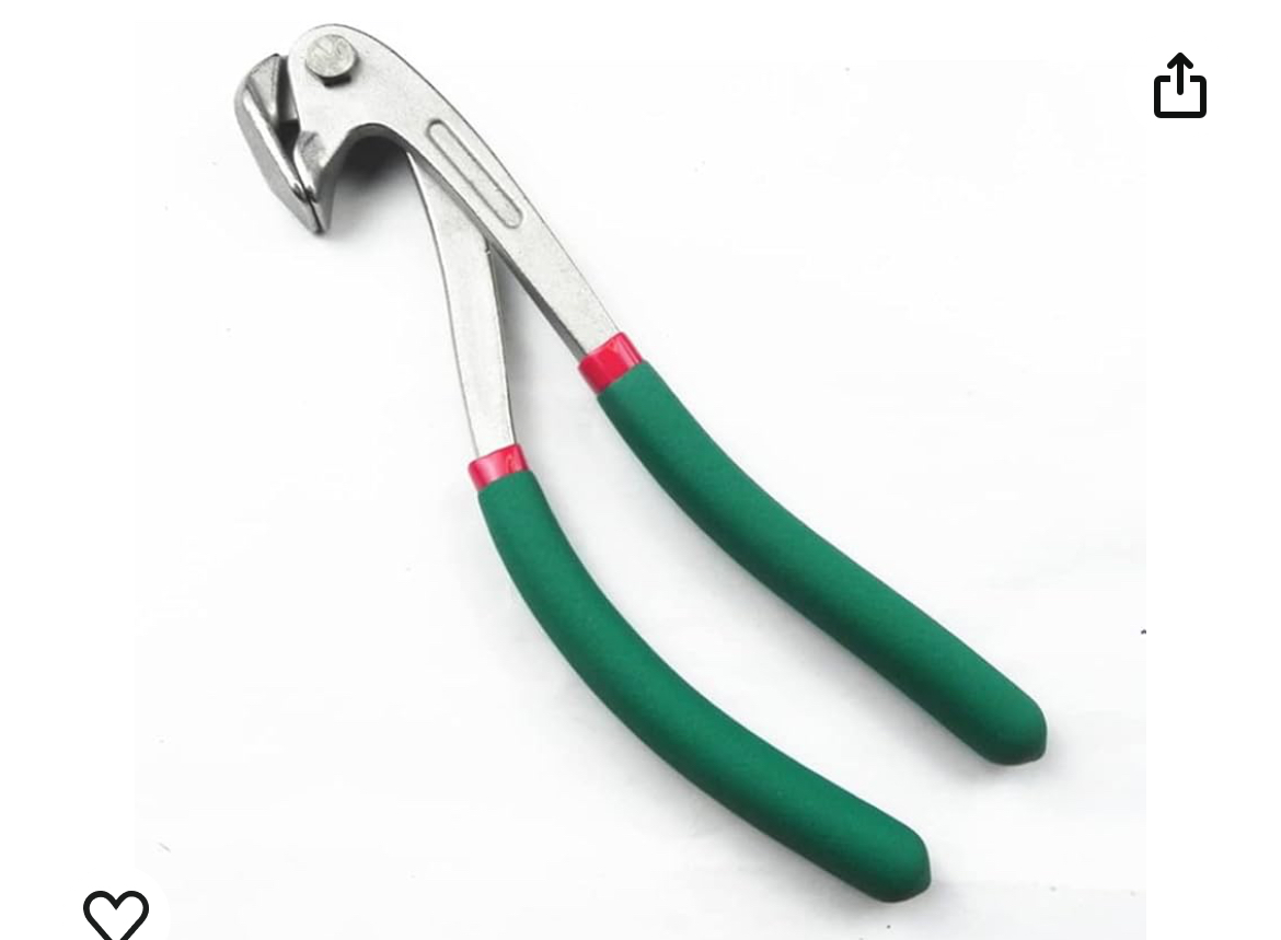

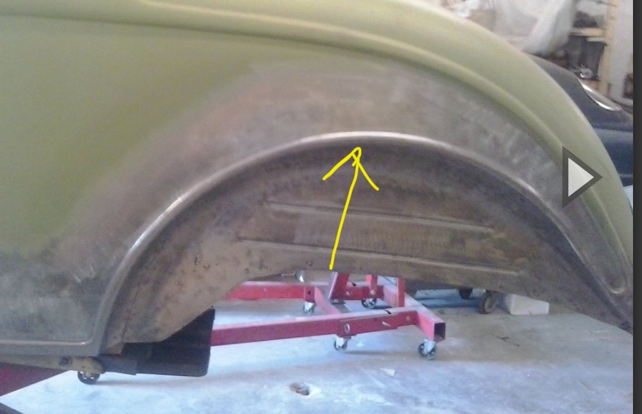

  23. Not really sure what your after but this panel was joined in the center of the bead.
    The arc was made by patiently bending with a vice grip.
    I haven’t bought a tipping die for my roller. I use pliers to bend flanges. Even hem joints.
    Not the fastest but works
    I have a pair of these that can fold further than regular vice grips
    I’d like to try these

    Finally able to gather enough hands to run the hood thru the bead roller's tipping die. We decided to remove the fence I made because running a test piece thru we noticed that if corrections were needed, they probably could not happen with the fence. Holding the much smaller test piece against the fence was nearly impossible.
    Anyway, we got it done. It's not perfect, they are a couple small wavers, but it's close enough. Now, I may finally be able to get the hood on the car!

    While it looks like we might have had Larry, Moe and Curley on the job, I ***ure you the only Stooge was me... I could not have done this with less hands... Really great the guys and gals could all come by to help me... That's the test piece we are running thru...
    Next up, I'll find a donor inner structure piece to capture under the newly bent flange and weld to the structure that still remains under the hood. Then I'll cut out my wood hammer form that I marked before tipping. I'll hammer the new flange (hem?) over supporting with the hammer form to 90 degrees then probably a dolly near the rest of the way trying not to distort the new bend. Then I can finish closing it with the bead roller and 2 flat dies as suggested. Gotta remember to get some paint in there beforehand...
    I'll probably need to put some contour back into the leading edge of the hood where the new hem is and hope to do that more by just bending and convincing than actually hammering on the hammer form. Cuz, I suspect hammering will create stretching that I don't want...
    I think that's it... then bolt it onto the corvette hinges that are already mocked up... Obviously, more pics when it's working!

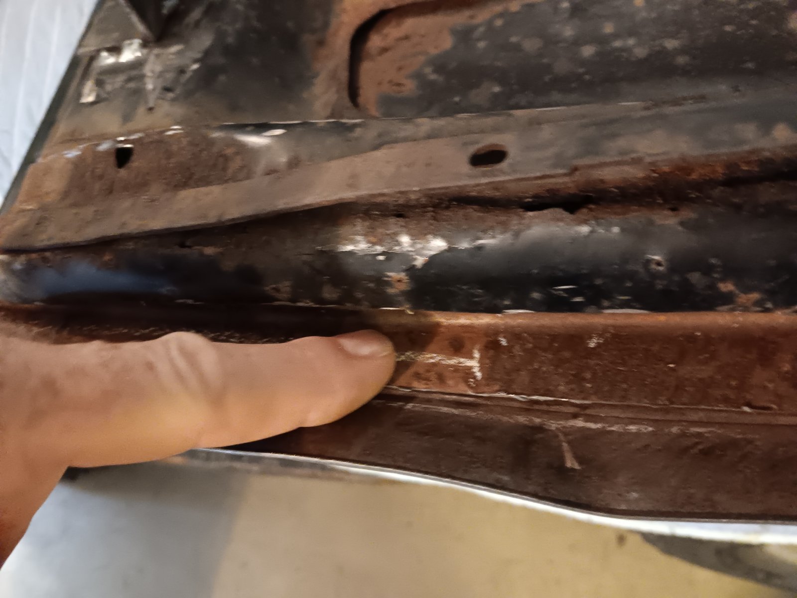

    Adding back the hood's support structure..
    Hood_Structure_repair4.jpg Hood_Structure_repair3.jpg Hood_Structure_repair2.jpg Hood_Structure_repair1.jpg
