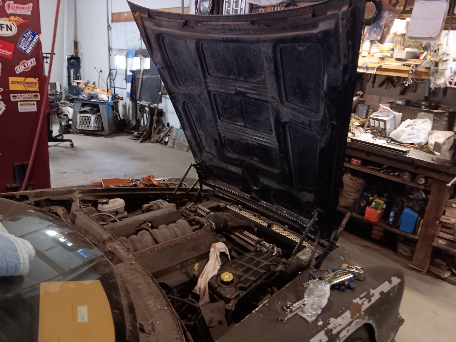

    I matched that rusty angle piece to the contour I saved in wood by shrinking. It put all the contour back in the hood's leading edge... Coming along...

    Finally back to it. Got the leading edge structure put back in the hood and hem folded over! It still needs a little more tweaking to get the fixed piece and the hood edge to match better, but it's on its way. Thanks for all the help on this guys!
