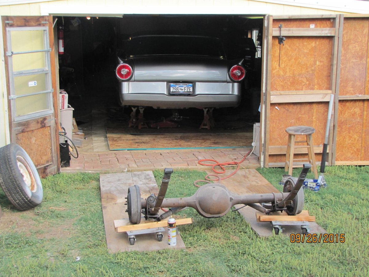

    Plywood (actually cheap osb)...my garage has a dirt floor, and I've used the plywood and wheel dollies often. I'm a 155 lb 69 year old, can move the car myself. A few weeks ago I used the same method to roll my rear end out rear end removal 001.JPG
