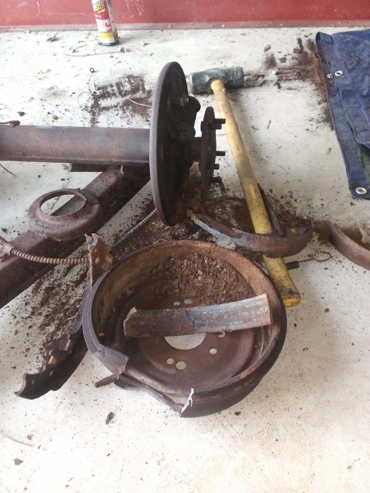

  1. So on my 58 Impala rear end I got for my 53 I got serious about starting teardown to clean it up etc. Had soaked everything in penetrant for days with no budge. Managed to get p***enger side mostly free with creative taps and prying. Luckily inside axle didn't have a speck of rust. Go to the driver side after patience levels dropped and just decided to go full on John Henry on it. Once I saw how rusted the inside of the drum was I didn't feel bad about smashing the drum. But there has to be a better way than just going caveman lol. Had already planned on replacing drums and backing plates IMG_2023-10-16-18-14-57-064.jpg

    I’ve found heating it up the around the the drum flange helps. That’s where they seem to get rusted solid.

    OH, so you DO have a BFH, after all ;)? Yeah, I don't believe that little 2 # dead blow would have done the job. Not trying to be a smart ***, but you know that a little heat from a flame wrench on that drum would probably made it a lot easier to get off? Just saying!
    @RmK57 beat me to it.

    I’ve had luck with penetrating oil, heat with torch then get your BFH and give it a few wacks. Repeat if necessary

    Here I thought wacking one with a 2-1/2 lb hammer was overkill. I'd be pulling the axles and third member to make sure that one hadn't been sitting under water for a while.

    I have always had good luck drilling 3 holes in the drum right up against the axle . Squirting penetrating fluid in the holes . Then cutting the hold down pins off and whaling the hell out of it

    BTDT. Sawzall and expanding the drums to get over the shoes was the only way. Rearend had been sitting for 20 years. Some of the time inside some of the time outside…

    That post # 1 photo, shows some serious rust. :D
