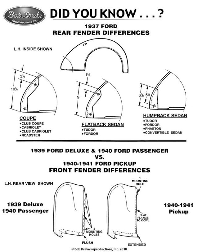

    Here's how to identify 1937 Ford rear fenders as well as 1940 p***enger vs. 1940-41 pickup front fenders. I understand that the 1940 p***enger car fender flange to cowl can be flattened out to fit the 1940-41 pickup. Remember, the 1940-41 pickup cowl section is flat in that mounting area.
    We will have our 1939 Deluxe-1940 p***enger front fenders done early this Spring. We'll look into the fitting issue for the pickups and keep you advised.
    Bob
