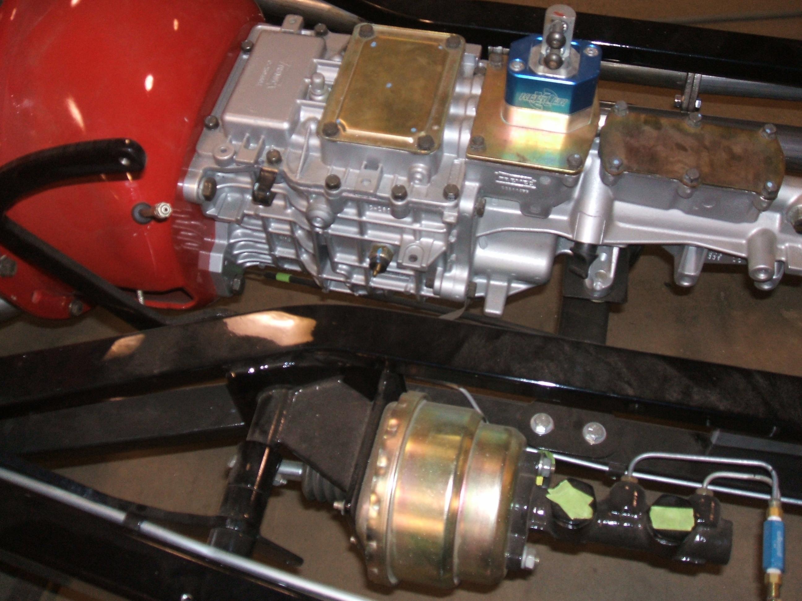

    hydraulic slave cylinder , here are pics of the pedal ***embly by fatmans fabrications, slave cly and throwout bearing fairly std stuff but had to find a throwout tha had a bleed screw in it as the throw out was lowest piont in system

    I swapped out the inline six for a 1984-5.0 302 w/t 5 speed in our '54 Ford Wagon.
    As someone else posted the tail shaft on the Ford transmission can be swaped out for a S-10 tail shaft.
    I used the transmission without the alteration,, HRP
    In this photo the shifter is in reverse,,close to the set but doesn't touch it.
    shifter is in first.
