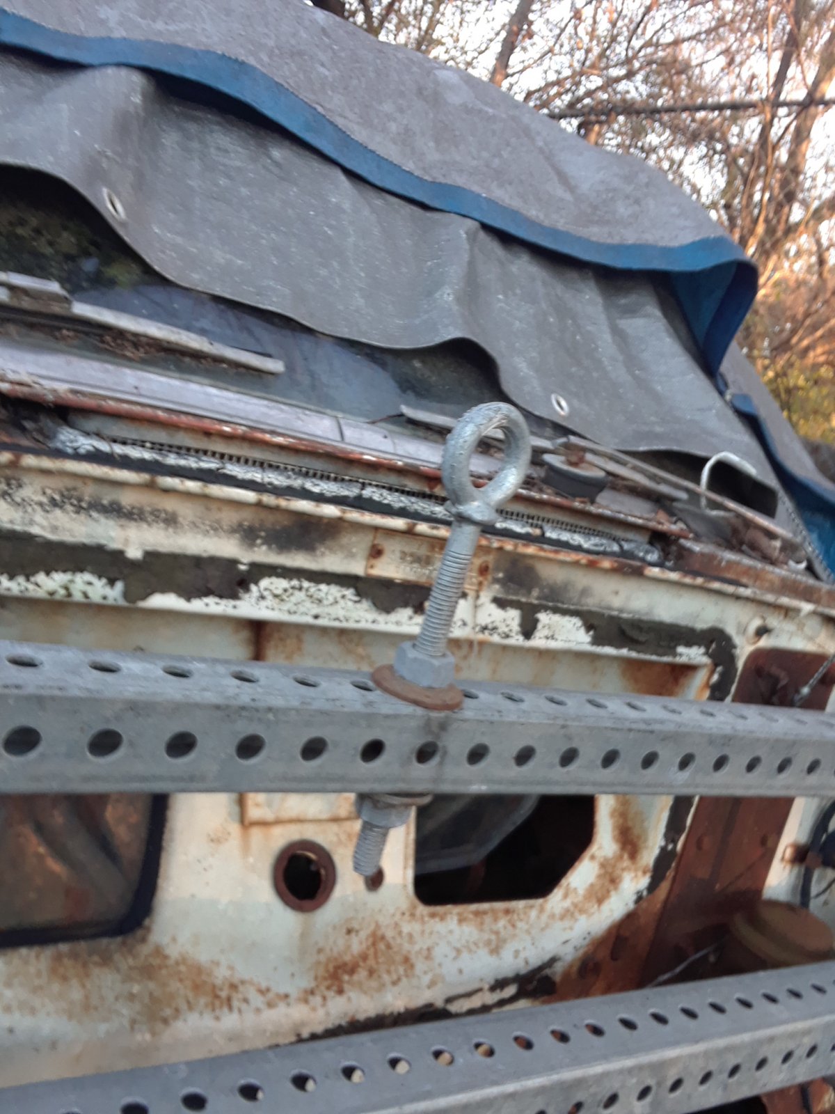

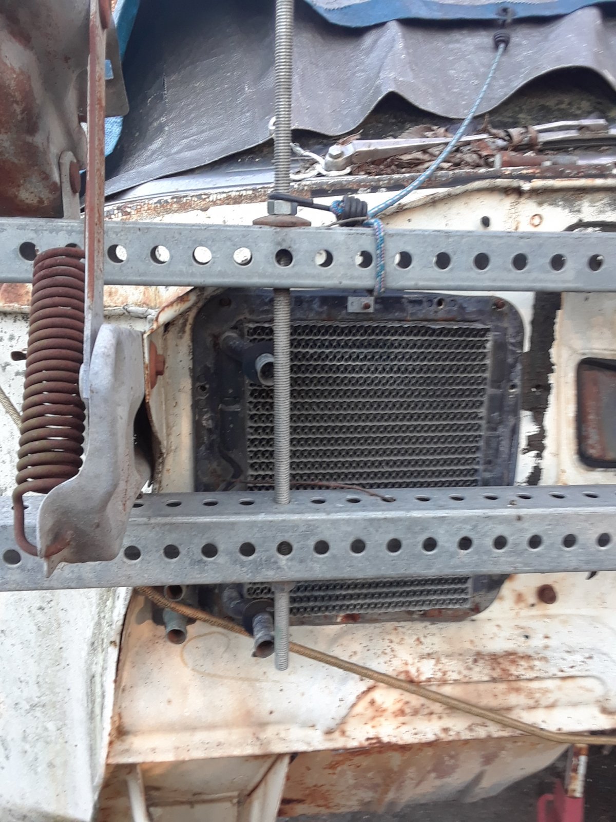

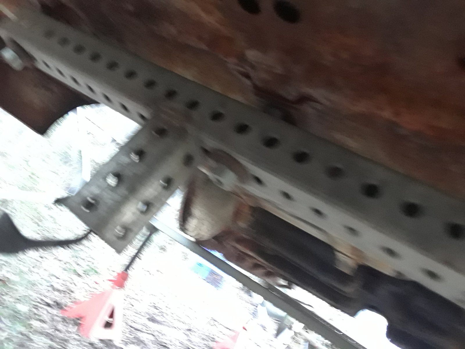

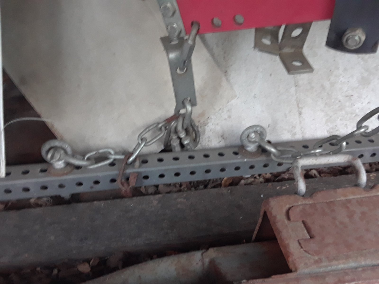

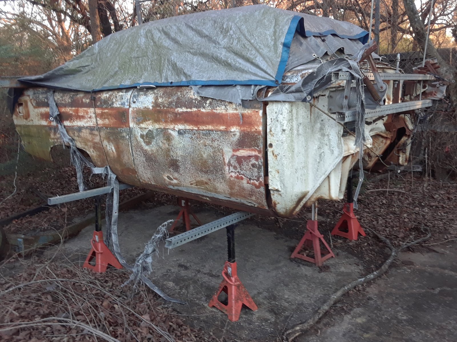

    I’ll be pulling a ‘32 5W and eventually the body of my ‘56 Meteor Victoria. I thought about using my engine hoist but the space is narrow and I couldn’t figure out how I could roll the ch***is out with the hoist in place. However, as luck would have it I came across a screaming deal on a return electric hoist, 400/800 lbs., at Princess Auto. Same type as HF and a mul***ude of other retailers. A couple of weeks later during a “family and friends” night I scored again but this time it was a 660/1320 lbs one. I checked out the load capacity of my trusses and I’m good for lifting the two bodies (I hope!).
    Still need to figure out how to keep them up in the air while I play with the ch***is work. I think with climate change and acquiring my shop has shrunk from 28’ x30’ to basically a single car shop!
