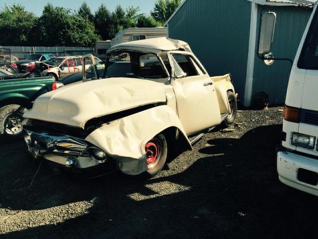

    A friend of mine had 9 year old radials on this F 100, the rubber on a rear tire came off while he was going 50, damn near killed him. It can be risky ! Paul Smith's F-100.jpeg

    He ran off the road, through a ditch, and over it went. He is an excellent driver, Drag Raced for many years, won some National Wallys.
