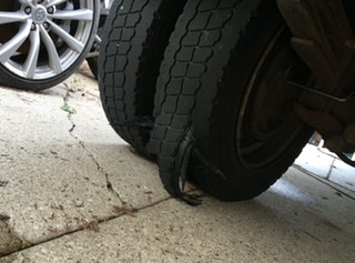

  23. TRENDZ
    Joined: Oct 16, 2018
    Posts: 386
    TRENDZ
    It just happened to me. My dually has 12 ply 19.5 tires. Way over rated for a pickup. The tires were given to me, used, about 10 years ago. They are inflated to 90 psi. Heard a very loud boom a week ago. Couldn’t figure out where the noise came from. Neighbors came out of the house at the same time wondering the same thing. Yesterday, I was wondering what the heck was that under the rear inner tire on the truck???

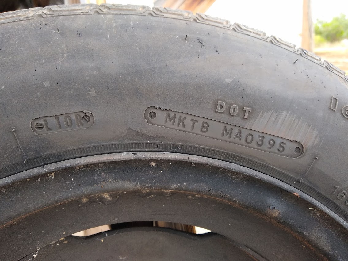

  25. squirrel
    Joined: Sep 23, 2004
    Posts: 59,856
    squirrel
    I wonder if I should go on a long trip with this tire? It looks fine....
    (Goodyear G-Metric 165SR15)

  27. Pre-2000?
  28. squirrel
    Posts: 59,856
    squirrel
    I think so.
