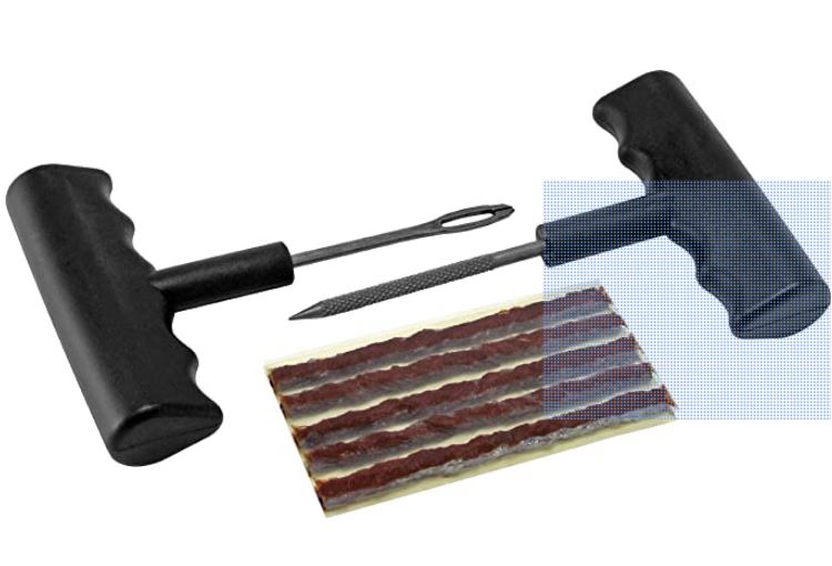

    Ran over a nail, had a new plug kit but I was surprised there was no glue included, and not mentioned in the instructions. So I shoved the plug in, it was gooey enough as is. Haven't put the wheel on yet but it's not leaking. Anyone been down this road?
    I've plugged tires before, and has always worked, but always used glue.

    I haven't used glue with a tire plug in at least 25 years. I use the plugs shown in your picture.

    Old habits are hard to break...apparently the newer style of plugs have the glue embedded in them.
    I still apply glue onto them.

    Does anyone else light the extended end of the plug for a few seconds after it's in the tire to heat the glue? An old guy that has been changing and fixing tires for years showed me to do it. Seems to work.

  12. Use them at least 2 times a week at work, I've been using them for 25 yrs. Installed correctly they last the life of the tire. You don't need glue and the redish ones work WAAAY better then the thinner black ones.

    Same here. I use the sticky newer plugs, but have a can of rubber cement type glue for plugs anyway, so figure I can’t do wrong with the plug and cement.

    I had a plug go bad on my 70 Challenger, 5 or 6 years after installing it. Self valcanising tire plugs are much more reliable the the old glue in plugs.
    One advantage of plugs over patches in the upper midwest is protecting beltd from rusting. When i made tire repairs for a living, at the service station back in the ninties i saw a few belt seperations due to rusted belts around older patches.

    i use a tire patch that has a plug built onto it you have to prepare the tire as if using a patch but then pull the plug through and then seat the patch a very solid repair

  19. We call those “ camel hairs “ they work great never had an issue.
    I never glued them , ream the hole, stuff it in, cut off the excess and burn it a little.
    ive used the thin black ones you need to apply glue to, work great as well.
    the last 6 or so years I did automotive those plugs became “ illegal :eek:“. So we had to do plug patches from the inside.
    a much better repair I was told...... but the 15 or so years before this became supposed law, I never had nor did I ever hear of a plug failing.

    the glue act's as lube. you can buy just the glue separate

    Something else I have been wondering: Are you supposed to fold the plug evenly in half and leave both ends sticking out, which makes removing the tool more difficult, or leave one side shorter and have it slide through the tool inside the tire?
