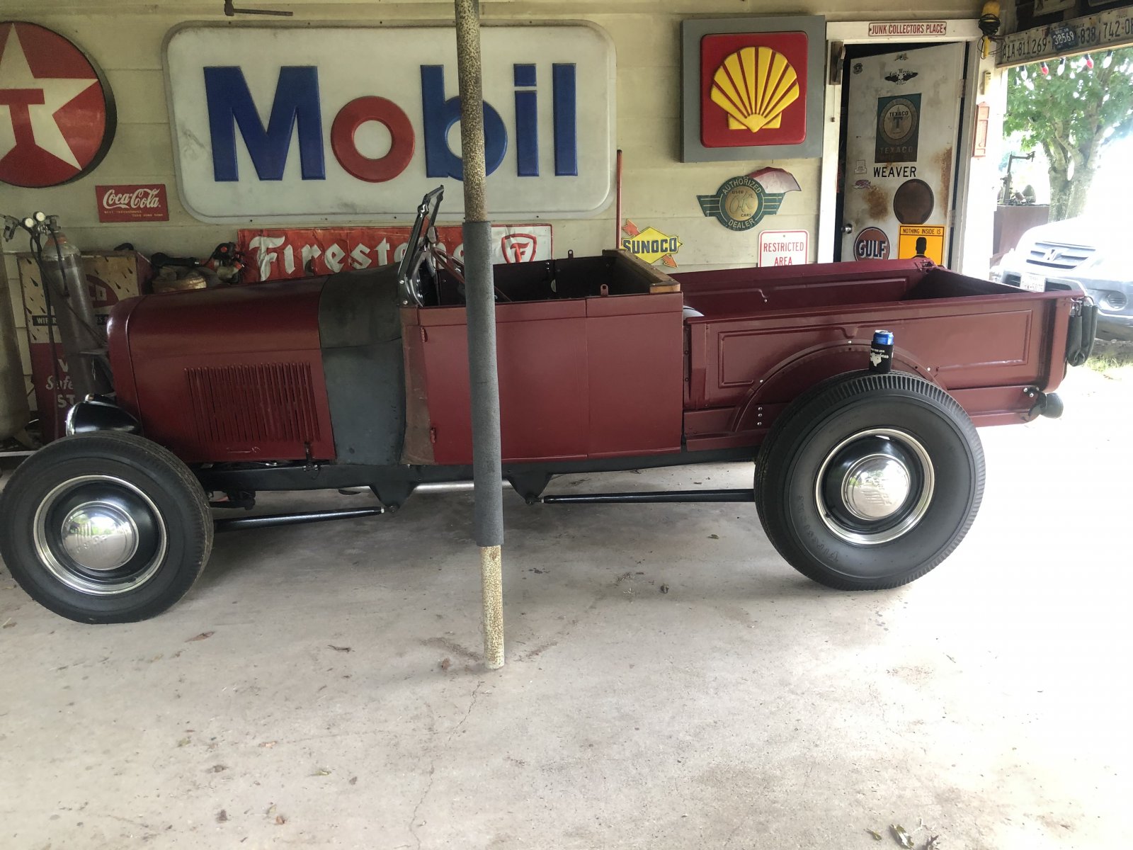

  19. 26 T Ford RPU
    Joined: Jun 9, 2012
    Posts: 12,543
    26 T Ford RPU
    Seven year old thread, the OP has sold his car and Marty hasn't been on here in five years. JW
    Kiwi 4d likes this.
  20. Tim
    Joined: Mar 2, 2001
    Posts: 19,970
    Tim
    from KCMO
    Still a good question worth answering. I’d rather do a search and find good info all
    In one thread than have to start a new thread and wait for a consensus.
